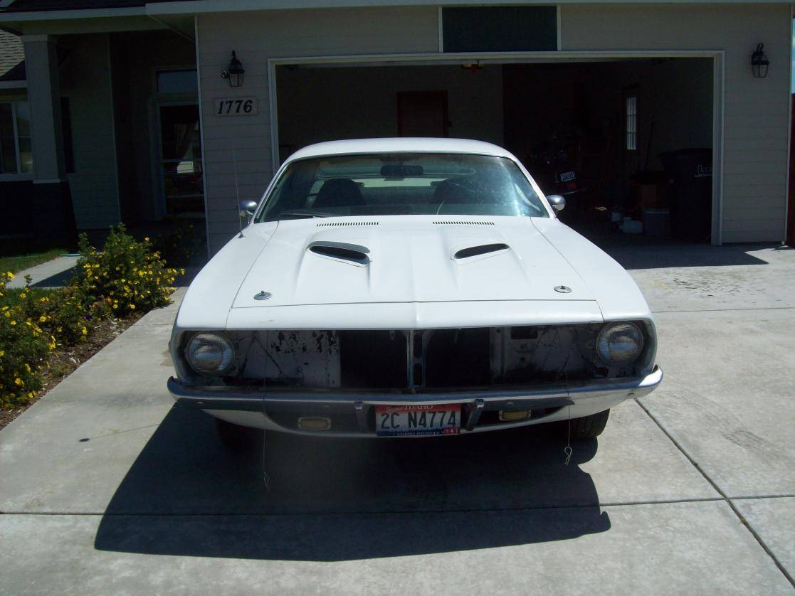

I did send the grille off to Classic Car Ranch in Canada to see if they could rebuild it, it will be a miricle if they can because it was in two pieces with some missing parts. I sent them pictures and they said it could be done, hope I can afford it. lol

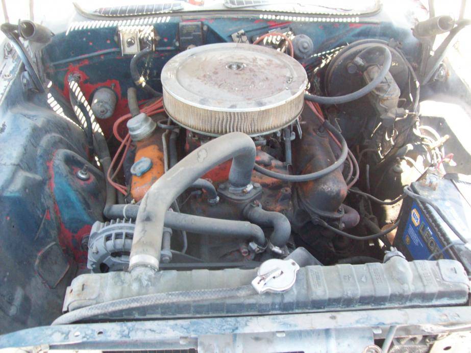

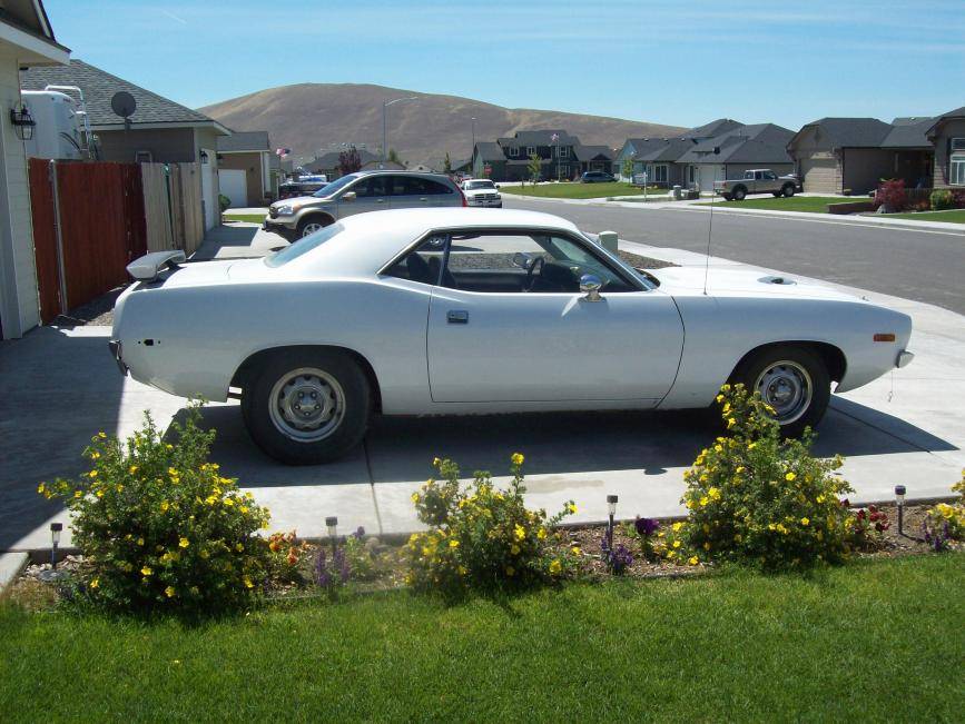

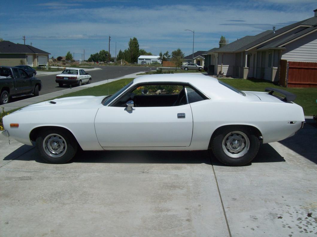

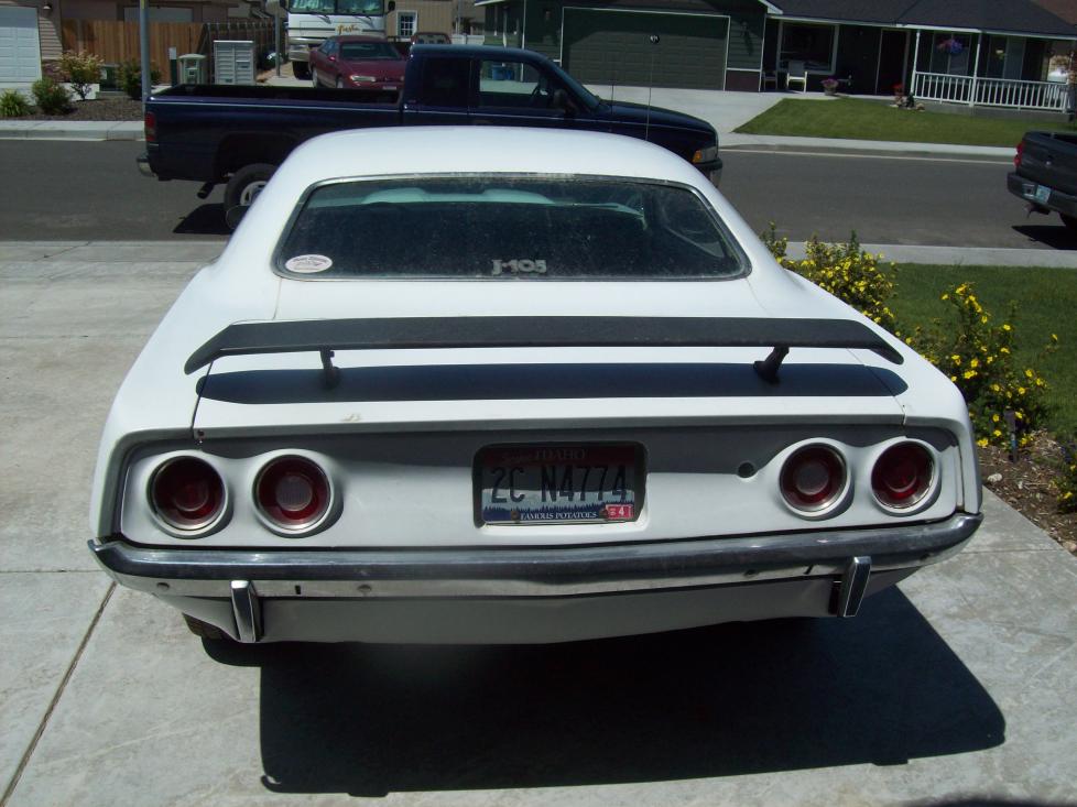

The pictures are what I am starting with for the restore.
