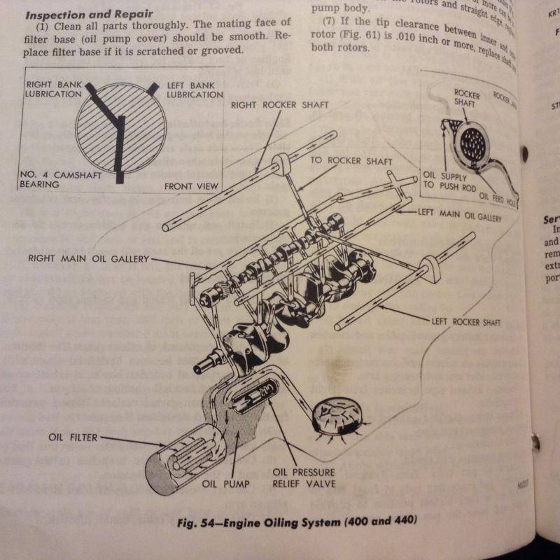

440 has way to much oil pressure
Chances are it's the relief valve in the oil pump. Not anything in the clearances. It's good to check those just to be sure - but my $$ on the pump. You should pull the cover off, and remove the relief valve. Clean its bore and make sure there are no burrs on the piston. Then reassemble it with a little white grease packed in the rotors. That should be a must-do for any new oil pump install. You might be amazed at how often there is a chip, or sticky valve in that bore.
