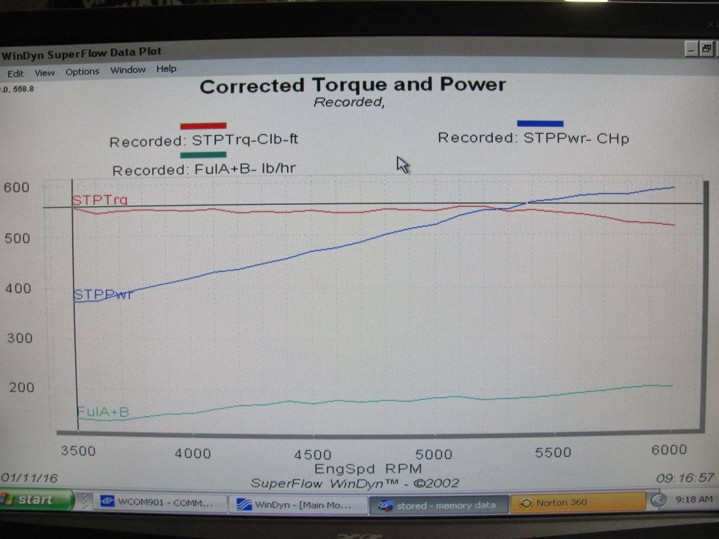

Mar 10, 2016 #1 I IQ52 Well-Known Member Joined May 4, 2012 Messages 66 Reaction score 8 9.9:1 compression, 91 octane, custom street solid roller 238/242 @ .050 (the equivalent of a 232/236 hydraulic roller) 589 HP, backup pull 592 HP with a graph that looks like this.........

Mar 11, 2016 #2 Adam Well-Known Member Joined Dec 25, 2012 Messages 1,695 Reaction score 760 Location Washington Very nice! What brand of cam?
