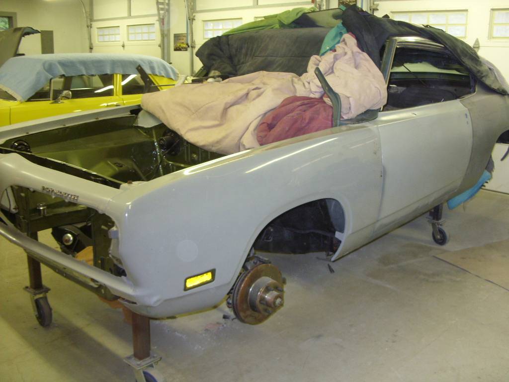

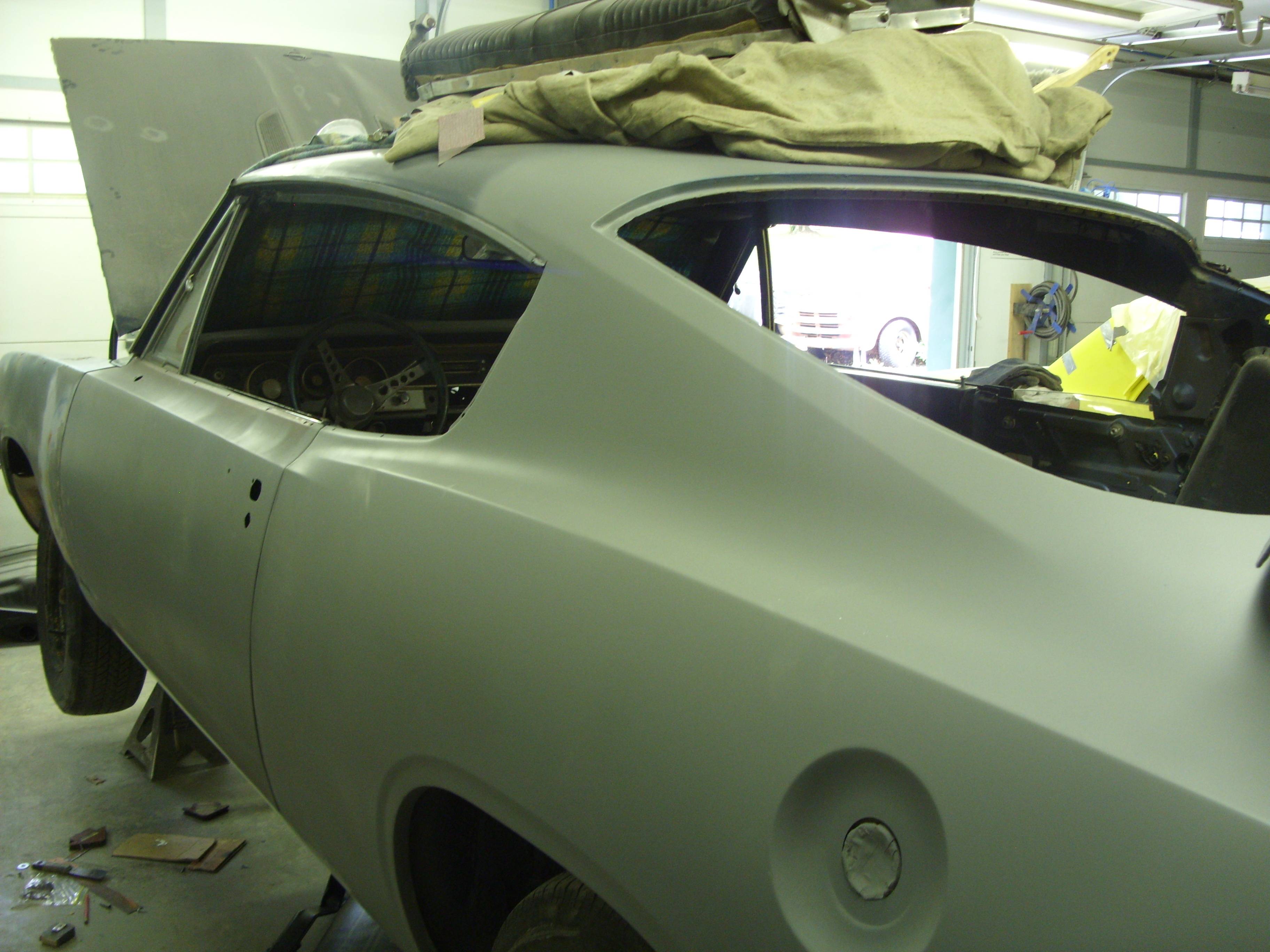

Here is my uncles barracuda he bought new. I did body & paint on

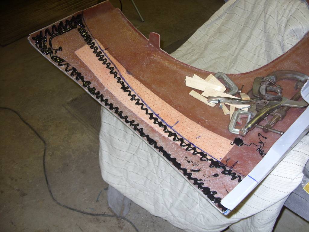

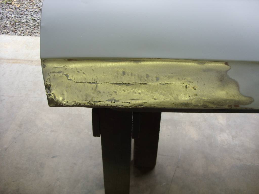

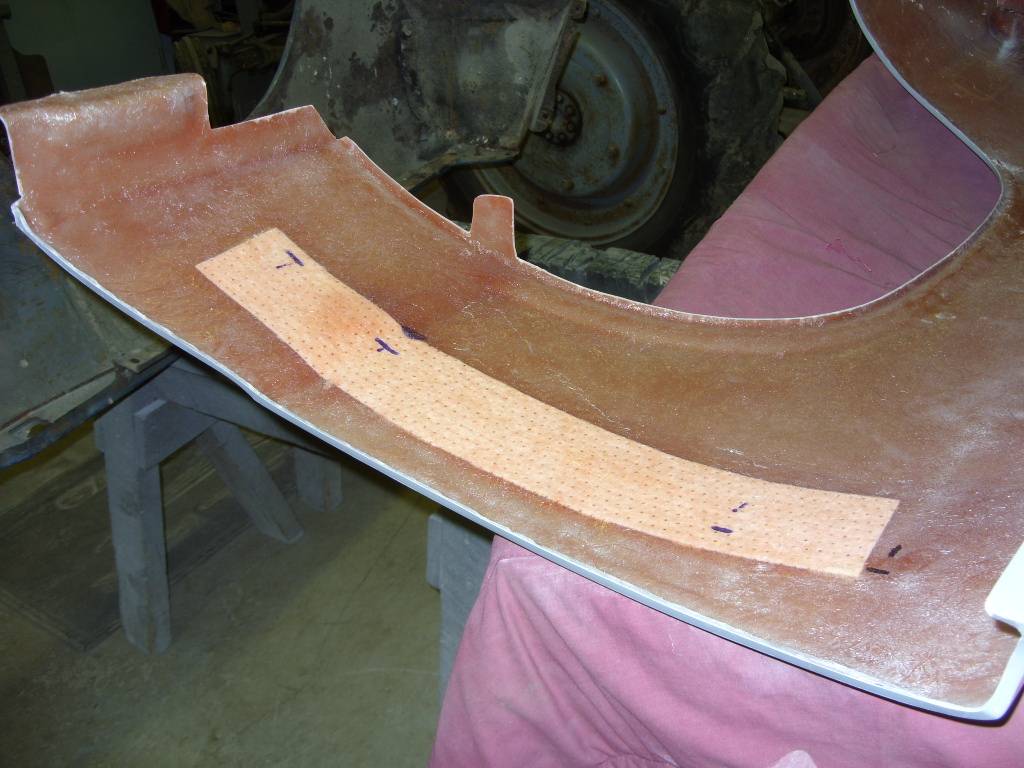

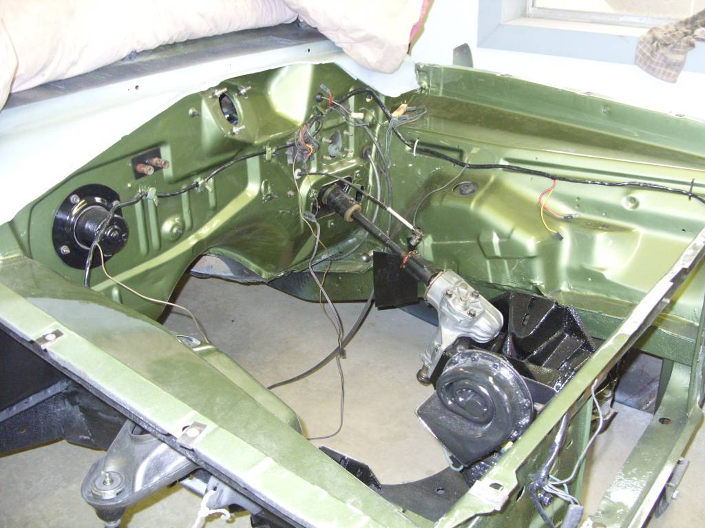

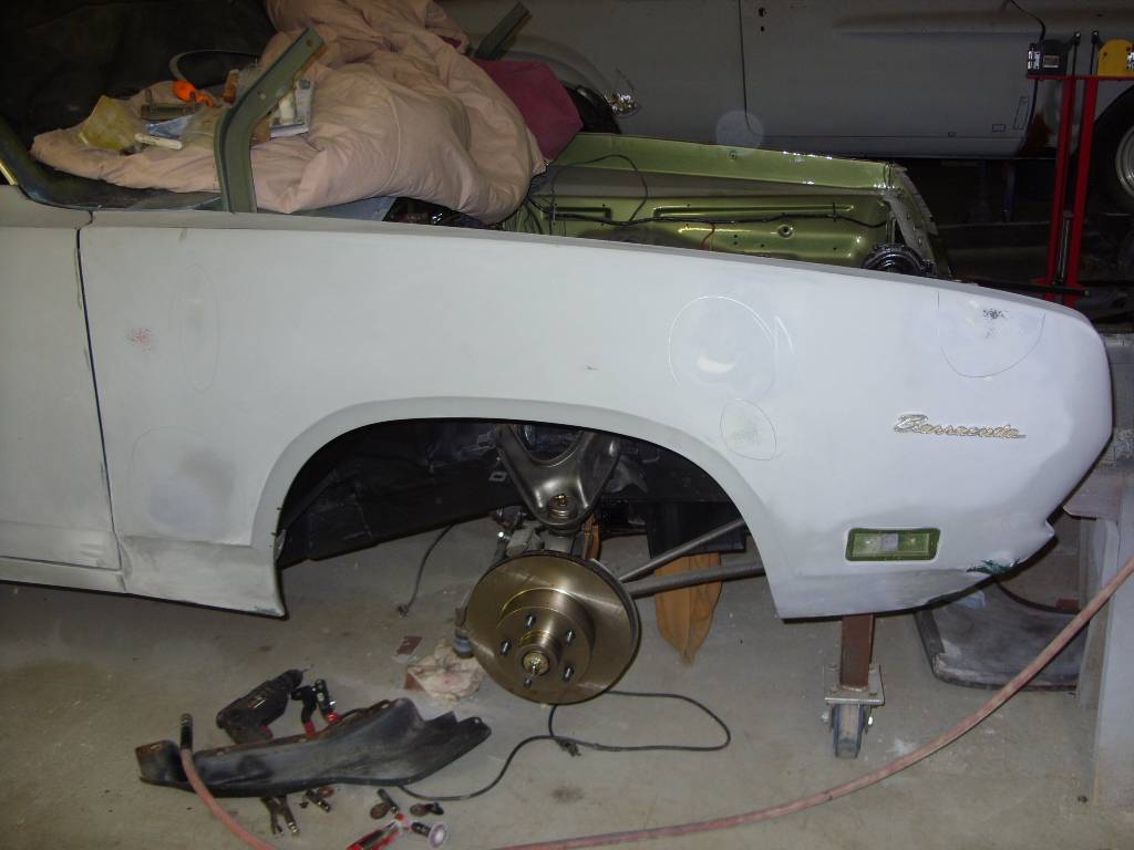

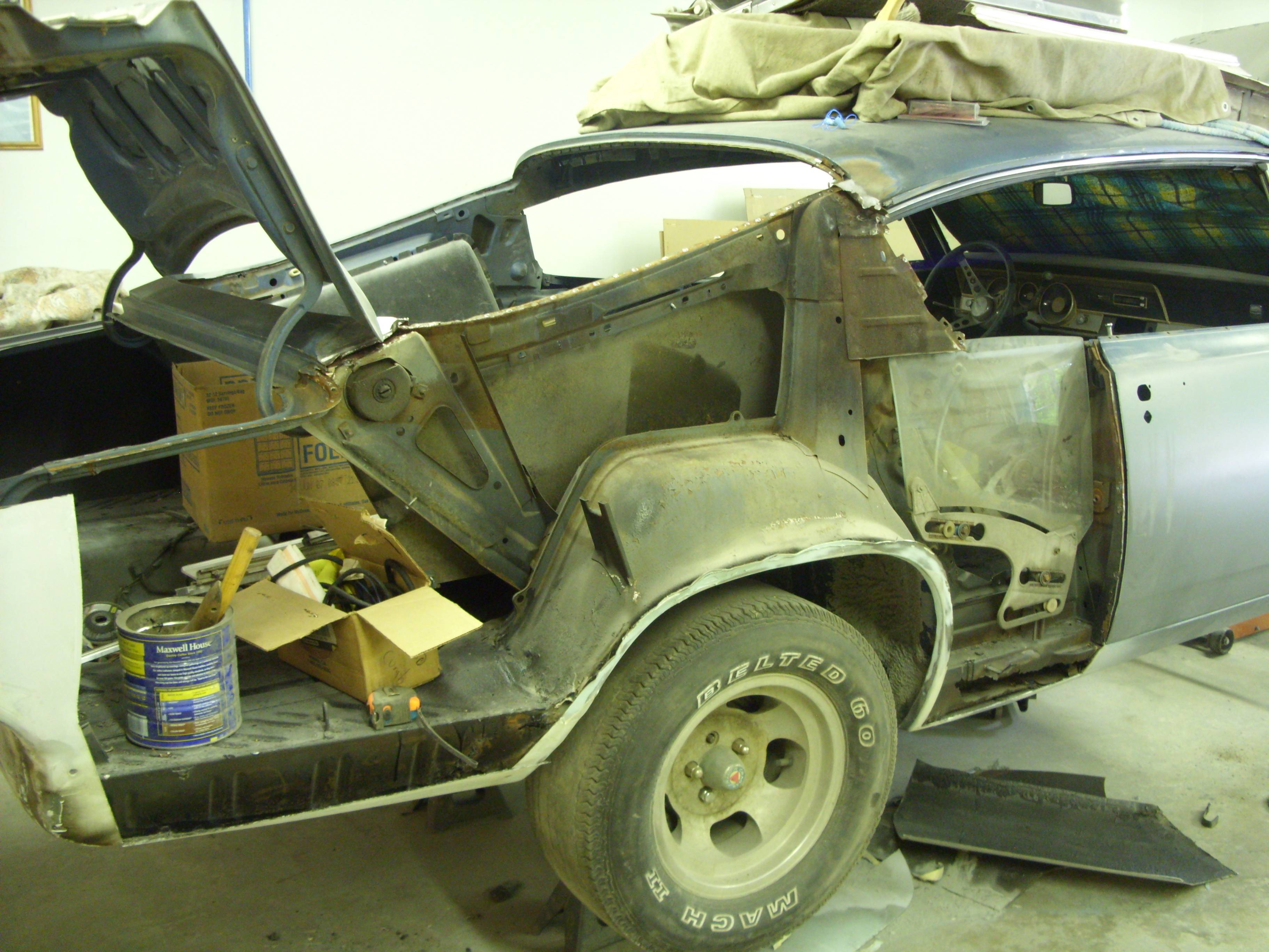

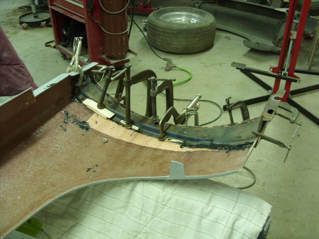

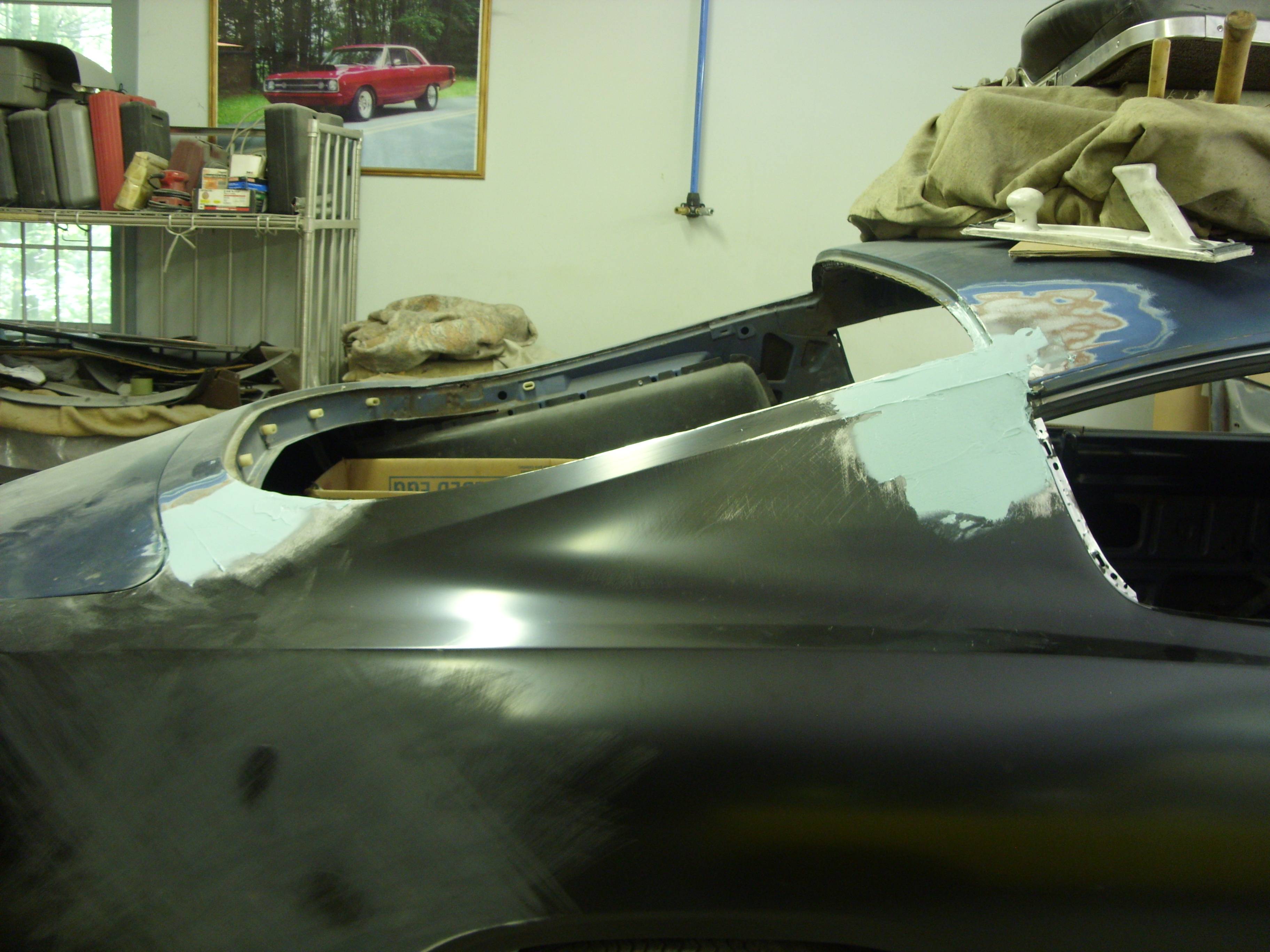

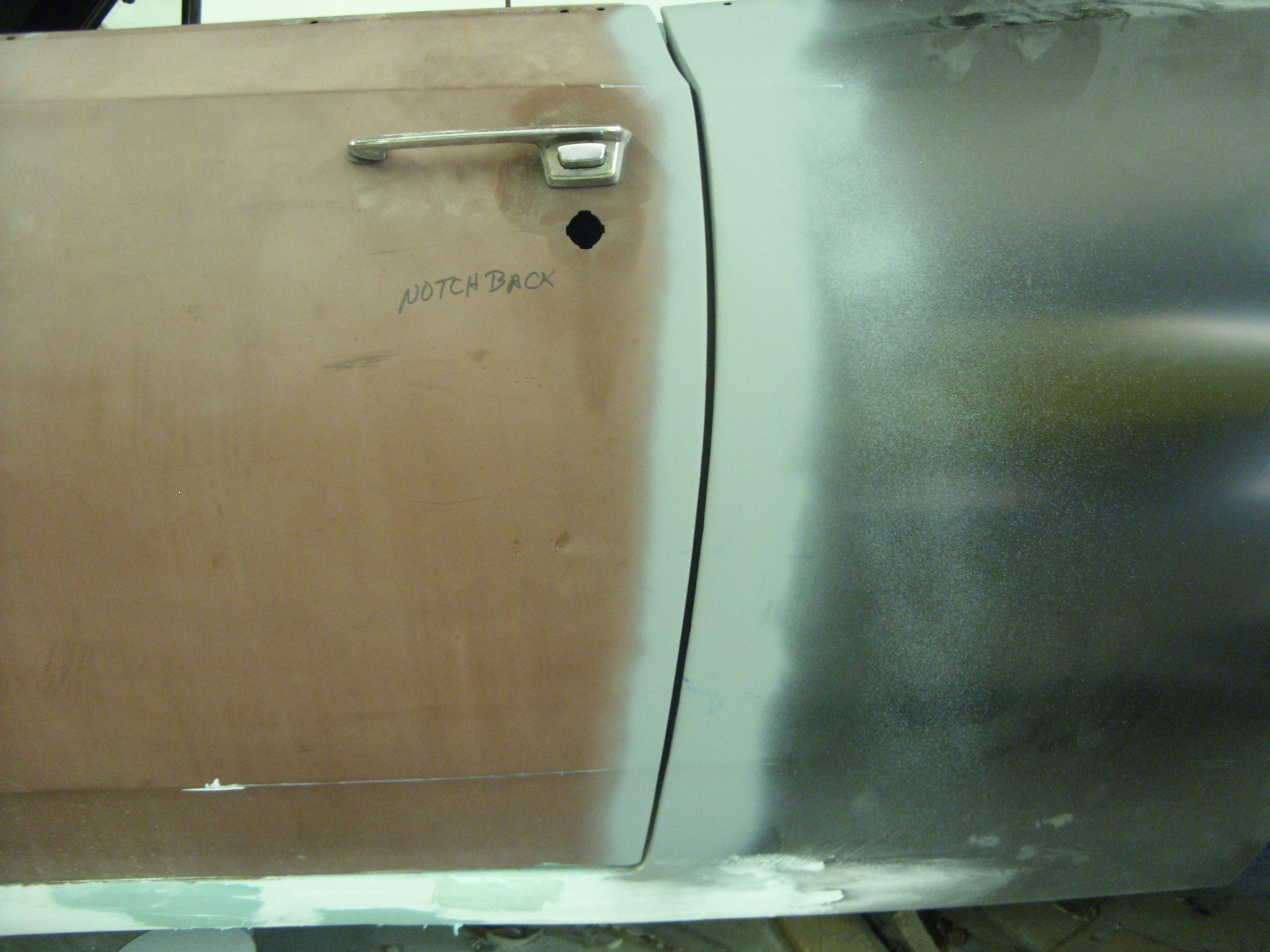

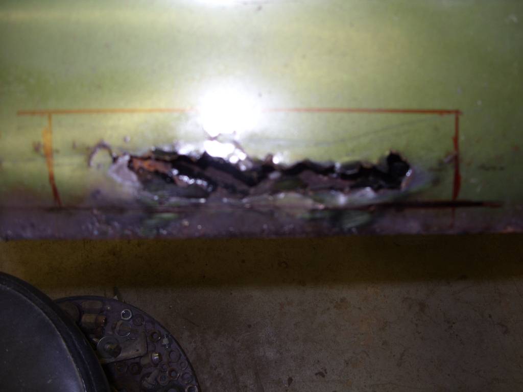

both quarters replaced patch work one door the fiberglass fenders didnt have the bracing where they bolt down at the rockers the original fenders were junk so i used the braces off of them

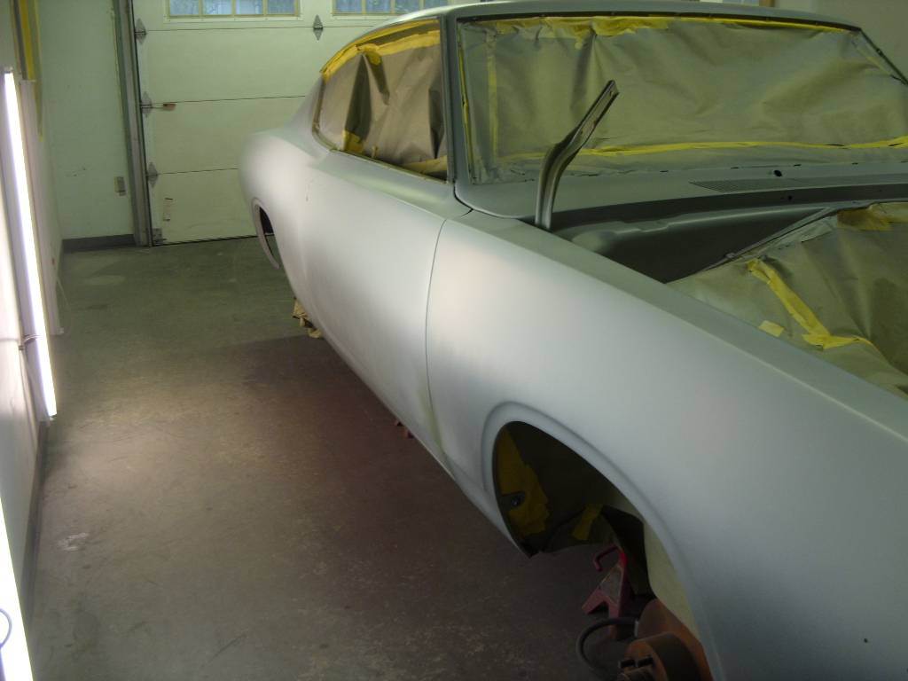

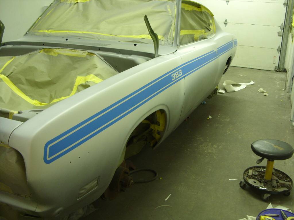

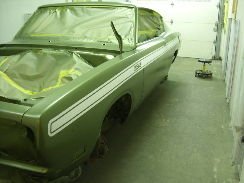

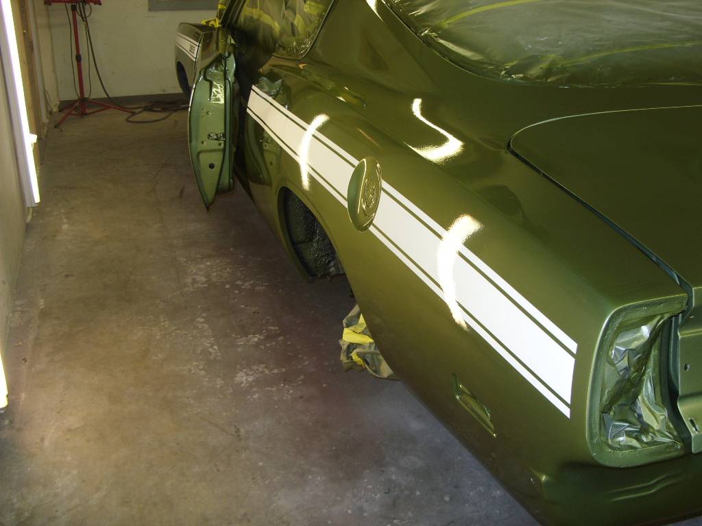

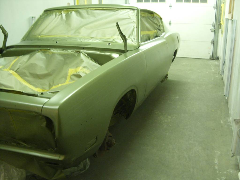

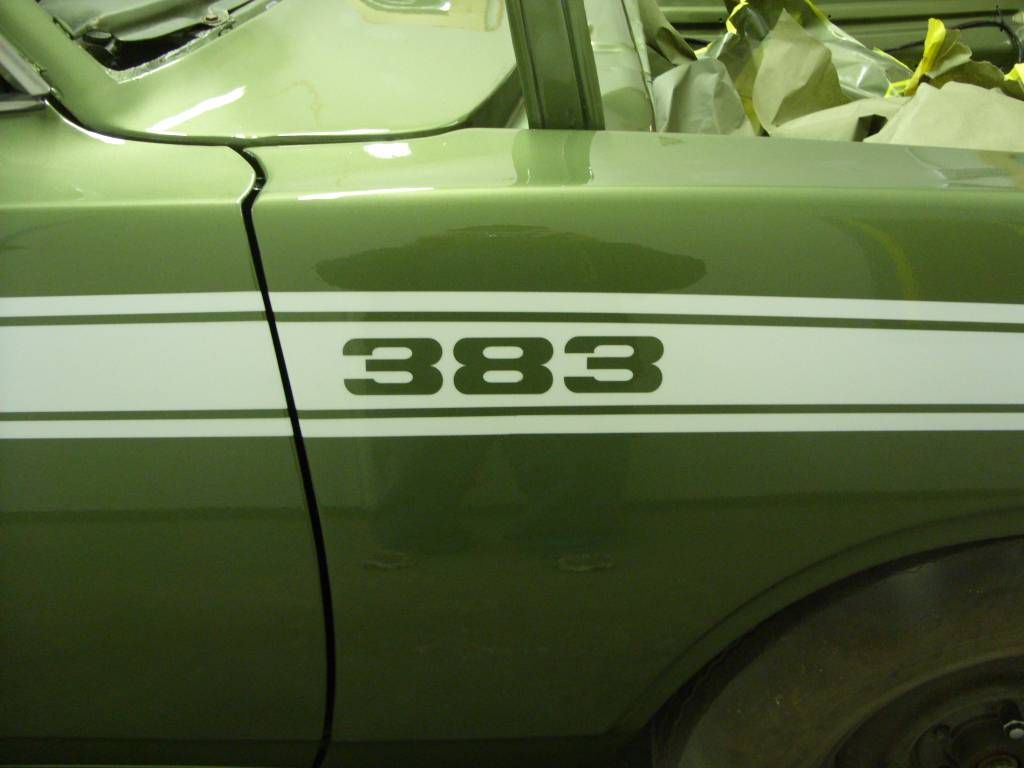

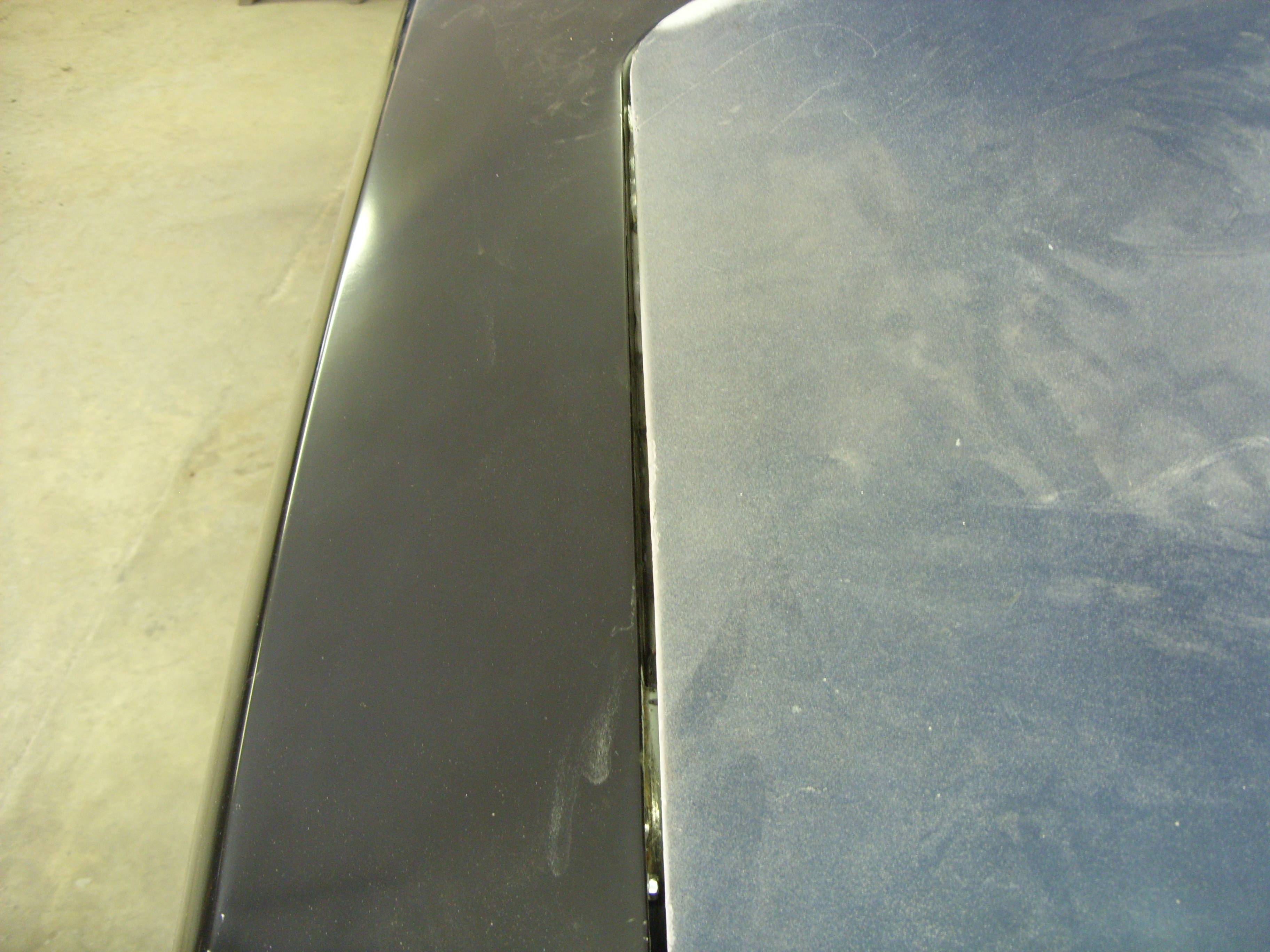

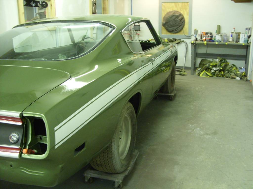

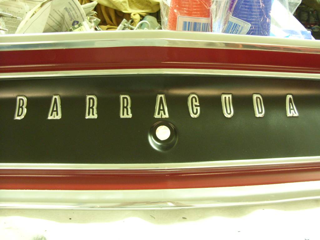

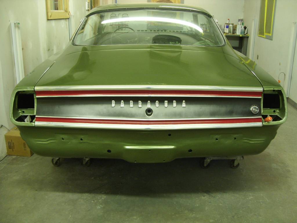

more pics white sealer then white base coat, put on the stripe mask, 4 coats of base green take the stripe mask off then 3 coats of clear after it dried block sanded it with 800 grit then 3 more coats of clear wet sanded with 1500 the wet sanded with 3000 then buffed

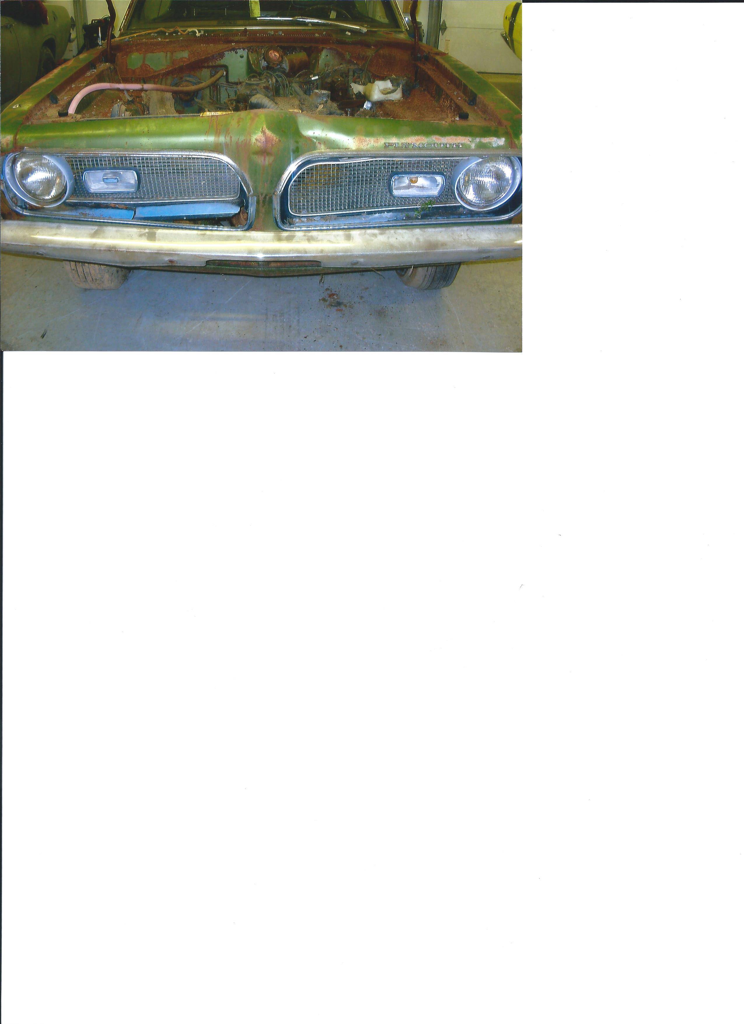

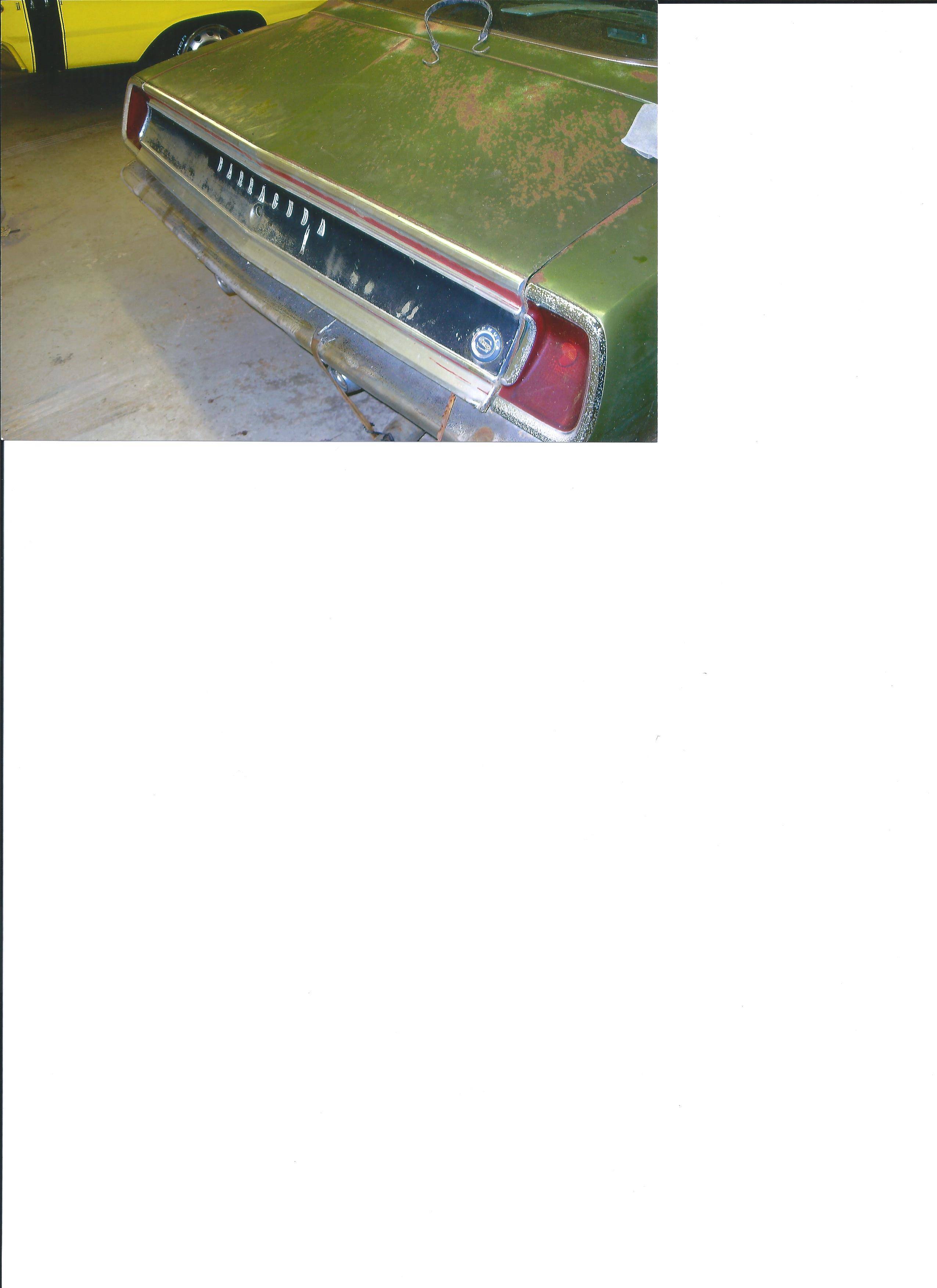

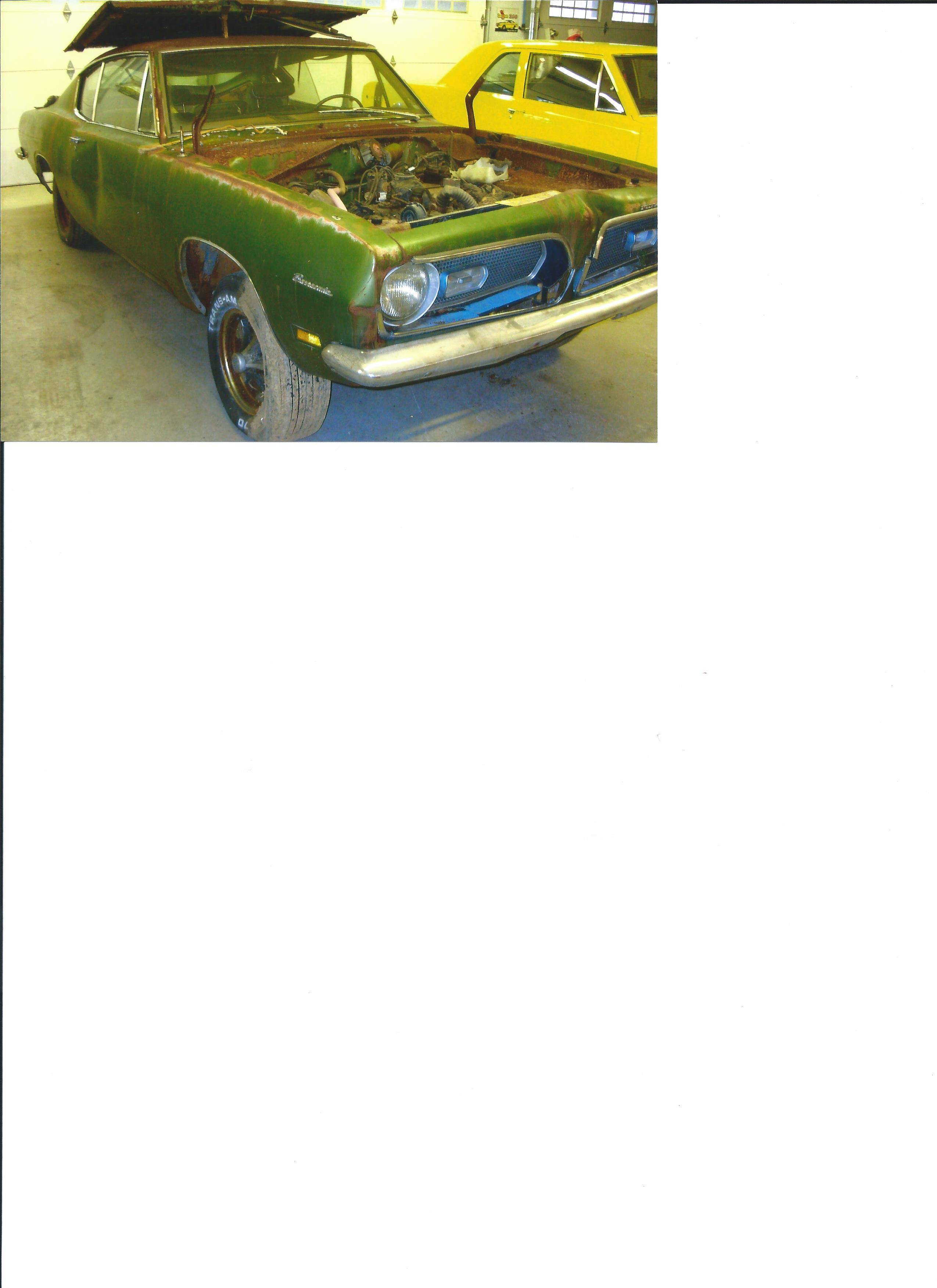

it sat in my uncles driveway for over 30 years frame was still good & floors had very miner rust wholes had to replace both quarters, trunk lid, left inner fender i bought it from him then when my dad got sick & was in the hospital i sold it back to him to fund 2 of my dads cars so he didnt have to do any thing to them when he got out but that didnt happen dad passed away dads 2 cars were 67 gtx 440 4spd ( he bought new) and a 62 polara with 62 413 max wedge
