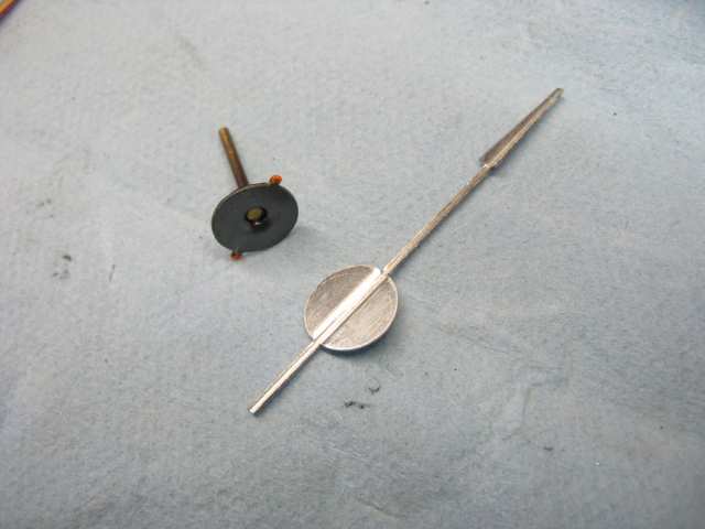

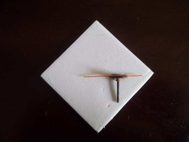

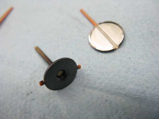

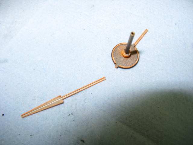

If you weren't aware those IS needles glue onto the broken park of your old needle, you'll still need that round portion with the stem. This guy mentions that around the 1:27 mark
