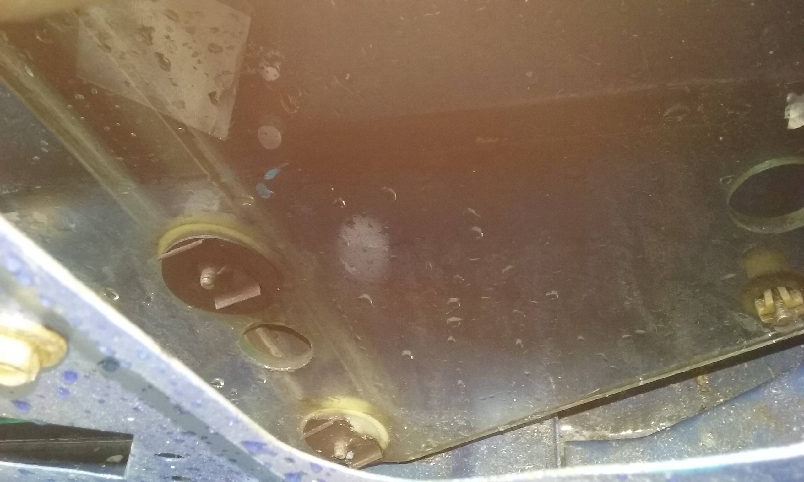

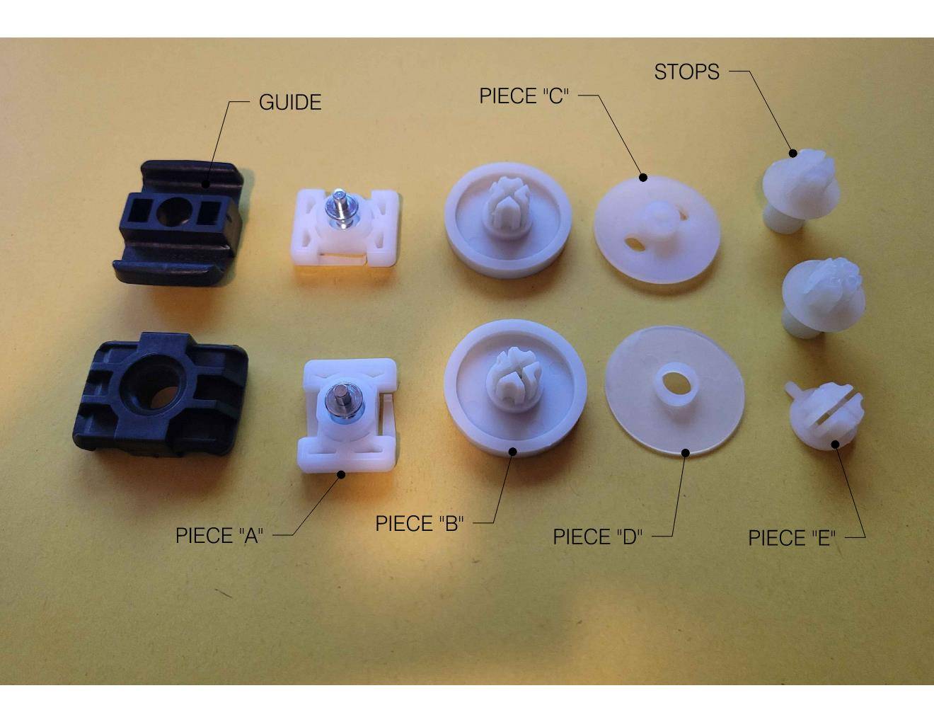

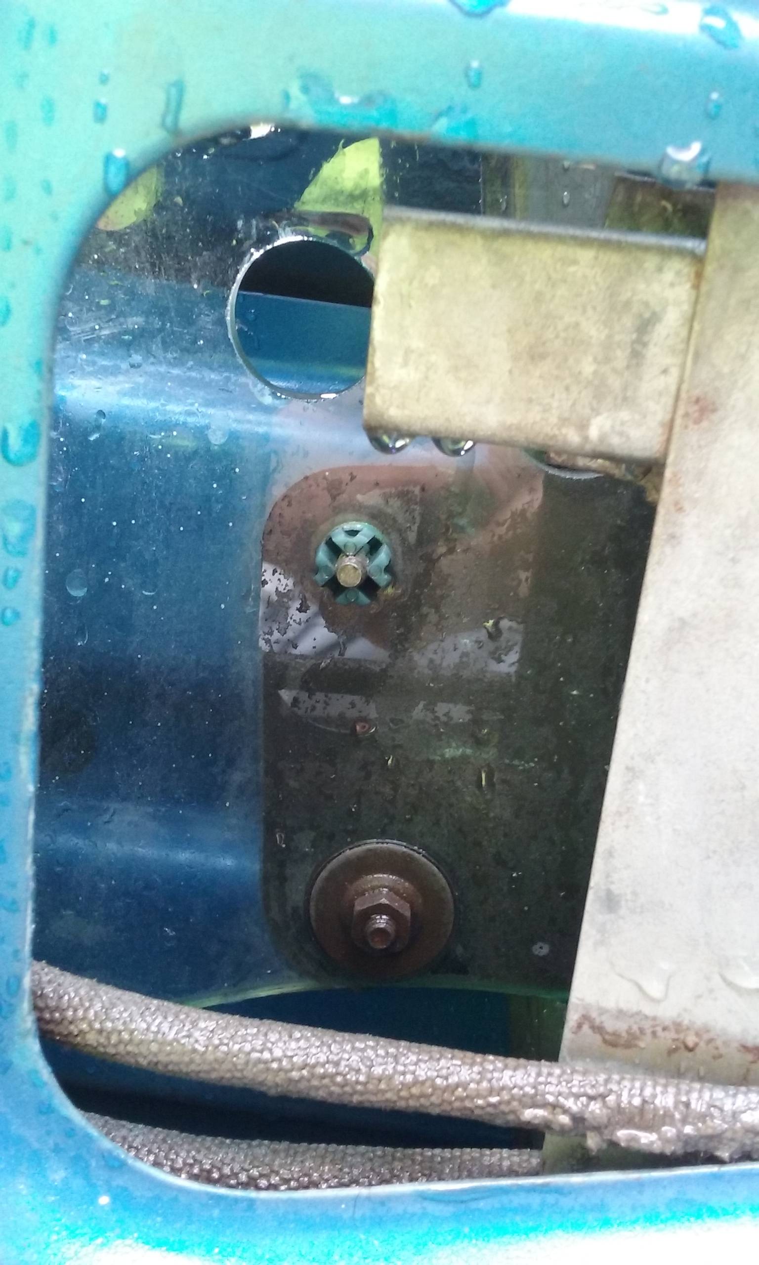

I know where the guides go and I have the screws that go through them. I do not know is what the sequence of parts is beyond the guides. Does anything go between the glass and the guide? What goes on the other side of the glass? The exploded view in the manual is not very clear. Thanks in advance.
Inside of door glass.1st picture back 2nd front.
Cool, thank you, best info I got so far. So, on the front guide rail there looks to be a minimum of three or four pieces. The screw going through the guide, a white/yellow washer, then the glass, then a fiber spacer and a very unique metal nut/fastener. Agree?
