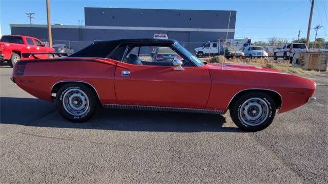

I looked at one of these rides and wanted to kinda take a poll. I know what I want to pay for it, but opinions matter and I thought I would get some input from you guys just based on a description. The main reason is, I'm not used to seeing a car like this in this shape. Usually they are rusted or in several pieces.
Body seems in nice shape no visible indication any panels need replacement. Trunk needs to be cleaned out but original ss and jack are there
Interior is nice. not new but complete. Rally dash, power top, console all there but needs work on the trim pieces. add on radio cd
bright work complete nice and clean. along with the top. tight clean no tears or damage. grill needs a restoration. Needs new weatherstripping
318 auto has a 340 auto. runs good, shifts nice, front discs. not clean in the engine compartment some grime maybe small leaks at valve covers or power steering?
wiring not cut up stock decent but brittle and stiff I would say.
Has a fender tag.
It's a driver. I think maybe 10 years ago this car would be 35k- 42k all day long...but now...who knows. I see a lot of disparity in car pricing between restored rides and survivor cars or cars that have just been sitting for years.

It's hard to tell the condition from just that picture. Is the car original or an older restoration?

most certainly an older minor restoration. He claims some minor rust repair was done. I don't see any rust that throws down red flags.
It is in decent condition. I mean I would be fine cleaning up some of the imperfections I noted and drive it for awhile. It has under coating but the floor and trunk pans are nice

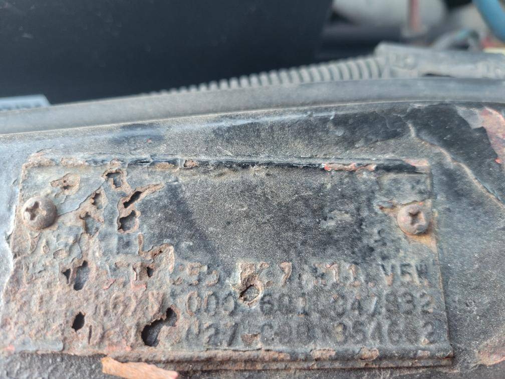

Ok here is what's left of the FT.
That's why it's kind of hard to finger a number on this car. You don't see them like this anymore. Ok say I make a deal for 55k the disparity is I could throw down an extra 20k and get a non numbers matching completely restored big block convertible bp. That's the dilemma. In this case, clearly the restoration costs would never be recovered so it'll be better to just clean up what I can? And drive it like it's meant to be.

That tag is pretty bad. I would want to take a good look at the car to see what was done to it in the past.

Exactly my thoughts. If at some point the the fender tag rusted on the inner fender like this, what the hell did the rest of the car look like.

Wow. pretty rusted.
D31 A904
C55 buckets
xw black and White interior
v5w body protective moldings with a white insert ( not seen very often)
Can't tell what the M code is. M27? wheel lip moldings delete? (probably not) I expected M31 belt moldings.
Looks like fe5 rally red
V4W white top
Can't tell what is above the interior code.
I'm sure the back of that tag would be readable for the codes that you can't make out on the front.
Not many options on the car really.
Kinda surprised at the 904.
jujuka
Aug 29, 2011
53
16
thx ch. It's kinda strange that tag looks like its never been off the fender.

It does appear to have not been removed before. Sure is some weird rust on the tag if the car doesn't have anything like that. Could be a good thing. Maybe a battery exploded back in the day and that didn't get cleaned up like the rest of the engine bay.

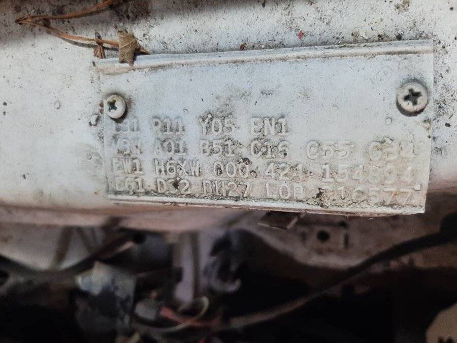

Ok I'm looking at one more car. Needs a complete restoration. It has a fender tag but it has 2 transmission codes d31 and d32? how can that be?
it appears to be white on white on white?

It can't be a D31. Has to be between G and R somewhere.
I would assume M31 for moldings of some sort on a vert. I dont' have my code book with me at the moment.
I sure wish a BH 27 0 would show up with M46 on the tag. I'm always looking for M46 on the tags. That's what I collect. WANTED: 1970 barracuda with M46 option in Cars For Sale or Wanted

That sure is an awesome car, especially for a vert. I prefer white on a vert for some reason. And a triple white is sweet. Of course, xw is black and white. But still.
