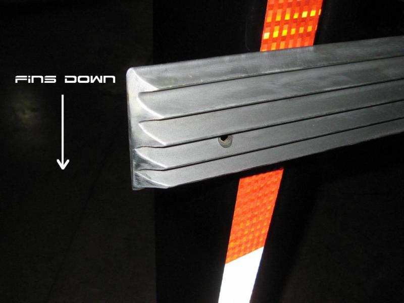

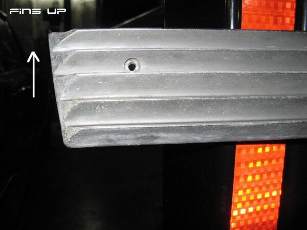

Help.....I'm restoring my 70 Barracuda Gran Coupe and require assistance in determining which end is up. Somehow I neglected to take pictures of them during the disassembly. DUH! Do the fins get installed up or down? Thx in advance.

So far I've had three guys say up and two down. I'm hoping to find an unmolestered Gran Coupe with pictures that I can rely on.

Use the mounting holes as your guide. They are off center so they will line up with the holes in the rocker panel only one way. Fins down so mud and other debris won't stay on.
