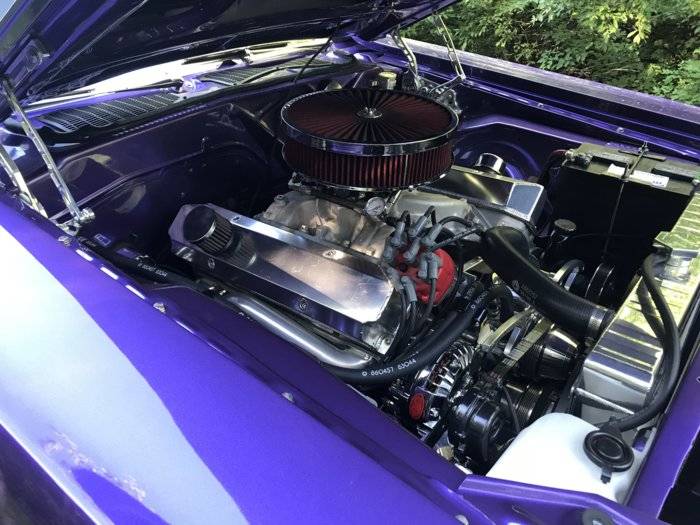

having heaps of trouble adjusting hood hinges tried all the install guides either too high at rear and can push hood down by hand or to low
anyone used ringbrothers hinges if so do they take this ply out of the hood

I have ring brothers hinges . There is no play up and down on back edge. (When tight)They cost like 3times what an original set cost. Like Rich said you shouldn’t have up and down play with everything tight.
as you said ring brothers hinges are 3 times the price. are they worth it? are they easier to set and adjust position
rbbruno3
Jan 1, 2011
1,679
381
upstate , NY
They were for me as my car is not stock and they look much better. They have all the same adjustments as stock hinges. They are not hard to adjust, just need a couple extra hands
