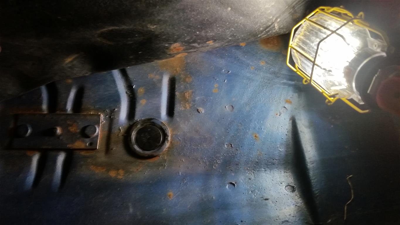

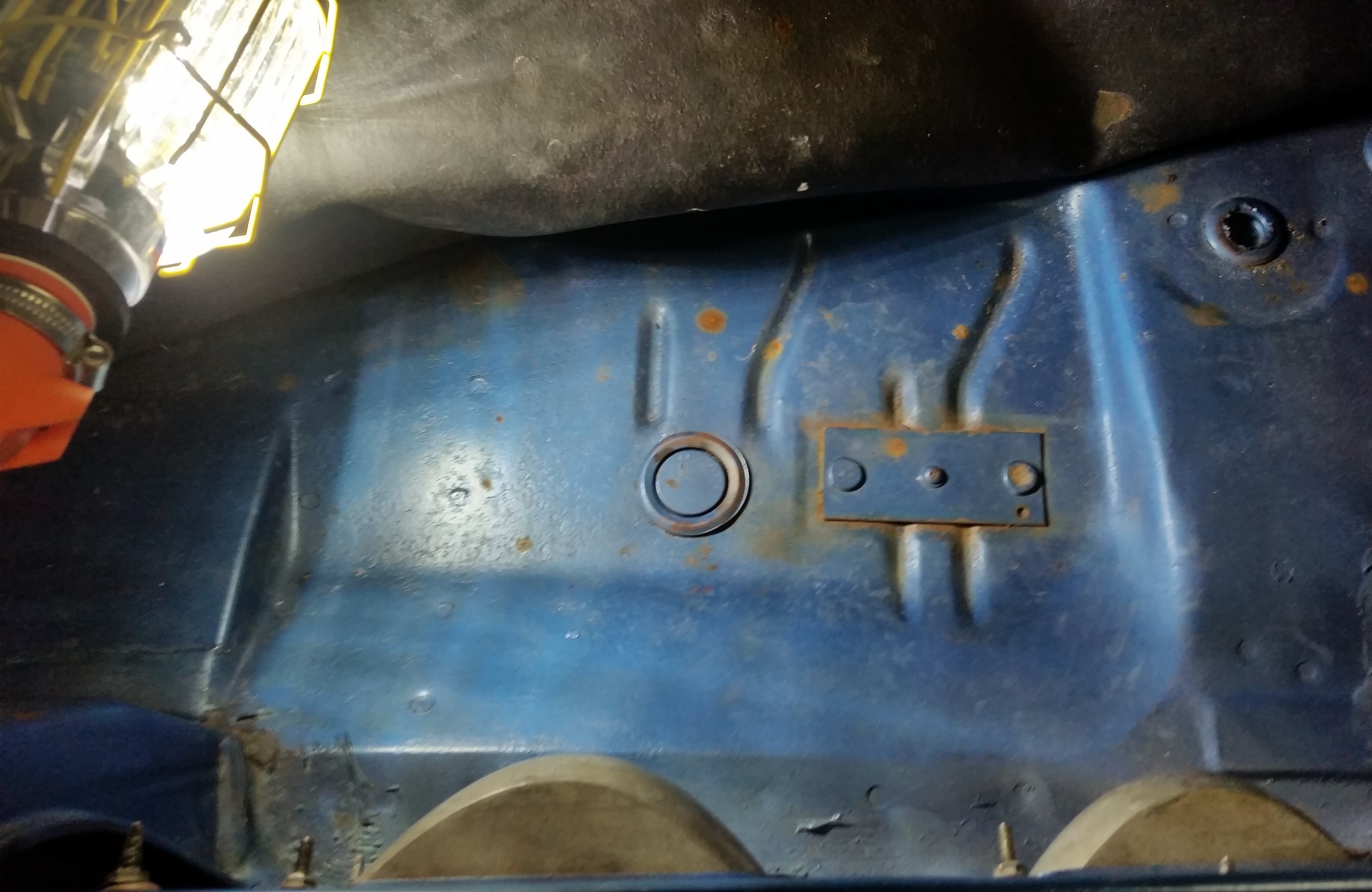

Going to install muffler heat shields Challenger. All the sheet metal and paint is done so I don't want to hose this up. My trunk pan is new. I bought a kit and believe I need to put two doubler plates on the inside of the trunk, but I don't have my old pan for reference. Any help is appreciated.
My 71 Challenger trunk pan photos. Left side and then right side of brackets.
Terry W.

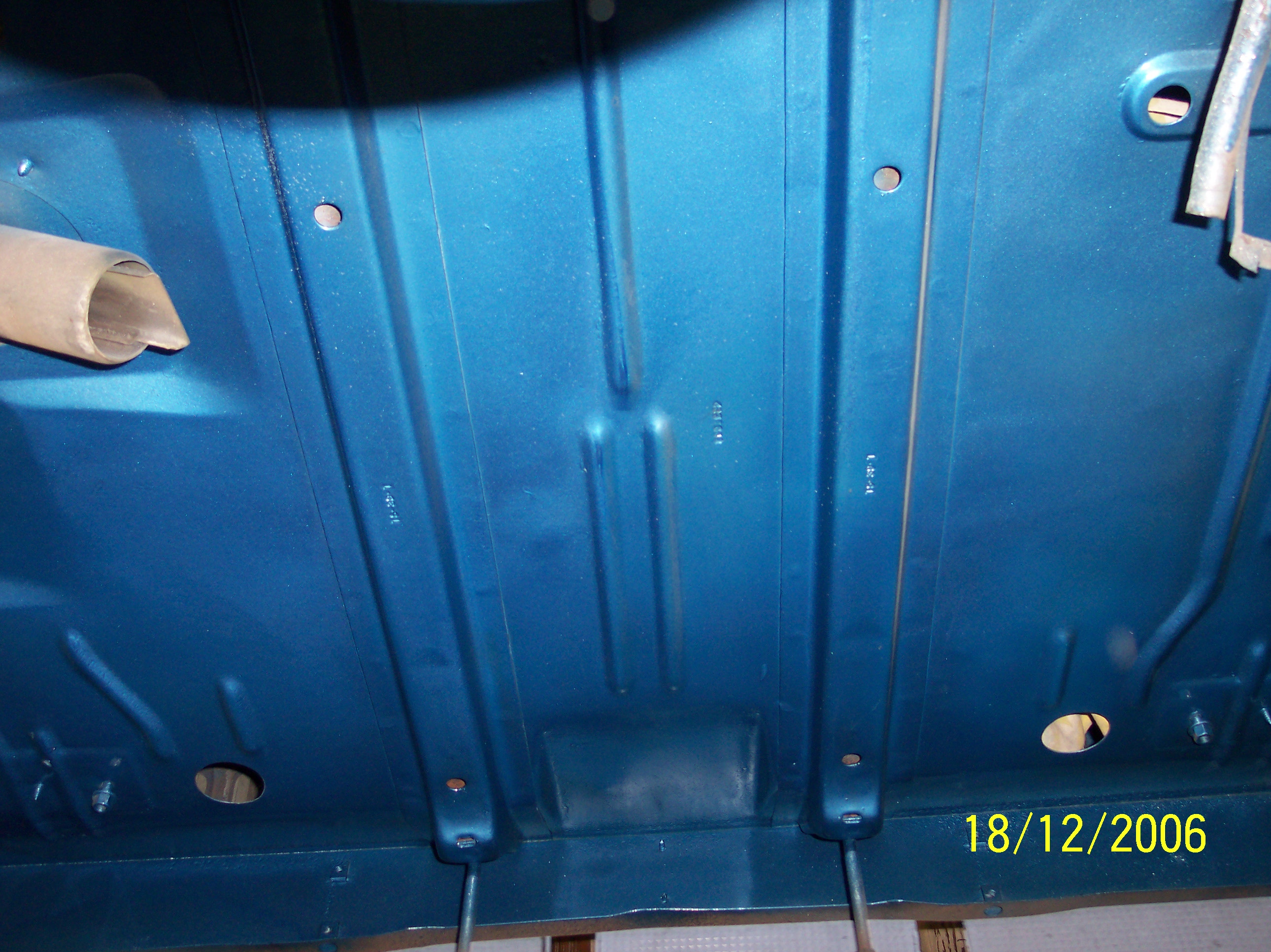

Thank you Terry! Extremely helpful! Do you have any pick of the heat shield attachment?
Mark
Sorry, I do not. Two screws go into the rear frame rail. The front one bolts to the rear cross member piece and the rear attaches to the brackets using nuts. Once you get the two brackets installed and hold the shield up in place, you will see where the holes are. Maybe someone else has a photo with heat shields installed.

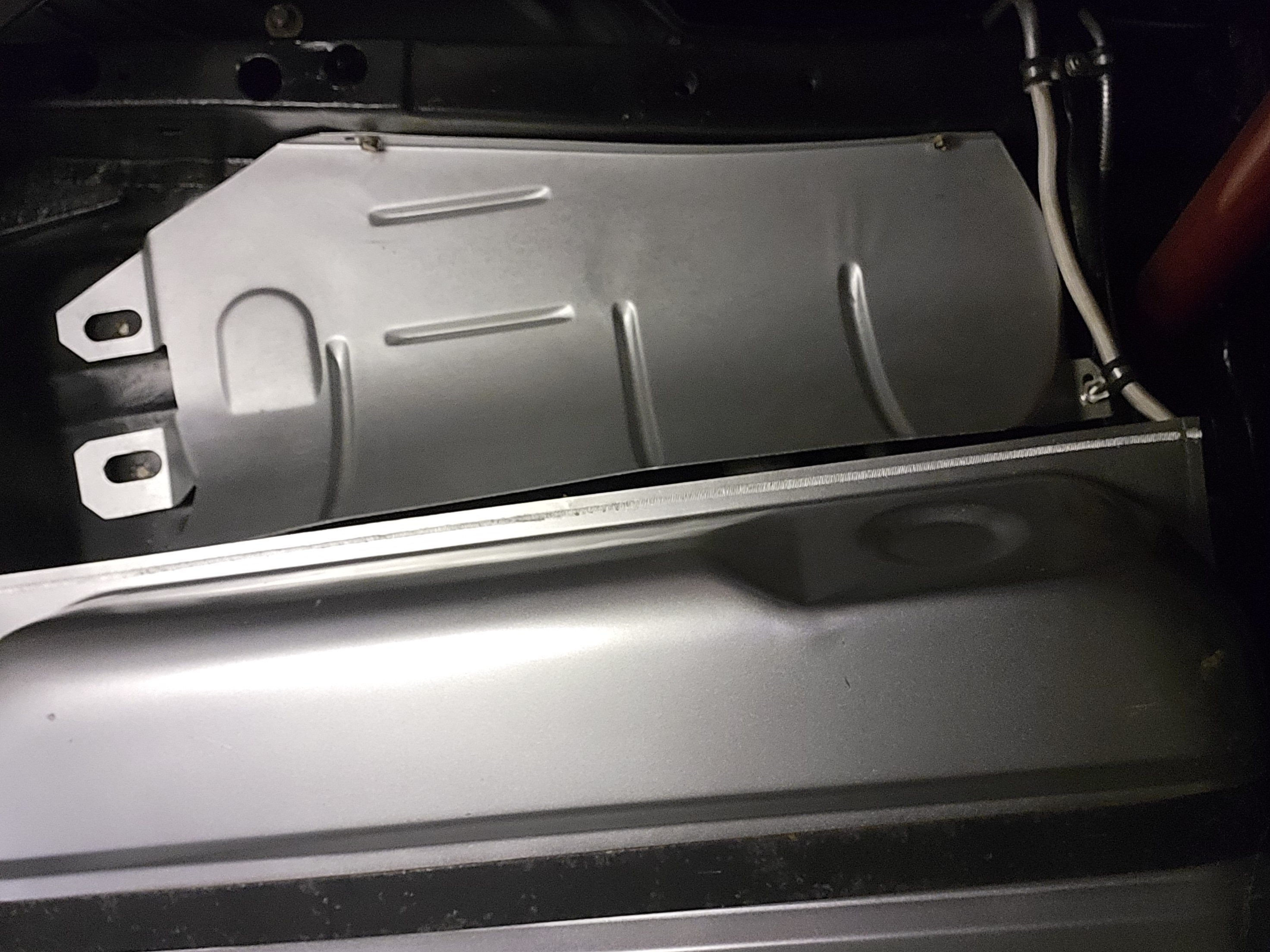

This was just a radon shot. Hope it helps.
I thought I had a pictures of the heat shields installed. If I find it I'll post it.
Terry W.
Exactly , hope this helps
