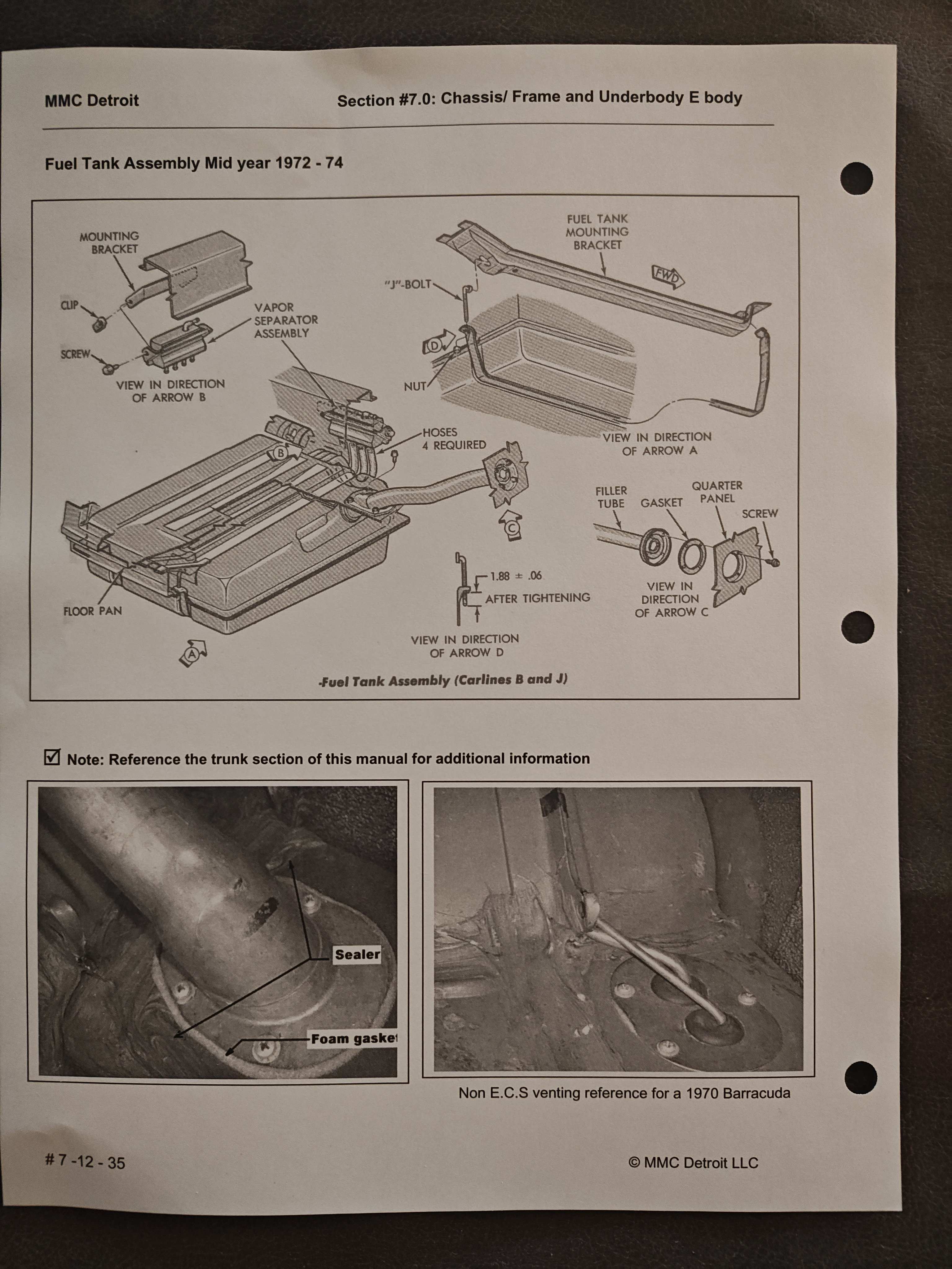

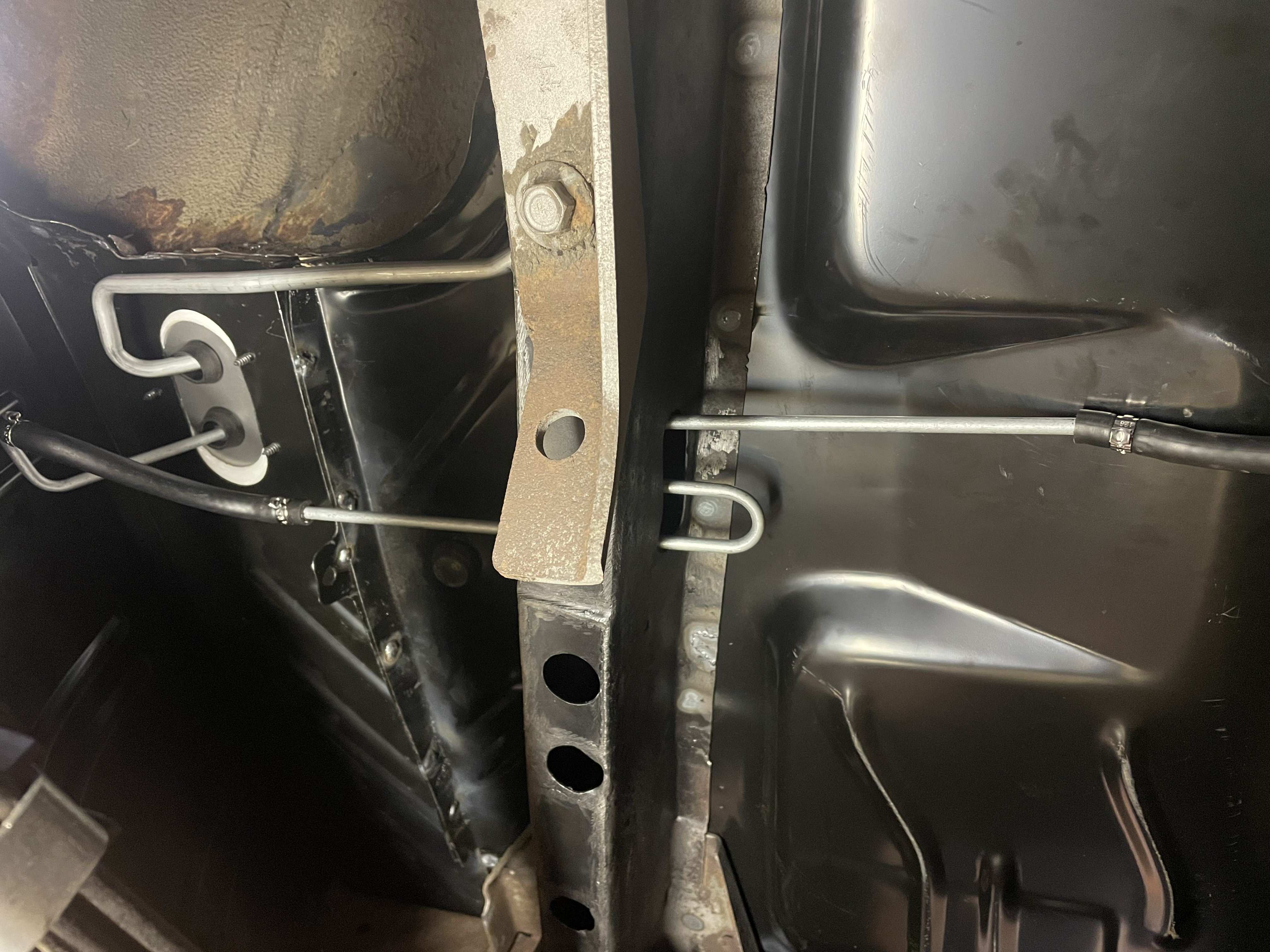

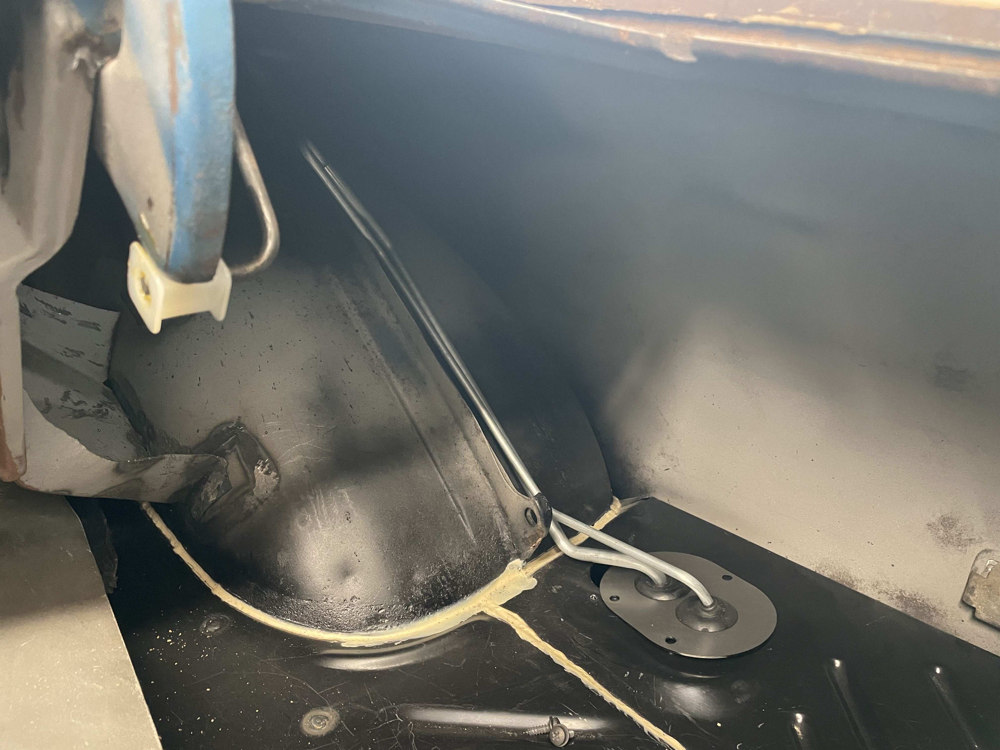

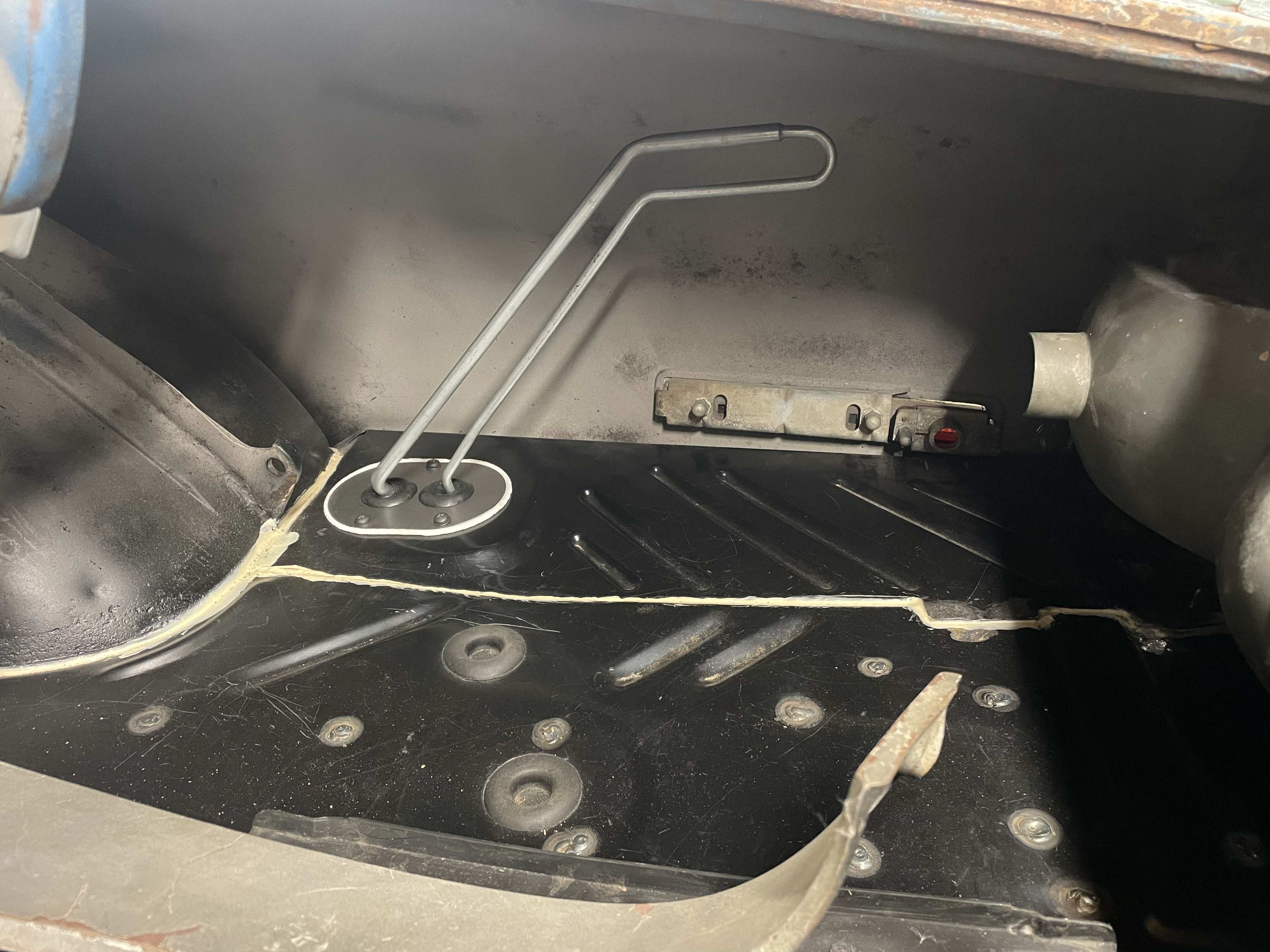

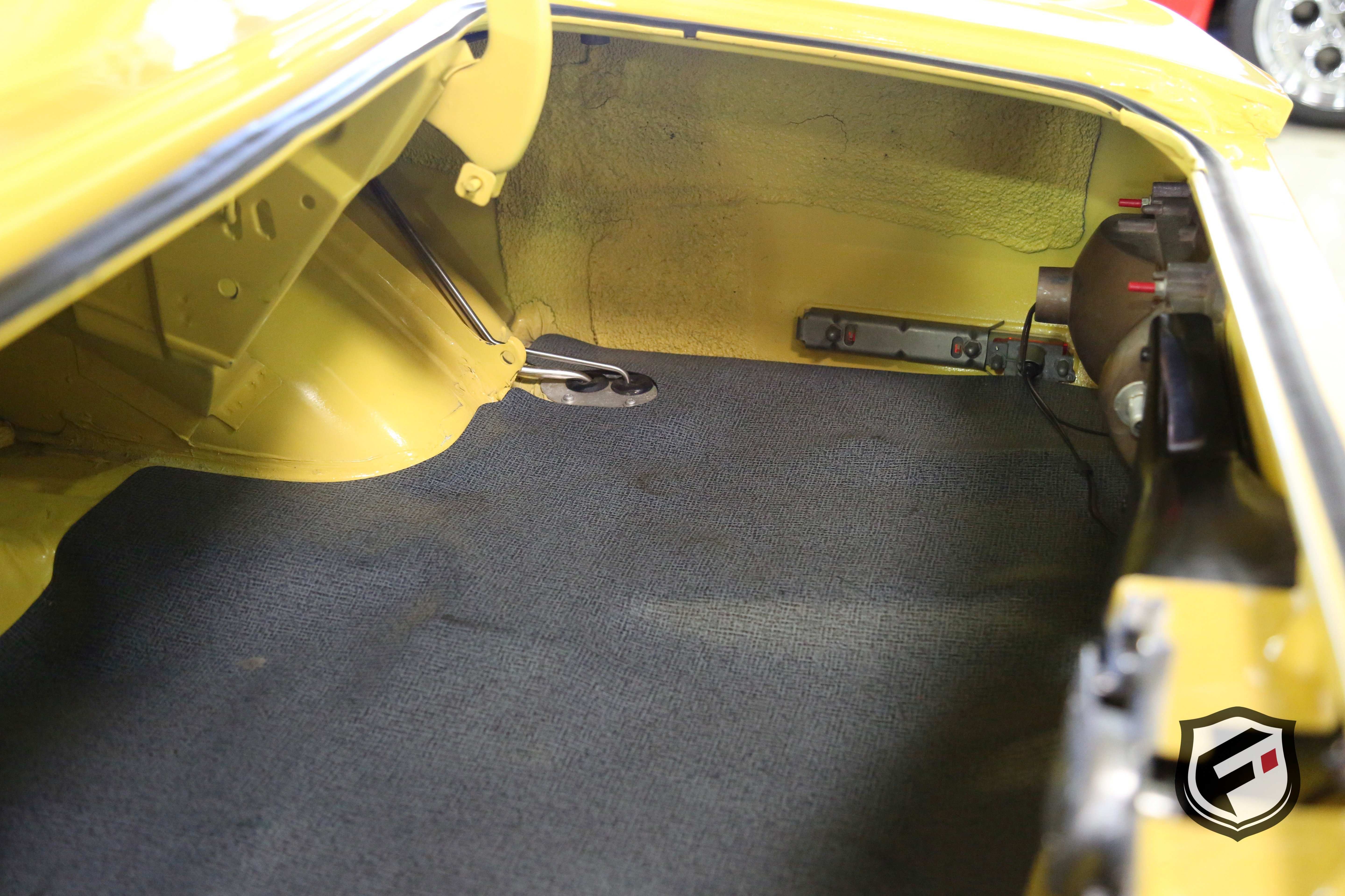

Just plumbed all of my fuel lines. I'm working on a non ECS car with 3/8 lines and need someone to verify if this vent looks correct in the trunk or if I've ordered the wrong vent parts. Thank you!
