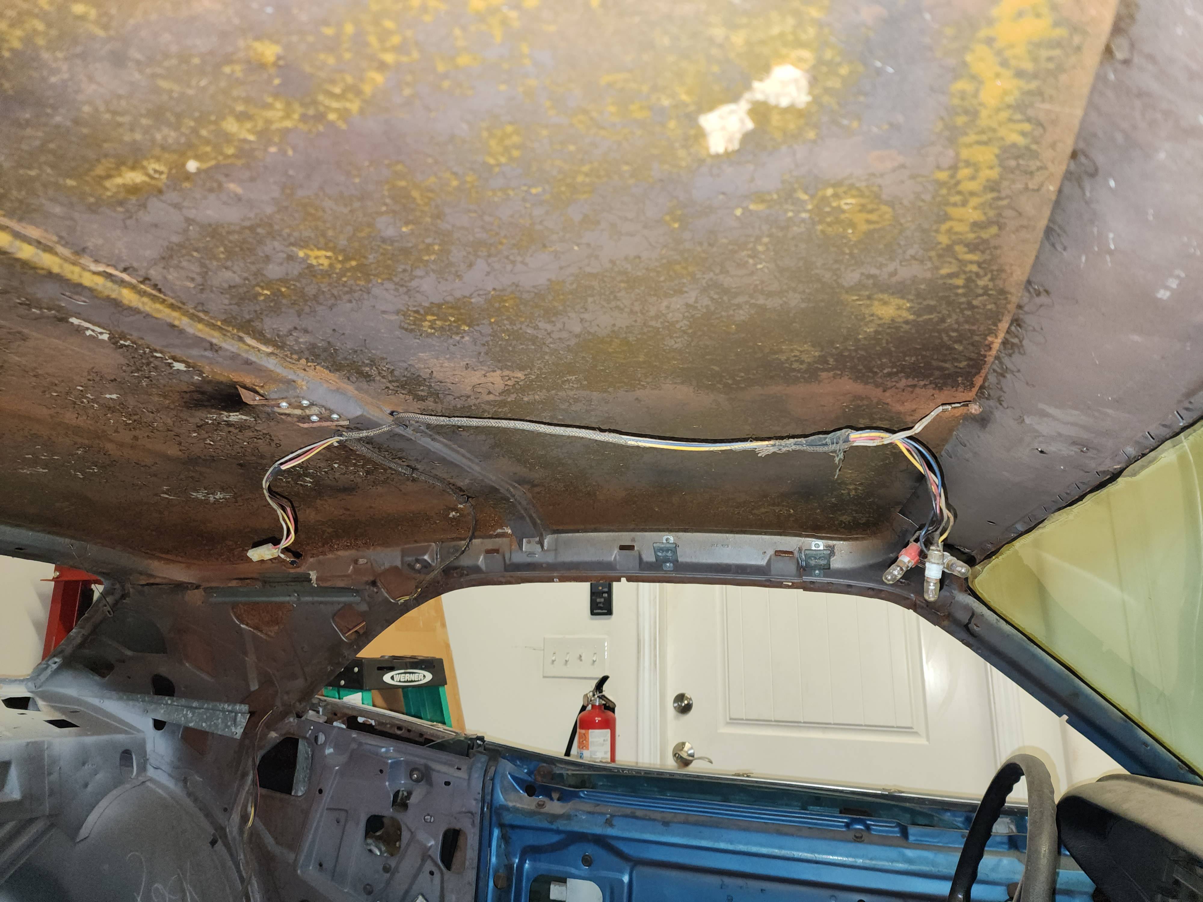

Hello, just so I can make it correct, does anyone have any drawings of how and where the overhead consolette wiring should be routed along the frame ? Thanks in advance

From memory, the wiring exits the rear-most position of the upper console and routes directly to the left driver side edge (following the roof frame) of the headliner. It then turns rearward along the roof frame, and then down the (C? pillar) behind the left driver-side sail and rear side panel, on down to the lower part of the floor, turning forward into the wire channel that runs along the left side for the vehicle. It continues forward toward the parking brake and then up behind the left kick panel where it plugs into the wiring harness behind the dash.

Here a pic of how my 70 SE wire was ran. Should be same
