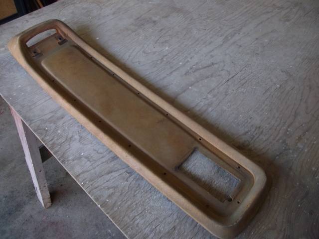

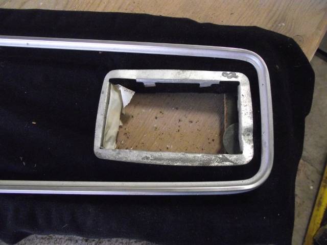

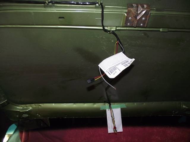

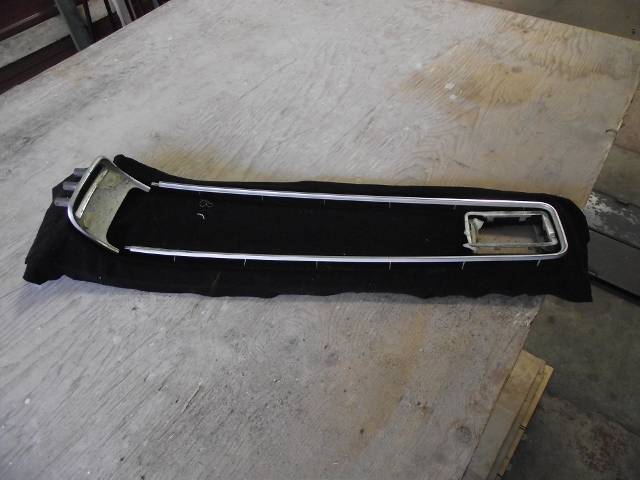

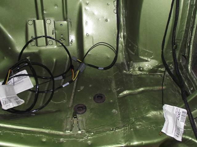

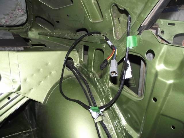

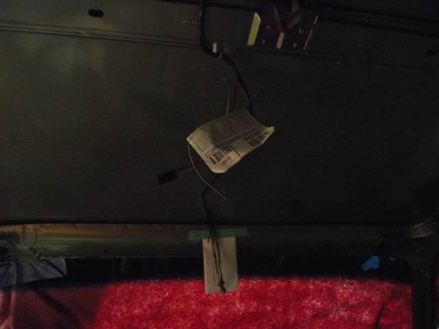

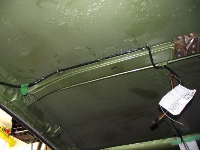

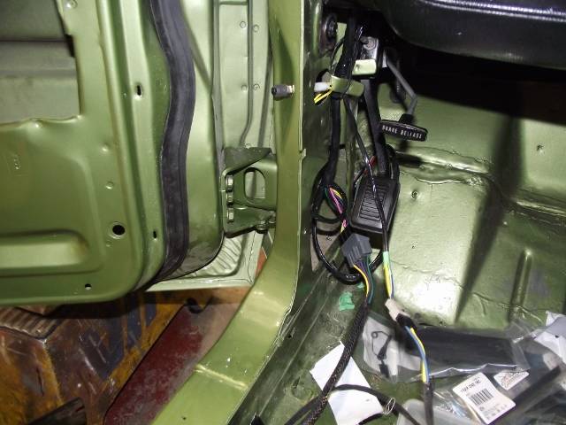

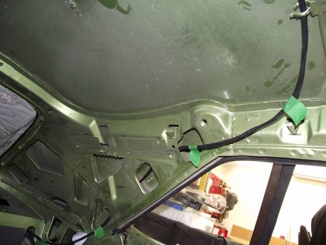

On my Gran coupe the wires for the overhead console, come out of the wire harness on the drivers side . There is a plug connector up on the wheel well. This then goes upward under the sail panel and then across the roof support in the center of the roof, to the center then strait forward toward the windshield.

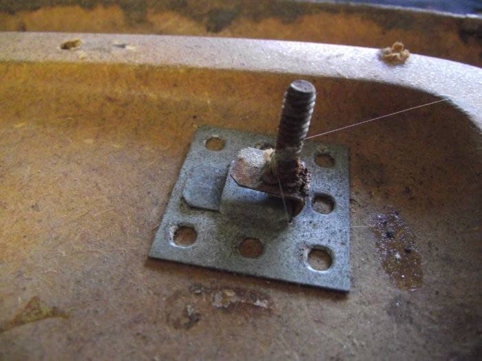

Not sure how you are going to attach it up there ??? . I will include some pics of how it is mounted. Hope it helps.

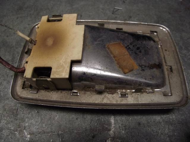

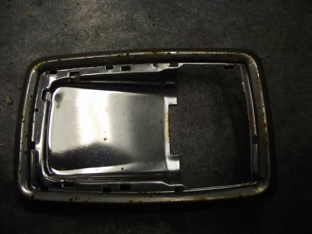

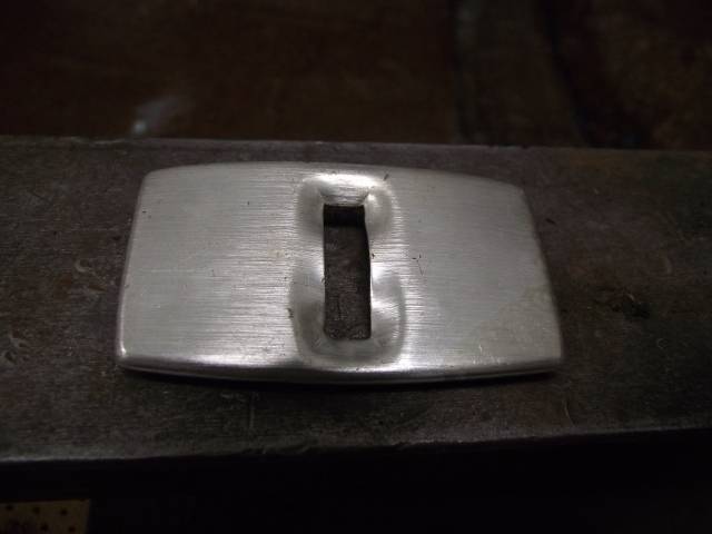

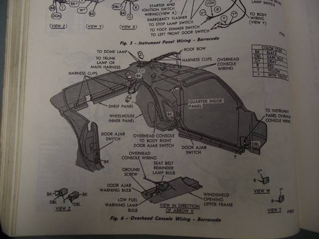

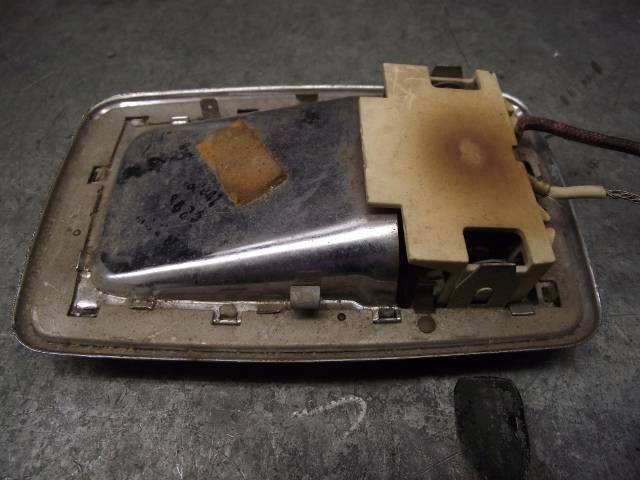

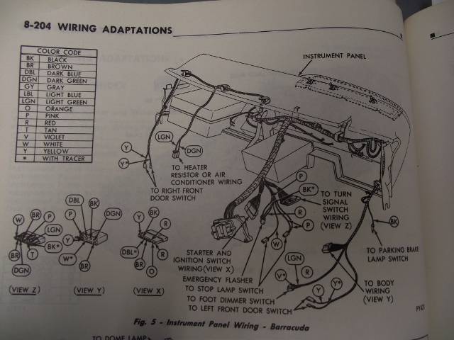

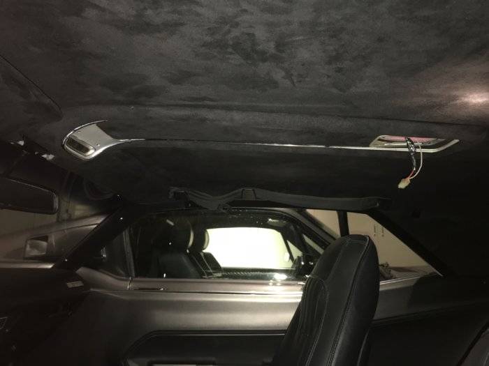

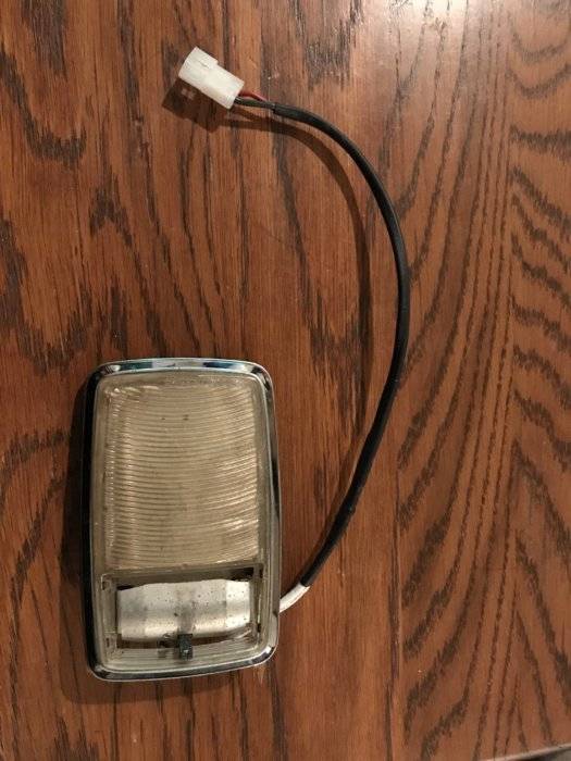

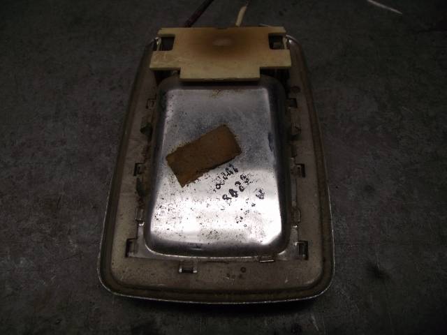

Thank you Doug and 6pak, you guys are awesome. Those pictures will help A LOT with the wiring. Can you tell me what manual that is out of? It would be worth it for this project alone. I think it looks great but it looks kinda funny in the picture. I forgot to take one when it was in the sun. It seems that my dome light is missing a cover of some kind that goes over a sliding switch, know where I can find one?

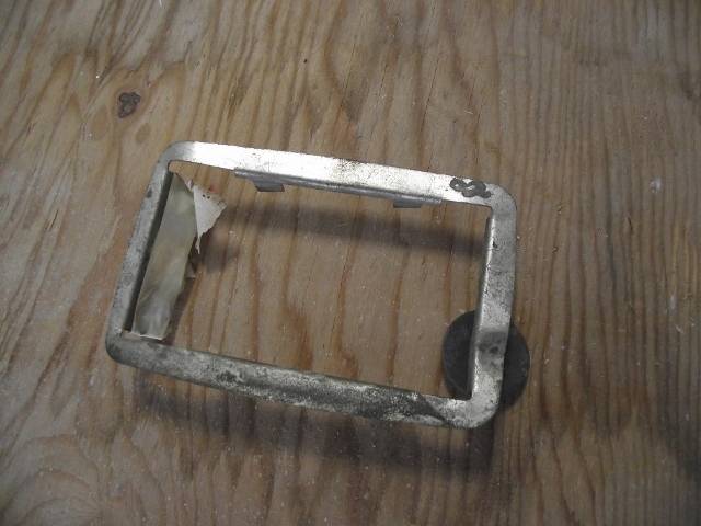

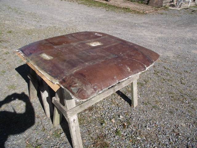

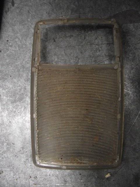

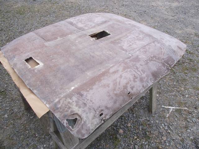

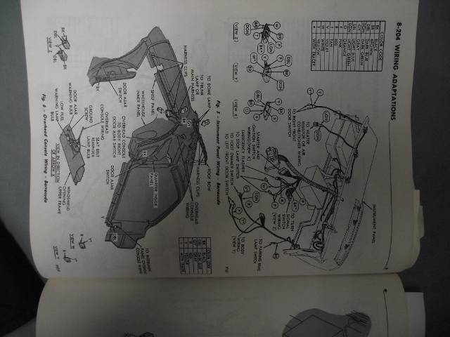

Good morning . Pic # 3 is the starting piece that goes into console first, painted gray. Pic #9 is the cover for over the switch you speak of. The new lens I got from Dante,s Mopar in NJ. The rest of the pieces your best bet is ebay. Or a place called Mopar City, Oregon IL. 815-732-7751. These are really nice people, they have a large salvage yard for mopars.
The wireing pics are from 1971 Chassis Service Manual. Section 8, page 204. Yes the pics not great. I am not sure if all the plugins are on all wire harnesses or not. I bought all new wire harness for the Gran Coupe model and the connections where built into the harness

Looks like the complete dome light is missing. You can find them in some Plymouth Fury's and Dodge Polara's also. I believe it was a deluxe interior feature. It is the same light without the console. It will mount in your console. Otherwise you will be looking for the SE light that most people overprice.

I think I have all the pieces except for the cover in the last picture and the bulb. Good to know about the Fury and Polara, I'll have an easier time finding one of those. Appears no one seems to stock the bulb anymore so I'll have to look at some old stock suppliers.

The bulb was discontinued. I found some and bought them years ago. I would go with the l.e.d. The original bulbs got hot and burnt lenses if a pin switch failed.
