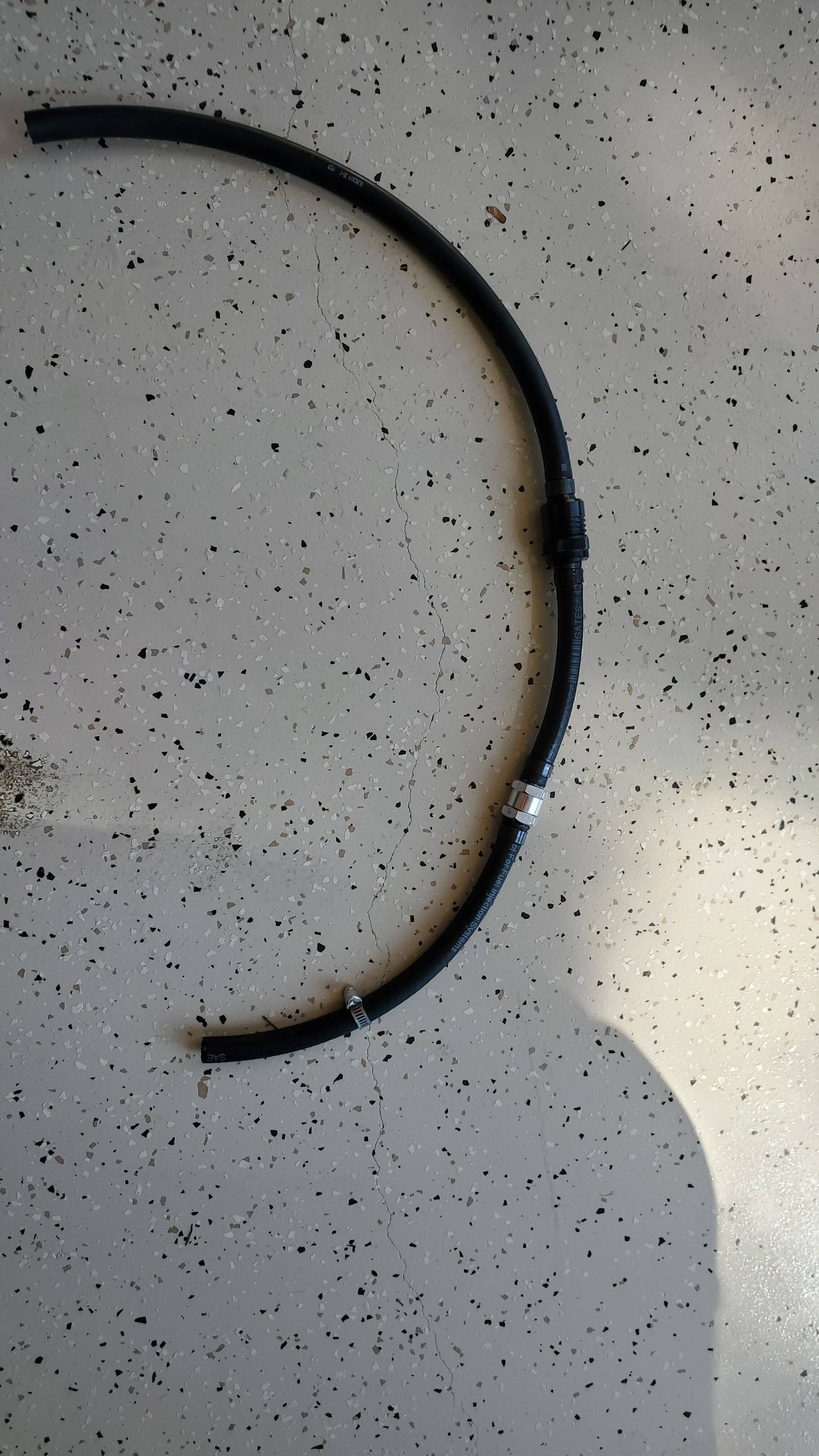

This is what I came up with. A one way check valve and a filter. Also I used a 1/2 inch pex fitting on the hose so there is no clamp with screw. Nice and clean look

On the 4 lines they each go to a corner of the tank. One goes to one corner and another one goes to another corner and so on. On a 71 the 4 lines went to a vapor tank in the trunk. On 72-74 they go to a smaller vapor tank mounted on the shock cross member. The vapor tank then has a 5th line that ended up at the carb where the vapors consumed with the fuel mixture.
Just connecting a hose to one of lines might result in fuel spilling out of it. I'd find a vapor tank and go that route.
