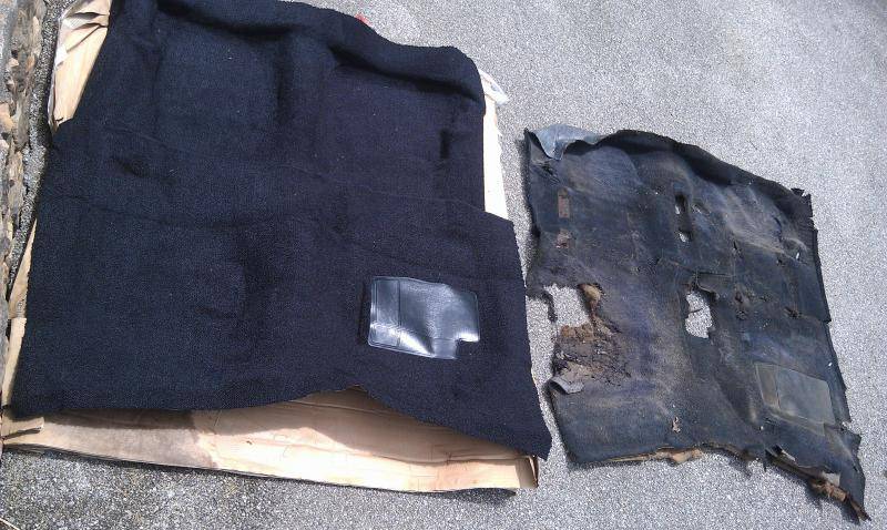

Got disgusted, tore everything out and threw it away. Ordered ACC carpet from RockAuto.

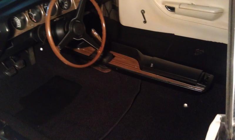

http://www.rockauto.com/ It also came in the same size box as the OER and on a 10 degree day but not in a bag. Opened it up and looked at backside and it also had the pad bunched up in a couple places from not being glued properly. :banghead: Cut all pad off. Laid sections of pad where needed. The ACC carpet was formed properly and laid a hellva lot easier without need for steamer. You will need to remove the chrome from the base of shifter and just pull the boot up. In order to relocate the holes under the carpet, I first used an ice pick to find them. Then I heated a nail (held with vice grips) until it was almost red hot and pushed it through the carpet. It left a very clean hole for the screws. Where the shifter goes when you think you have it located, cut an large X in that area. Then you can trim it better and if need still glue down if you went too big. Even though its not cold out now, when you get the carpet you should still allow it to lay for awhile. Preferably outside on concrete in the sun. Also, if your seat bolts do not extend down plenty, you might need to remove padding/mat from the area the seat contacts the floor.
Start in the center and work outward. There is extra that will be cut.
