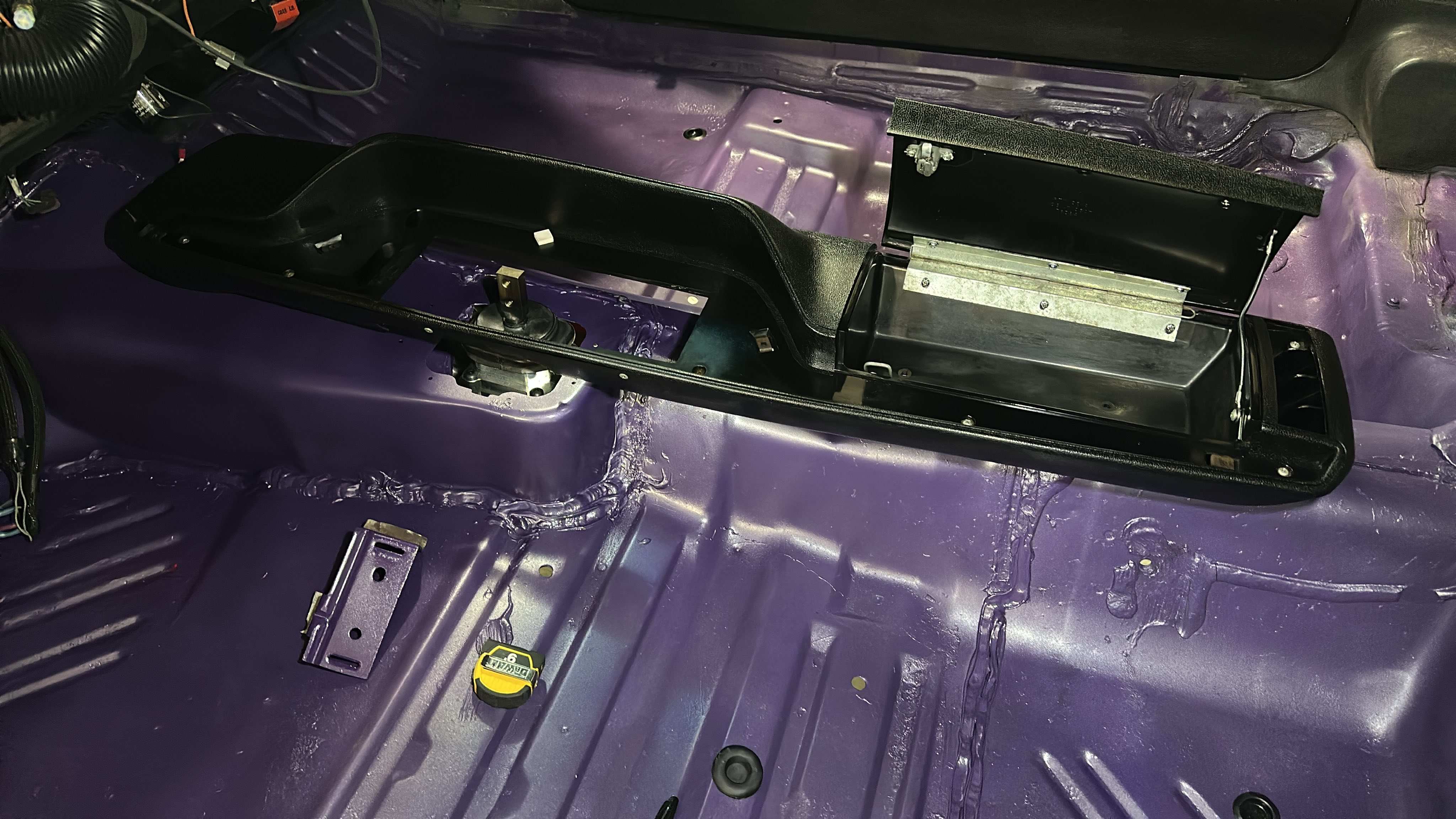

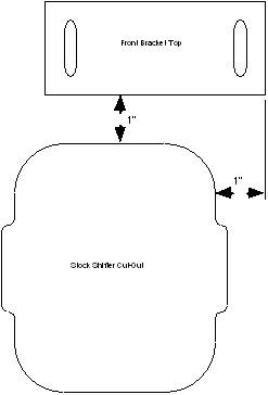

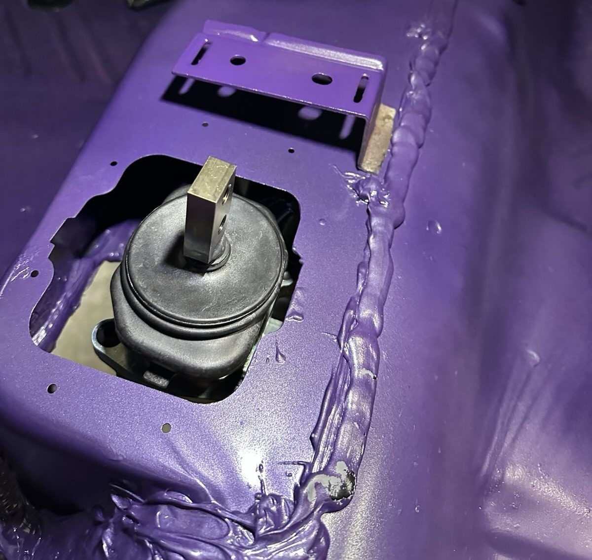

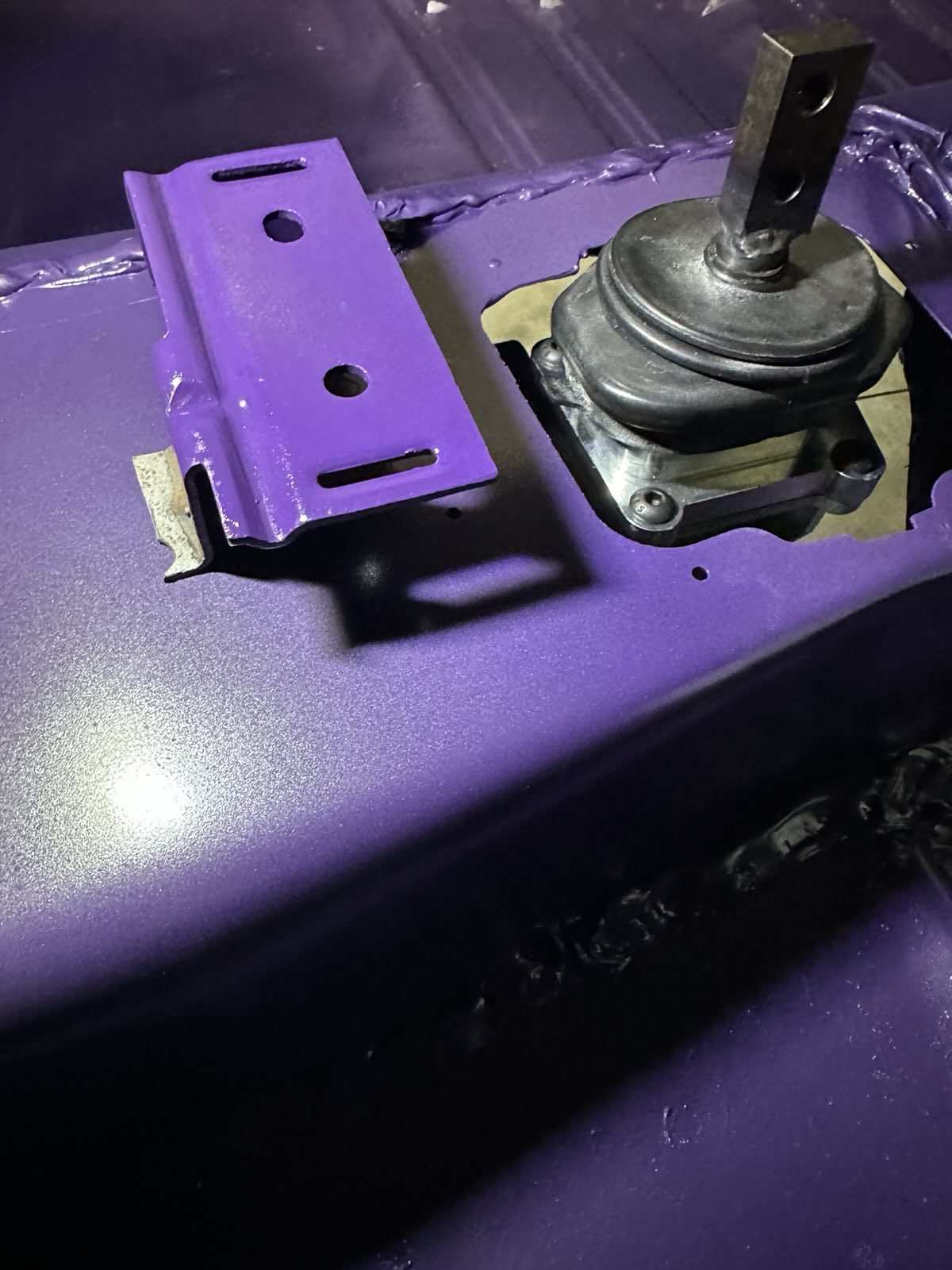

Questioning the exact location of the manual transmission front console bracket I purchased from @NixDad ...
Here is my mockup photos before prepping the tunnel for welding the bracket to the new tunnel hump plus a diagram from the ole Interwebs.
I also measured the console itself for spacing to center the front screws in the bracket's slots at the front and the rear.
I am not sure how precise these were done on the assembly line so I am hoping there is plenty of room around the shifter boot/console top plate for some minor deviation.
Thoughts?
