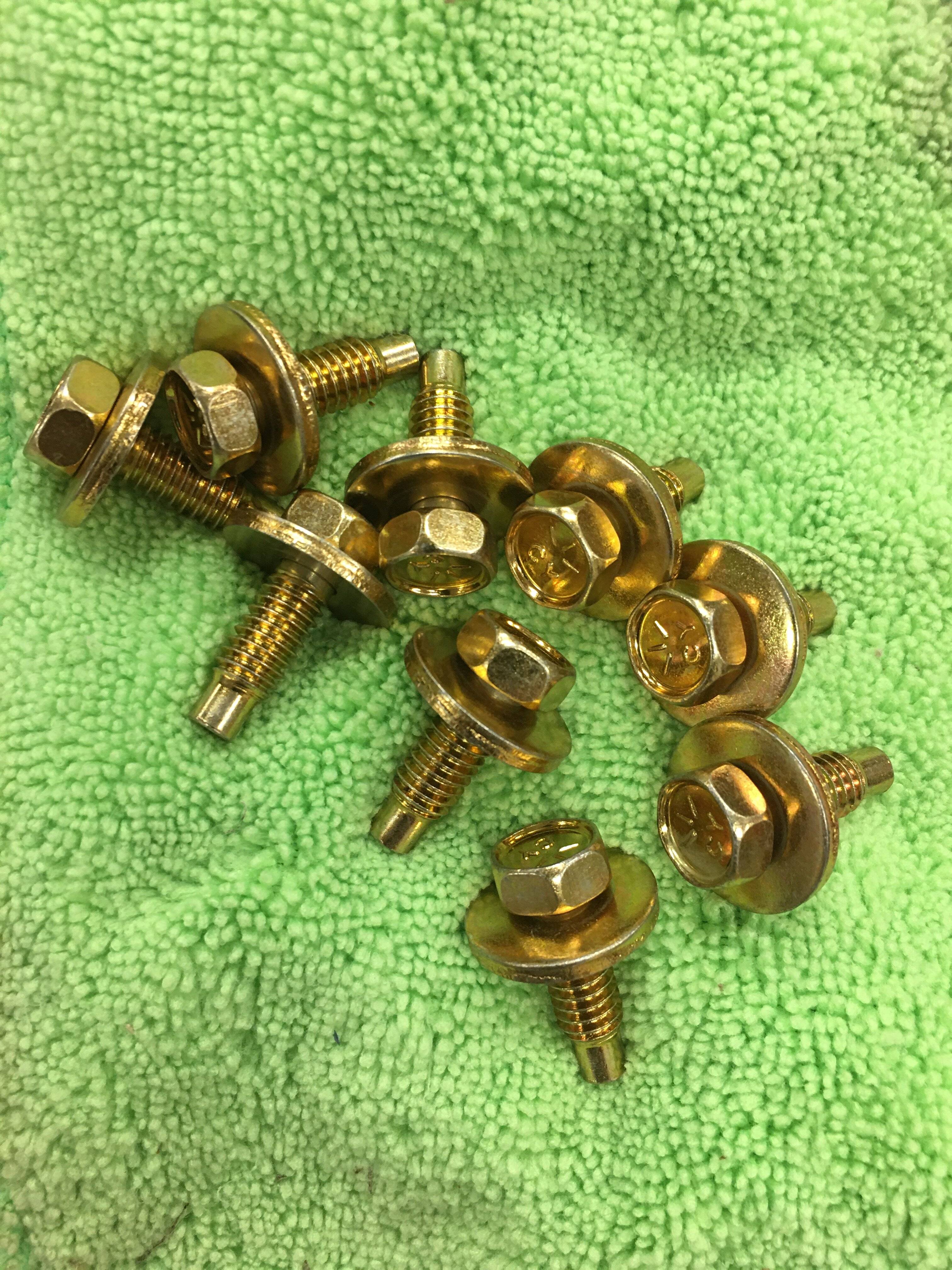

I know you’re searching for a stud but, have these from a previous restoration.
No stud/s though.

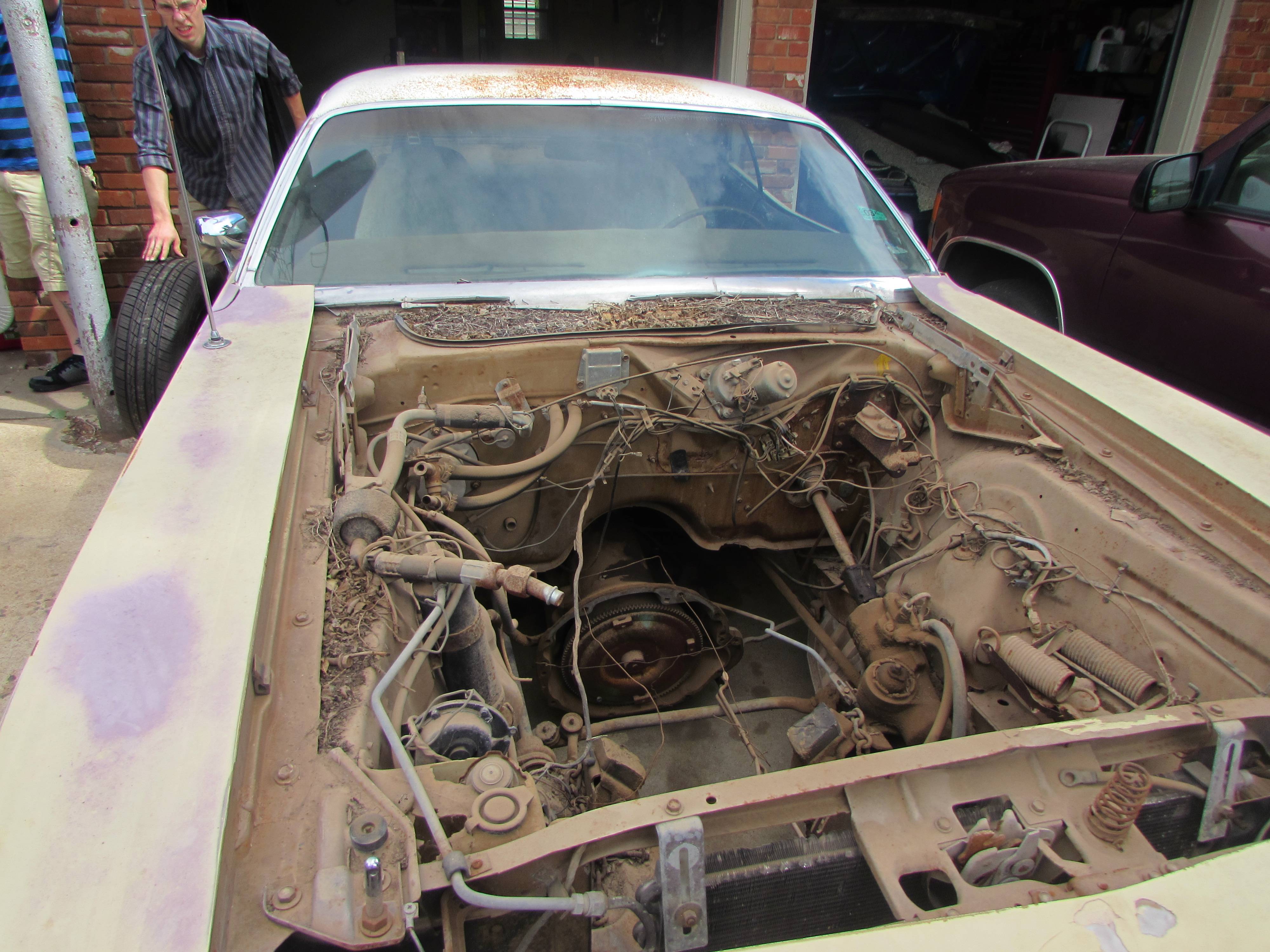

I just stripped down my 74 cuda and it had three studs on each side. In the middle locations. This car had never been apart before so I can guarantee it came from mopar this way.
