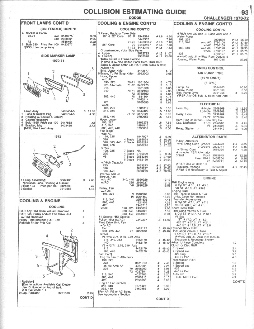

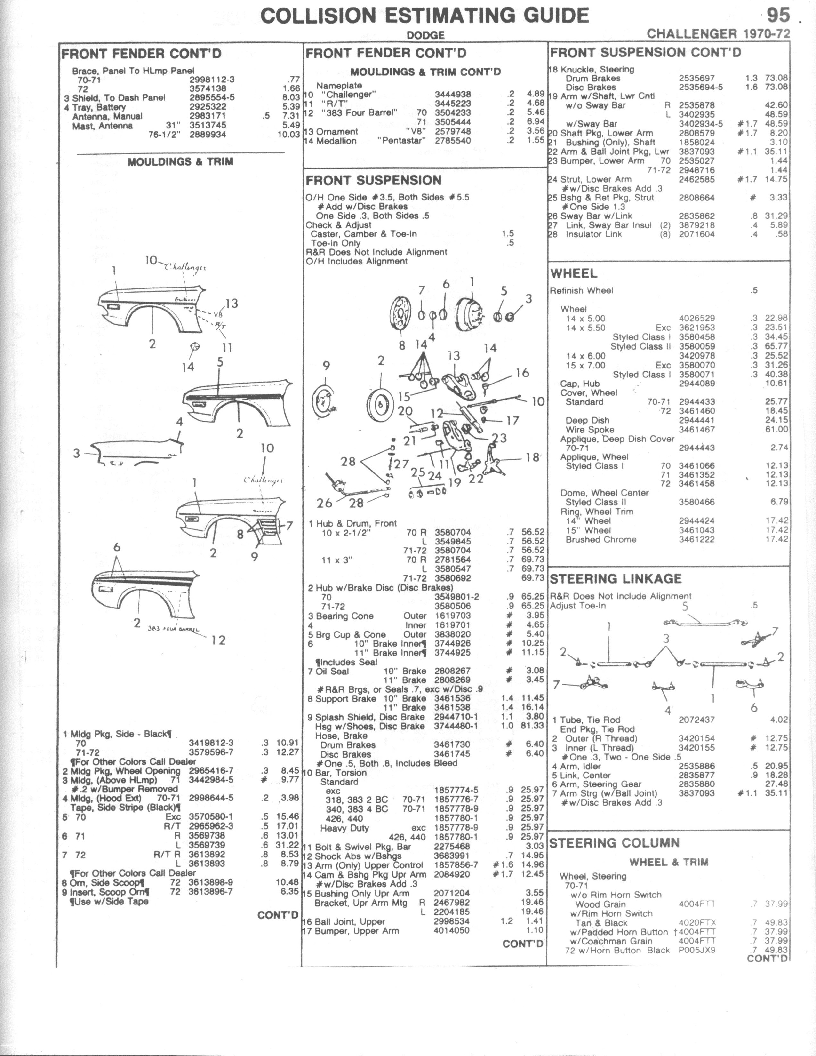

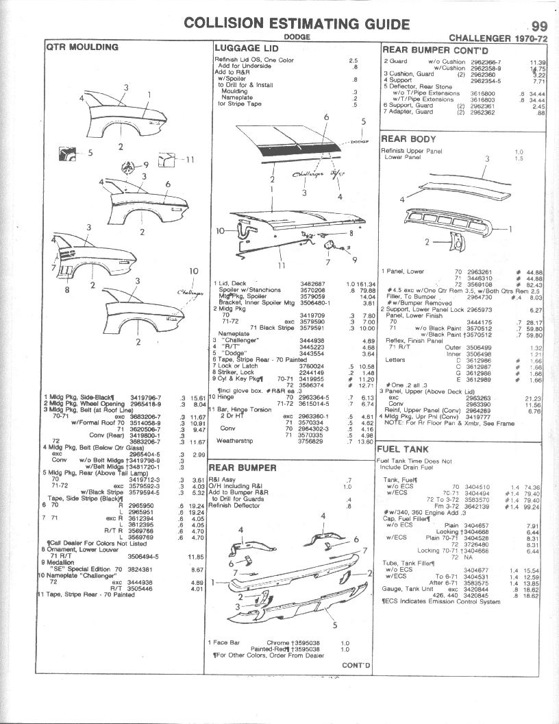

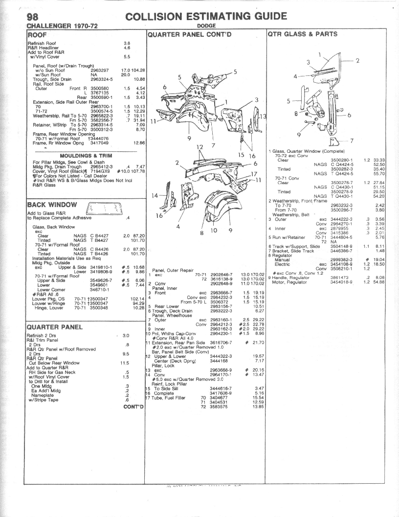

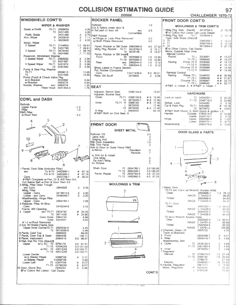

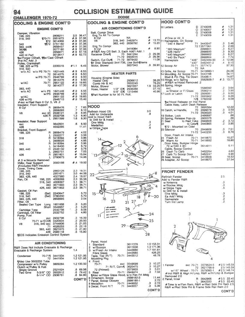

71 COLLISION GUIDE PARTS Some years parts are different.

It used to be in a large catalog and the pages you wanted were gone or unreadable. Now you can keep everything like this on your pocket phone. backup to a drive.
