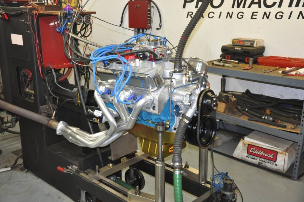

I have a 73 Challenger that came with a 340. I also wanted to keep the block size but increase HP. Mine bored to .04 over, 4.00” crank, Hyd roller lifters, Edelbrock Al heads and intake. Dyno on machine at 430+ HP and 490 Ft-Lbs. Did not run over 5000 RPM during test. Engine is in the car now but restoration is not complete. I have more specs if you need anything. The engine was built by Vintage hot rods in Chico CA. He specializes in Nitro methane Bonneville cars but liked working on a small block for a change. Picture attached.
