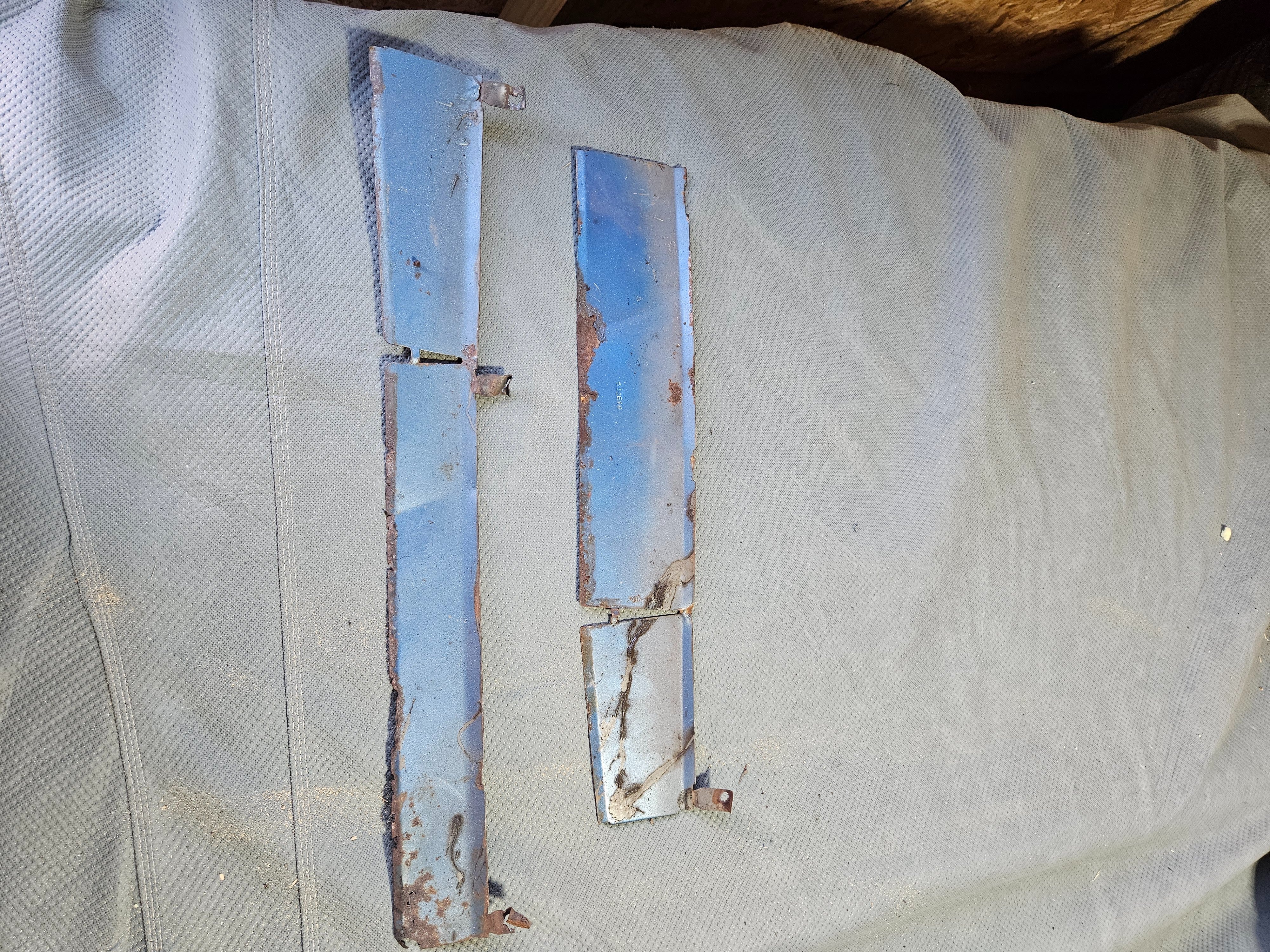

Can someone ID these 2 pieces?\nThanks

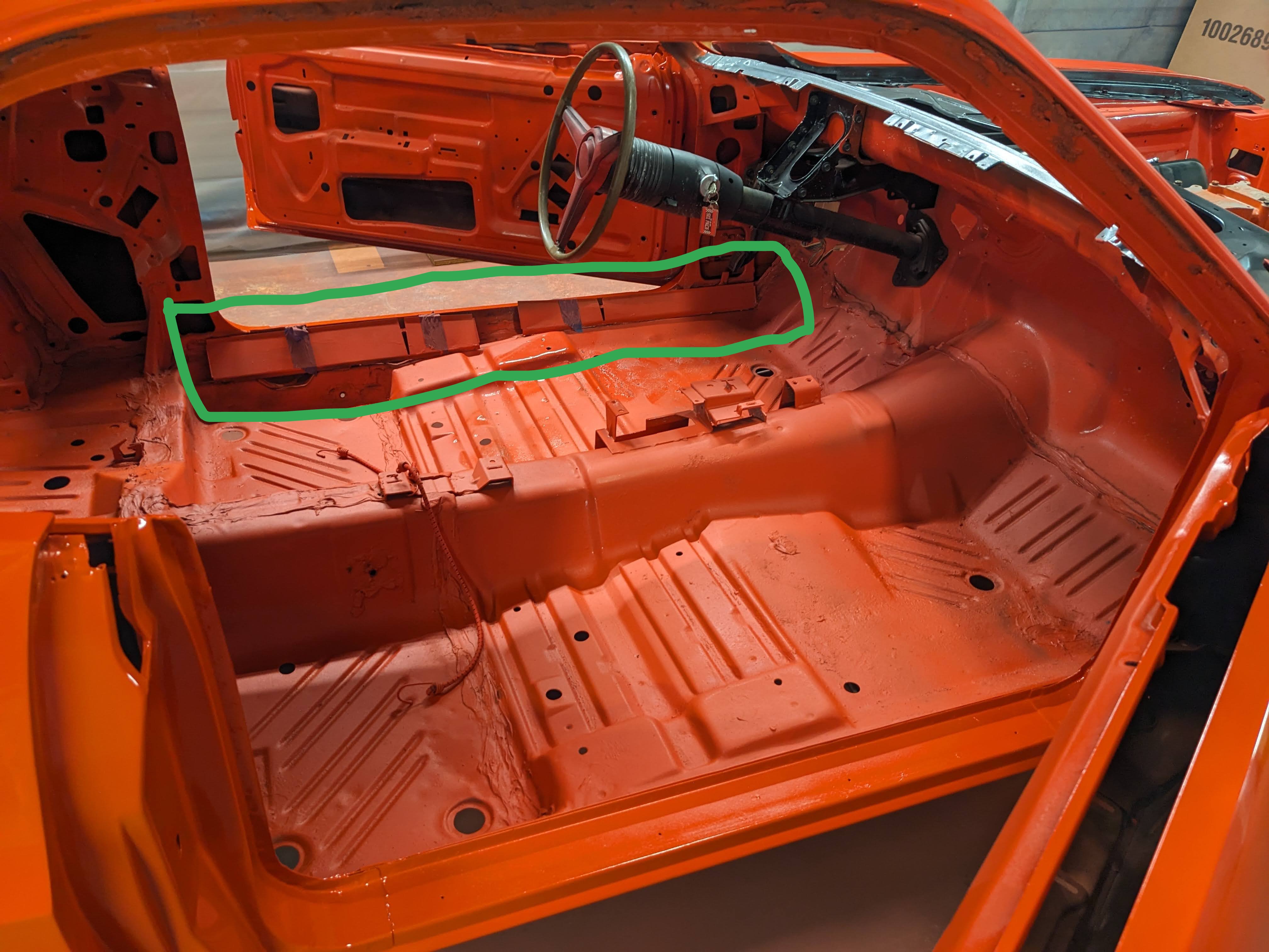

The pictured metal pieces are the wiring shields that mount on the driver side at the sill to cover the wiring harness that runs from the kick panel area to the pack of the car, as shown in the following image:
The shields are welded to the floor at the tabs. It looks like one has been cut off short.
