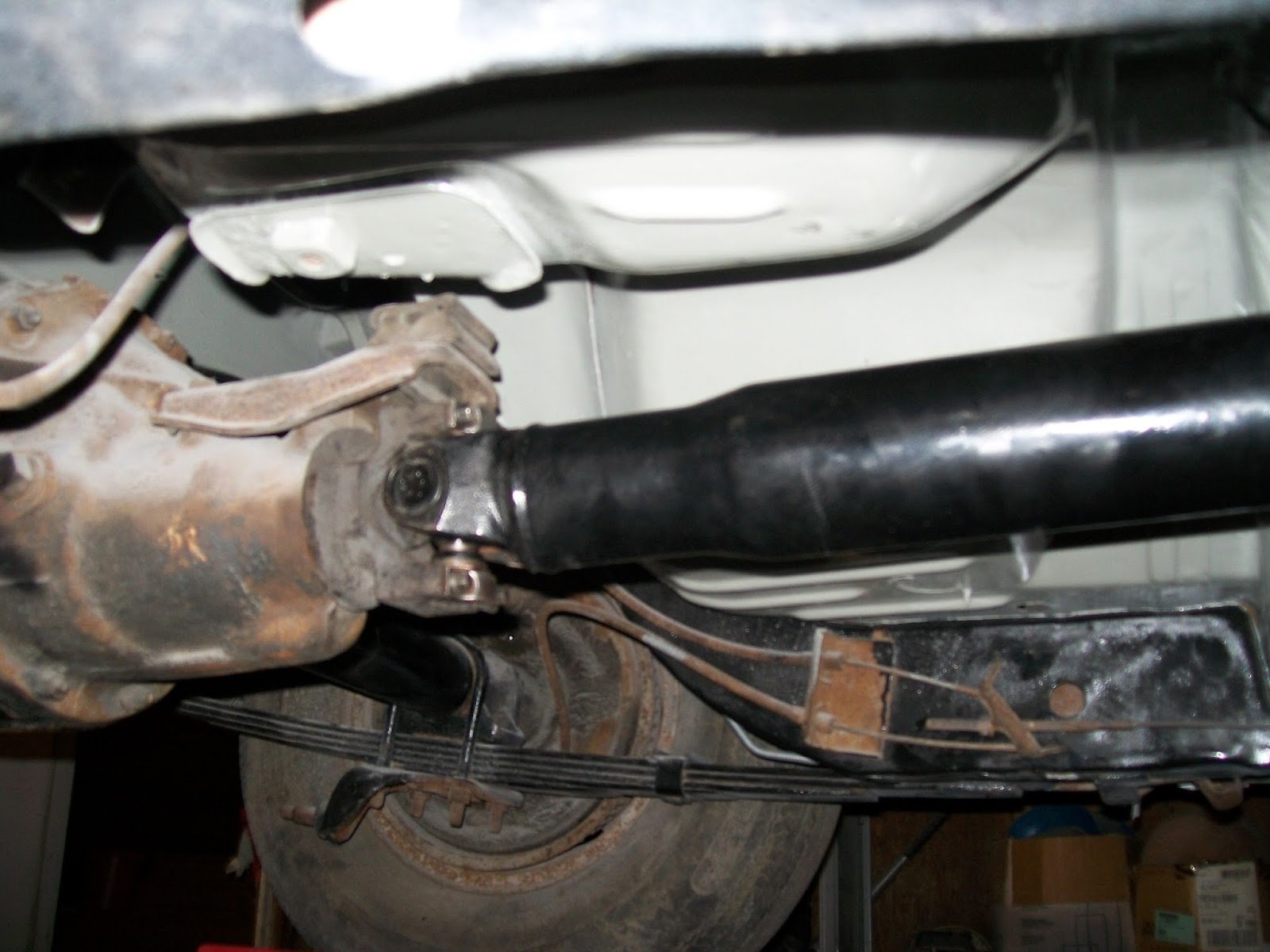

If the drive shaft has one tapered down end, that end was installed to the rear by Chrysler, at the axle, as shown in the following image:
Some propeller shafts, or drive shafts, have one tapered end, some have two, and some have none. Other variations have inertial dampers on the front end or the separation point for the Internal Vibration Absorber (IVA) versions near the rear.

That is correct.The taper end was facing the rear end...
This is how mine looked , but I switched it around the other way with the taper towards the slip yoke at the transmission.. Should I put it back the other way?\nIs the reason behind doing it the other way
