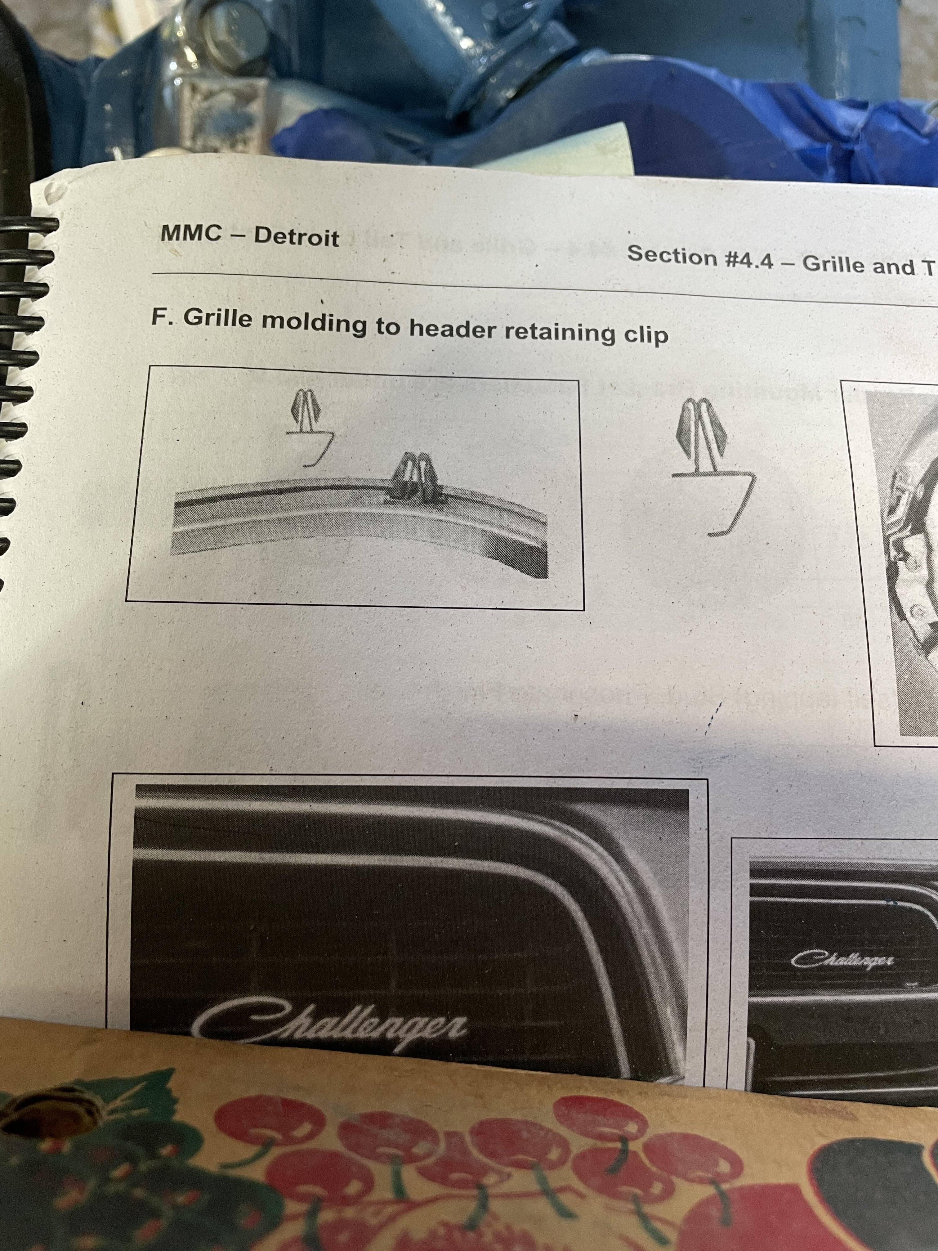

Hello! Wondering if anyone knows what fasteners the grill trim molding utilizes? Can't seem to find any good information on it and am looking to re-attach the trim molding to my 73 Challenger.
Hey everyone, just wanted to follow-up on this. Anyone have any ideas? Attaching pic's of what i'm talking about. As you can see the grill molding appears to need some sort of screw/faster setup looking at the actual molding its more of a track setup. I bought the molding from classic industries and spoke with their sales team. They didn't have any idea on what fastener to utilize either unfortunately

Hey Dmopar, they are a special clip that is not reproduced. I will take a photo of one in my fastener book either tonight or tomorrow. Rumor has it R/T Specialties - Mopar Fasteners, Clips & Hardware has clips that are not an exact match but will work.
Thanks 73Machine! Hopefully I can find somewhere that carries that.
