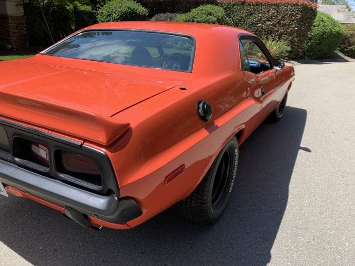

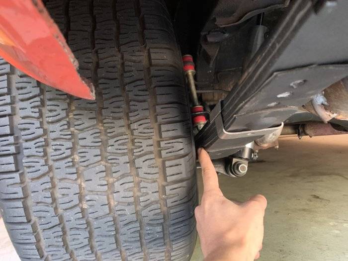

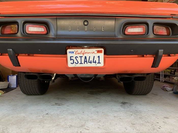

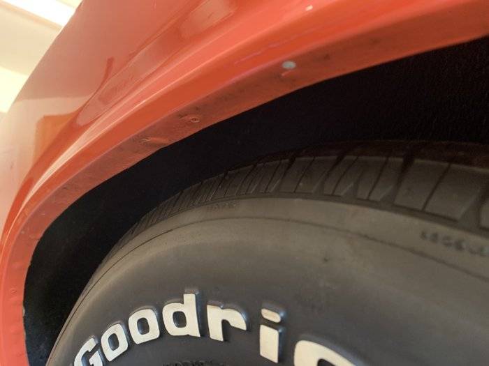

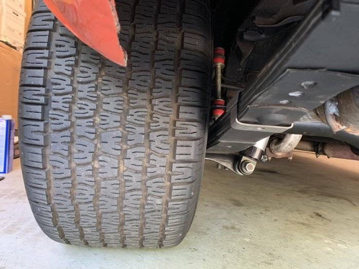

I just recently put 295 50 15s in the rear with 100% stock leaf spring set up and E-body width axle housing. I believe I had 5 inch backspacing if I remember correctly. It does indeed fit! I had to do a very tiny amount of grinding on the inner fender seam on the passenger side, but I think that was due to past sheet metal repair--less than an 1/8 of in inch and only in select spots. It's worth mentioning that I think my springs sit a bit higher than stock. Other than that, no rubbing on a street car, but I think you may run into issues if you intend on cornering super quick, as the clearance to that inner fender seam and the leaf spring is a tad tight. Let me go take some pics for you. I wouldn't be the one to ask on the bumper situation, but the previous owner of my '73 Challenger did an alright job on getting rid of the ugly impact bumpers.
Good luck on your project!

For the rear valance you want one for a '72-'74. The main difference is the bracket for the license plate.
