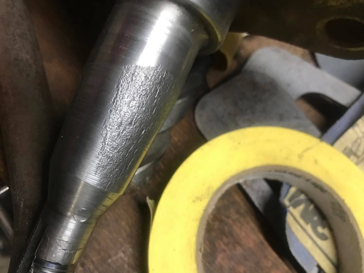

Does anyone have a right side Spindle for disc brake 73 challenger, I have the caliper bracket, just noticed the spindle has some funky corrosion on it. thanks

How bad is the corrosion? As long as its not in danger of breaking the spindle, clean as best as possible. Rotor rides on the bearings, not the spindle. Unless the integrity of the seal is compromised, of course.

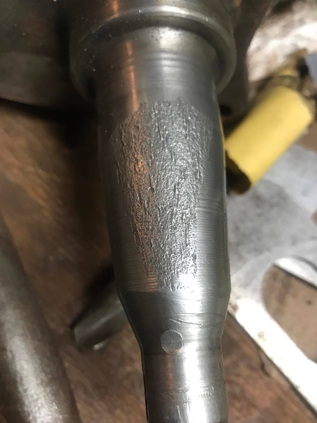

Thats kinda what I was hoping to hear. Whatdya think ? Its actually a strange looking form of corrision.

Looks like some surface area not coated in bearing grease that got some moisture. As long as there are no cracks and the seal surface is good, I'd say it is usable.

That almost looks like the original forging didn't get cleaned up by the machining operation. It's not deep or sharp enough to affect operation in my opinion. I'd run it.
