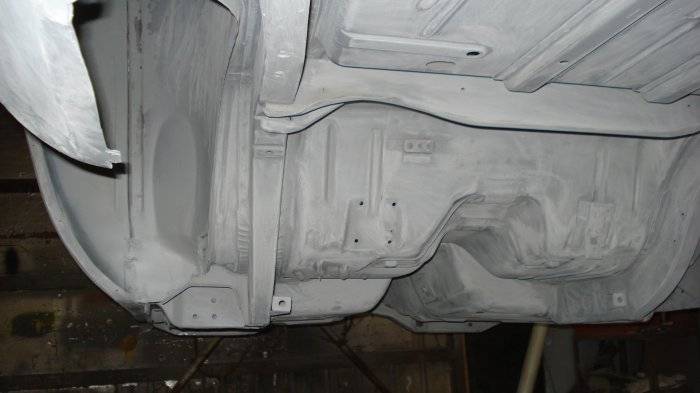

moparlee
Jul 25, 2011
3,221
1,417
Mid Michigan
From a 71 Challenger here you can see the two bracket locations behind the back seat area on each side of the floor hump. The 4 hole area on the driver side is a two piece bracket, one piece behind the back seat and one piece underneath used when the car had dual exhausts. If the car did not have dual exhausts these holes would not be there. The bracket you see on the passenger side (hard to see in this pic) is a one piece bracket welded to the body at the factory for the right had exhaust. These brackets are being reproduced today.

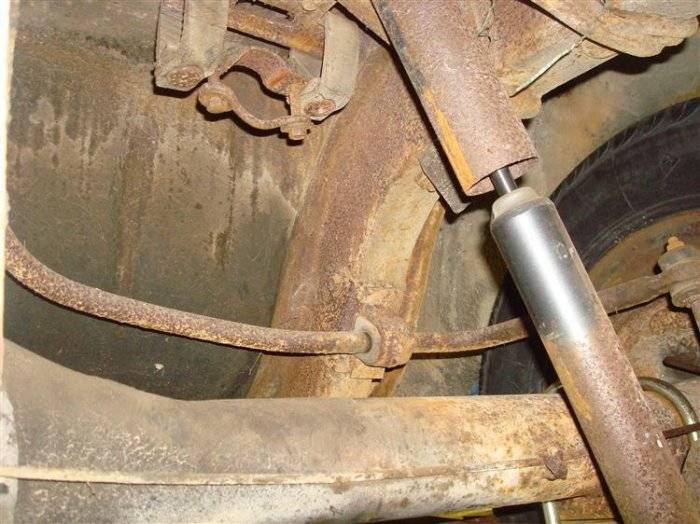

quapman
878
226
Here's the hanger on a 73 cuda. The floor section is repro, so that's why the lower bracket is there as well. The upper hanger attaches with 2 1/4-20 bolts to a tab on the shock x-member. I removed it and used the lower 70-style deal.
