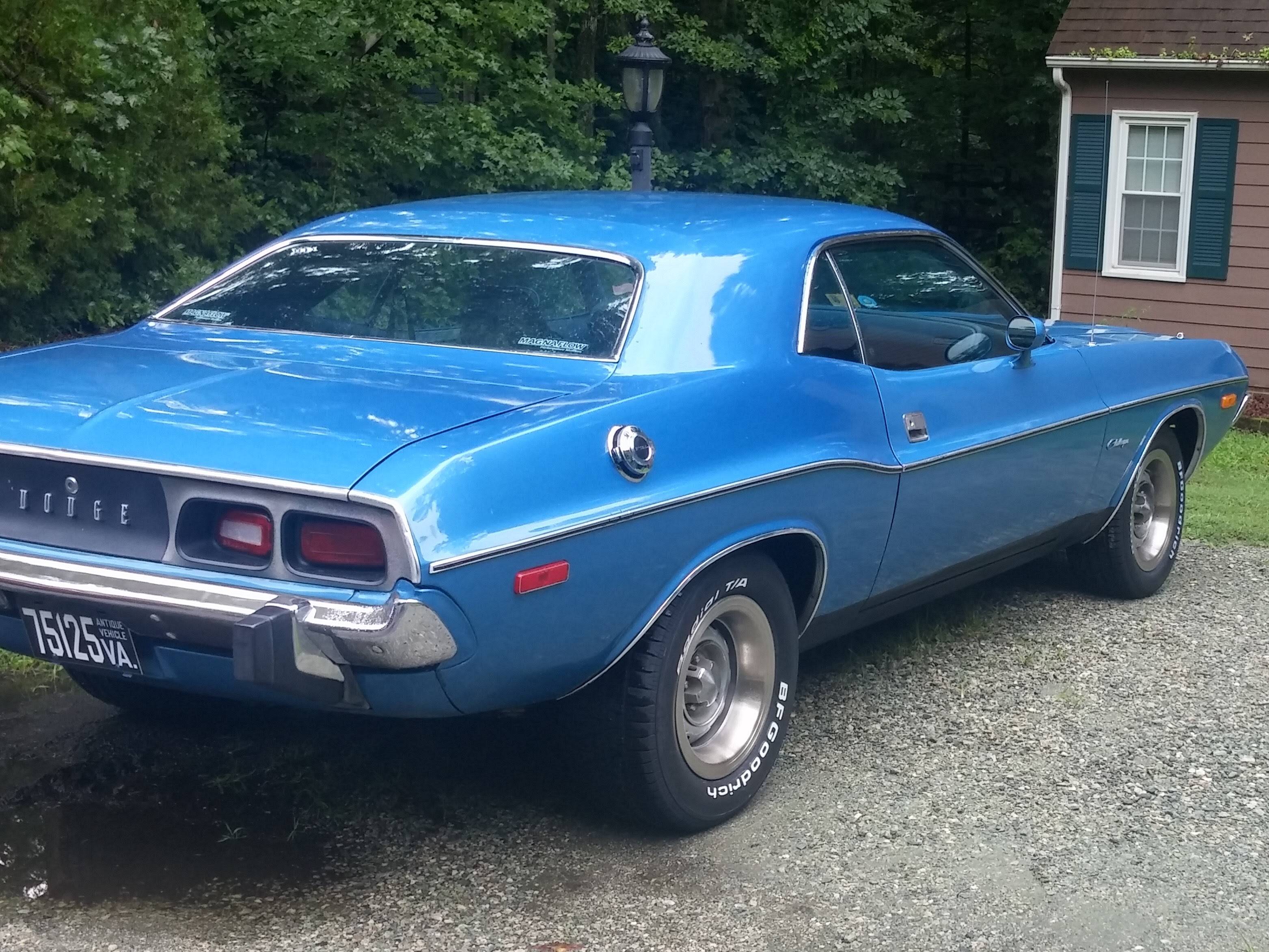

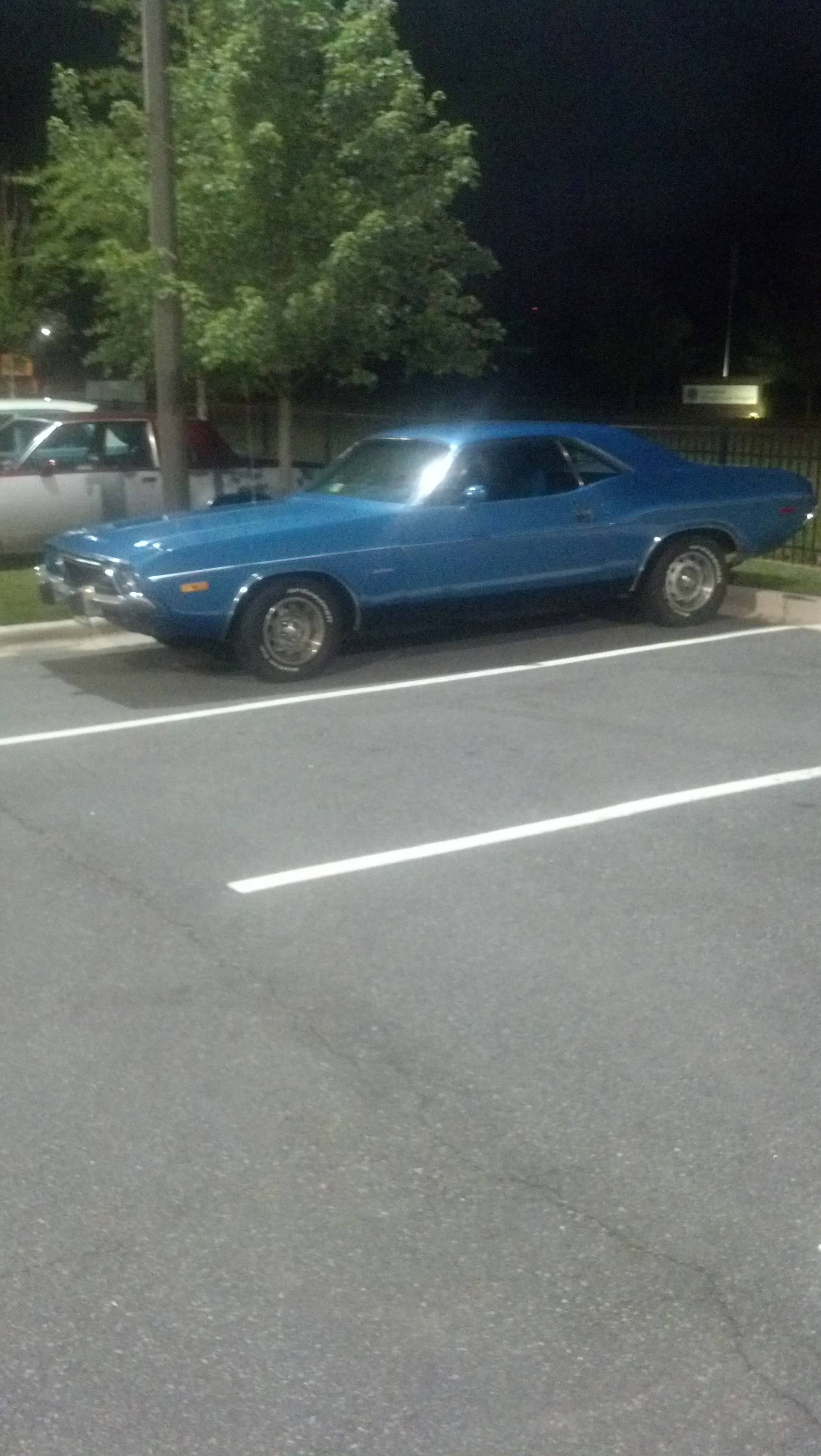

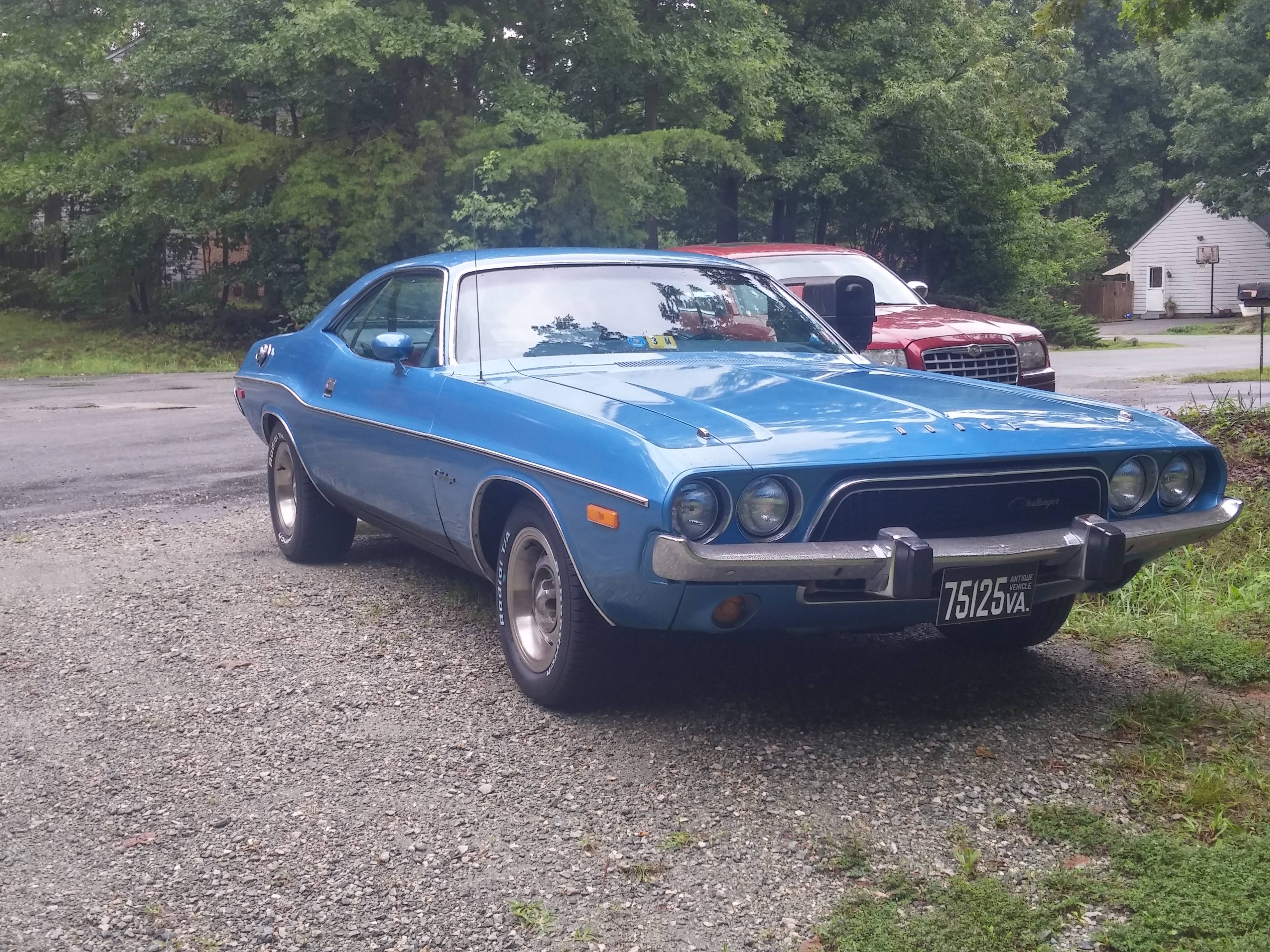

New member, I have a 74 challenger that was an original 318 car. It currently has a 340, and I am just starting the build on a 440 to swap in. Any advice, or tips and tricks from fellow members that have completed a 440 swap is greatly appreciated!

Welcome to the site from Arkansas! Nice looking challenger
