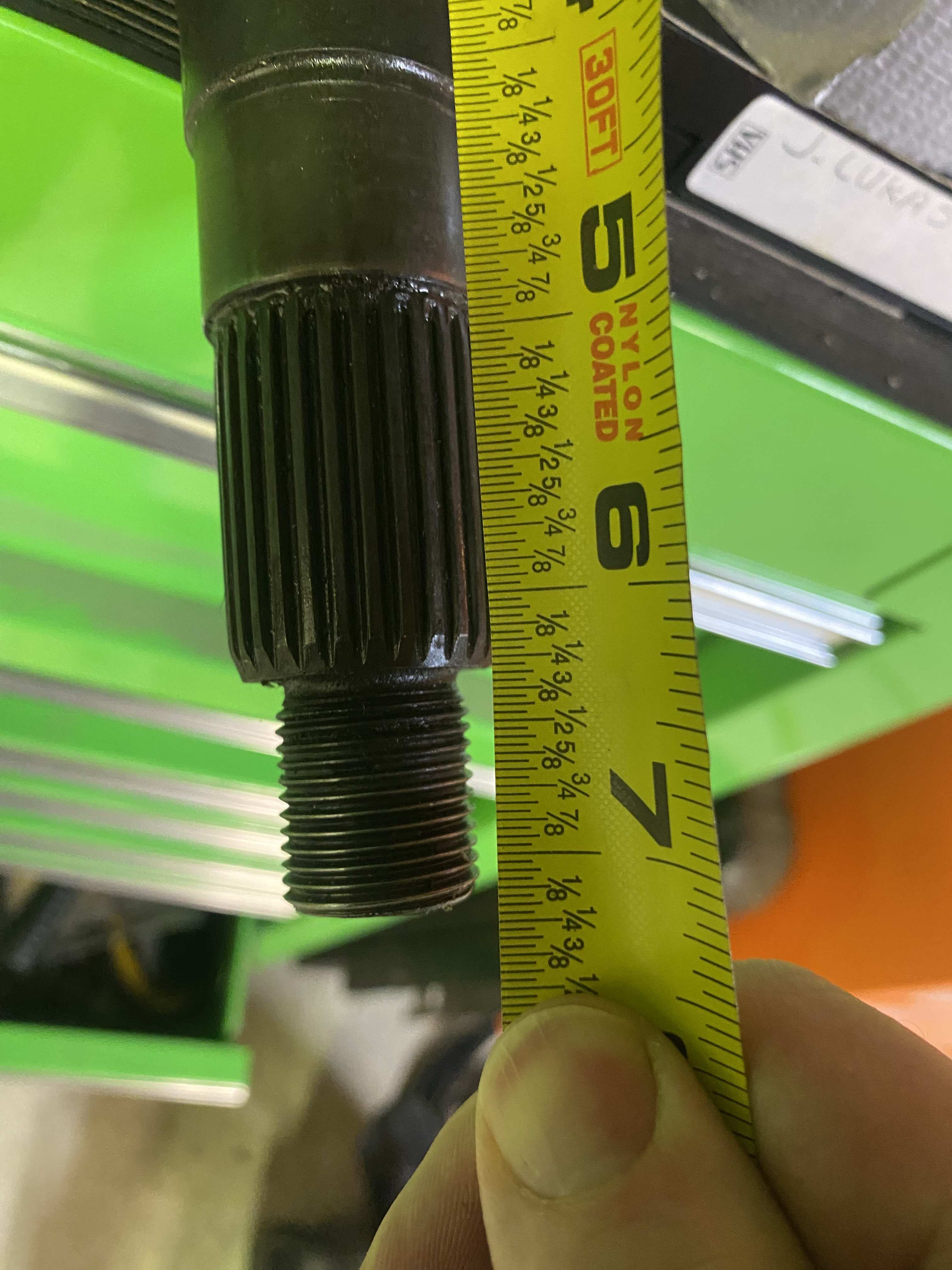

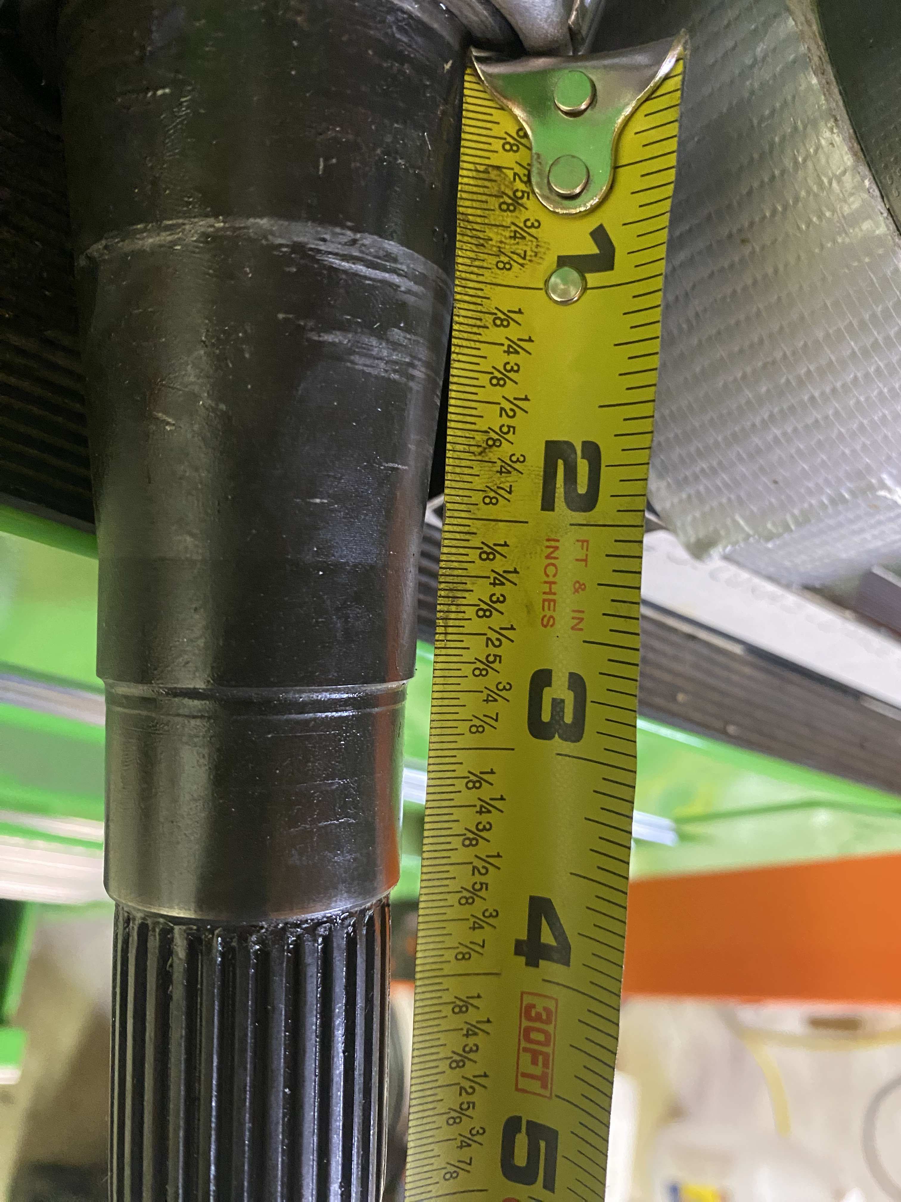

Here are a few measurements, first the crush sleeve is 2 7/8”.
From the backside of the pinion gear to the end of the shaft is 7 1/8”, and from the face of the bearing to where the splines end is 3 5/8”
I am still planning to purchase the sleeve kit, but I wanted to share these numbers and see if they are correct?
The crush sleeves and bearings came from Mancini Racing. The car will have a 440/727 with 373’s so I don’t plan to thrash it. But I am Shute I will do a few burn outs, and really want it to hold together.
