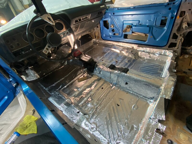

A new move over from abodiesonly hello all new project 73 rally challenger
Ohhhhhhhh Yeah!

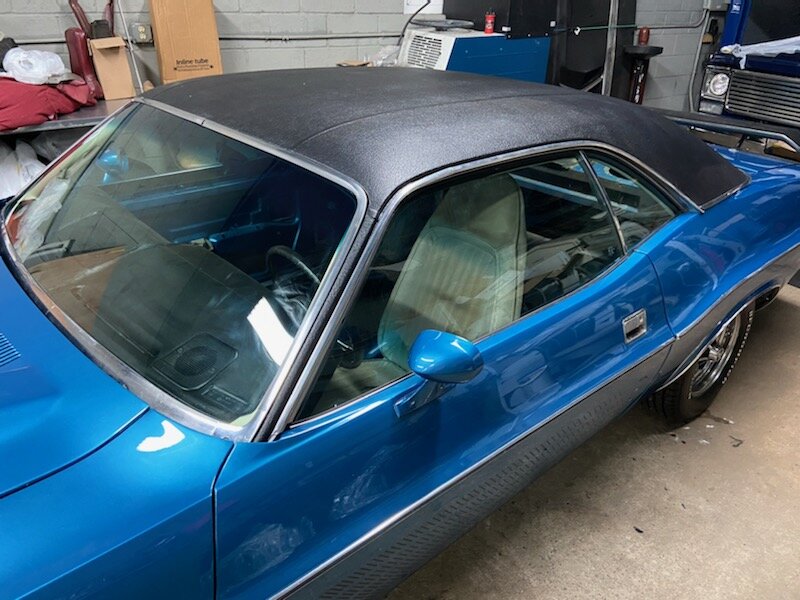

You have done a great job restoring and documenting the progress of your '73 for our benefit. The car looks great. The 360 with that roller assembly will work great. Have you thought of removing the 5mph rubber bumperettes? I'm jealous of your working rally dash. Great looking car.

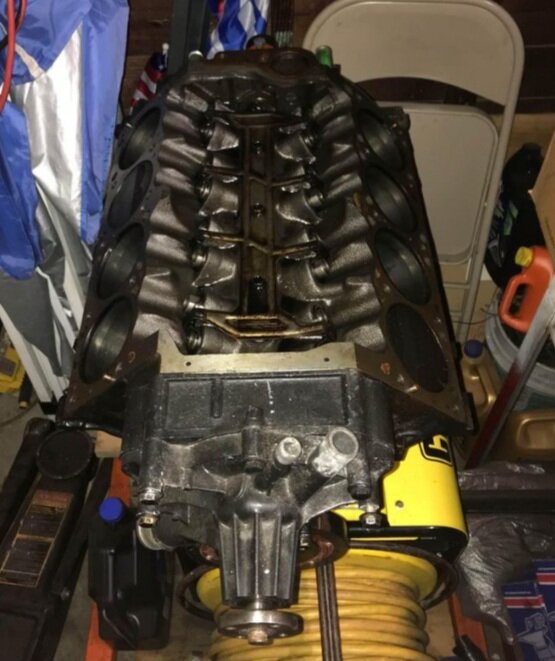

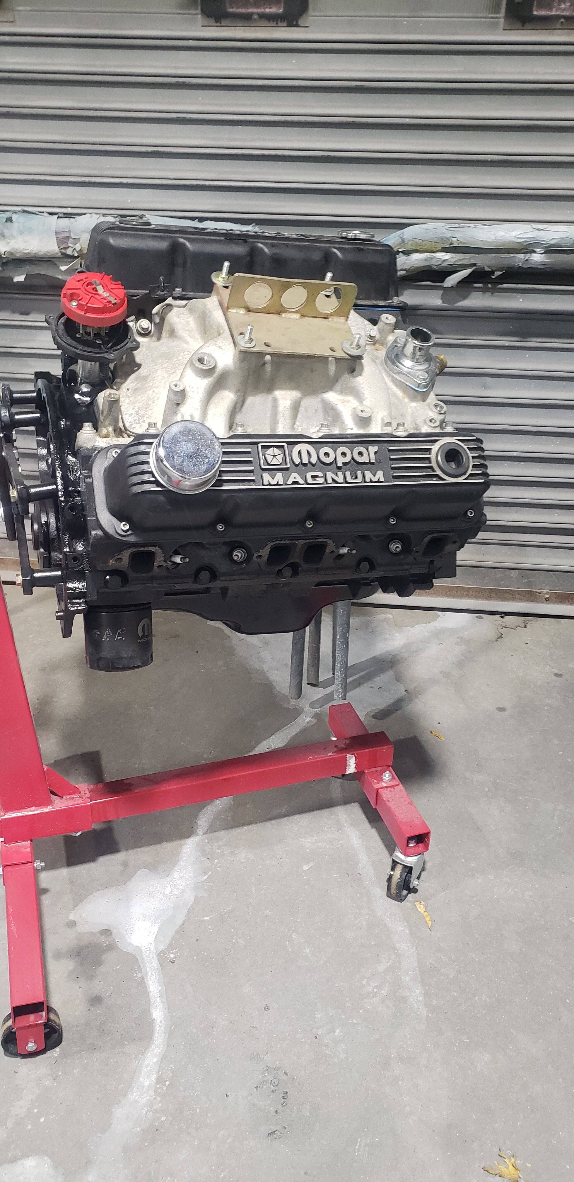

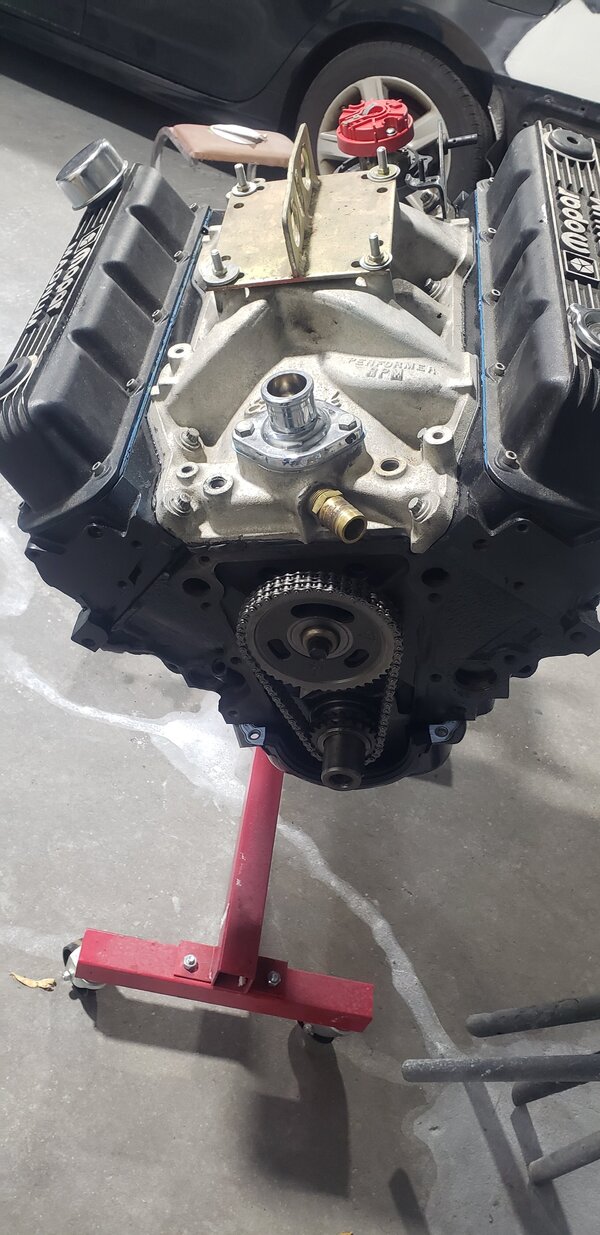

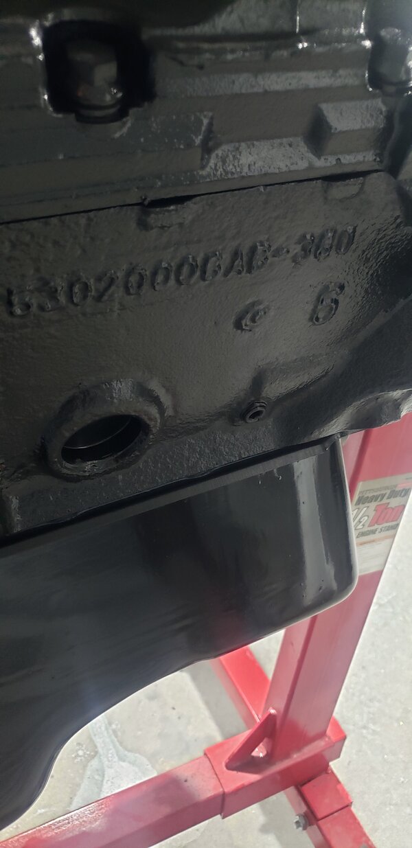

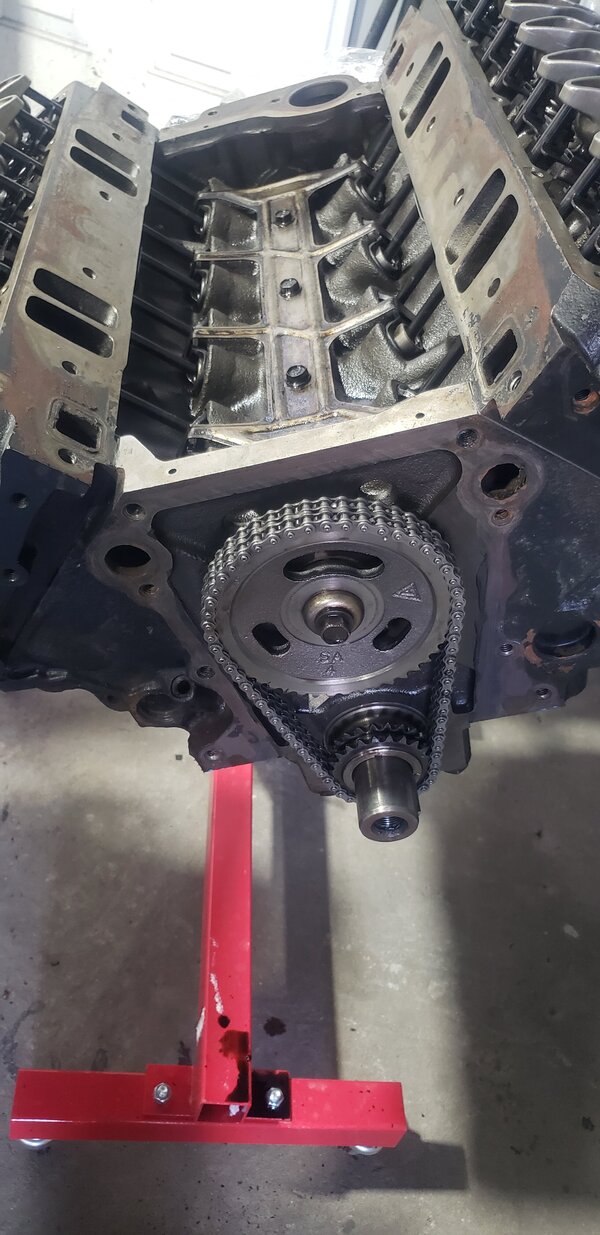

Mopar 360 magnum engine with about 12k miles, disassembled for storage was pulled from truck I built and sold as roller. has .030 over 10.5:1 KB pistons, rebuilt connecting rods with arp hardware, New EQ magnum heads drilled for LA intakes with double springs stock size valves, comp roller cam
