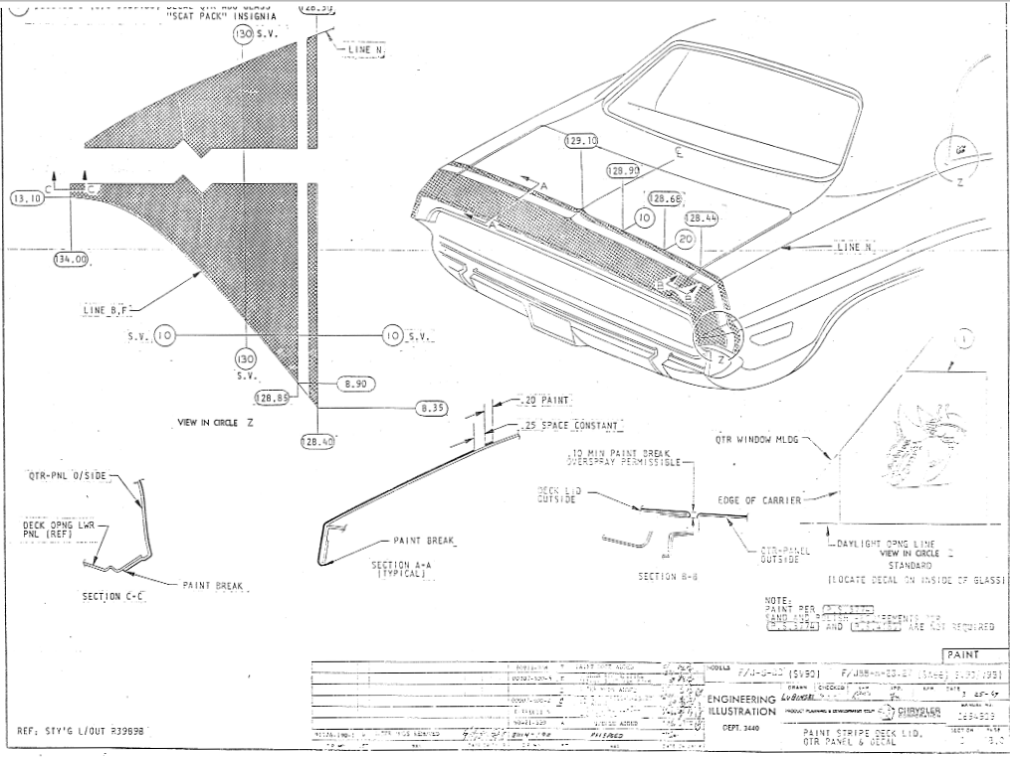

Feb 21, 2026 #1 AUSTA Well-Known Member Joined Apr 16, 2015 Messages 983 Reaction score 541 Location PERTH WA Hi doing a respray anyone have the rear stripe measurements for a A66
Feb 22, 2026 #2 Challenger RTA Well-Known Member Joined Oct 28, 2018 Messages 5,359 Reaction score 3,088 Location PA Flood city Rear stripe Attachments Stripe_Paint_Bumblebee_70.pdf Stripe_Paint_Bumblebee_70.pdf 114.4 KB · Views: 70 Last edited: Feb 22, 2026

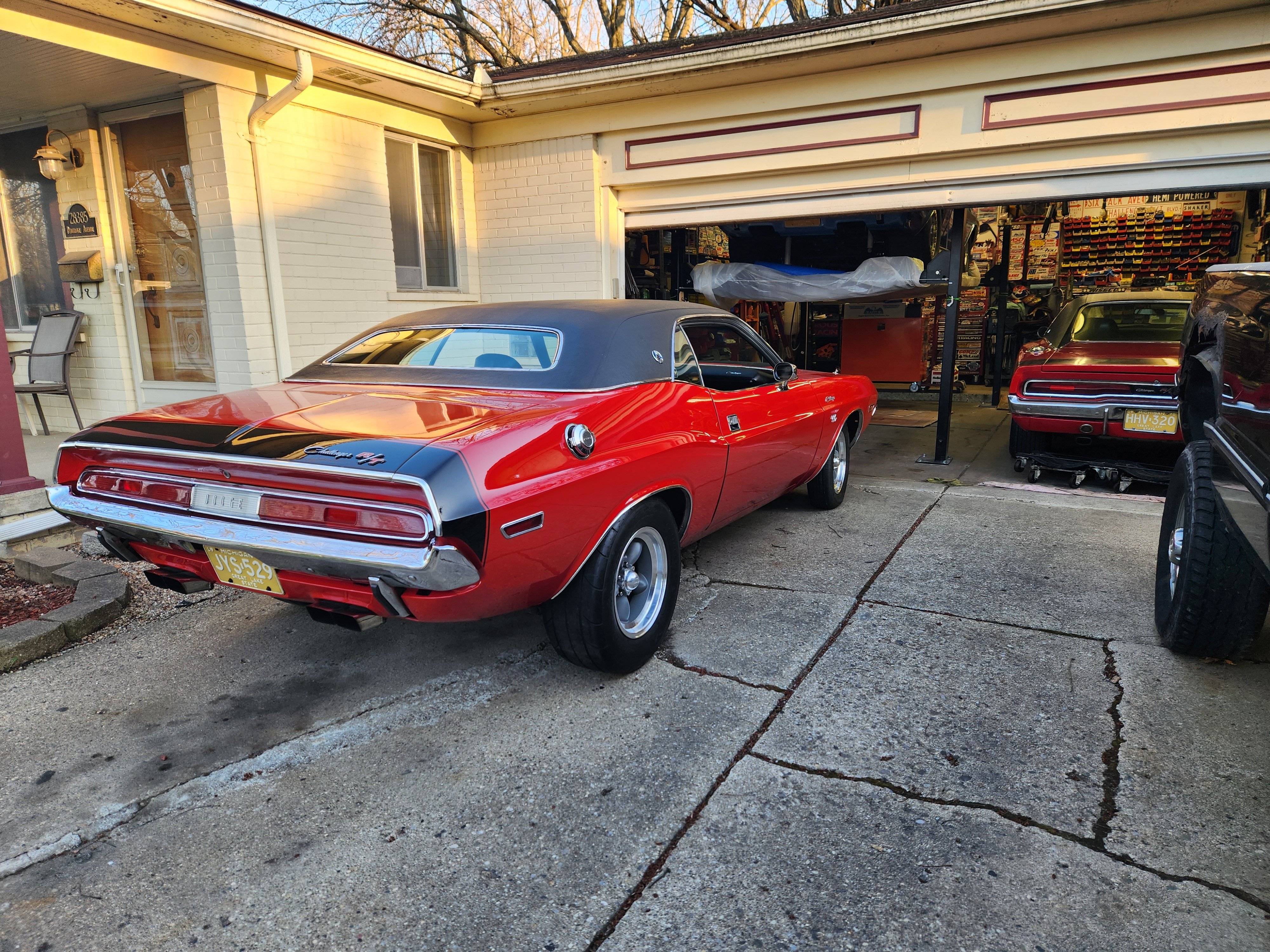

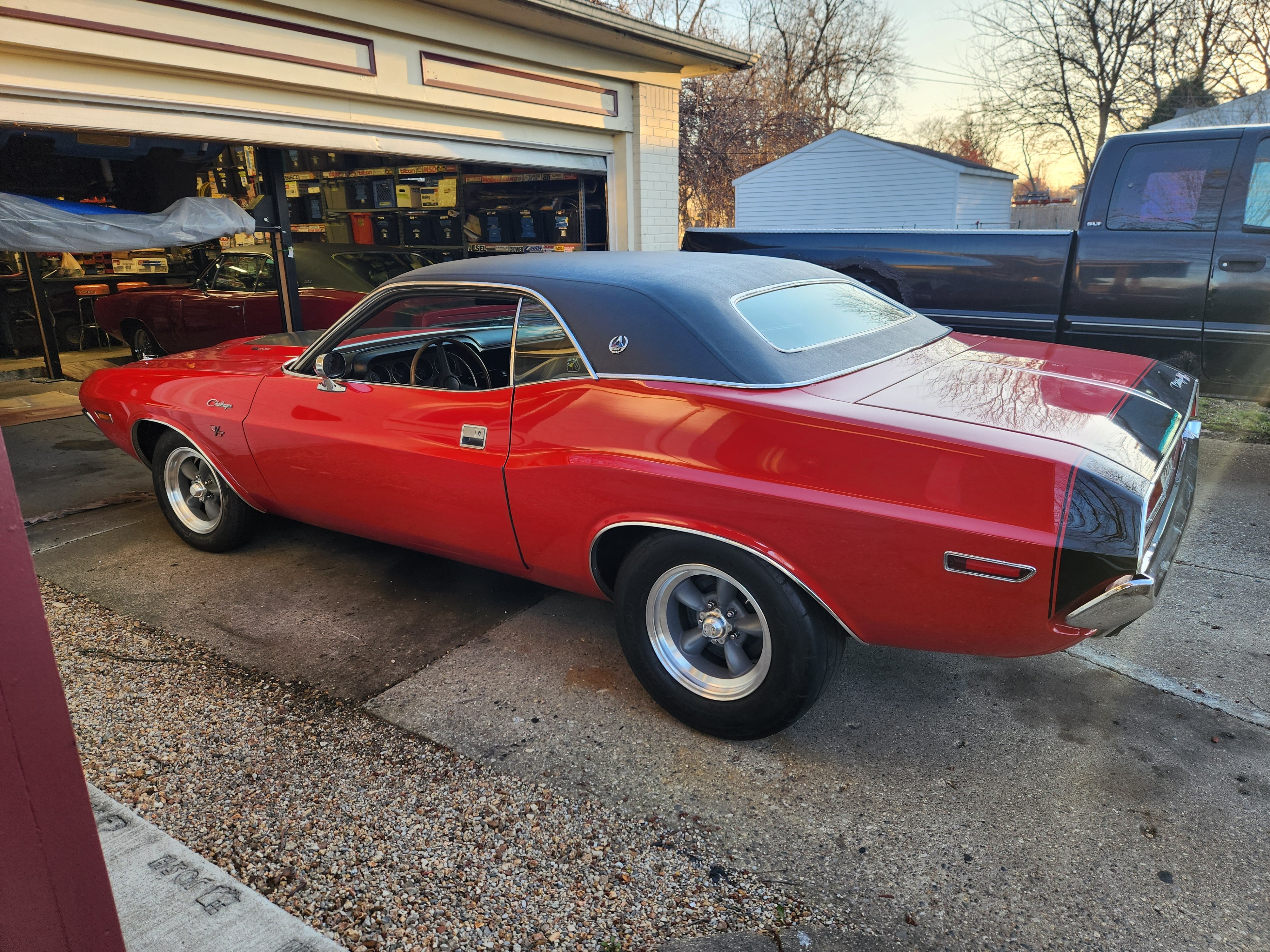

Feb 22, 2026 #3 6PKRTSE Well-Known Member Joined Feb 3, 2010 Messages 1,309 Reaction score 868 Mine was sprayed using that very schematic /print.
