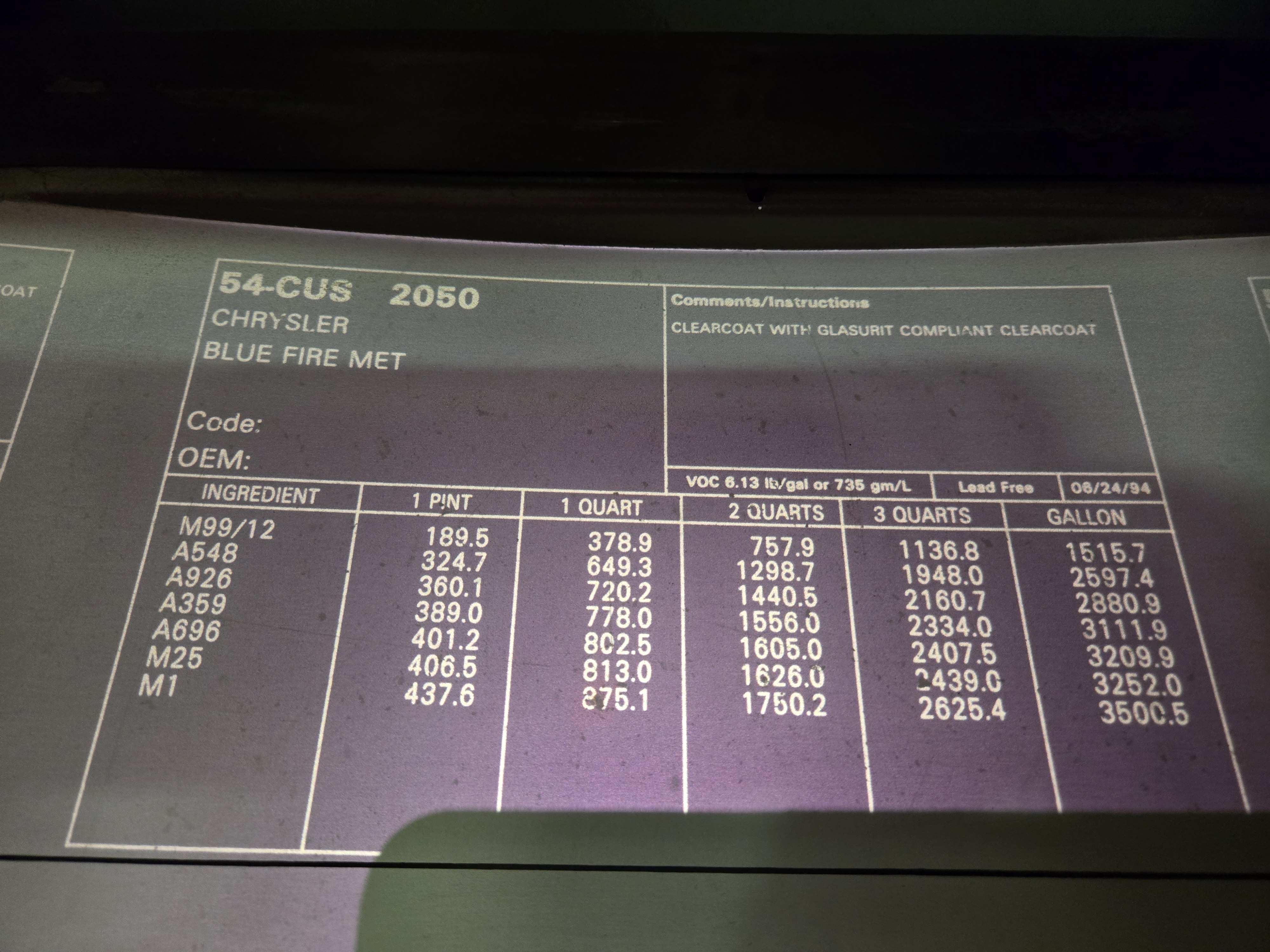

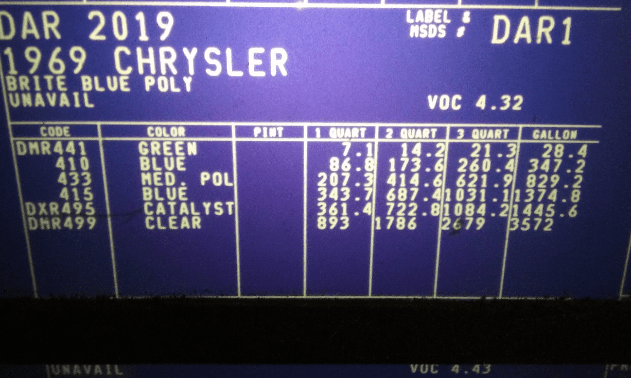

Oct 13, 2025 #4 Challenger RTA Well-Known Member Joined Oct 28, 2018 Messages 5,058 Reaction score 2,873 Location PA Flood city Thread 'Paint codes' May 20, 2024 Paint is 99% perspiration and 1% inspiration - Virgílio Dias, artist The posting purpose. To show the components used in the formula. Organisol INSERTS DDL BLACK 9533 DDL Acrylic Lacquer 9533 www.forebodiesonly.com PAINT 1 DLL Acrylic Lacquer PAINT 1 DLL Acrylic Lacquer www.forebodiesonly.com PAINT 2 DLL Acrylic Lacquer PAINT 2 DLL Acrylic Lacquer www.forebodiesonly.com PAINT 1970 DAR Acrylic Enamel PAINT 1 1970 DAR Acrylic Enamel 2016 Platinum silver poly A4 2017 CHARCOAL POLY 2018 BAHAMA BLUE POLY B3 2019 BRIGHT BLUE POLY 2020 MED DARK BLUE POLY 2210 PLUM CRAZY C7 2136 BRIGHT RED E5 2133 LIGHT GREEN F4 2103 BRIGHT GREEN POLY 2128 SUBLIME J5 www.forebodiesonly.com ...

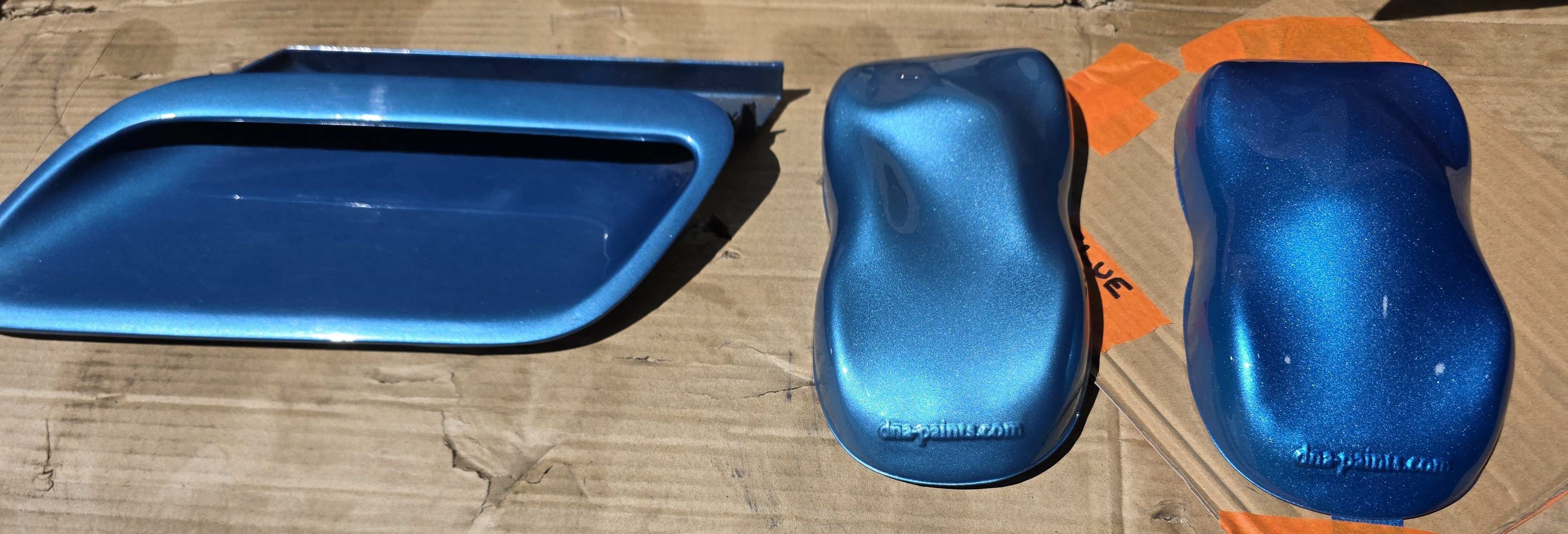

Oct 14, 2025 #6 AUSTA Well-Known Member Joined Apr 16, 2015 Messages 972 Reaction score 526 Location PERTH WA This is using the local system surf blue on the right ,B5 on the left B5 missing a couple of toners
Oct 15, 2025 #7 M moparlee Well-Known Member Joined Jul 25, 2011 Messages 3,400 Reaction score 1,545 Location Mid Michigan AUSTA said: This is using the local system surf blue on the right ,B5 on the left B5 missing a couple of toners View attachment 146110 Click to expand... I like the B5 on the left.
