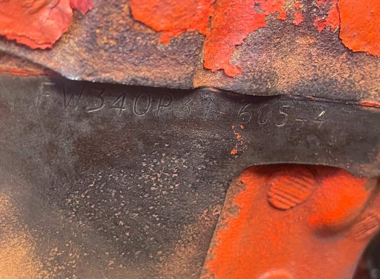

Stick with a 1968-1970 engine. Consider a 1970 engine (painted Street Hemi Orange) for your AAR if you can source one. The early-340 engines have the forged crankshaft and are internally-balanced.
The automatic cars have neutral-balanced torque convertors as well.
The later 340 engines (painted Chrysler Blue) have cast-crankshafts and are externally-balanced (harmonic balancer must match). Automatics get special torque convertors with weights.
Someone else can chime in about the 1971 340 engines which were painted Chrysler Blue as well. 1971 340s are also forged crankshaft and internally-balanced but you could make a mistake with those and end up with a 1972 or 1973 340. Check the Engine Identification numbers and casting dates. REFERENCE
Any of the 340-360 engines could be made into a similar looking 1970 340 when painted orange with the 2.02/1.60 valve X or J heads installed.
Finding T/A heads and a T/A block would be a very, costly endeavor as you probably already know.
2nd photo below is a 1970 340 engine ID stamping for FW340P31060544. Note there is no small "s" in the non-T/A 340 block ID stamping.

Thanks to all. Been looking for the early year block. I have a 72 block that I have done to replace my bad 318 in my Gran Coupe. Thanks for the stamp information on the front. I usually looked at the production date but this is good to know.
