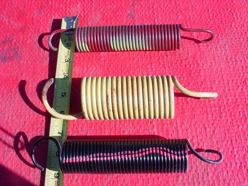

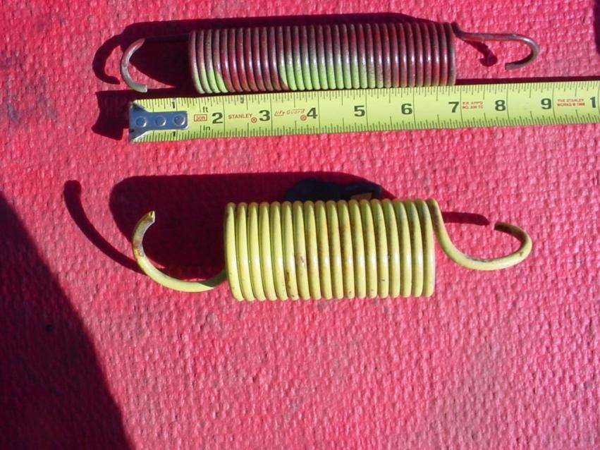

aar springs

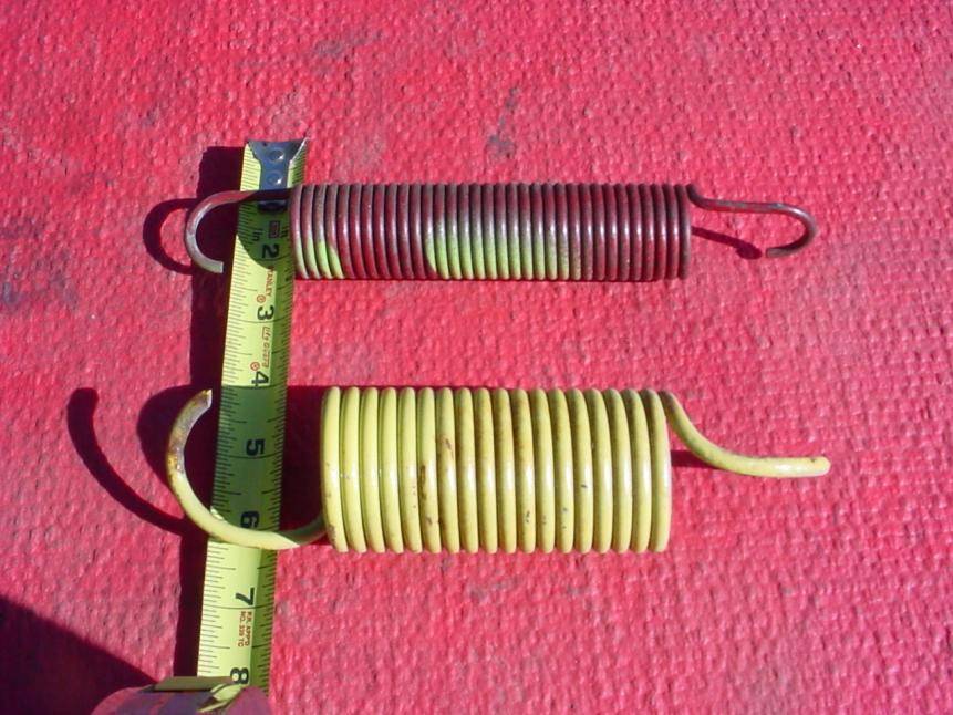

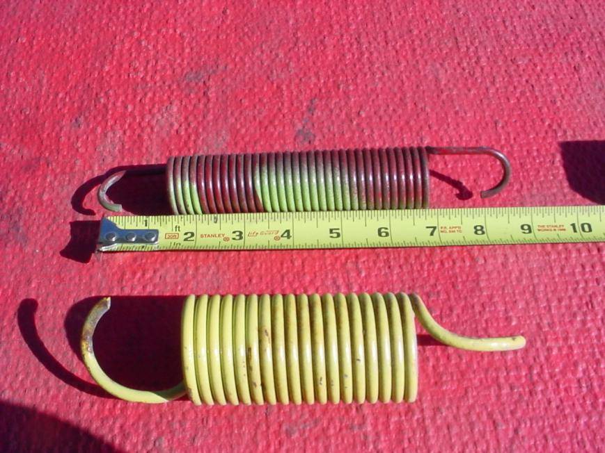

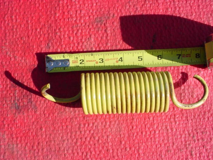

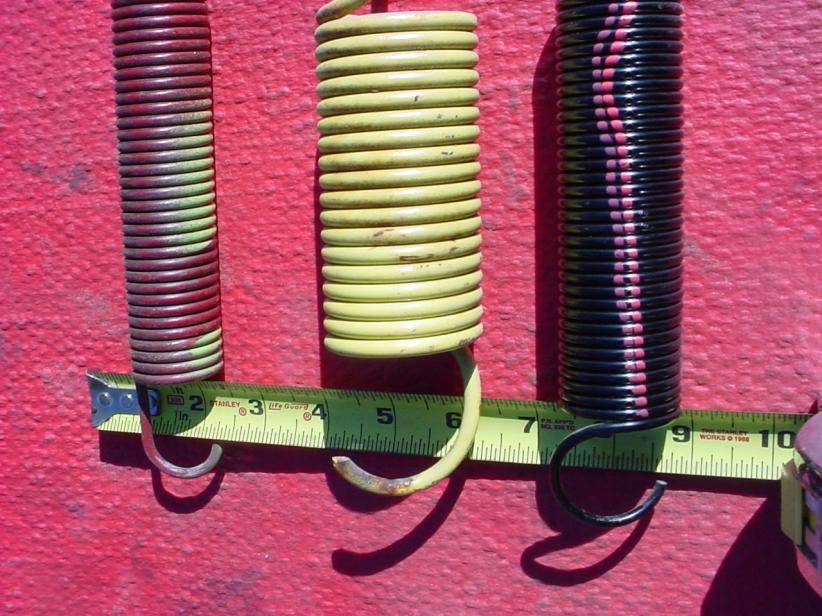

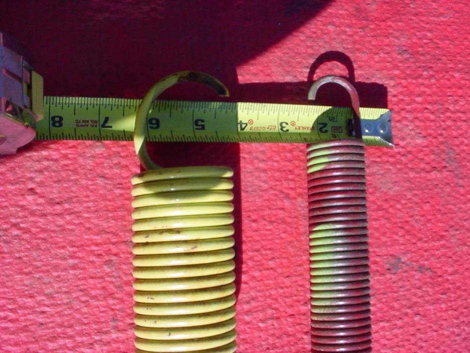

My boss asked me to send these pics to help you guys. One of the springs is a after market, and isnt like the other two. He said you would know the differnce.

aar springs
here they are

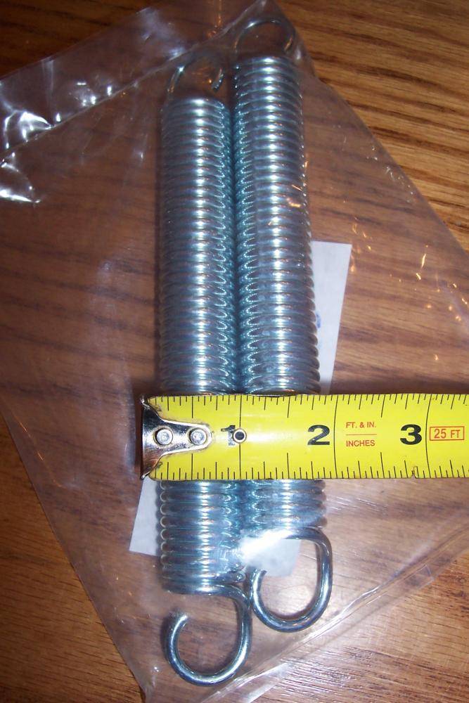

Thanks for the pics Cudarick.I guess there are a lot of choices out there.Here are pics of the ones I bought what do you think? I still havent even taken them out of the package yet.I was hoping to see how they fit in a day or two,but were supposed to get walloped with snow tonight and tomorrow and it`s freezing outside so who knows when i`ll get a chance to work on my car. This weather is killin me! :mad:

The red one is an original AAR spring the yellow is a cuda standard spring the black one were sold to me as aar but aren't close. you want a spring that will hold the hood up barley the main problem is when the hood is closed the spring is streached and puts upward preasure on the hood causing it to warp the hood along the fender line. plus in the sun is worse. I kept my springs off most of the time.(fan belt works best)

I just put the springs and hood on my car the other day and the springs from Penstar still seemed too stiff to me plus they were noisy as hell. My hood sounded just like my pull down attic staircase my neighbor heard it and said thats exactly what it sounded like. So I changed them to the trampoline springs I mentioned earlier and guess what they work perfect hood stays up on its own and closes real nice without all the noise the other ones made.When I get a chance I`ll post a picture of these springs looking at actual AAR springs these look very similar.
