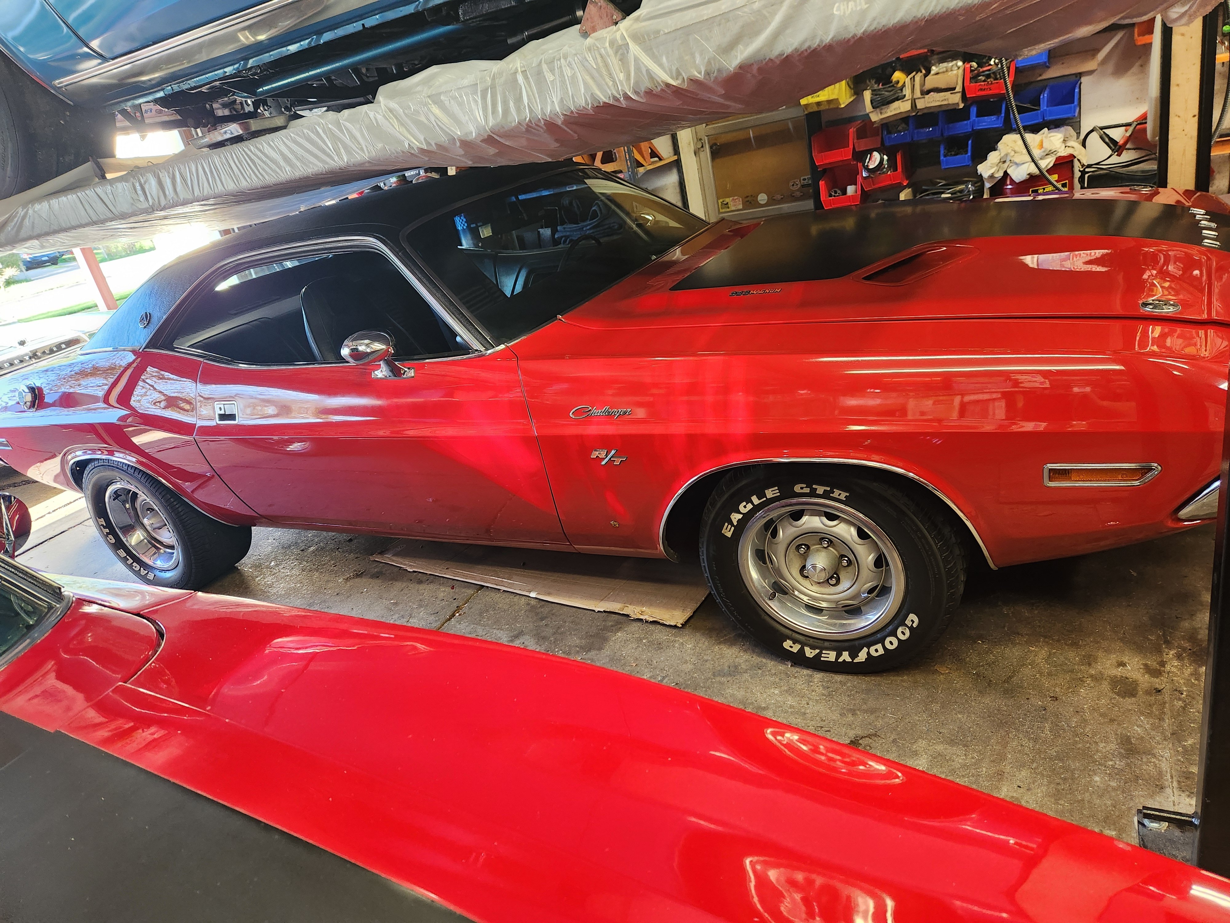

What is the best way to remove the trim from the top of the door? I believe it is called a belt molding and I notice there is a nut holding it on at the aft side of the door. Does it just slide off, or is there a specific technique needed?
