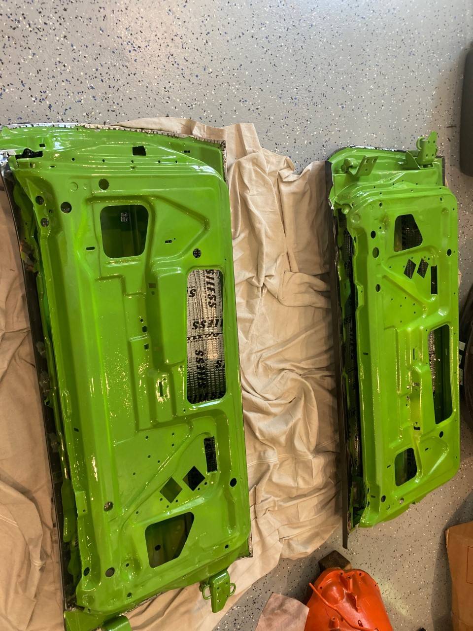

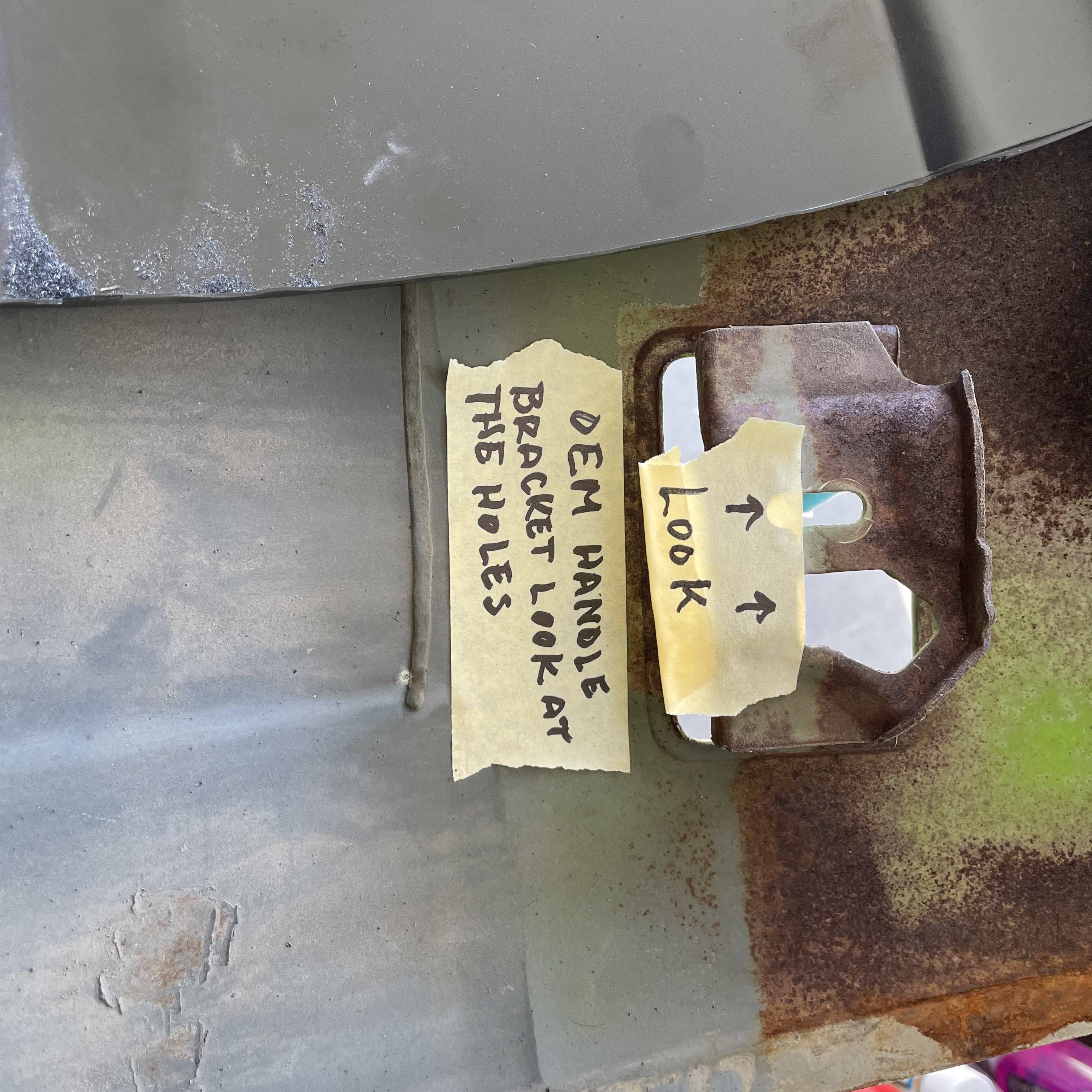

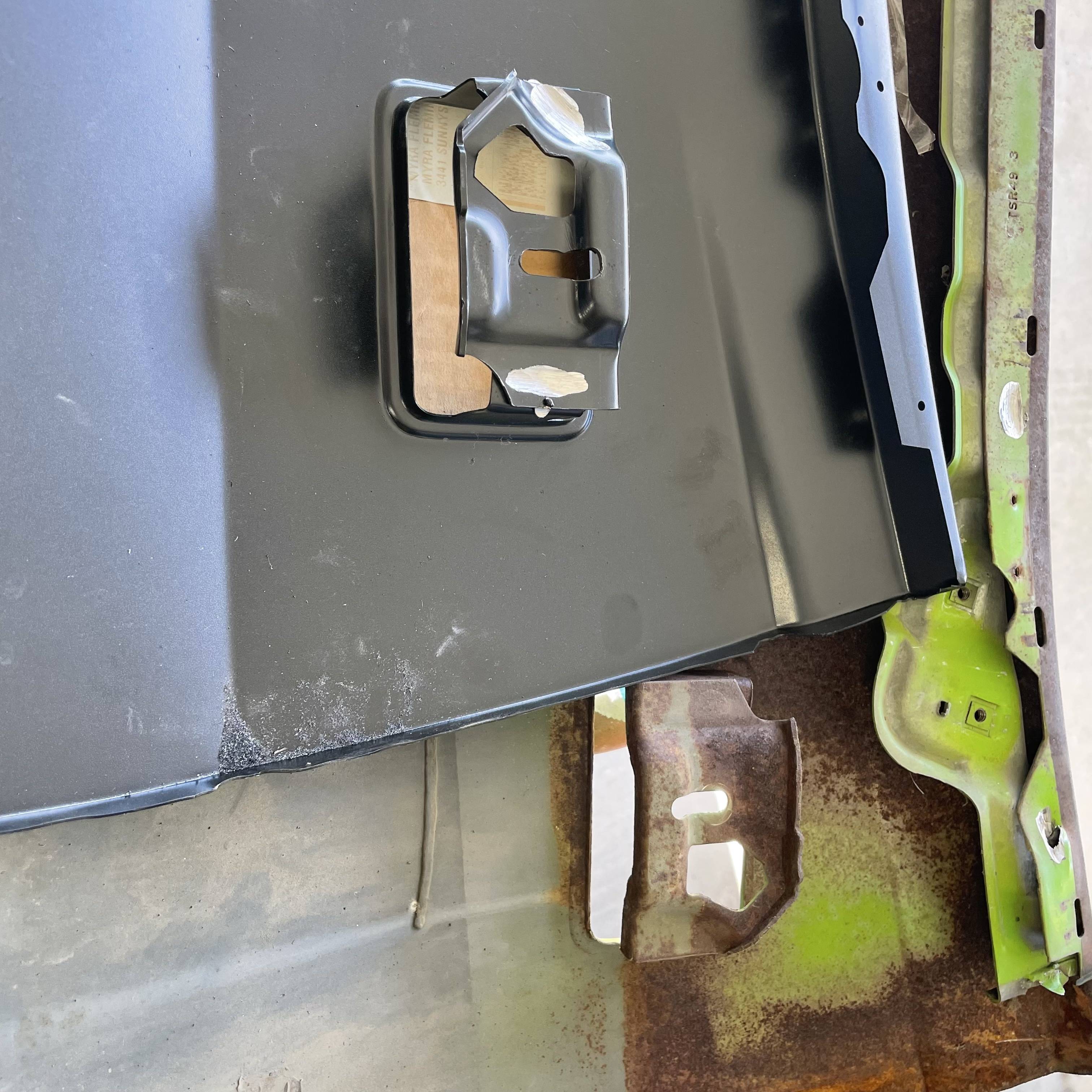

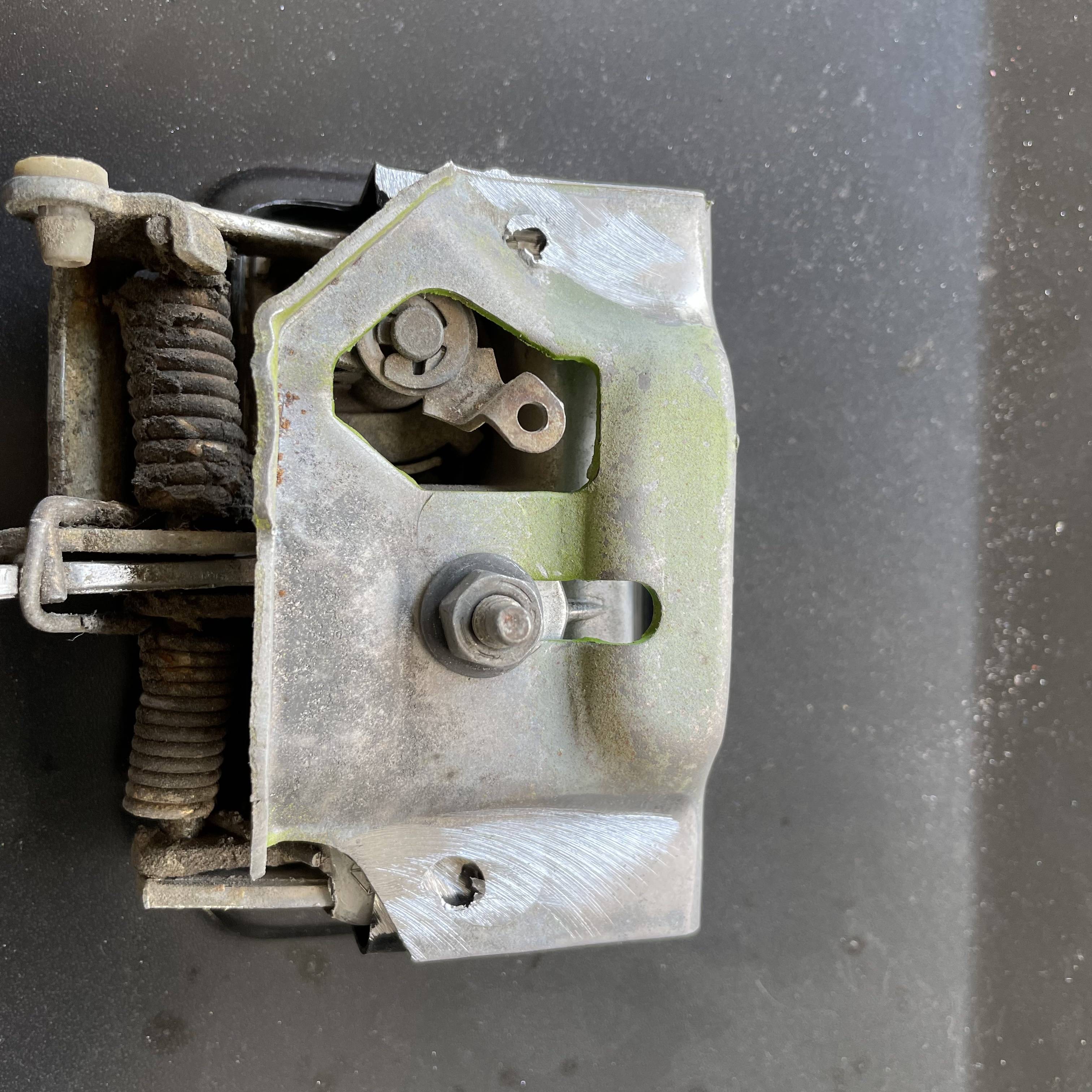

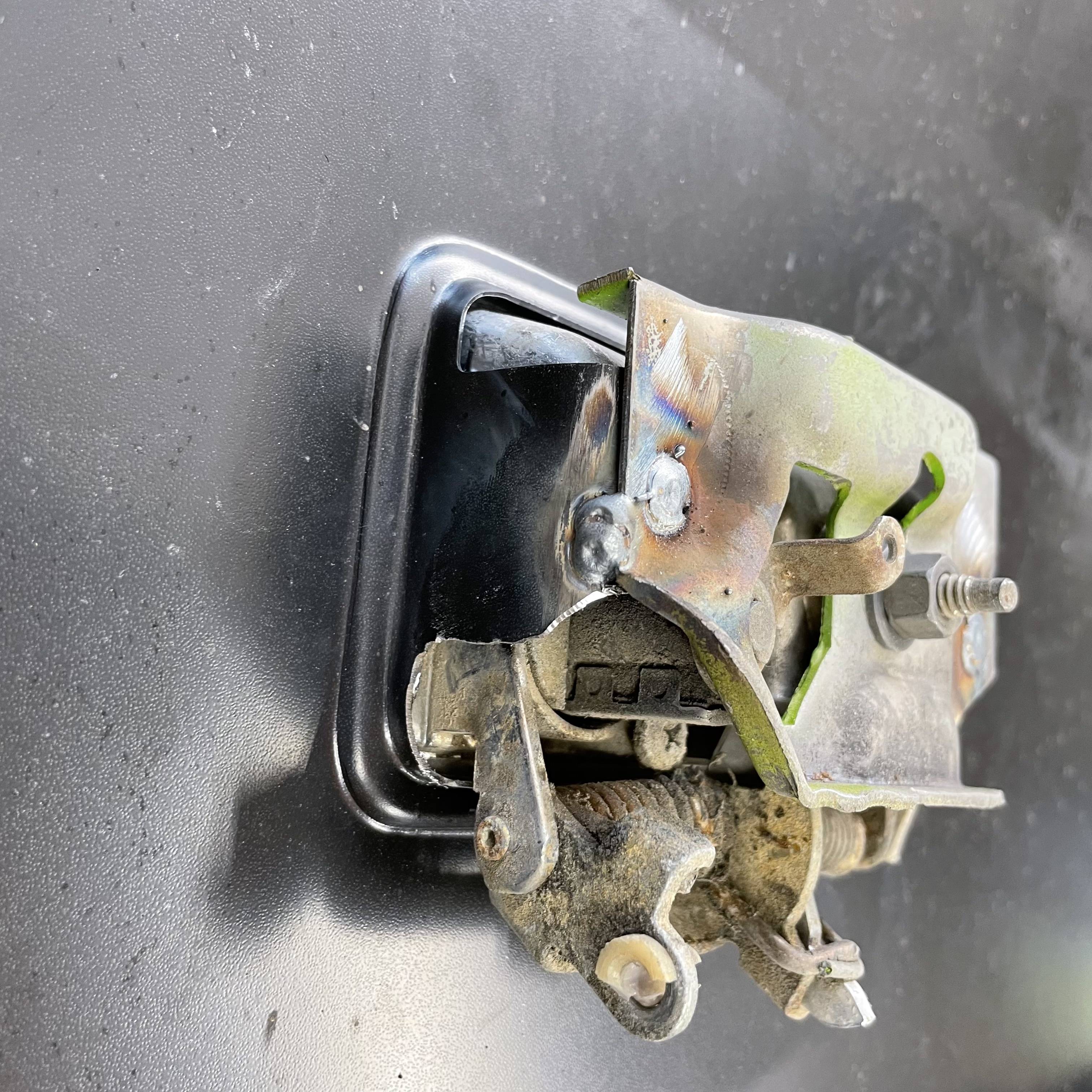

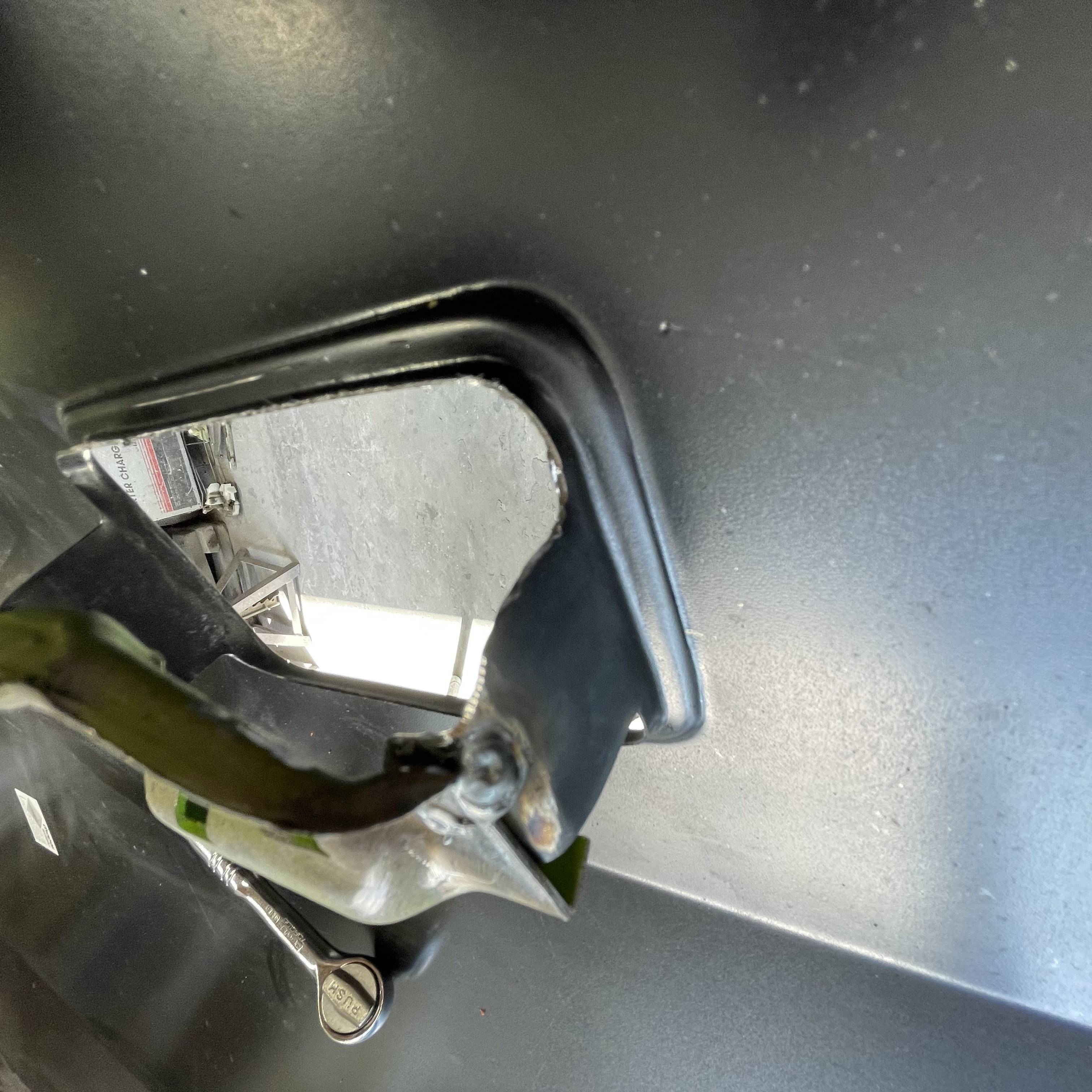

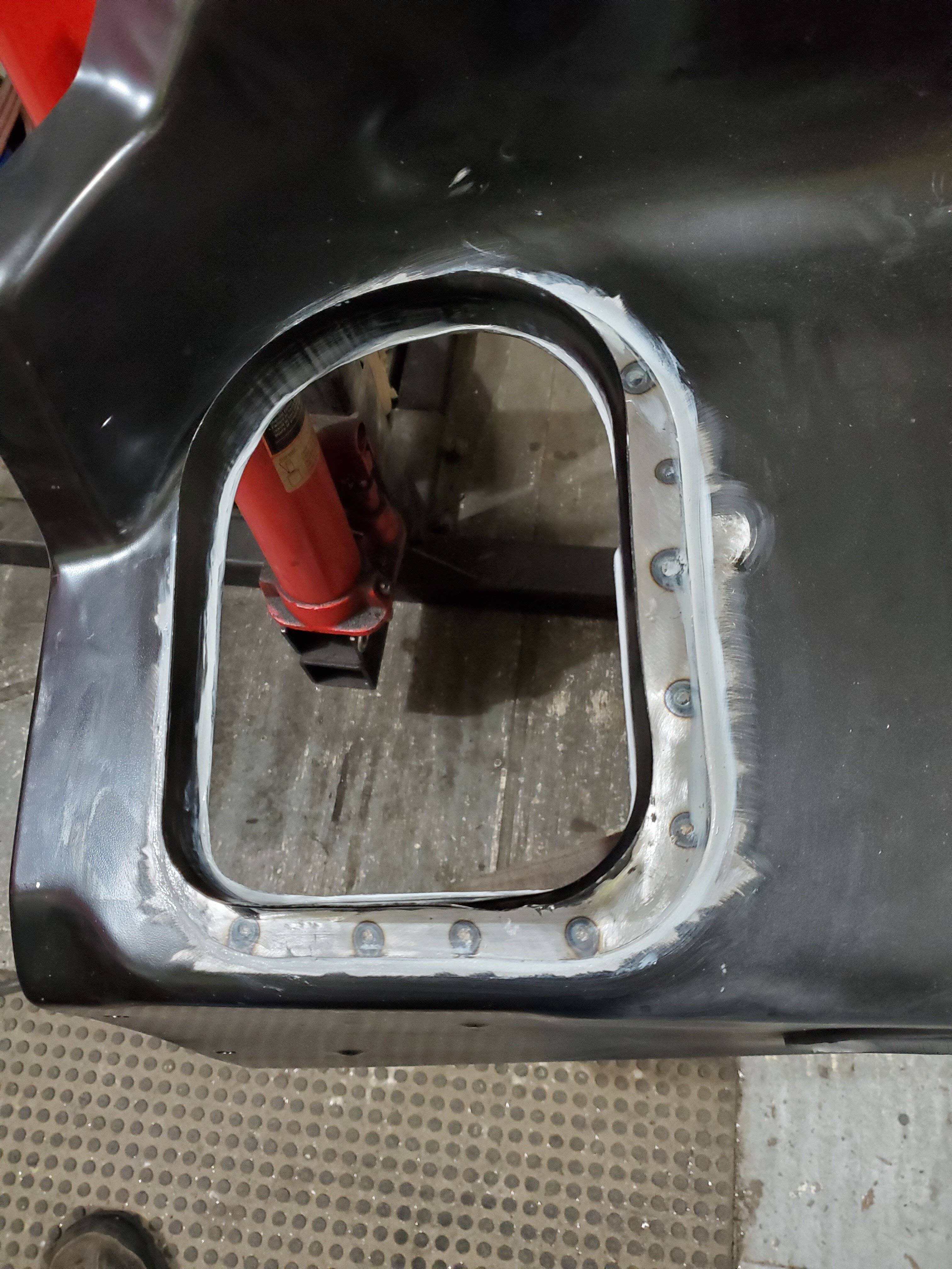

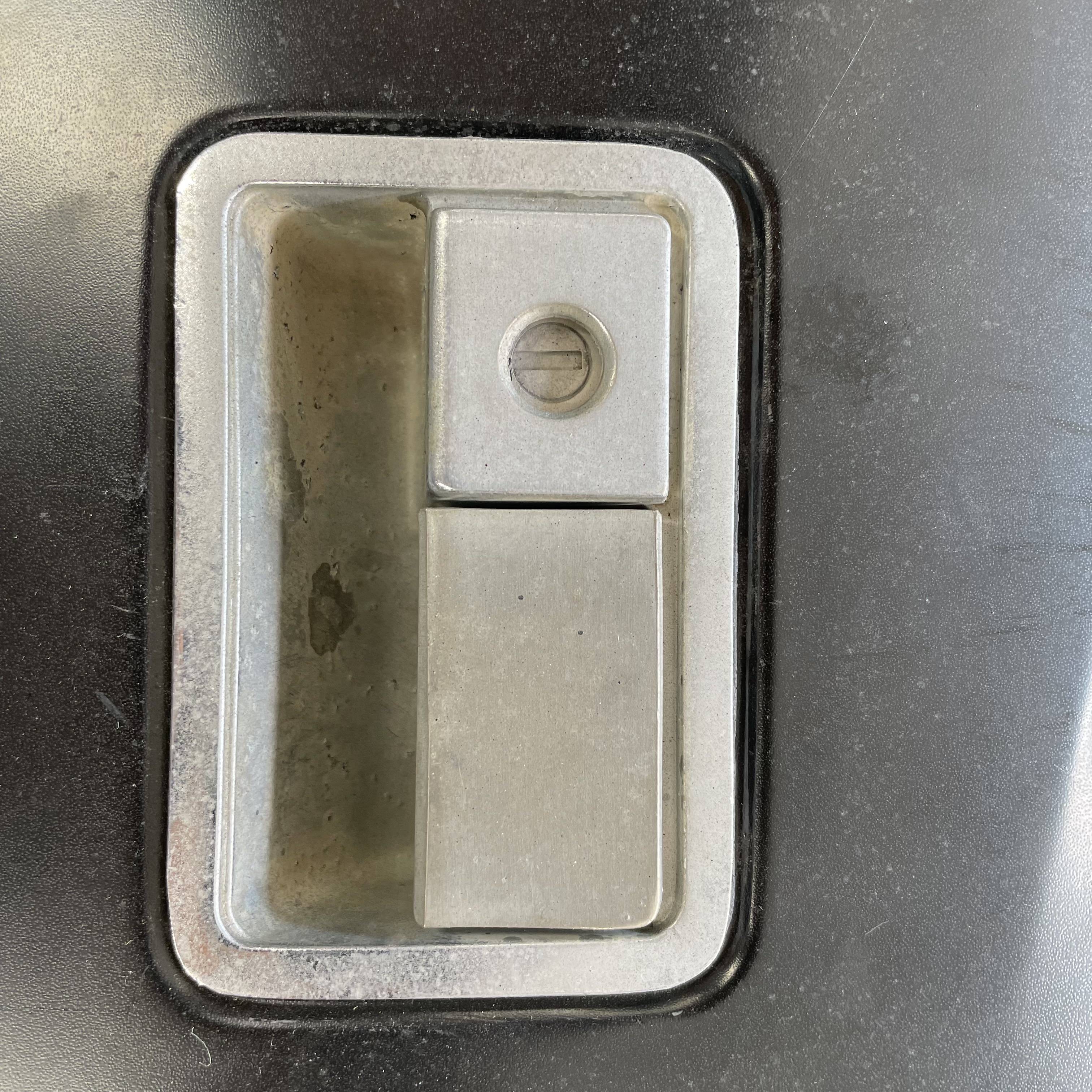

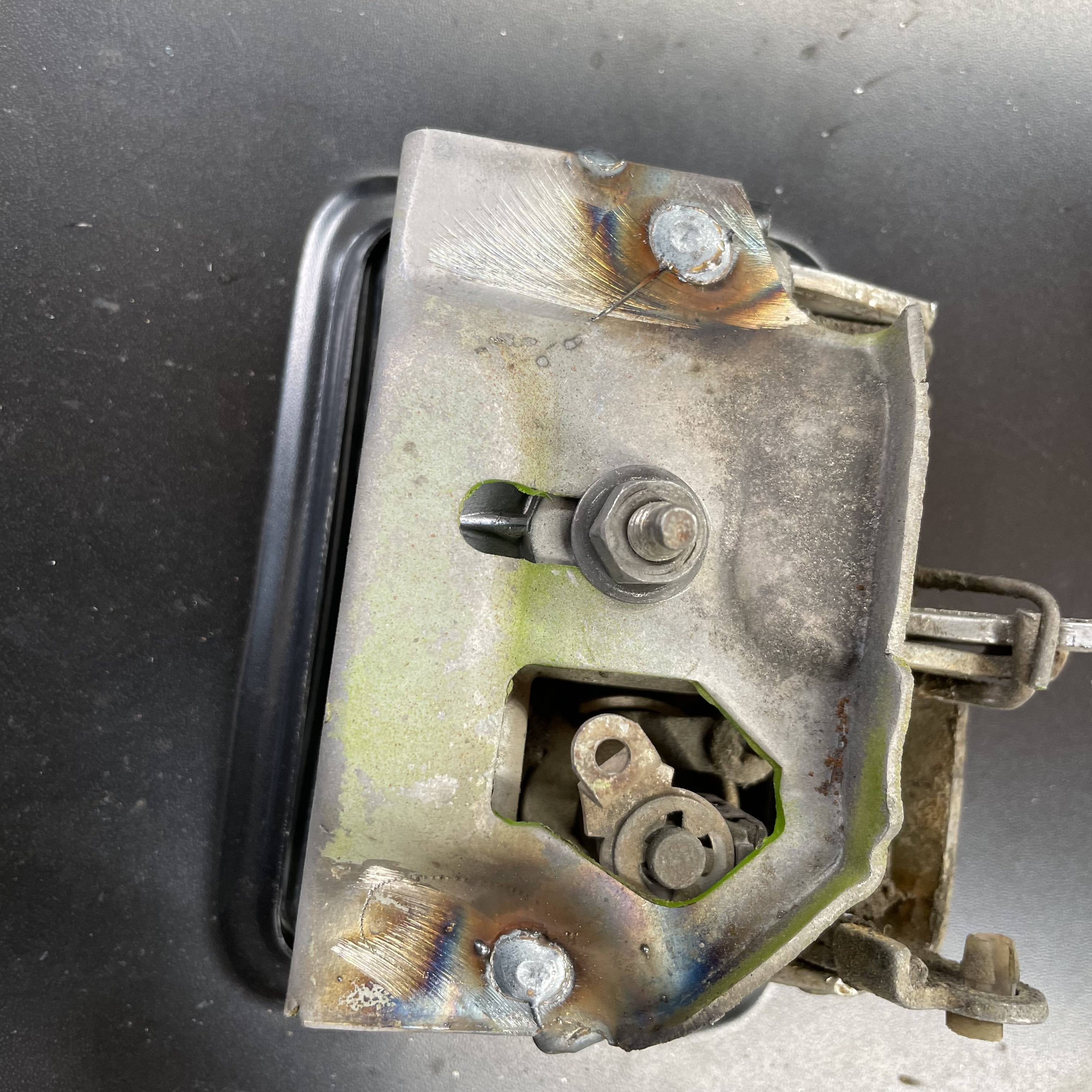

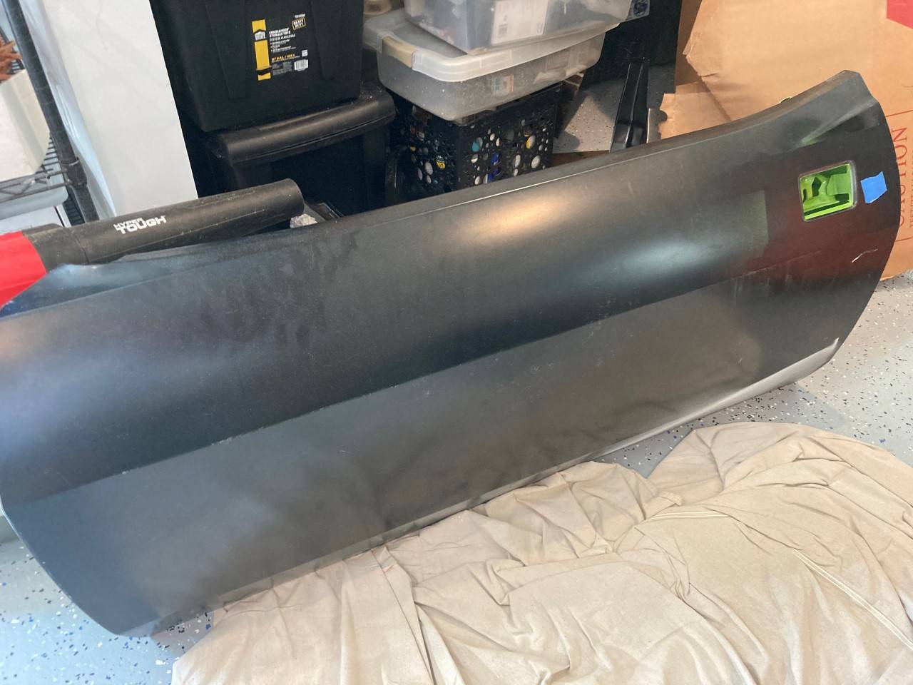

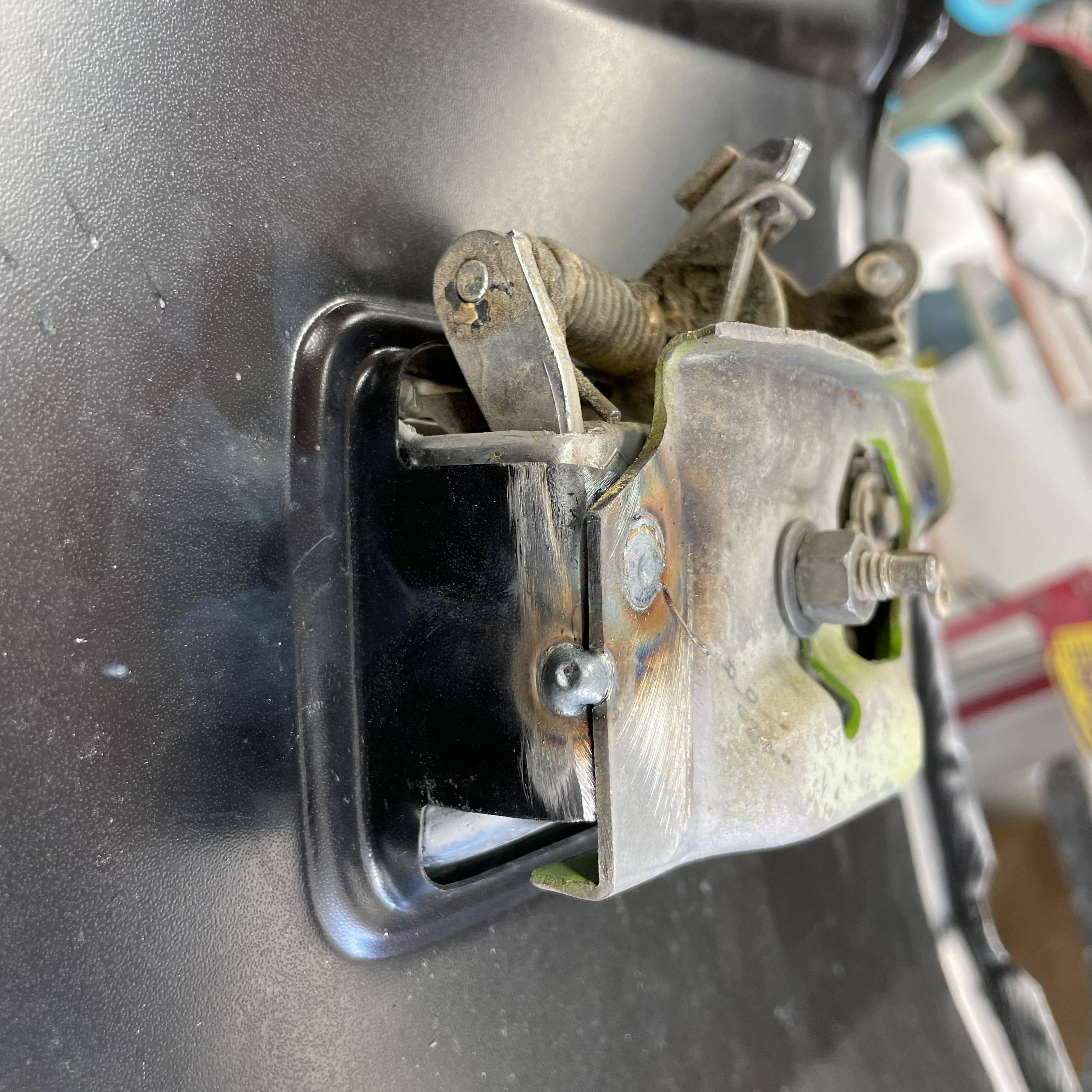

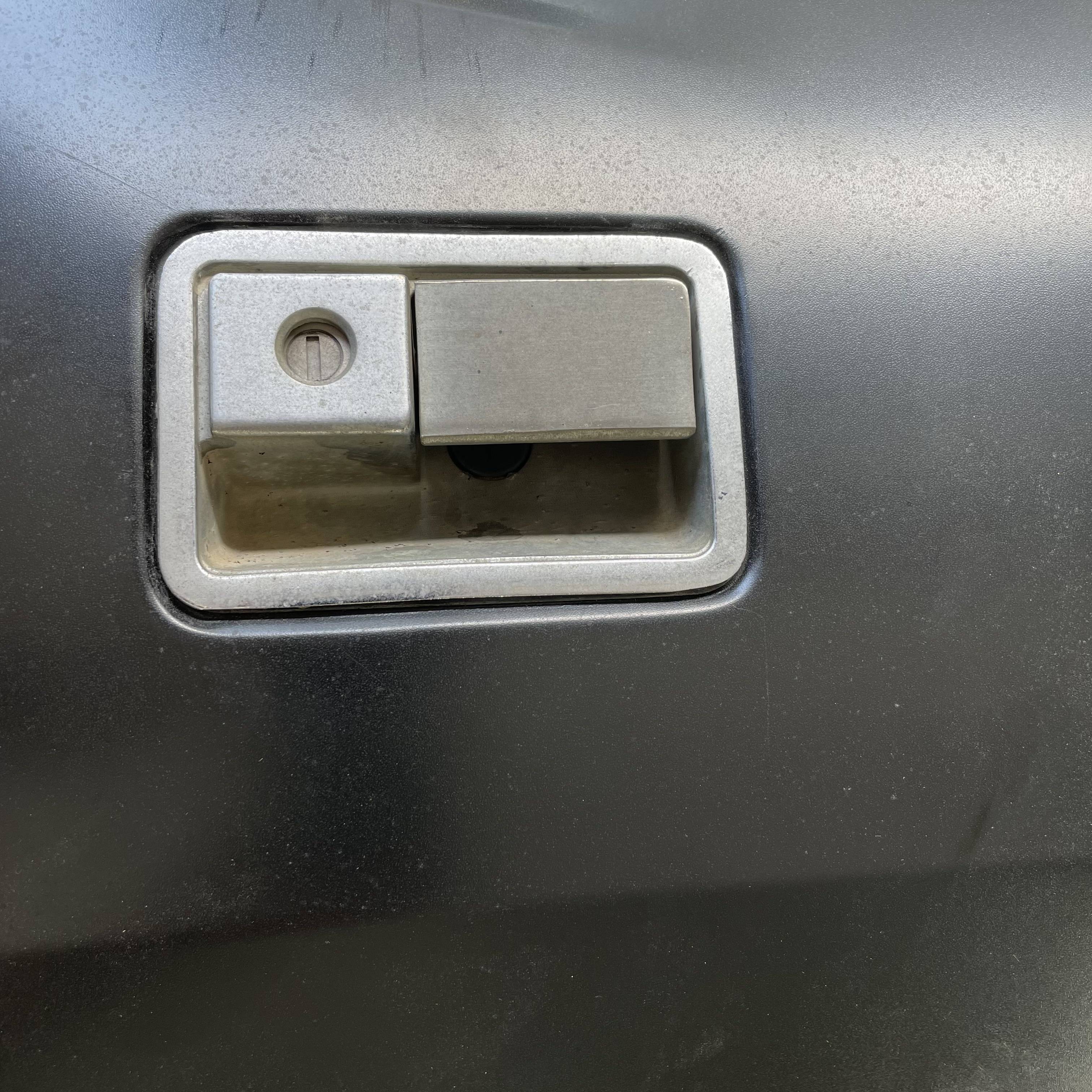

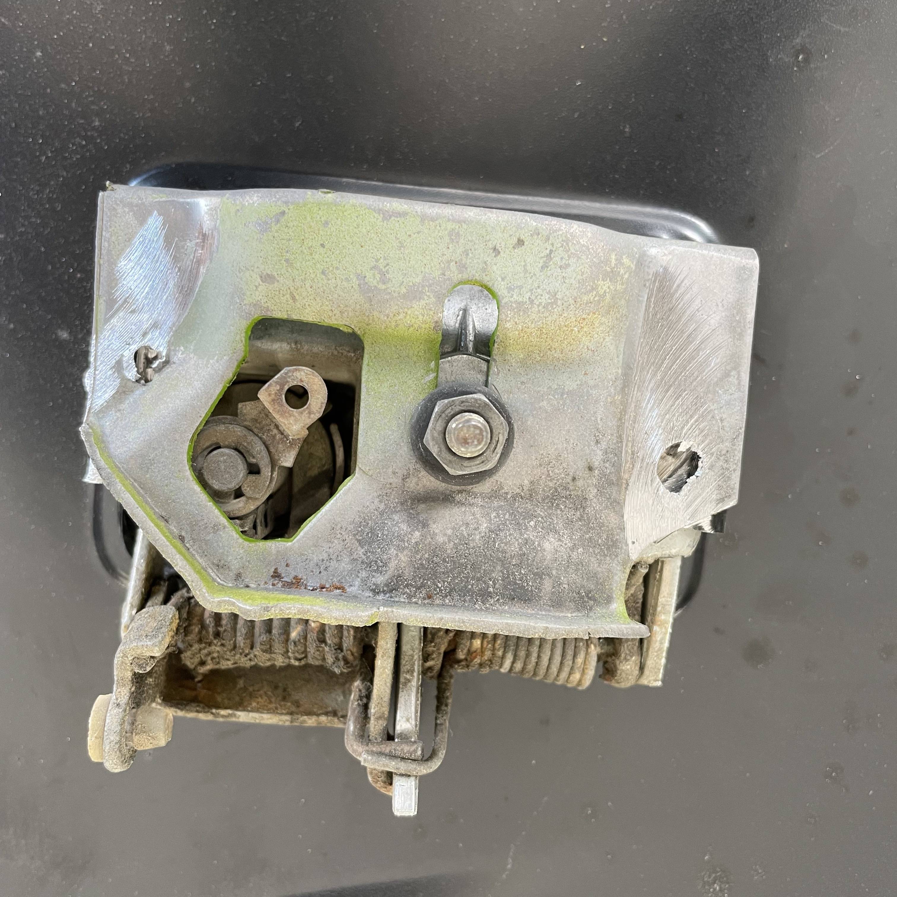

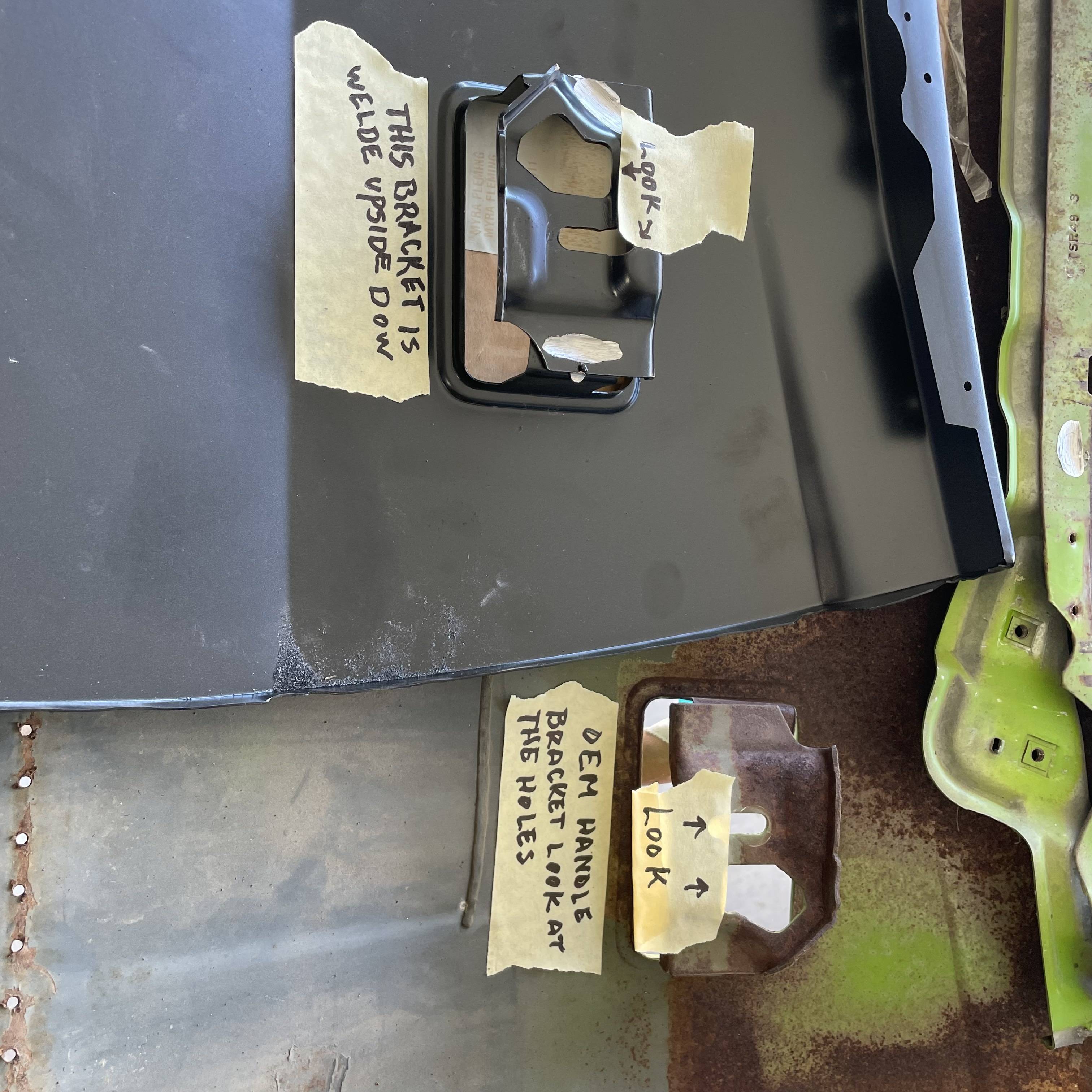

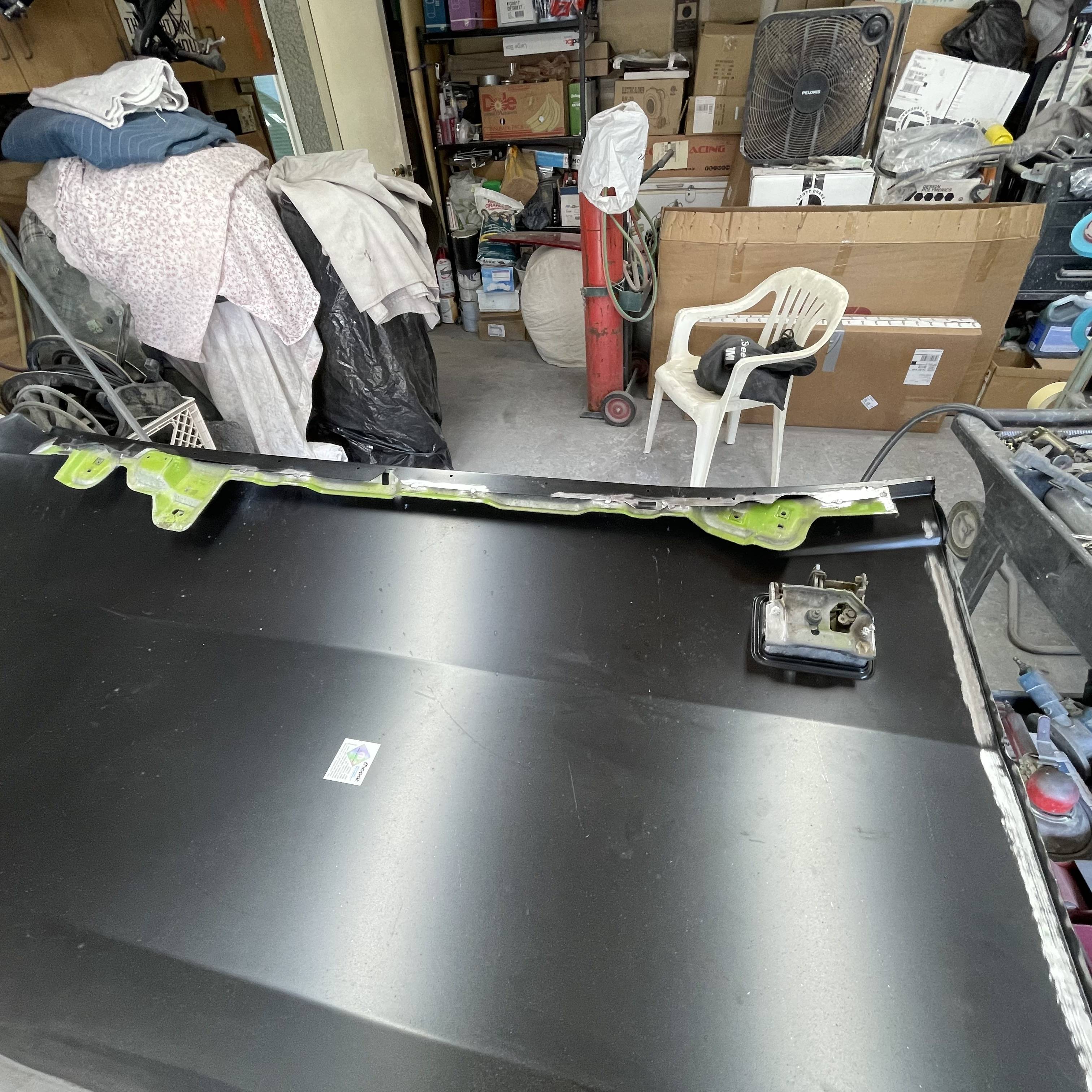

The door skin is good the door handle mount bracket is welded up side down, Check out the pictures, I Checked the door handle fit and did not go into place when I checked with the handle it didn’t work, So I looked a bit closer and found the mistake, Just putting out the word!
I just found it out today, I just removed it and put it in the Wright way. No big issues ,but if I had not thought to check it before ,I put the skin on .Then there’s a problem! I will let them know that they have a problem,That will be on them . So my thing is all this stuff is manufactured by outside sources and some parts must be checked before you install them! I checked everything l can to OEM parts if possible! That’s just me I am a retired body man , And got into checking all parts.
Hey it’s no big deal just remove the spot welds it’s up side down then reweld it.
Just to let you know I called AMD told them the problem, They said thanks, got some more pictures of the door handle repair and door skin attachment bracket for the window regulator assembly, l will also post pictures of door skin panel installation w/ panel bond adhesive.

lucky you caught that before skinning the door thanks for the heads up
It is if you don’t know how! :eek:

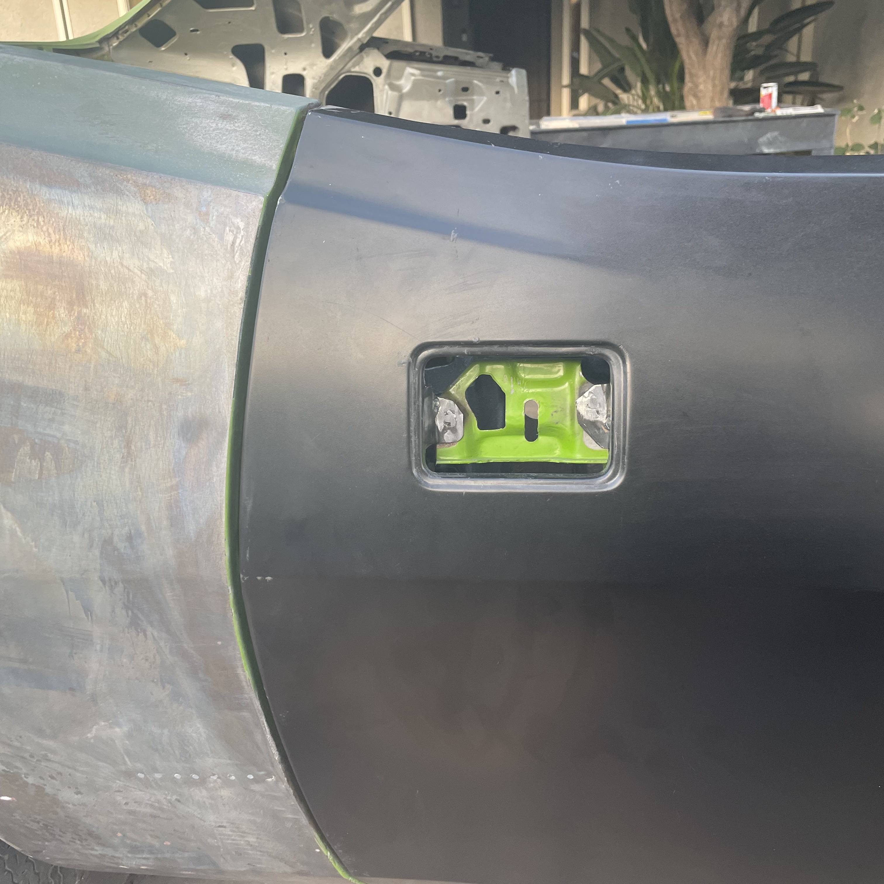

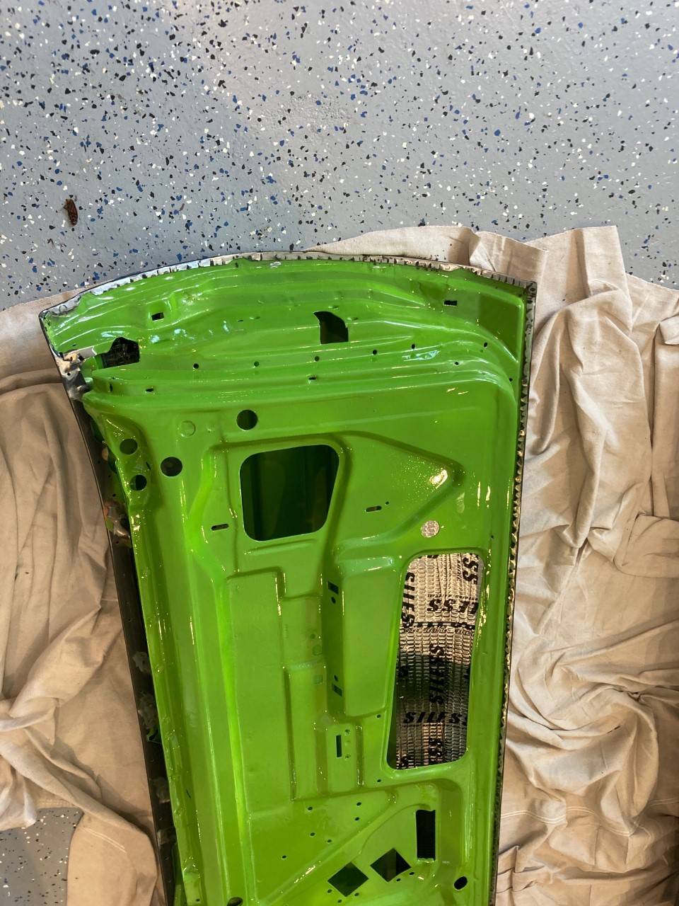

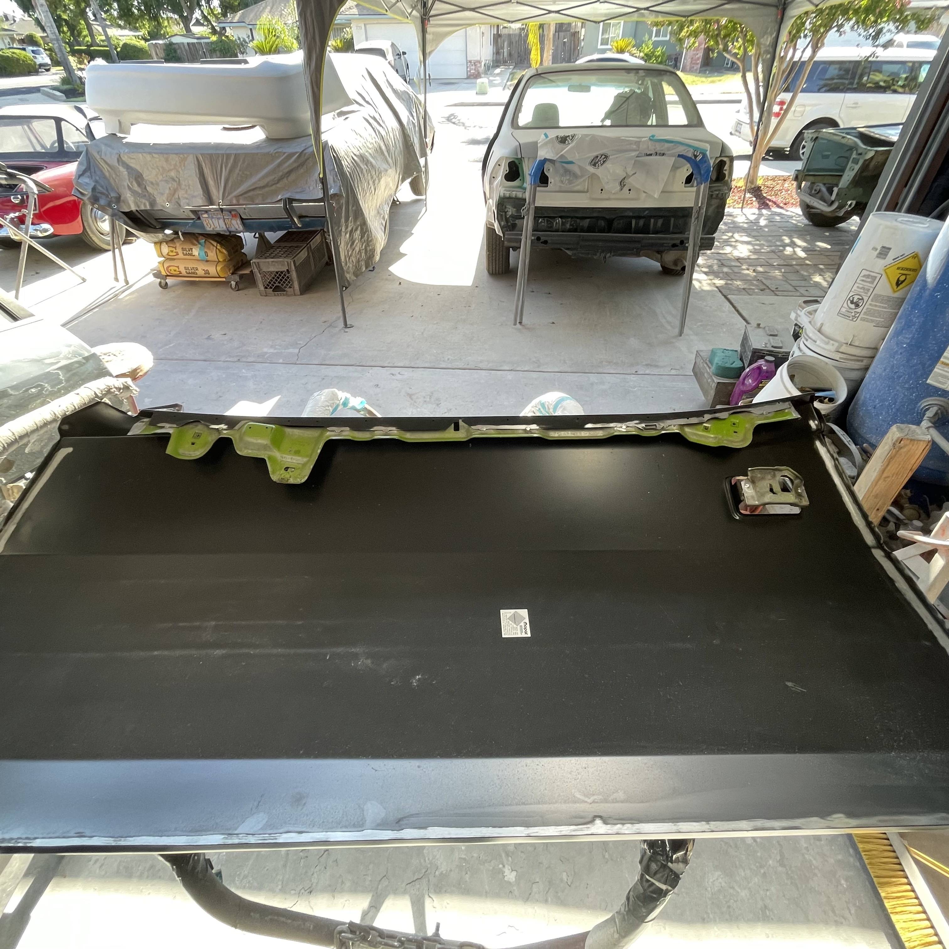

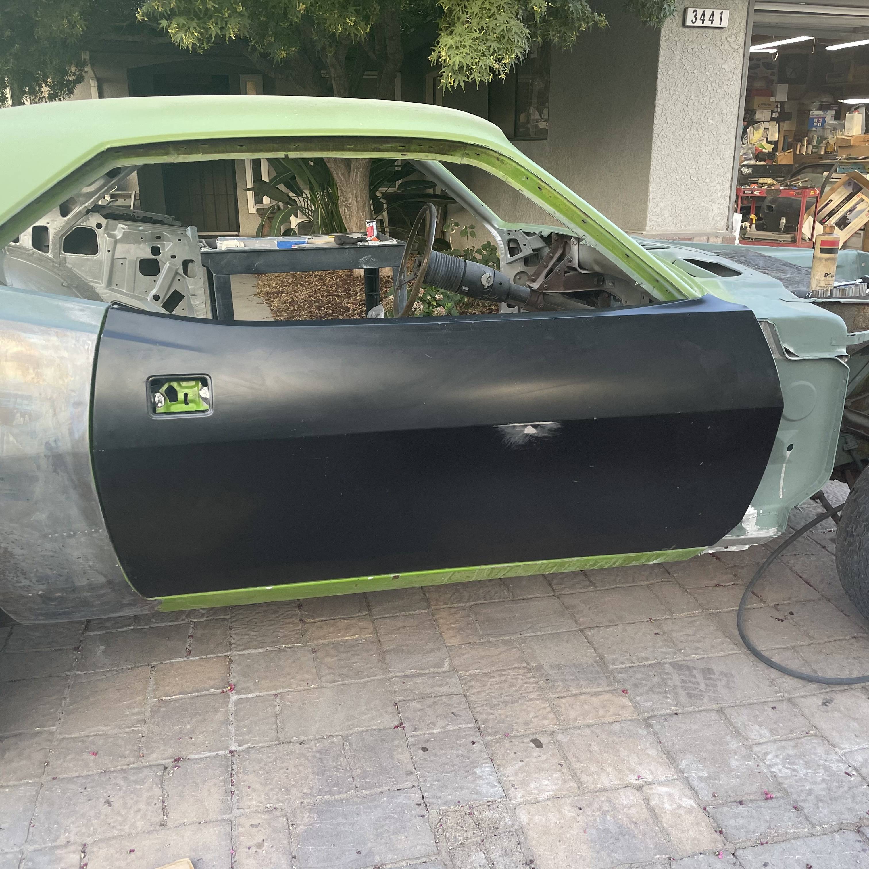

Door skin replaced and made some additional adjustments to fit the rear 1/4 panel need to check front fender, Then I can do some light body work and get it ready for paint

door skin looks great is that limelite green i see nice color.

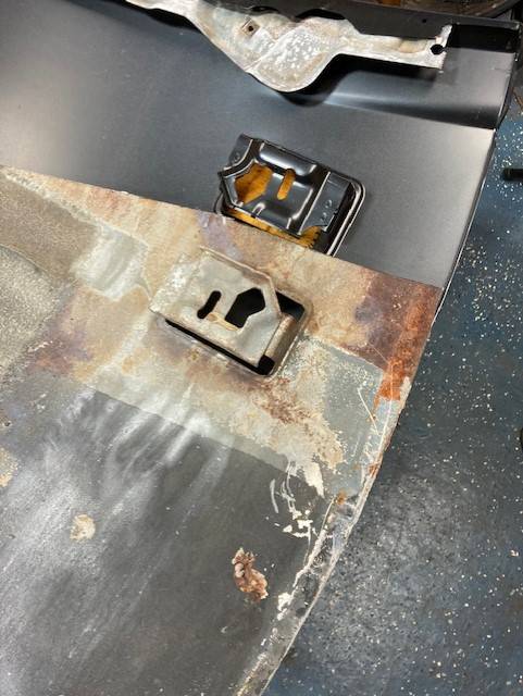

Big Guy: You saved me a lot of work. I had 2 AMD door skins for my73 Cuda. After reading your post I checked and one was upside down. Picture.

Got my door skins put on and the AMD bottom for the one that was rusted out for my 73 Cuda. Turned the door handle attachment the right way (as previous post). Overall, pretty pleased with the job.
