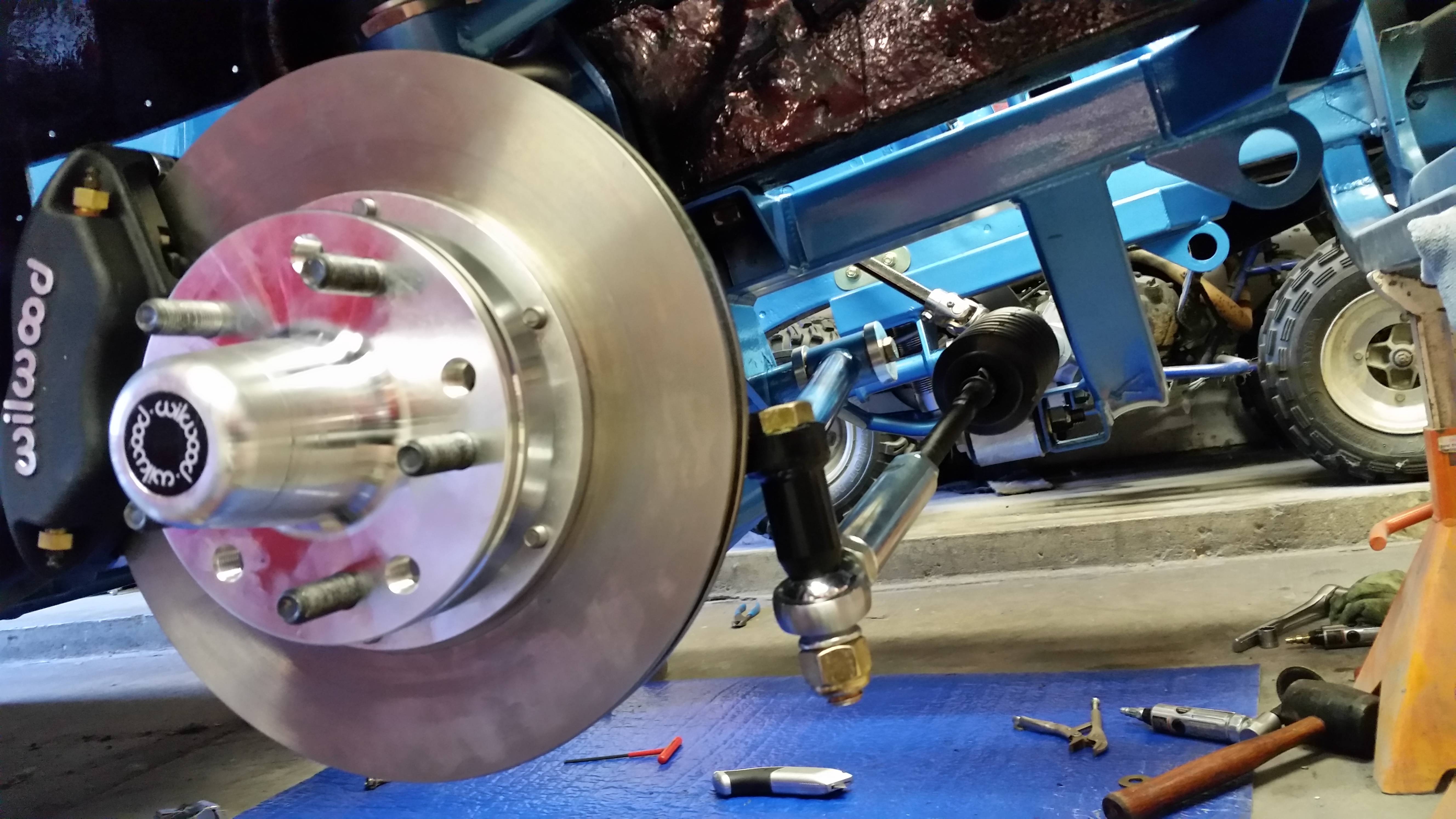

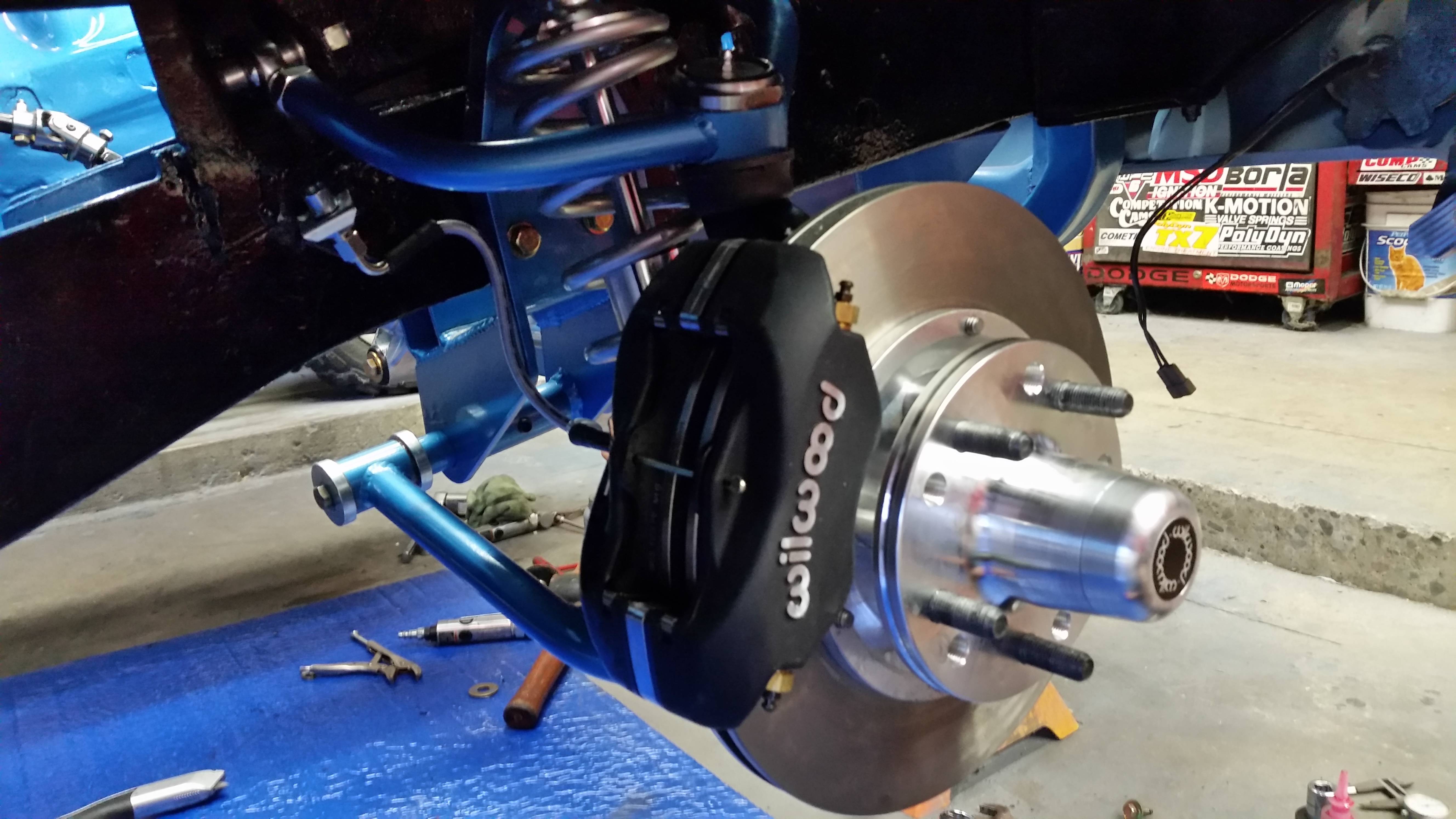

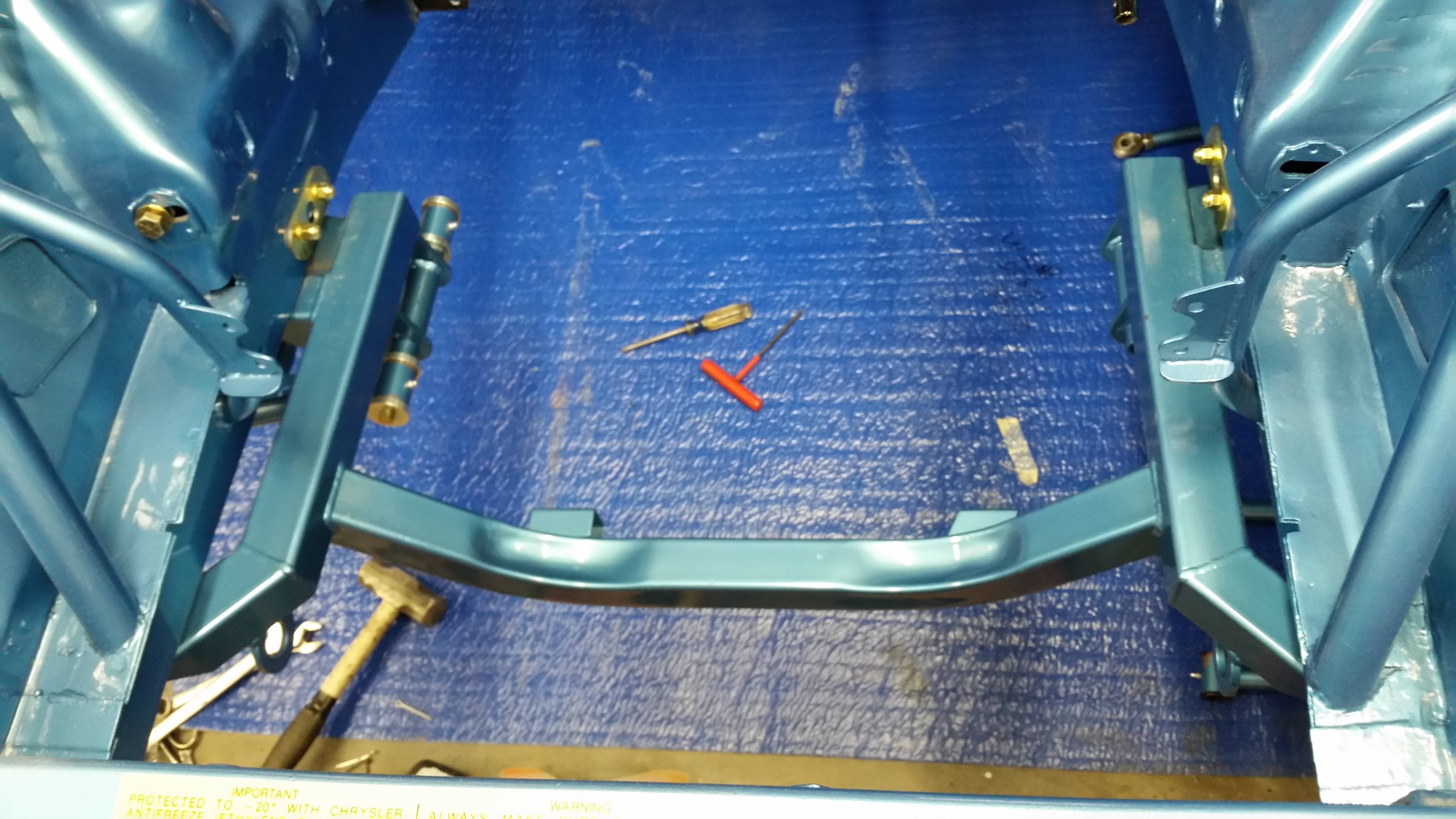

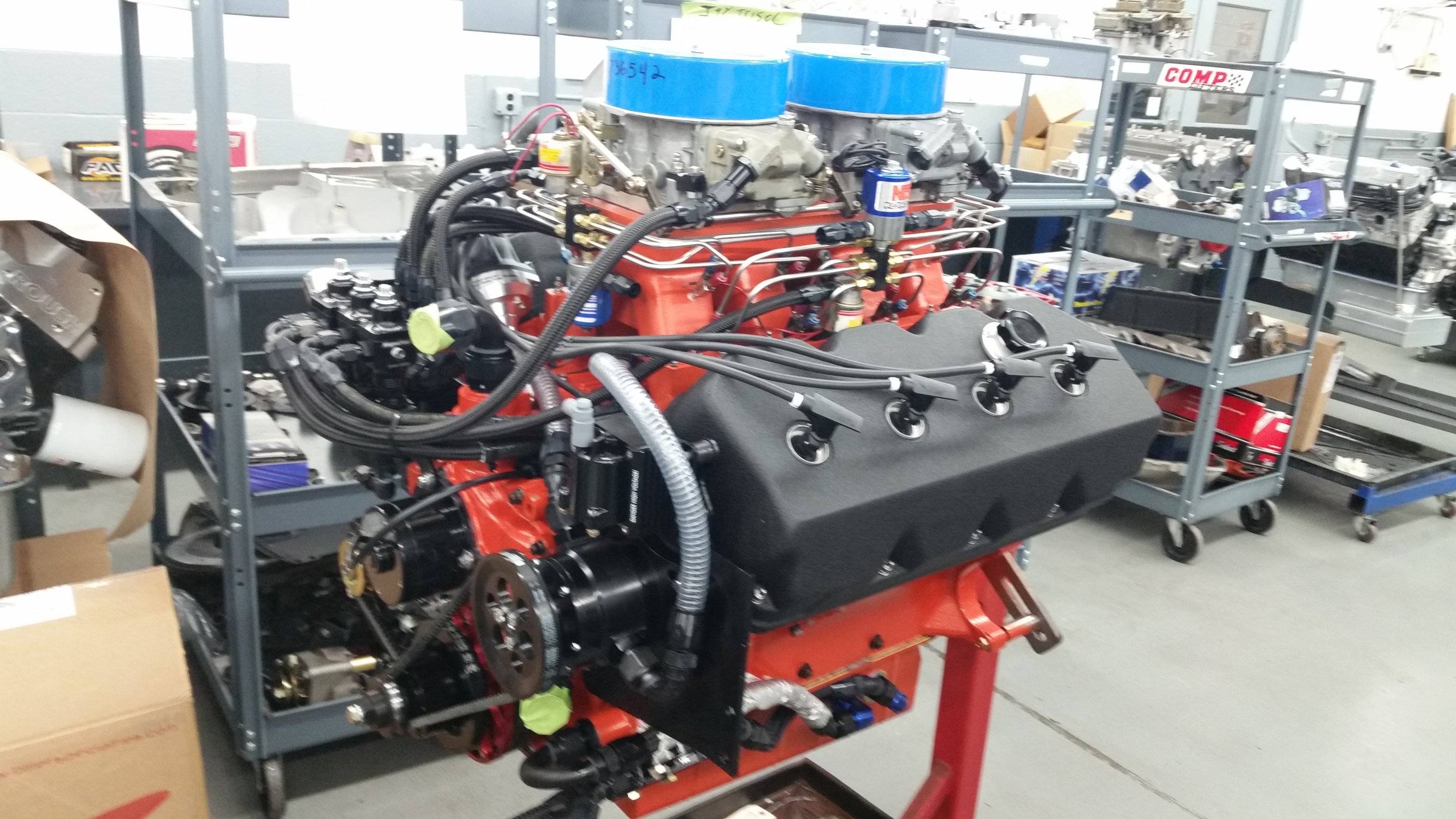

I have an RMS on my car. Makes for plenty of room for big tube headers. I can run a flat bottom 10 qt oil pan with no ground clearance issues. More suspension travel, adjustable shick settings, adjustable ride height, less weight from factory pieces. I can also install and remove the headers in one piece with the engine still in the car.
