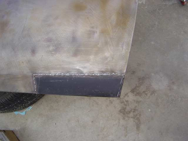

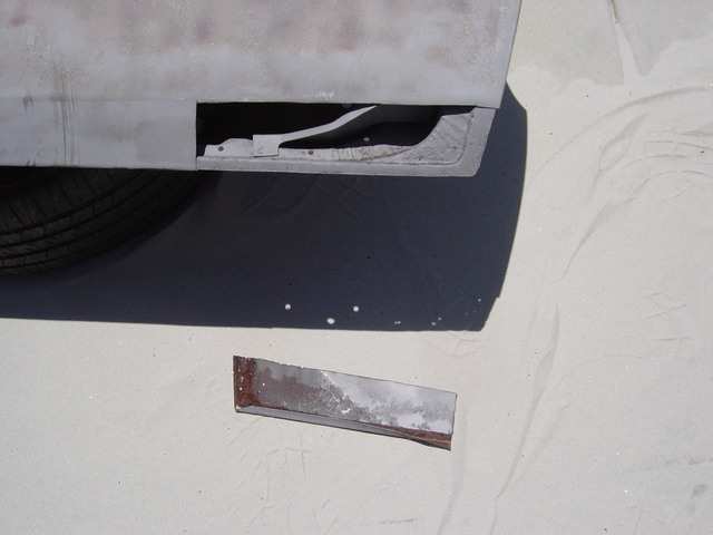

Just make one… grind thru the skin along the edge and use a cut off wheel for the rest… use the old piece as a template for the patch. I use a wet rag to cool the metal when it gets hot to avoid warpage when cutting, and when stitch welding in the new piece.
The skin is just folded over the inner structure, easy to do, but easy to f-up. Clamp the edges down hard and work slowly. If you don’t have the tools you could use body panel adhesive along the edge and glue a similar strip along the back side. That stuff is incredibly strong and will also keep water out of the gap.
