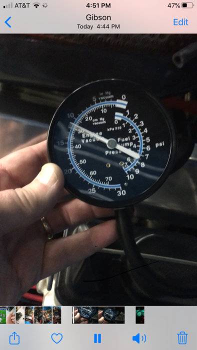

Can you school me on allowing too much vac, I’m running a comp cam extreme in this stroker. Currently makes 12-13” of vac. I’m learning everyday.
Thanks for your feedback.

The vacuum I was meaning is the vacuum generated in the crankcase not the inlet manifold vacuum.
I will try to explain please ask for clarification if I do not explain it right.
This is the basic principal.
Imagine the PCV valve is a 2mm hole that controls the amount of vacuum that can build up in the crankcase. If you drilled this hole out to 6mm this would allow to much vacuum in the crankcase which can hoover the oil from where it should be in the engine and suck it through the PCV system in to the inlet manifold. This can cause oil consumption. It can also cause the engine to run lean at idle or because it can get extra air from the PCV valve it can have a high idle speed due to the air leak. I did one engine that idled about 1100 rpm with the throttle blades completely closed and we had the restrict the PCV system before we could control idle speed.
Do you have a large scale vacuum gauge and know how to measure the vacuum in the crankcase?

I understand what your explaining. I’ve always hooked the vacuum gauge from the port on the back of the six pack manifold. That’s where I’m getting 12-13” of vac on my gauge. That’s the the only way I have ever measured it and tuned by. I don’t know what the large scale is or how to measure that.

And yes, if I remove the hose from the PCV the idle increases.

OK that gauge is fine I just meant a large well graduated gauge that you can see easily and that will allow you to see a small reading.
The crankcase vacuum at idle will only be 1 or 2 inches of mercury symbol (in Hg) on your gauge.
Here is an article I found that will tell you all you need to know and how to do the test.
It is a well written article and explains all far better than I can.
Positive Crankcase Ventilation (PCV)

One thing I forgot to mention it can take a minute or two for the vacuum to build up in the crankcase. Especially if you have leaks as mentioned in the article.
If you have leaks just make sure you have some suck on the valve and this rpm drop test is mentioned in the article.
Ideally the vacuum should rise to 4 or 5 in Hg when you build the revs up.
It can stay about the same but you would not want it to go high or really low when at say 2500rpm.
