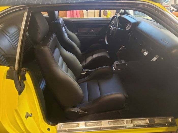

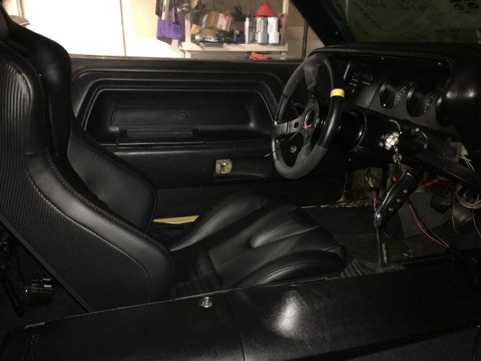

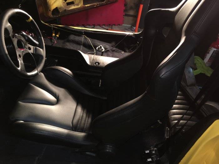

    My camera on my phone stinks but here you go...the front seat is about 8 inches from the floorboard...I’ve got about 3-4 inches of headroom.... like I said I can wear my helmet andsit comfee in the car...

    Few more....if your close to central ohio, your more than welcome to come check them out...I’ll post some better ones when I get the new steering wheel in tomorrow....

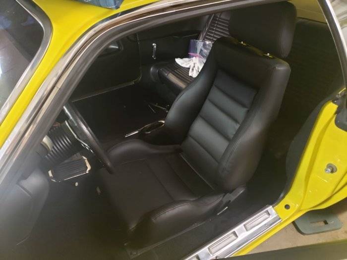

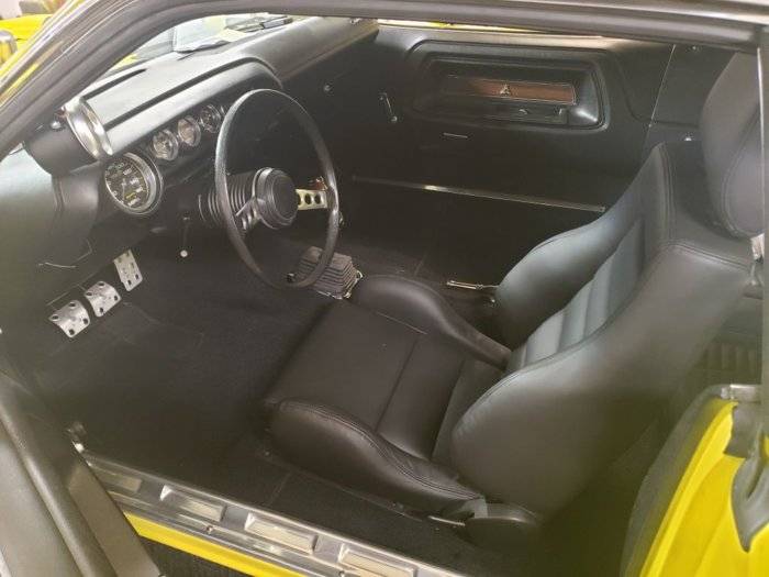

    I ended up ordering the leather GTS-II seats, had them shaved an inch so they're supposed to be 3" thick now. I went with the 'Wedge' brand brackets because the local race car shop said they fit the best and fit the lowest.
    Initial install was not good, the brackets fit the floor nicely but the seat was a couple inches too far forward, luckily I was able to bolt some steel extensions to the sliders so the seats can slide back 2 more inches, now I'm happy, I can wear a ball cap in the car and the seats are pretty comfortable.

    Front of the seat is the highest point, it's about 6.5" from the floor.
