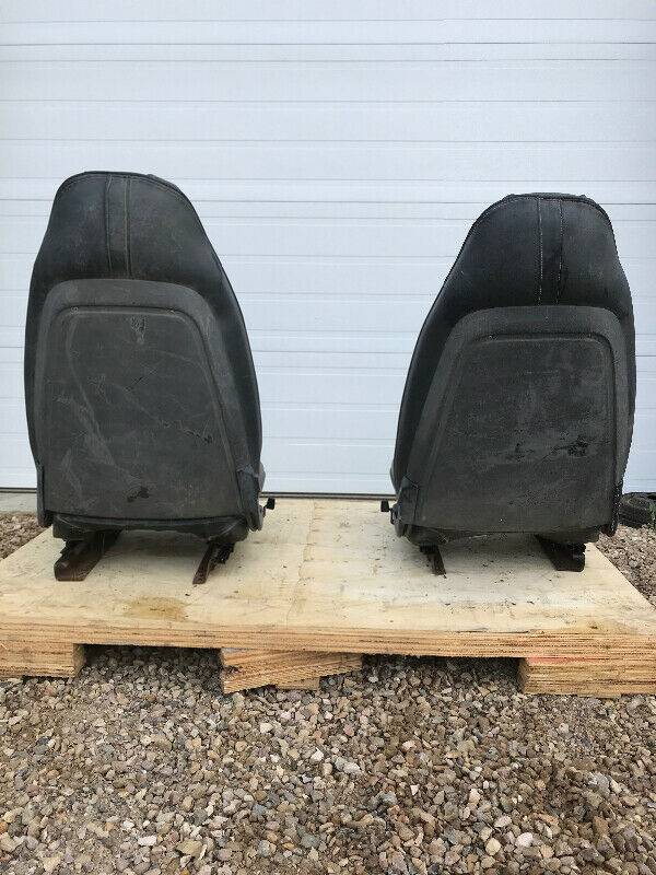

Oct 26, 2020 #1 C cudashark Member Joined Mar 26, 2011 Messages 8 Reaction score 0 My cousin needs seats for his 73 Barracuda. The seller says these seats are from a Plymouth but he does know what model. They look correct but are they?
Oct 26, 2020 #2 C Chryco Psycho Well-Known Member Joined Dec 28, 2008 Messages 5,021 Reaction score 2,661 Location Panama Look like 70/71 , they changed something almost every year , but yes they will fit. 73 & 74 had soft backs / no hard rear panel Last edited: Oct 27, 2020
Oct 27, 2020 #3 challenger6pak Well-Known Member Joined Feb 27, 2011 Messages 4,094 Reaction score 924 If you use these seats the 73 upholstery won't match the foam underneath. You would have to go with 70-71 upholstery.

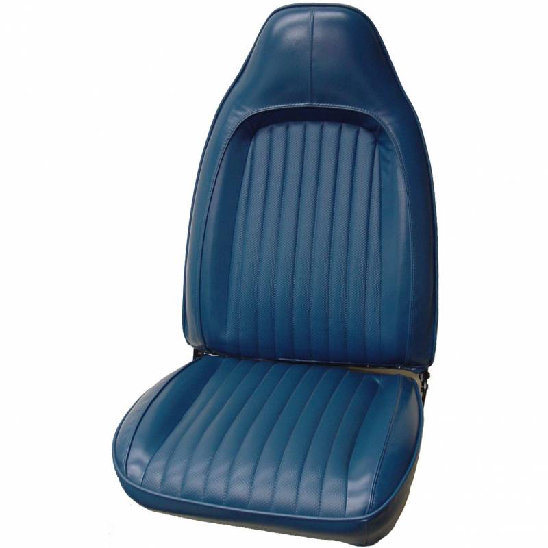

Oct 27, 2020 #5 340challconvert Well-Known Member Joined Feb 13, 2011 Messages 5,484 Reaction score 2,944 Location Parsippany, NJ Looks like 70 ~ 71 seats with the inserts redone non stock 73 seats look like this; They will physically fit though
