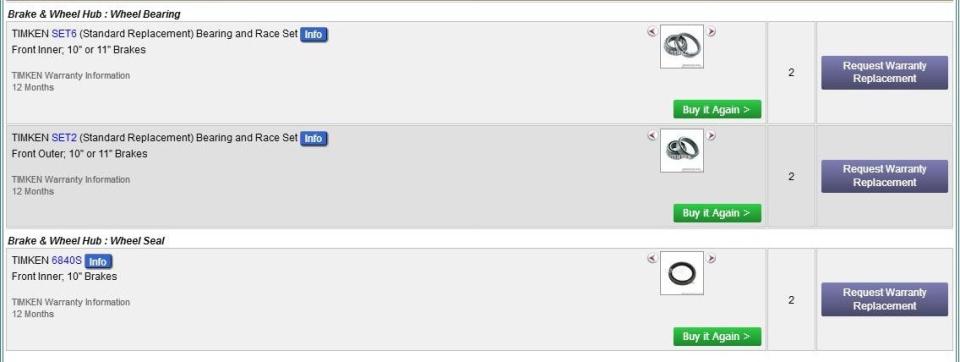

IMO go with Timken - this is what I recently ordered from Rock for my own 70 with discs-

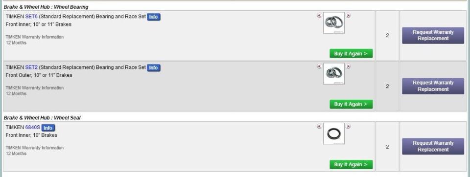

If you look up them on AutoZone website, scroll down in the description and the exact size specs are listed. Timkin uses item numbers such as SET2 and similar.
