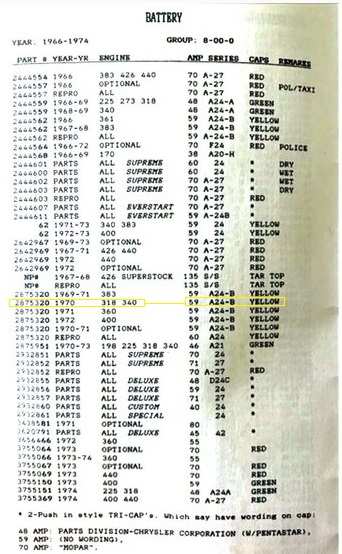

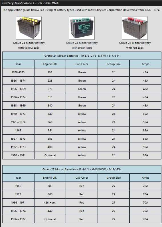

Yellow caps on a Group 24 battery for the 340 in 1970. The part number for the battery is 2675320.
The battery part number's last two digits are on the Broadcast Sheet (Line 3), if you have one.

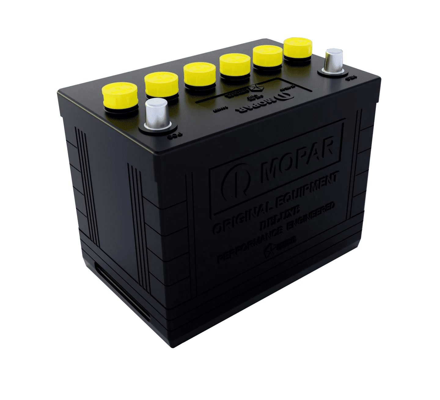

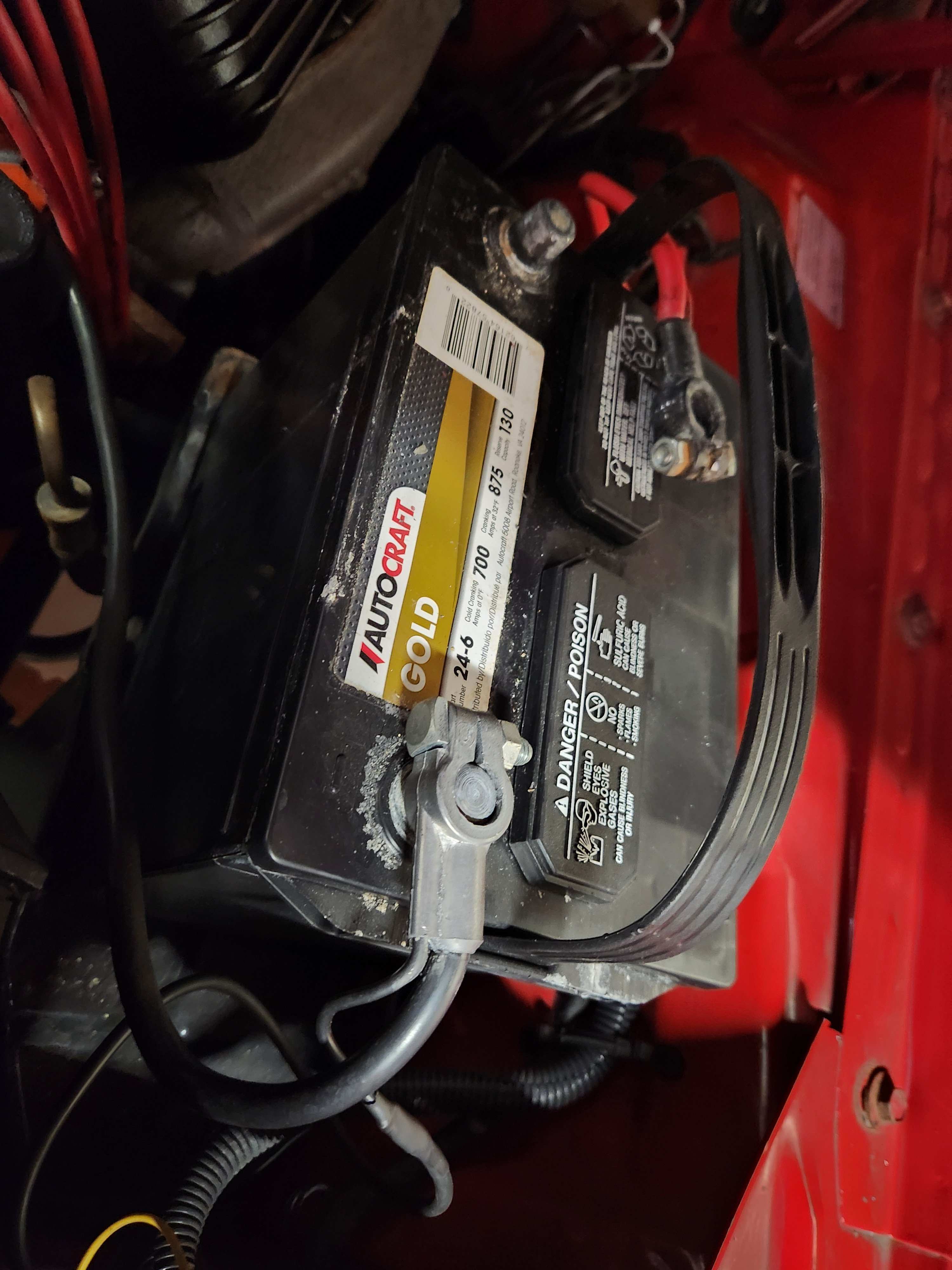

Are you going for a reproduction battery or a flattop generic battery with a battery topper or a yellow cap kit?

with the decals for the top and side and the plastic caps I bought yellow just wanted to make sure thanks for the info I printed that chart out good to have

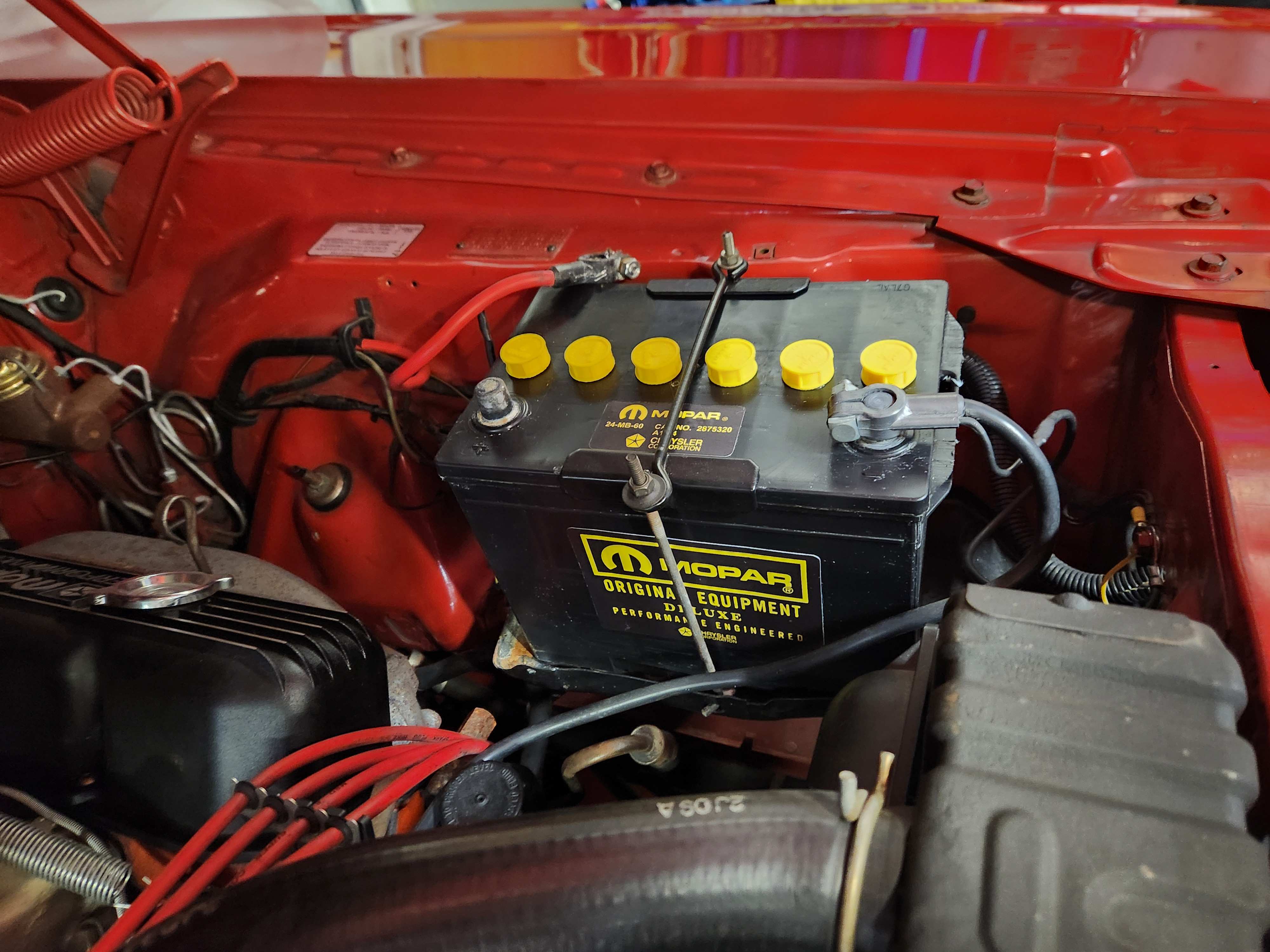

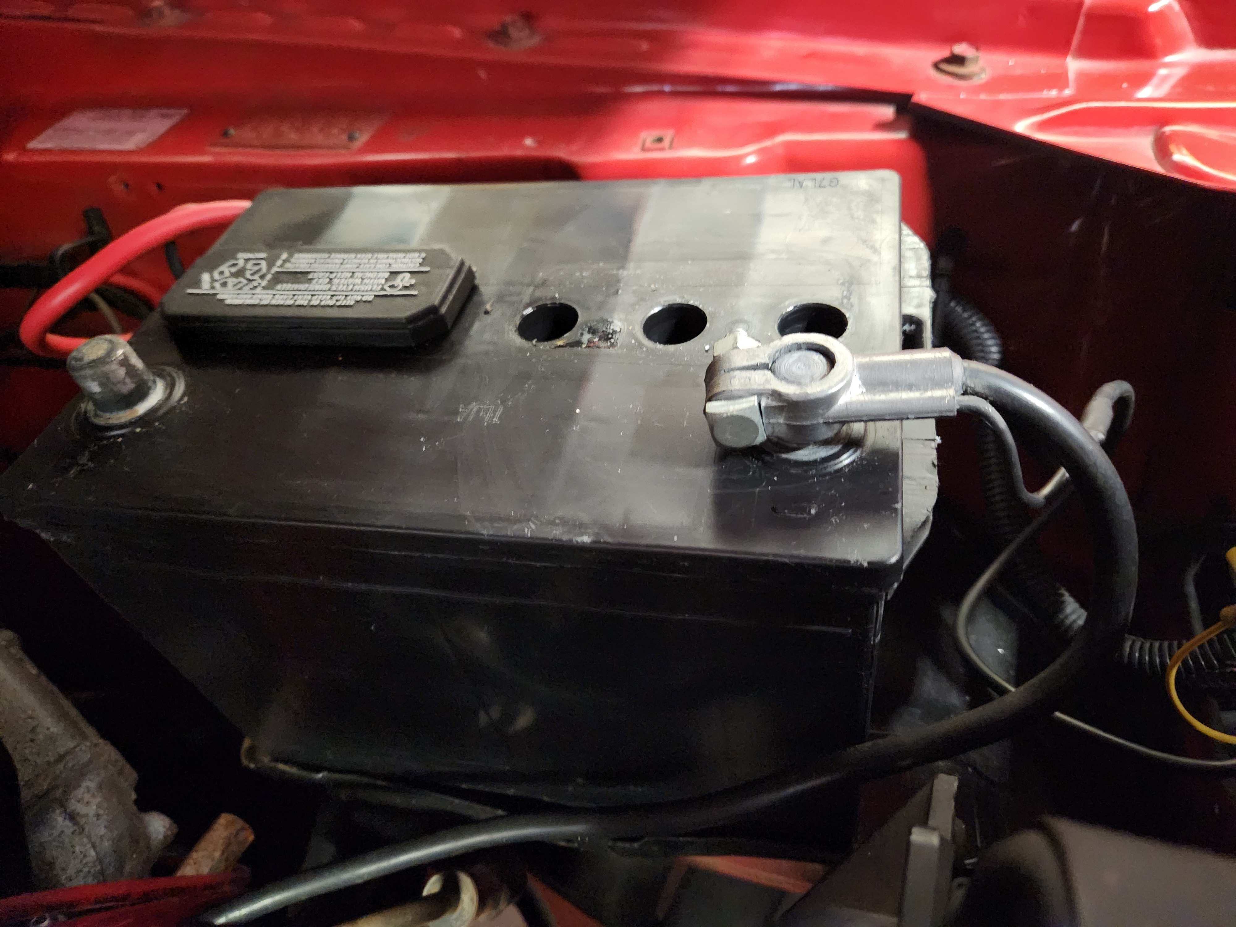

I did the cap kit on my red 70' 383 Challenger R/T.

Here's a thread I started over on A Bodies.
