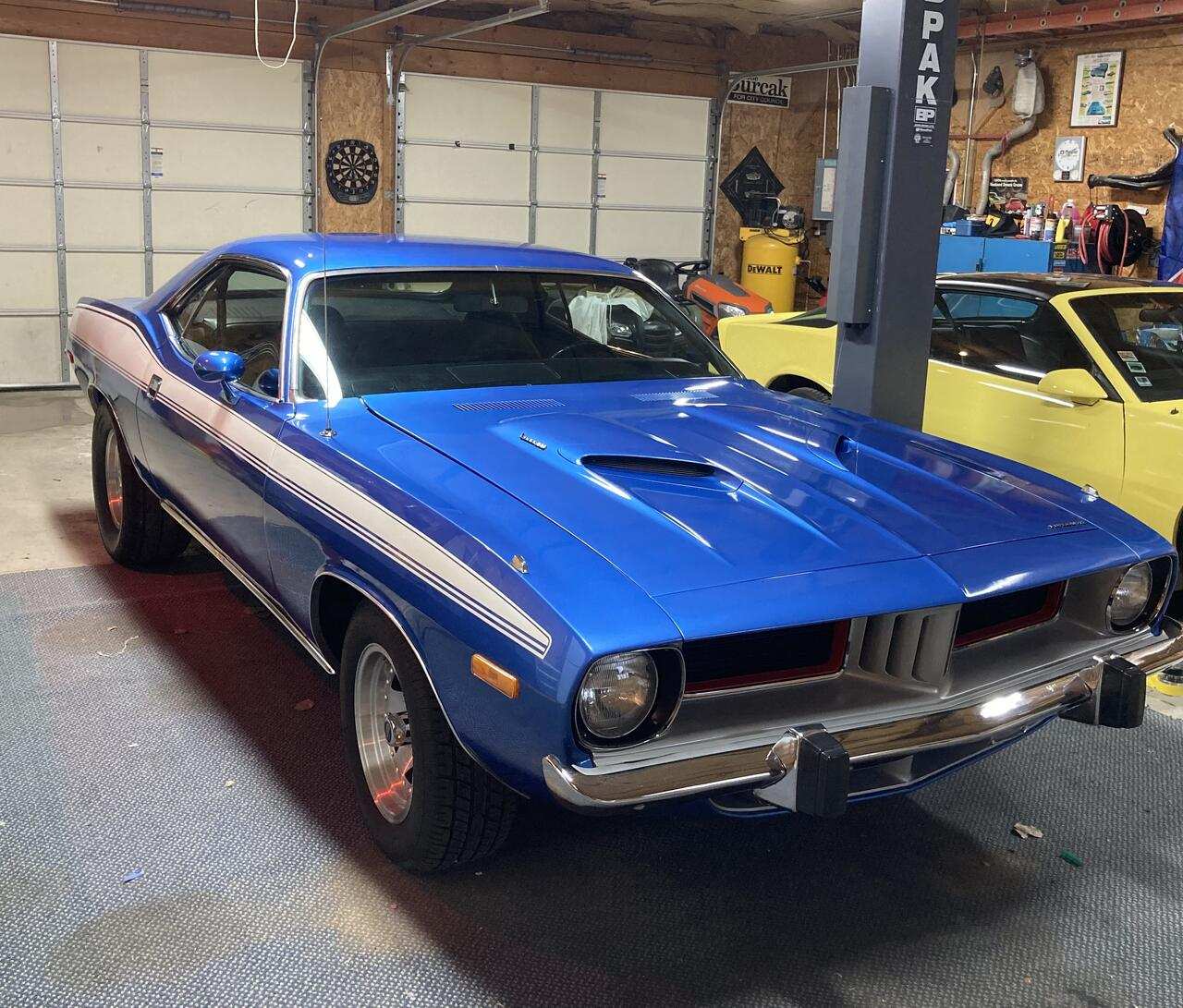

Hi all, I own a 1974 360 Cuda originally purchased in 1999 and sold in 2010. I was able to buy the car back in 2022 but it had changed hands a couple times and someone had replaced my Magnaflow system with Headman Headers. to manifolds with a flowmaster system. the sound was terrible and installed new headers to bring back the CAM sound. unfortunately the flowmaster are restrictive and doesn't have the aggressive sound anymore. I was looking at a performance kit from Magnaflow model number 15851 or 15852. Does anyone have experience with either of these set ups? Magnaflow only rates them for 1970 to 1972. However, they do note the 5.9 (360) as compatible. Thoughts?
