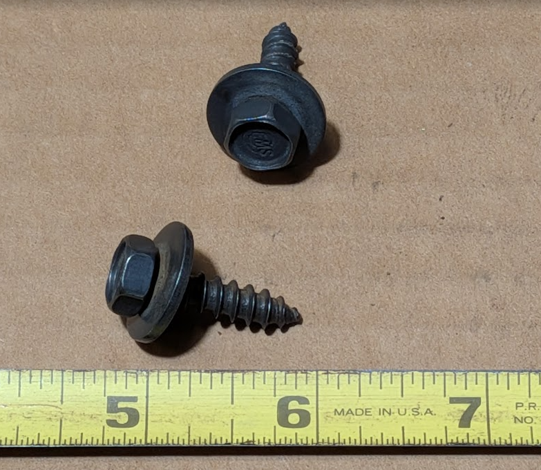

The screws to secure the bottom of the rear seat back frame to the floor brackets are 1/4"-14 x 7/8" with a 7/8" washer and 7/16" hex head. The following image shows the screws:

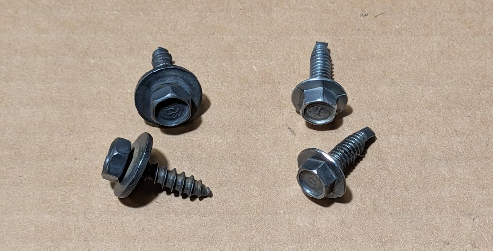

The 1973 - 1974 E-bodies employed a different attachment than 1970 - 1972 E-bodies with a 1/4"-20 x 13/16" flanged head screw with 3/8" hex head. The following image shows the 1970 - 1972 screws and 1973 - 1974 type screws compared:
The later screws may vary at the point depending on the supplier.
