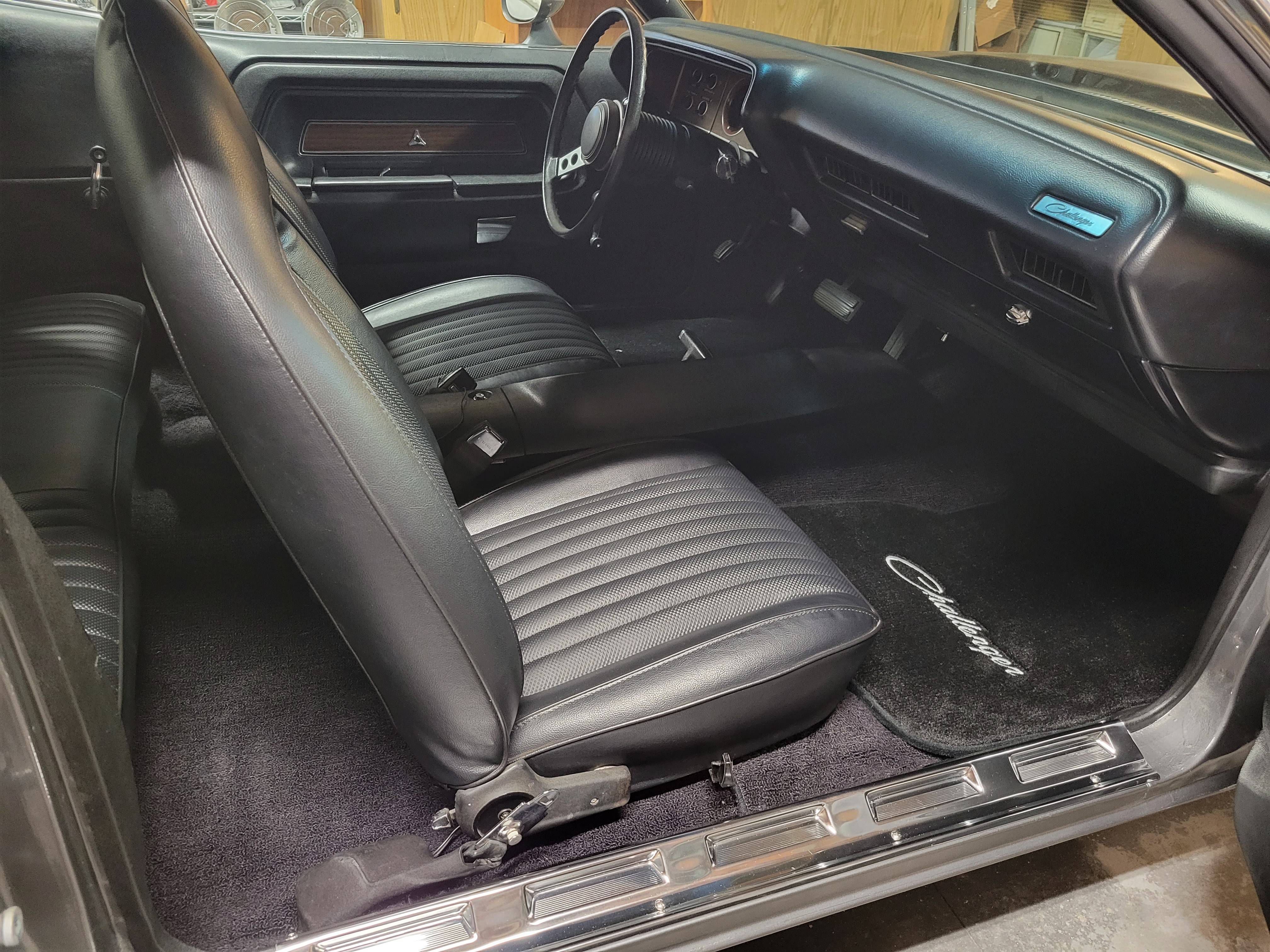

There are two wires that go to the brake pedal switch. It's not clear on the wiring diagram which color/one goes where. Does it matter? If so, which one goes towards the front and which one goes towards the rear? Thanks in advance. So close, I can taste it! Interior-Pass side.jpg
