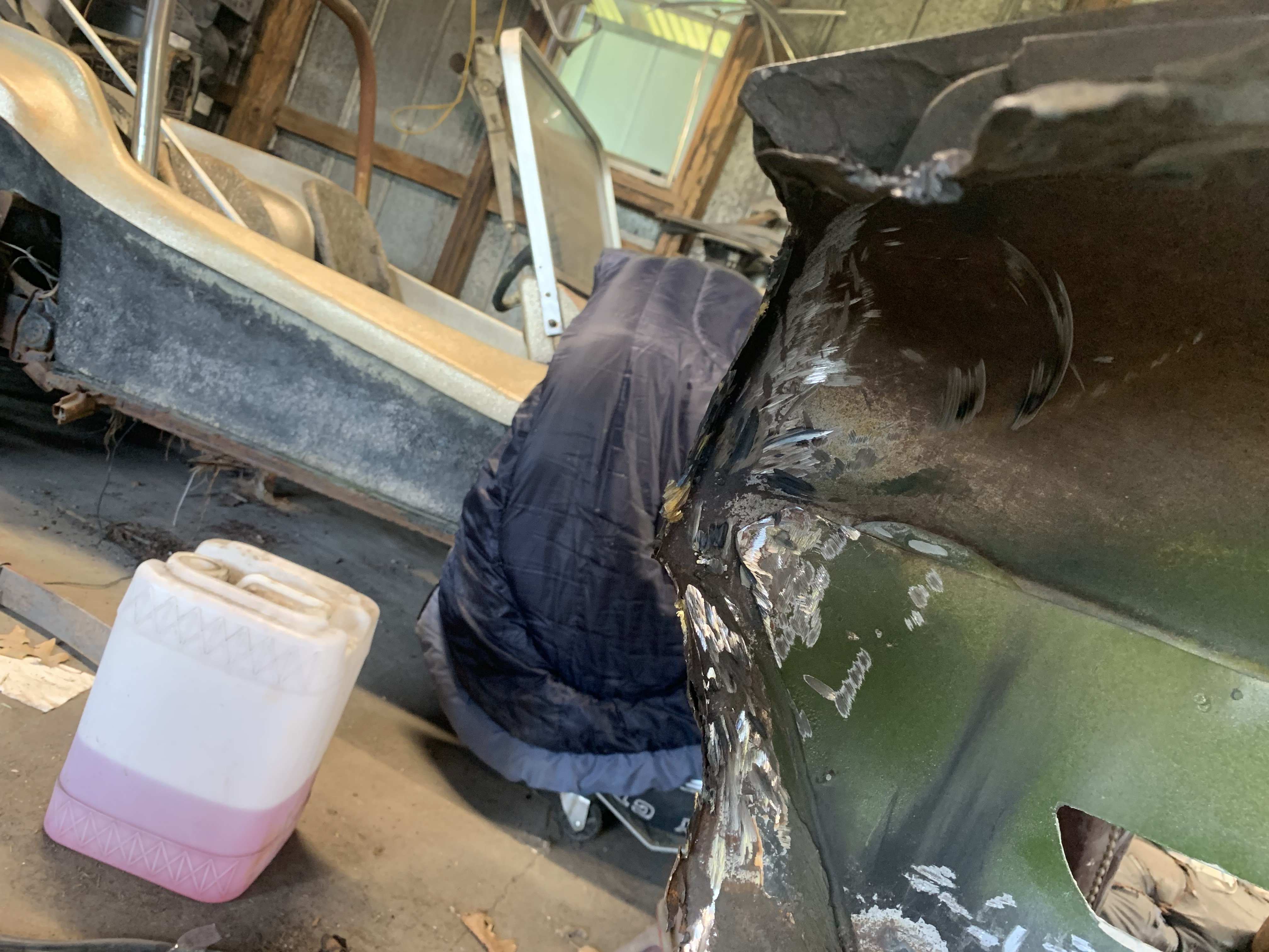

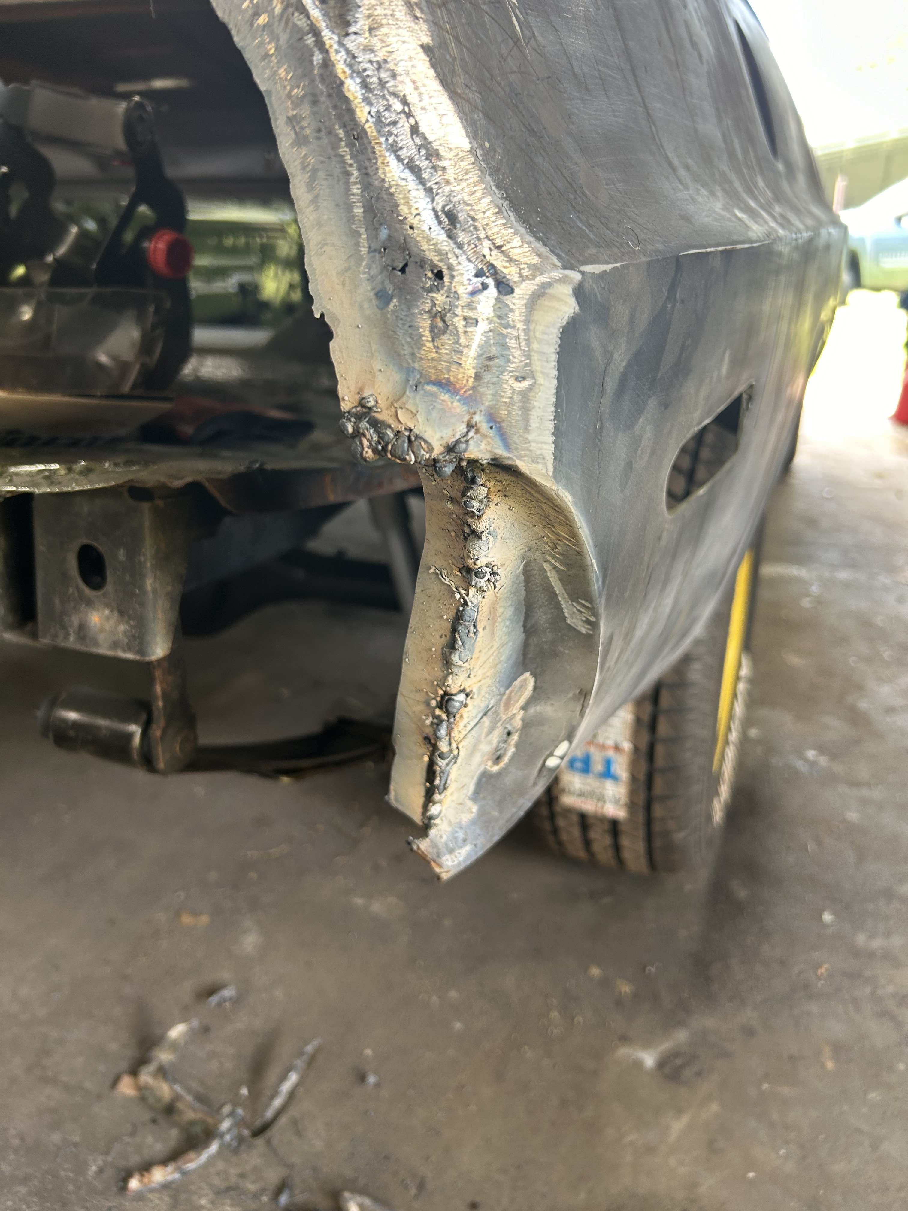

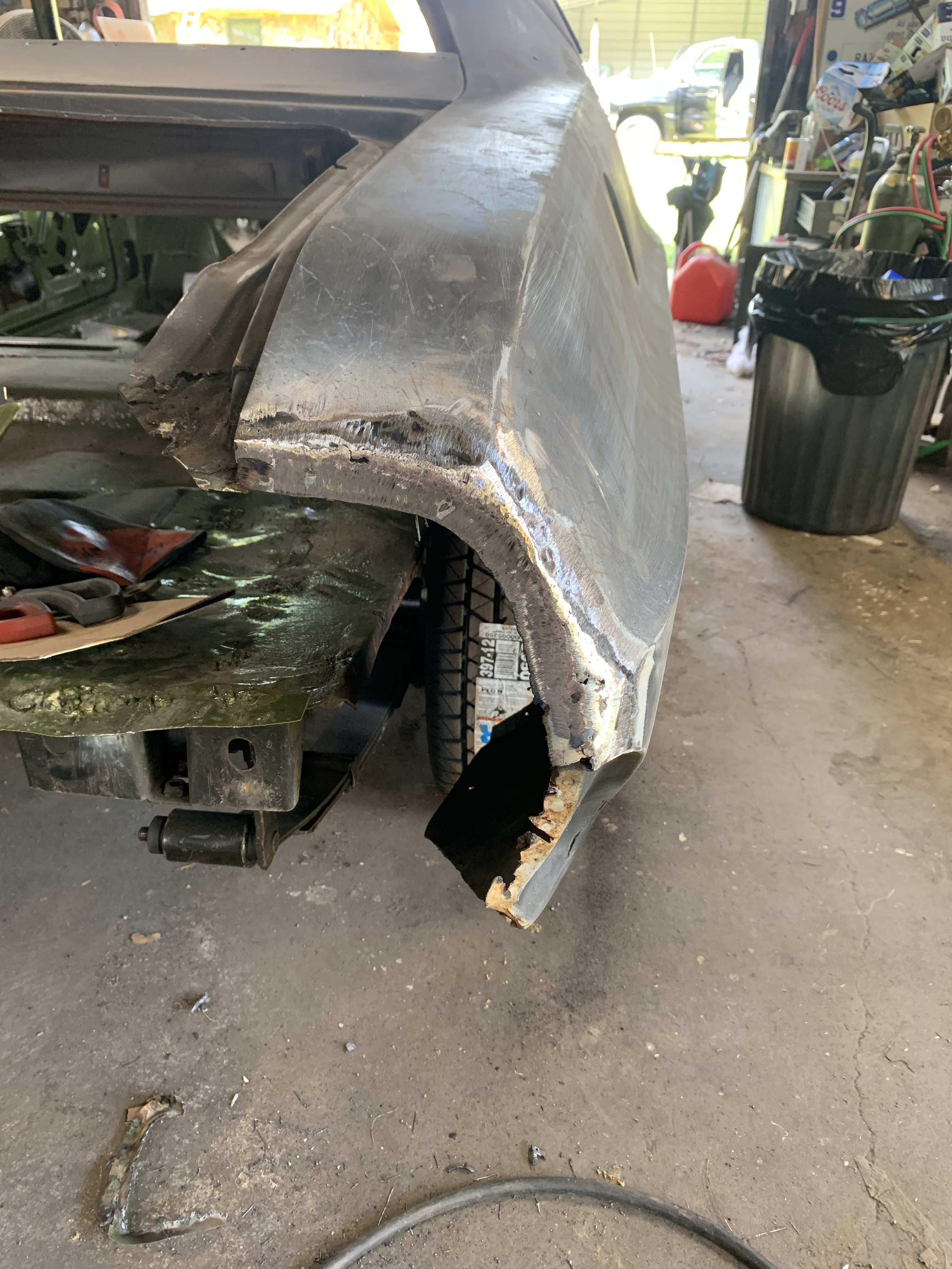

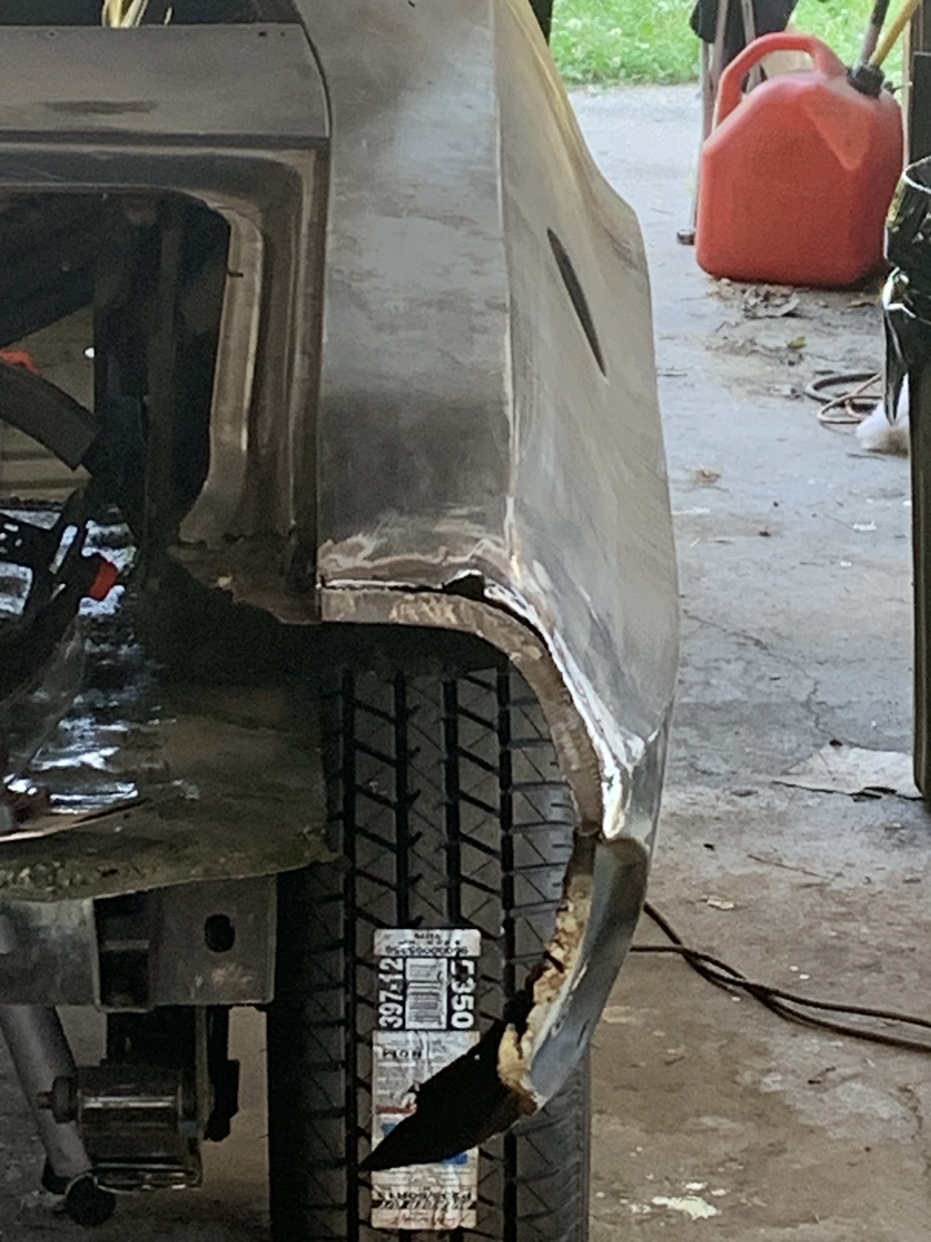

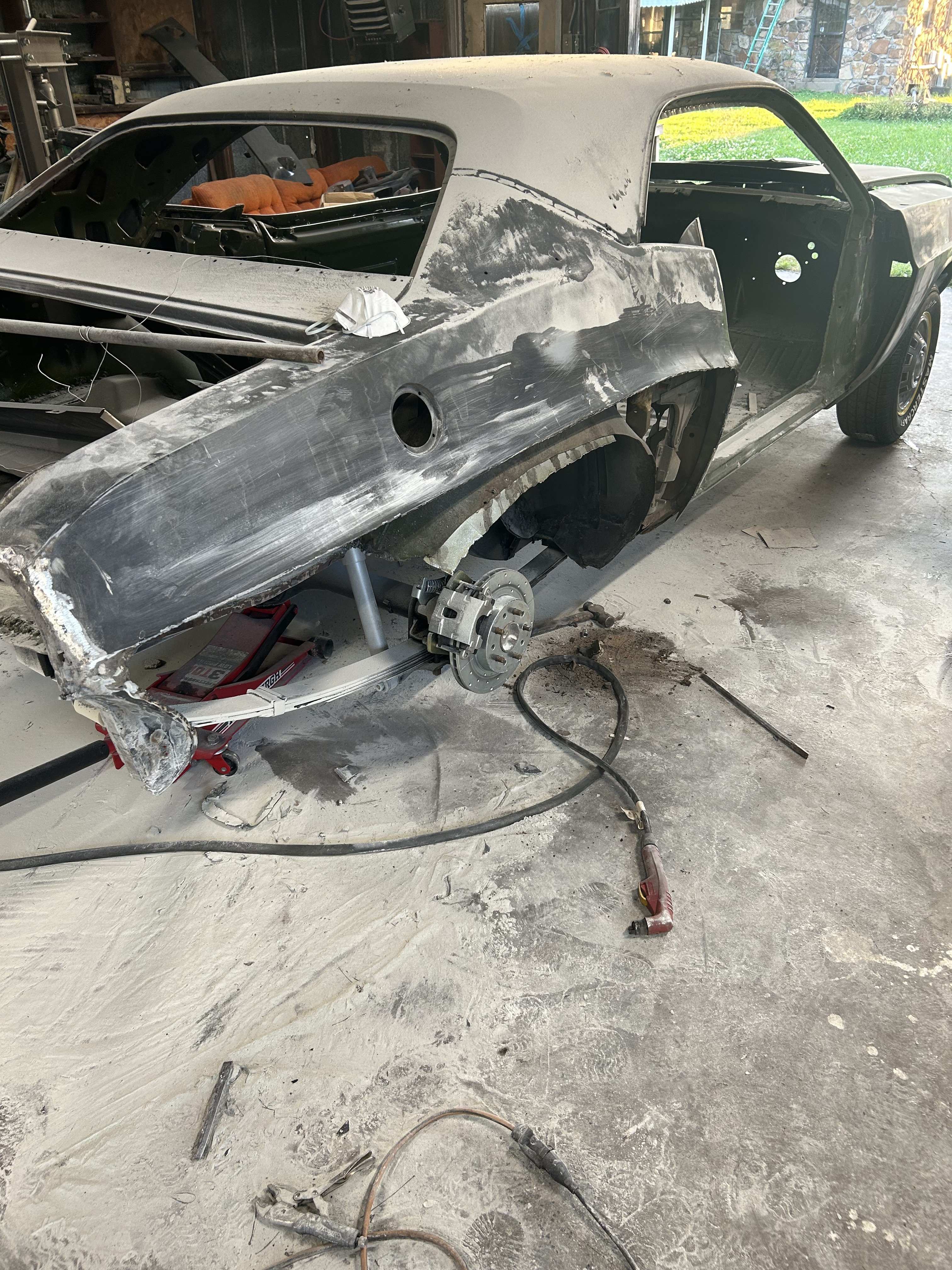

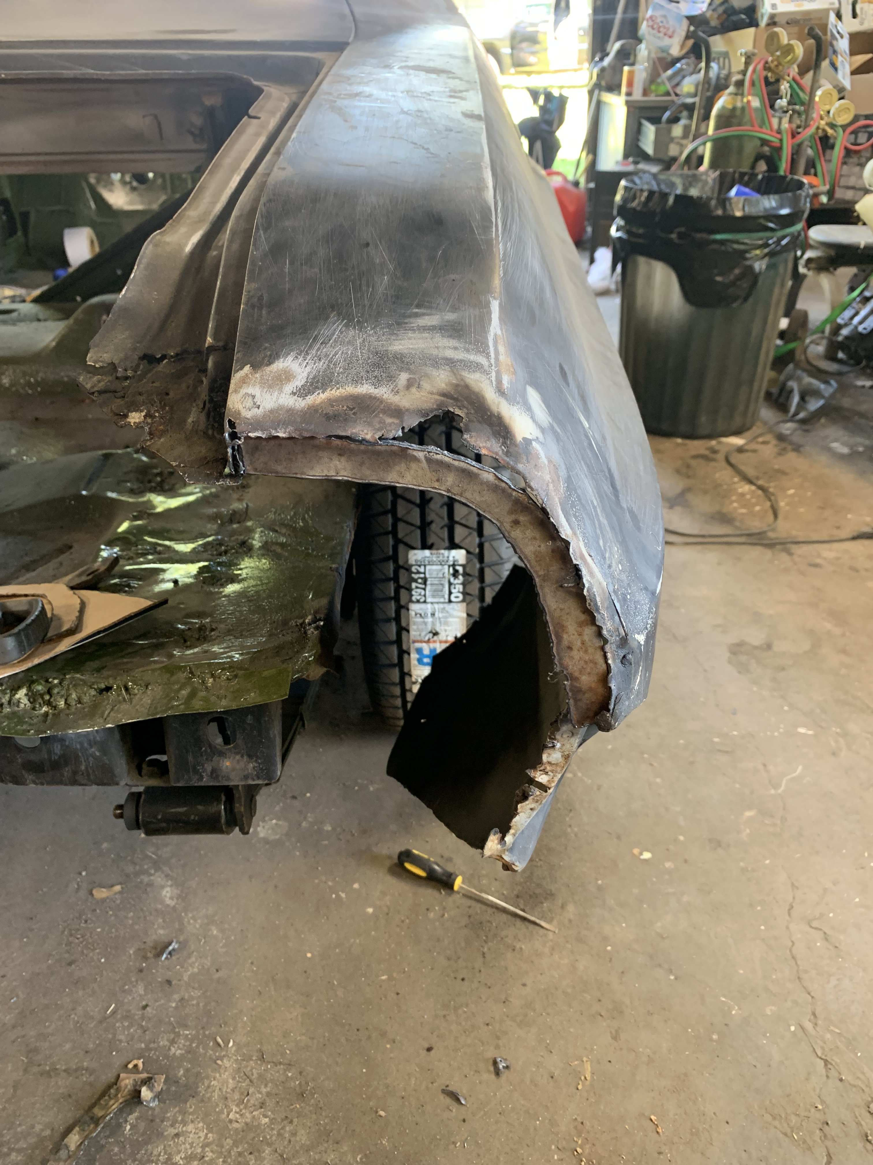

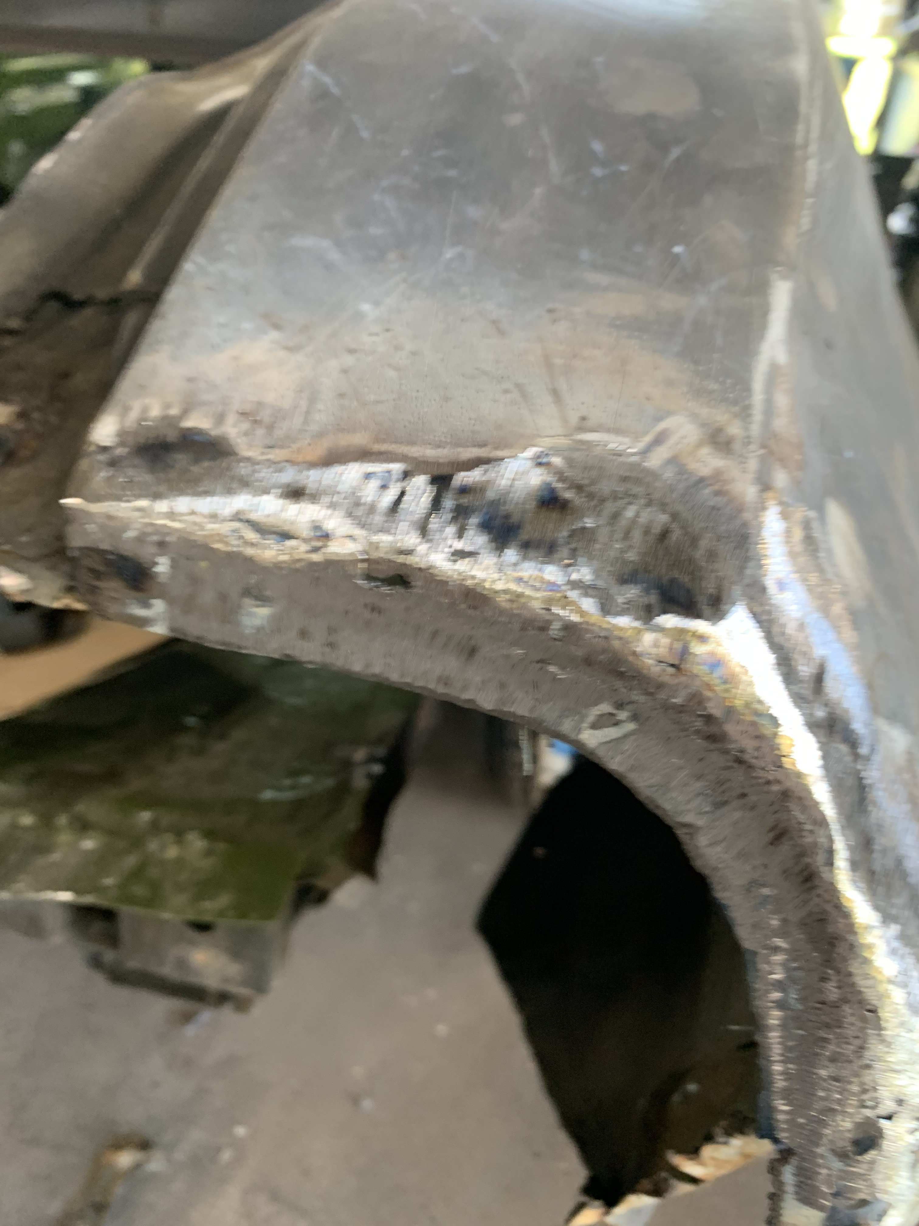

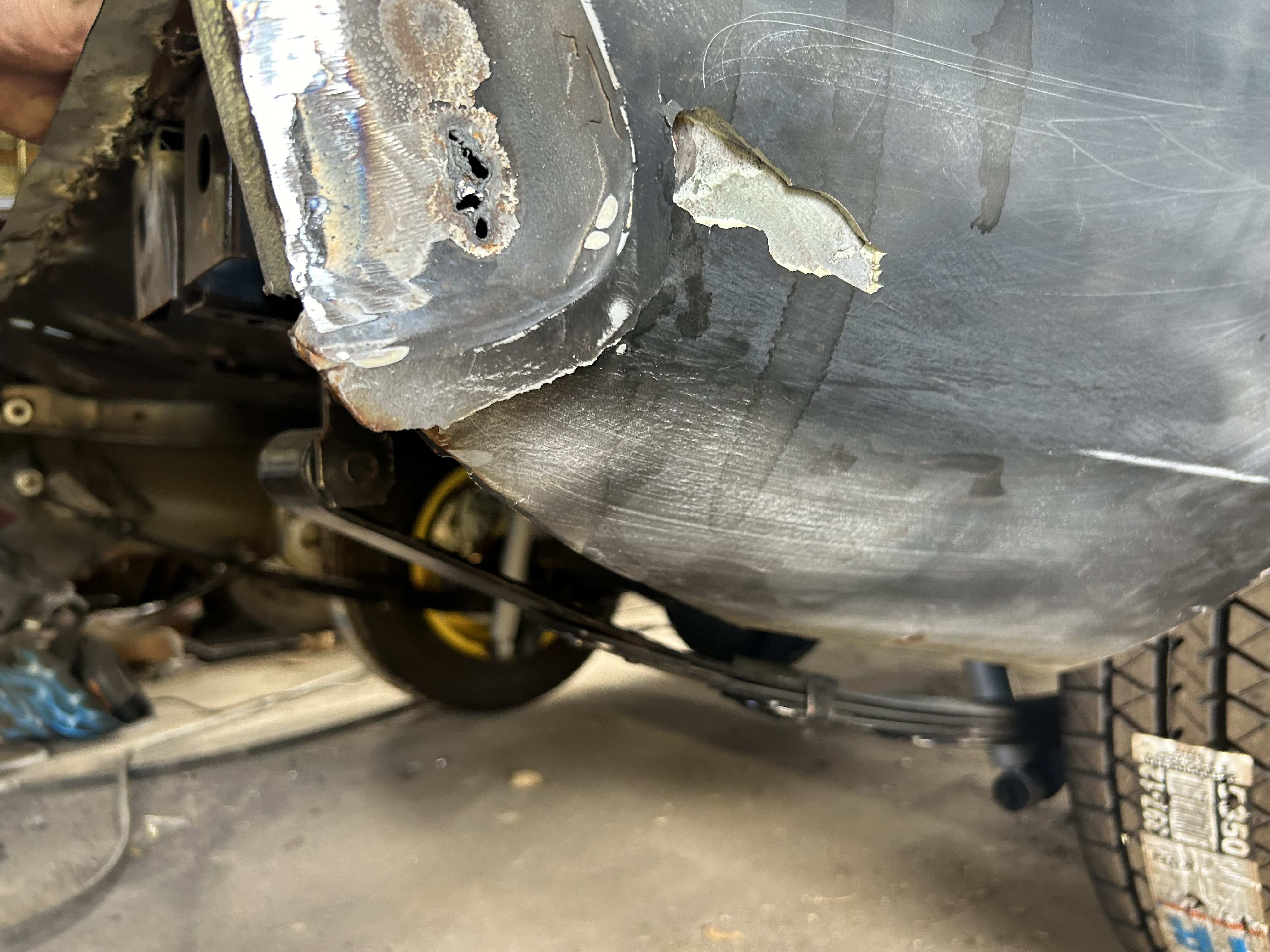

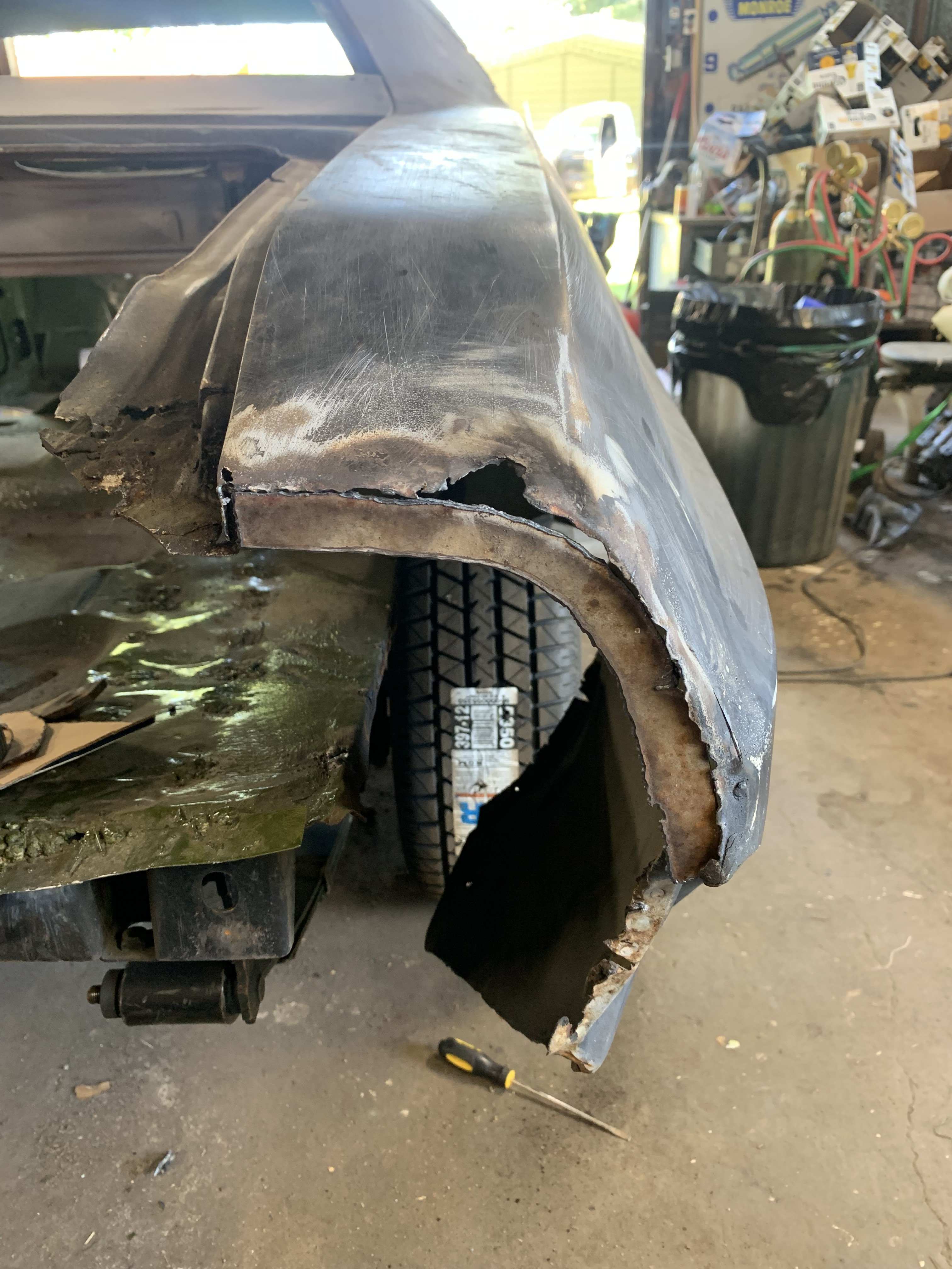

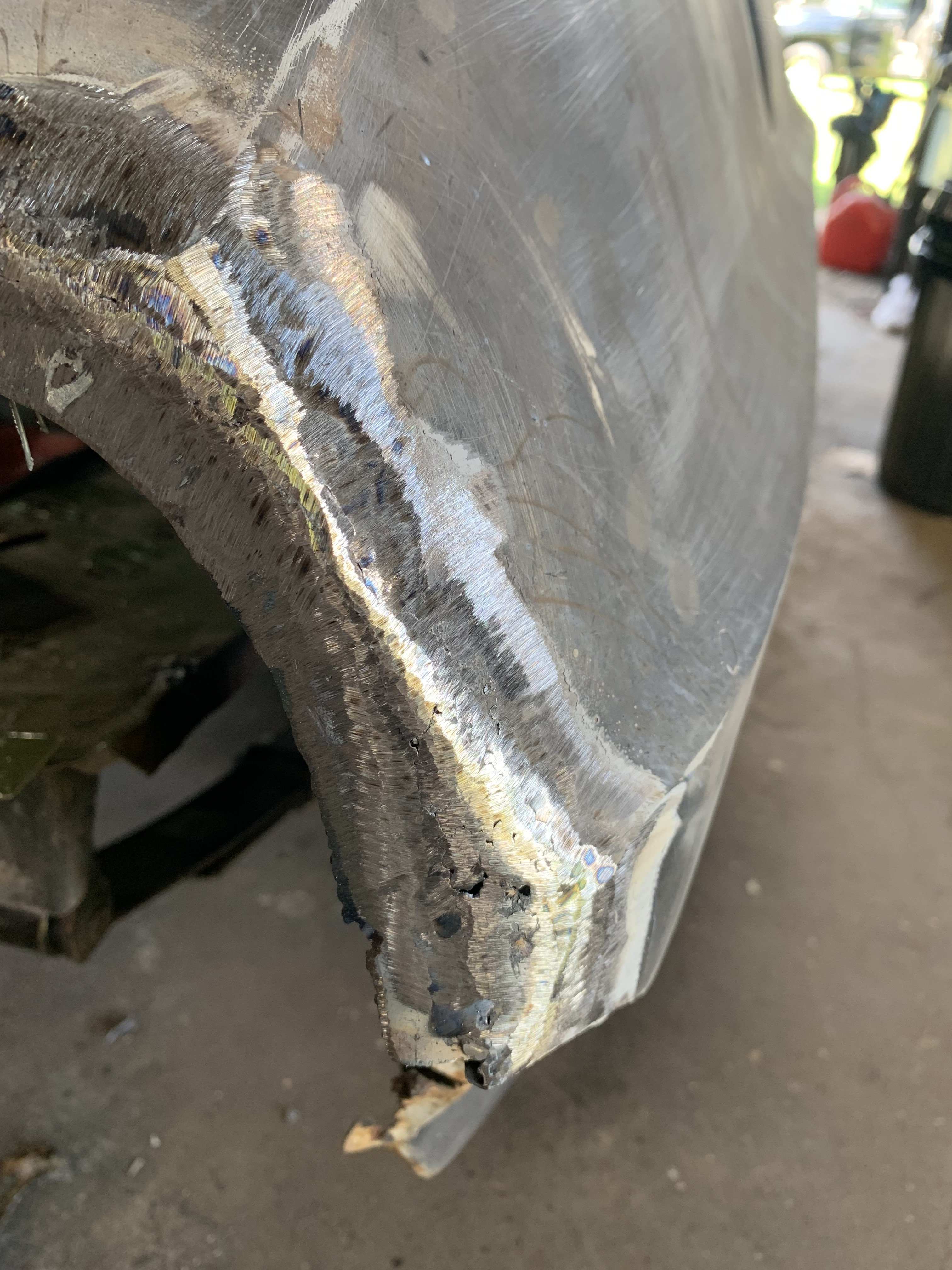

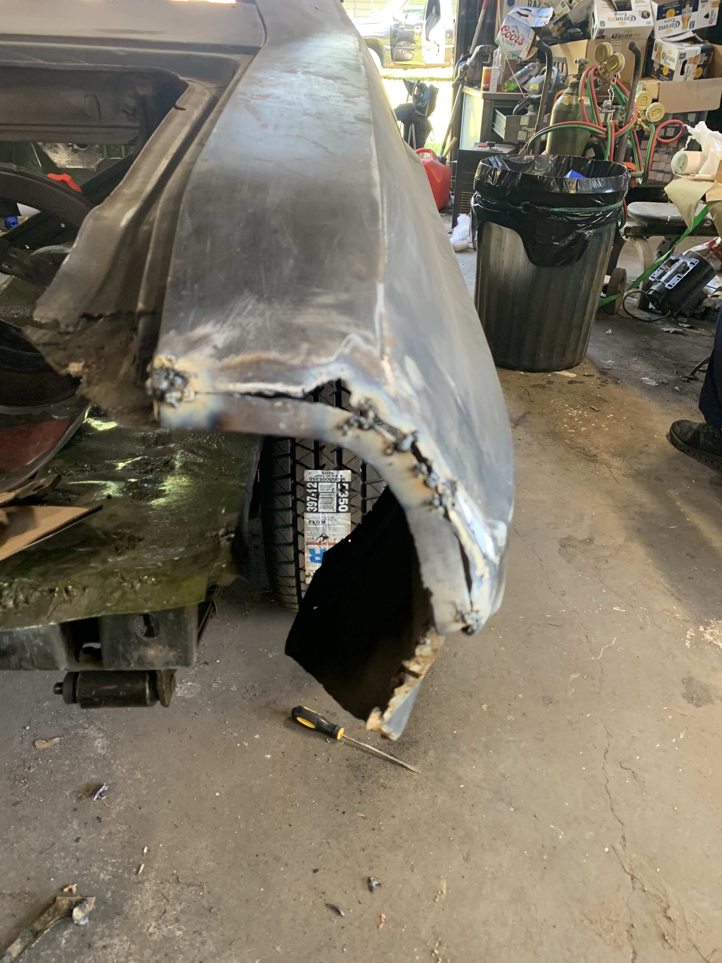

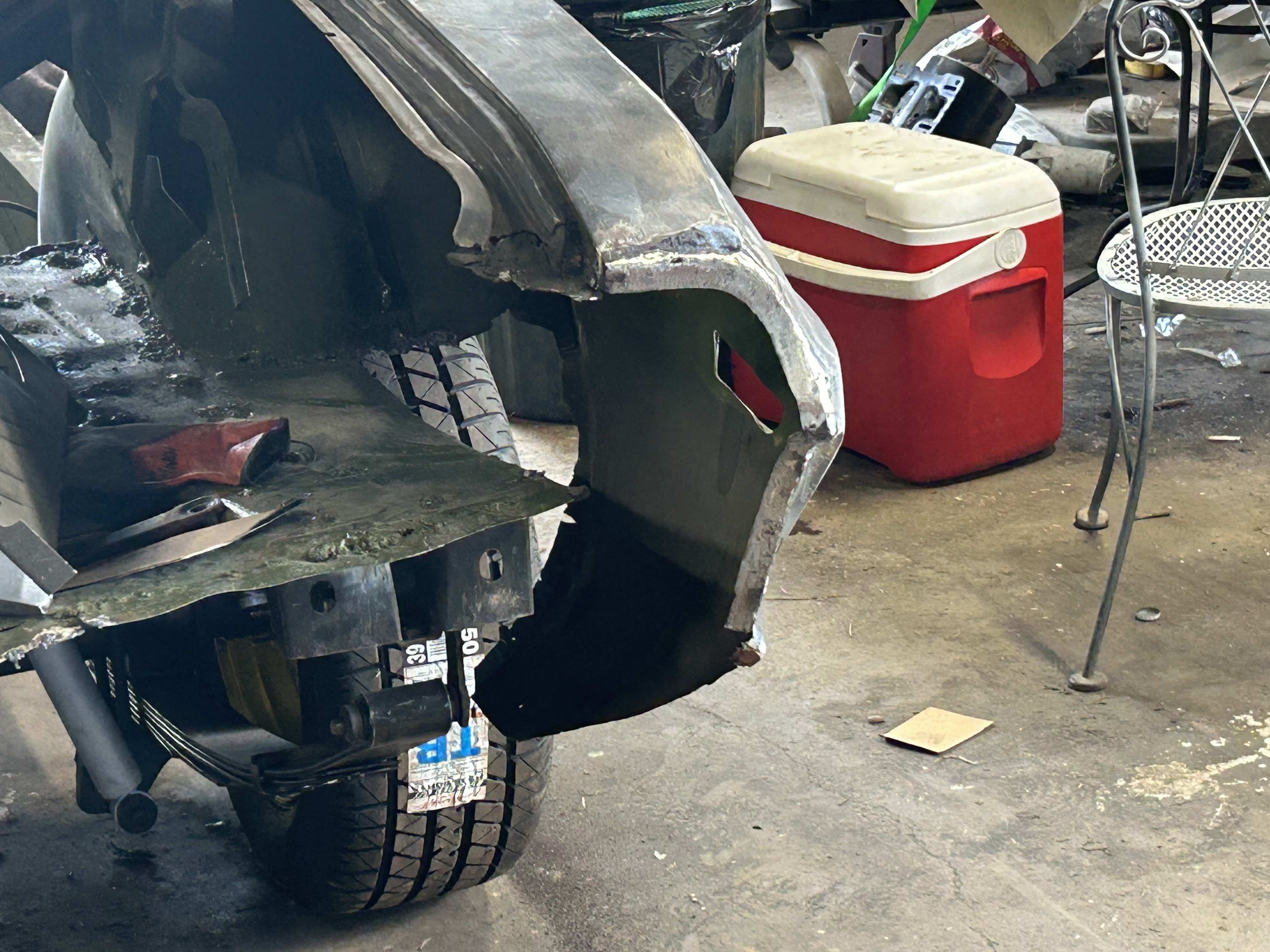

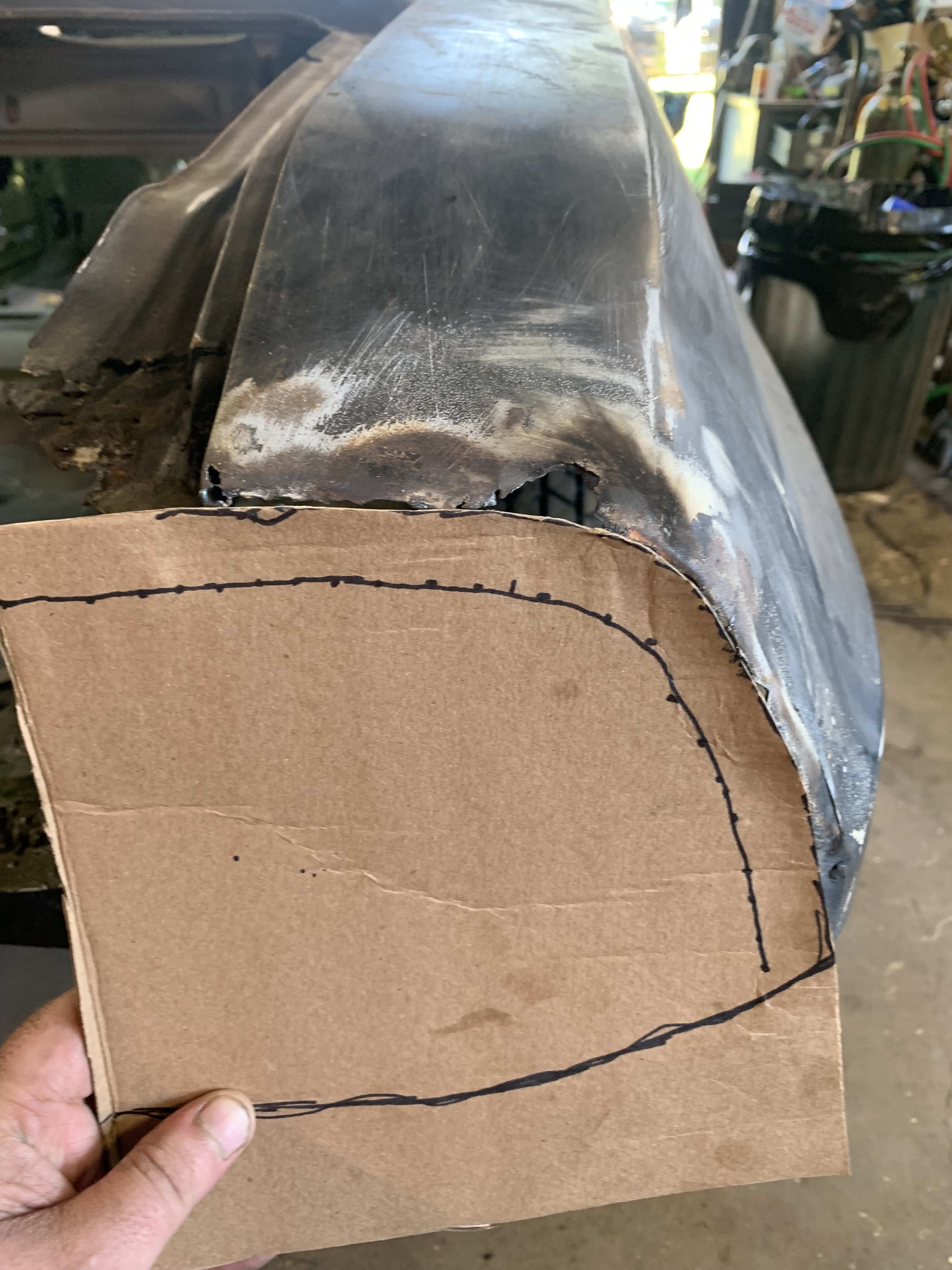

I tapered to much the quarter panel outside line-I wasn’t paying attention.. still have a few holes to weld up..

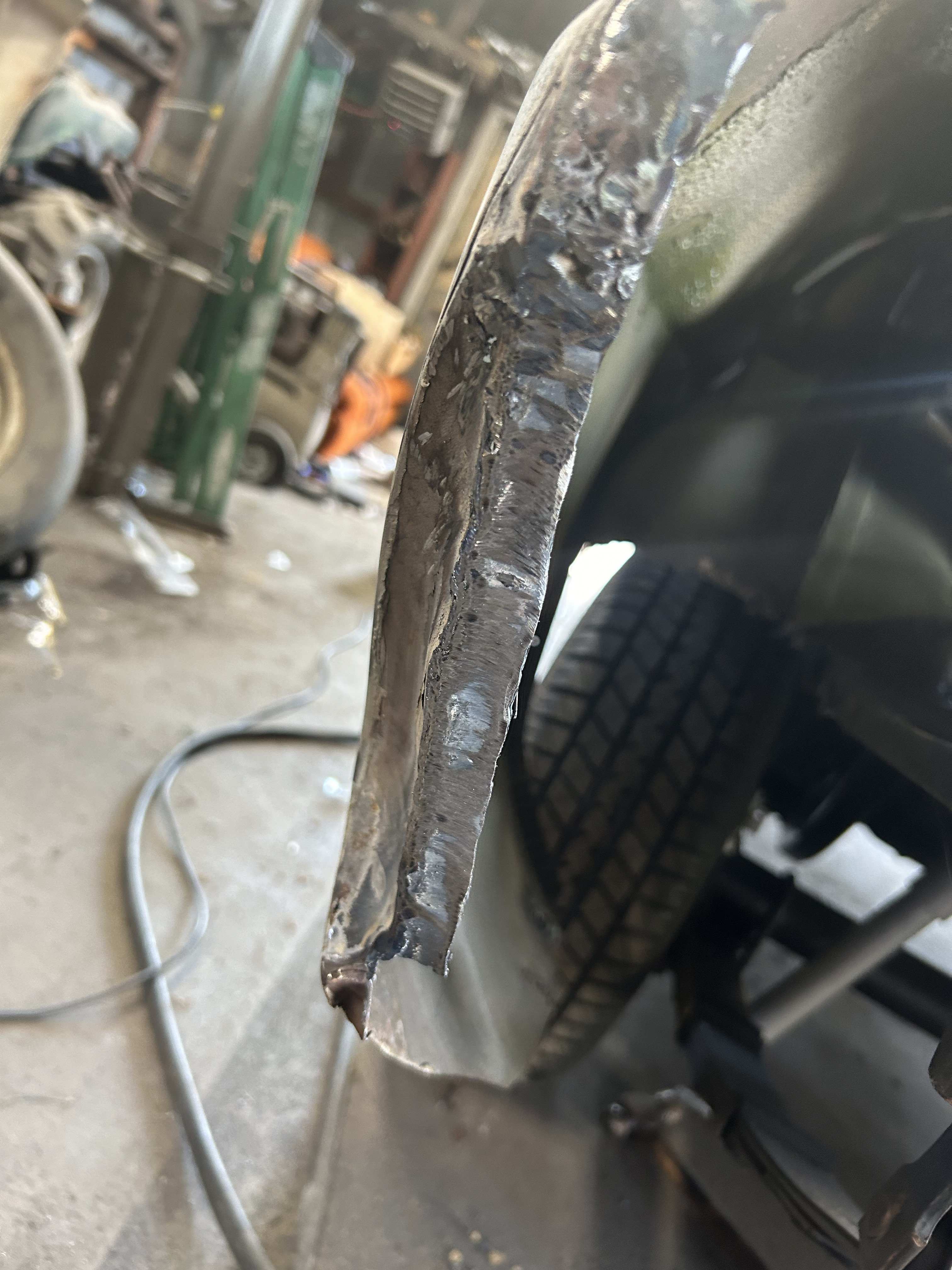

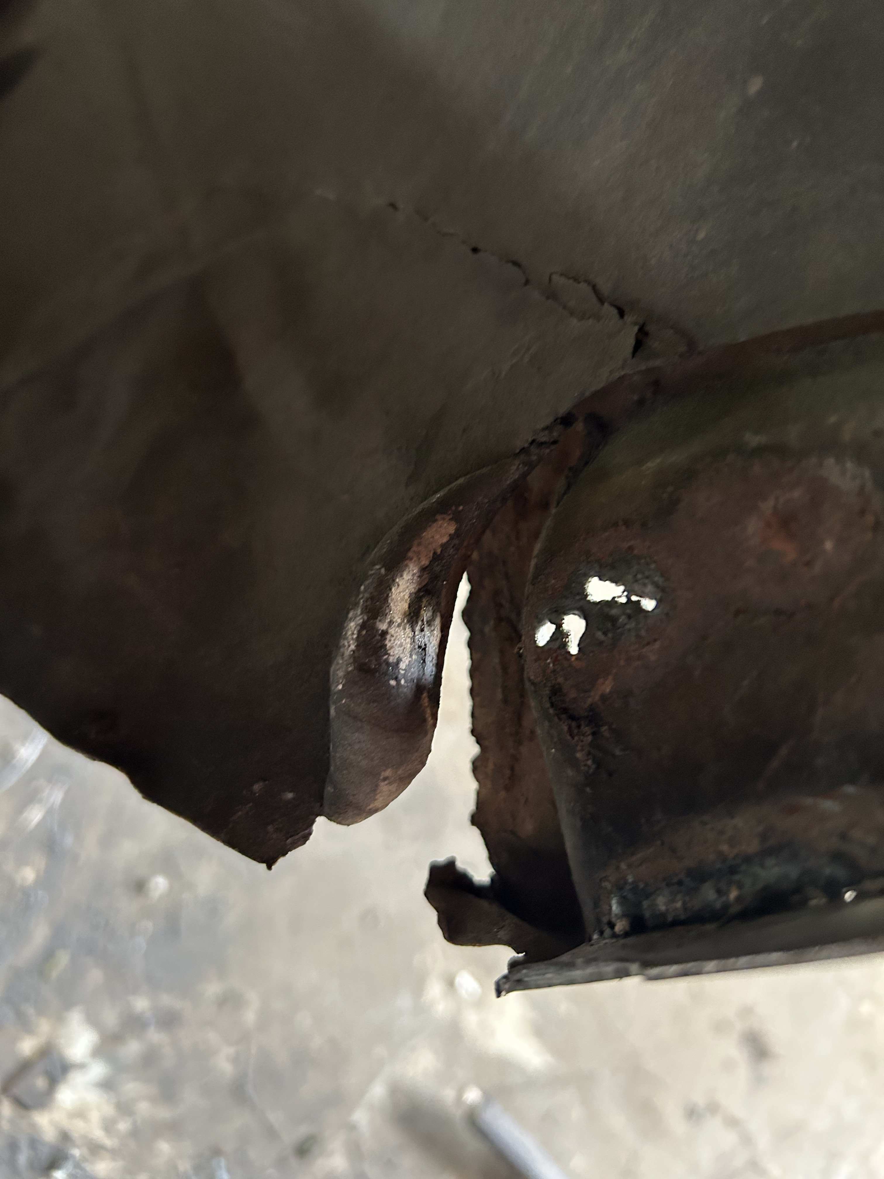

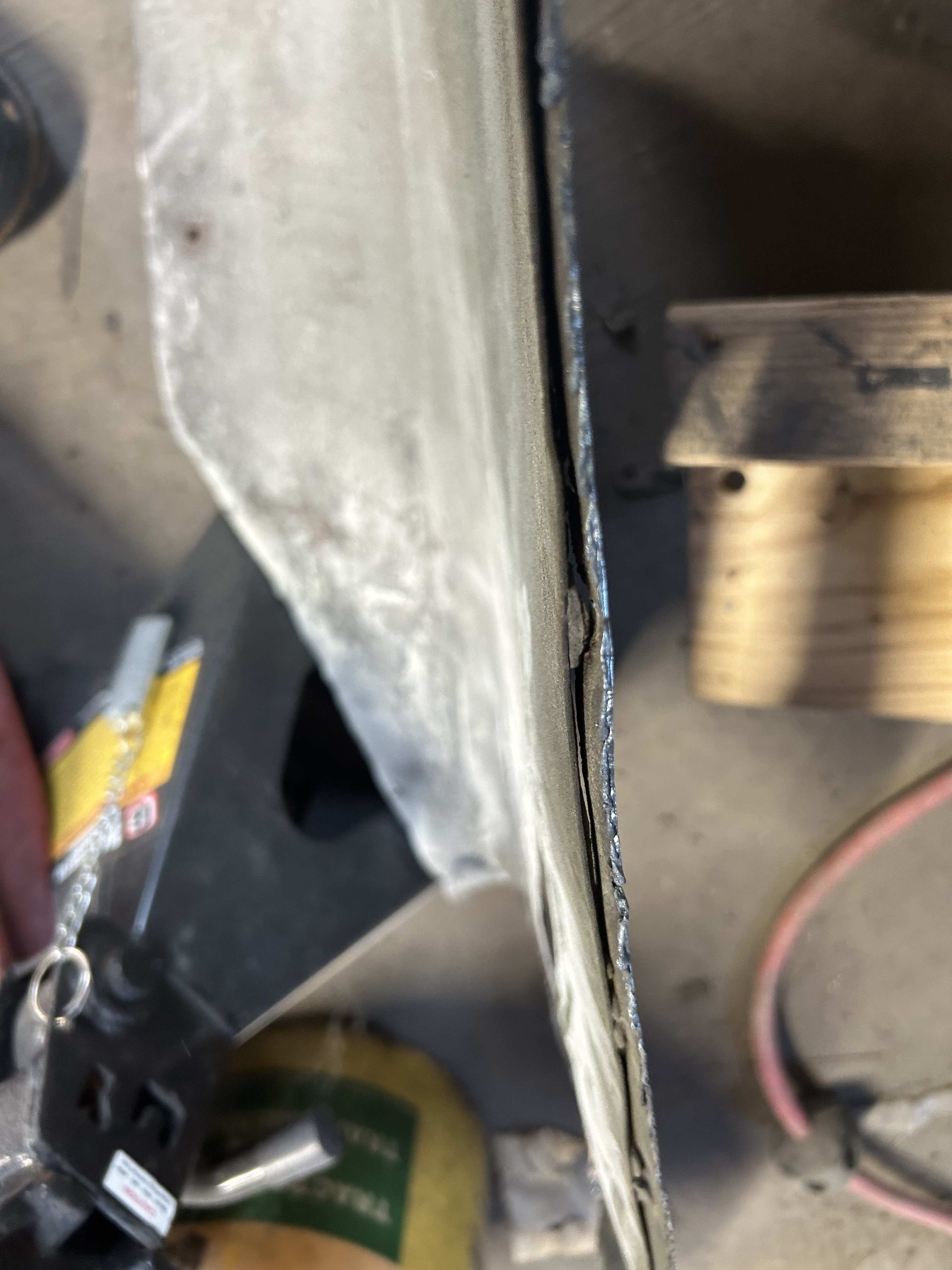

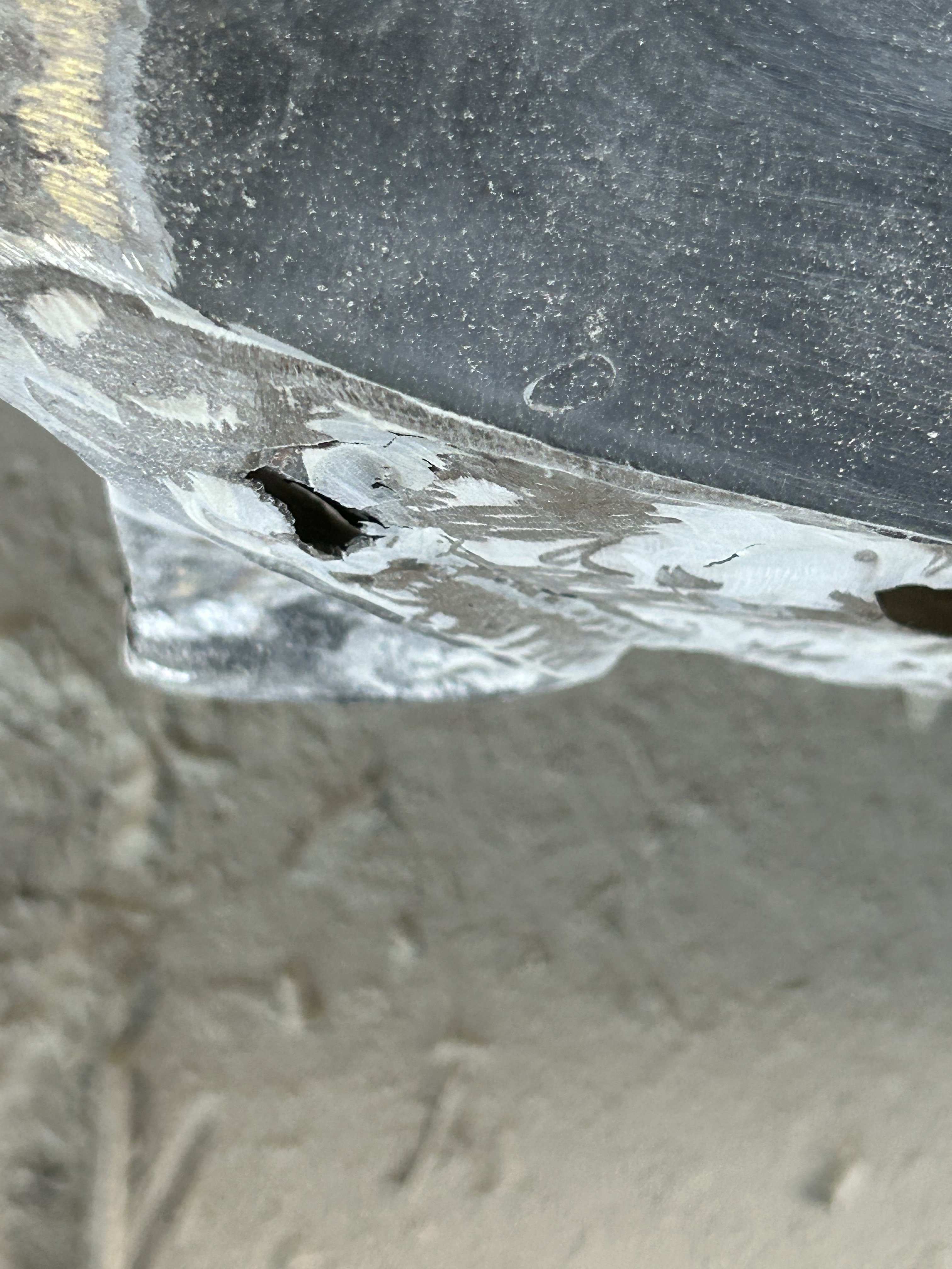

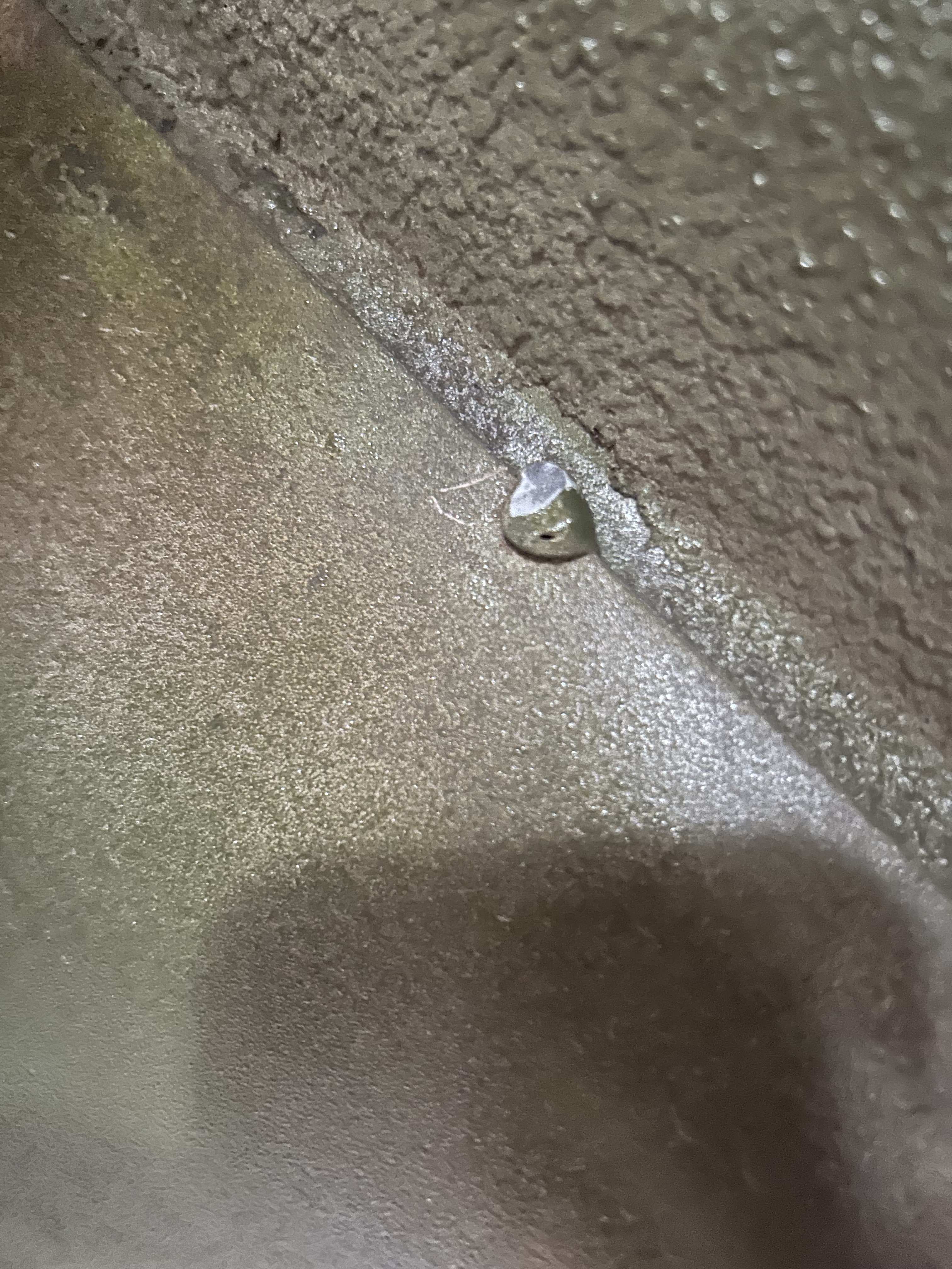

And I can see the crack in the weld that I’ve got to fix..

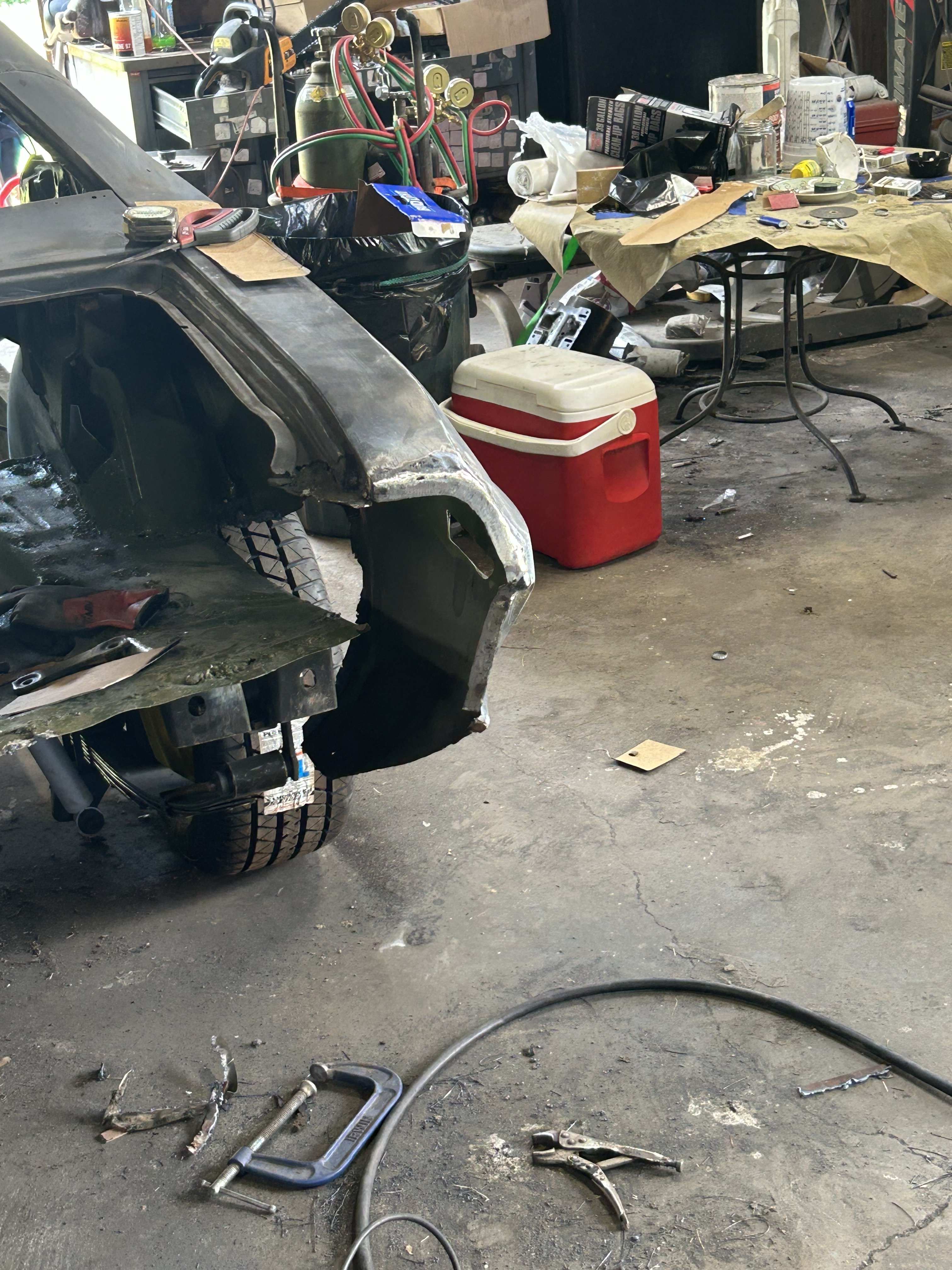

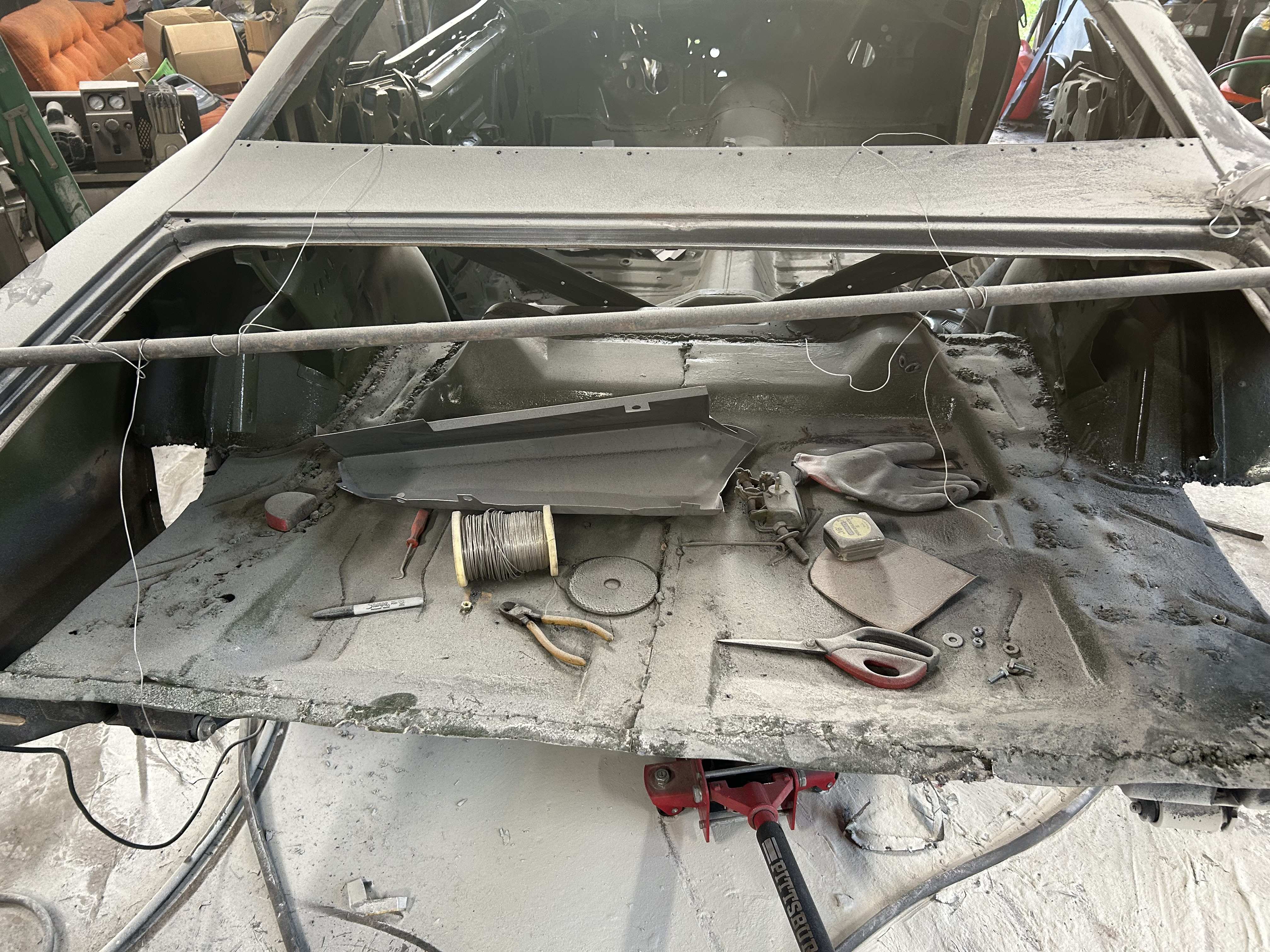

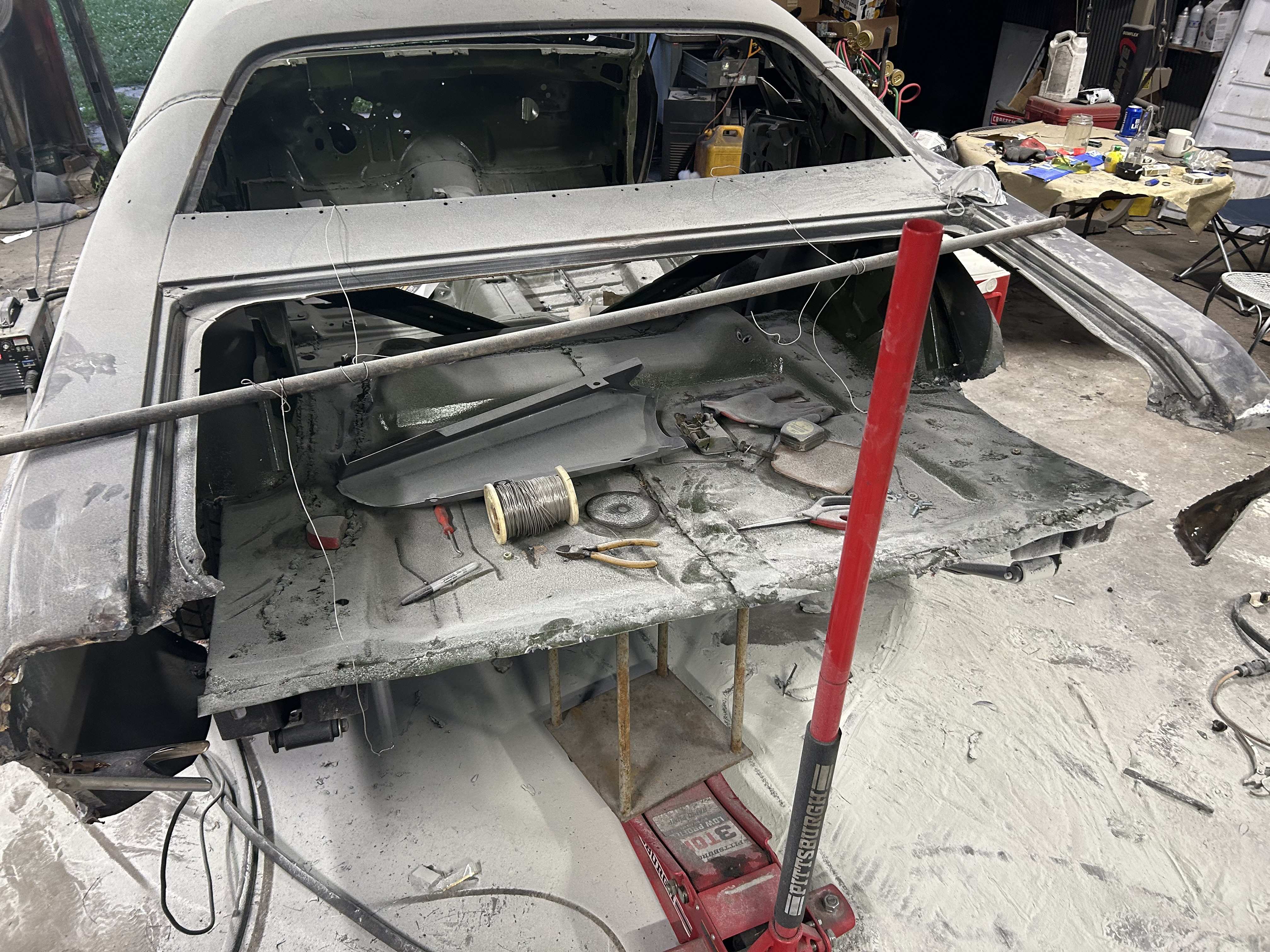

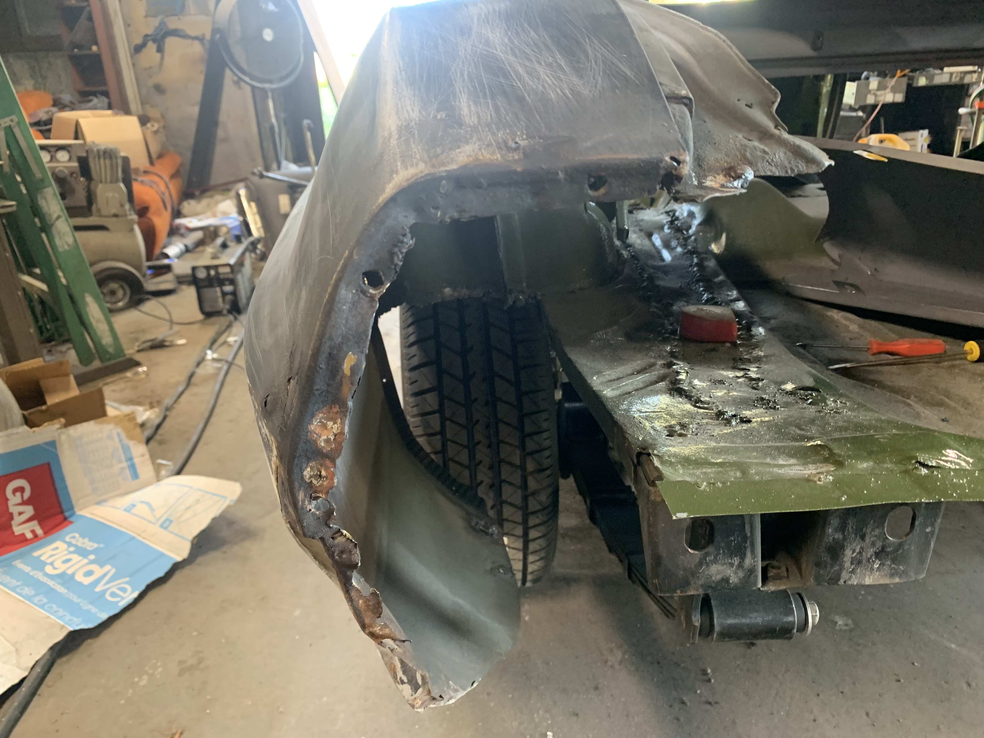

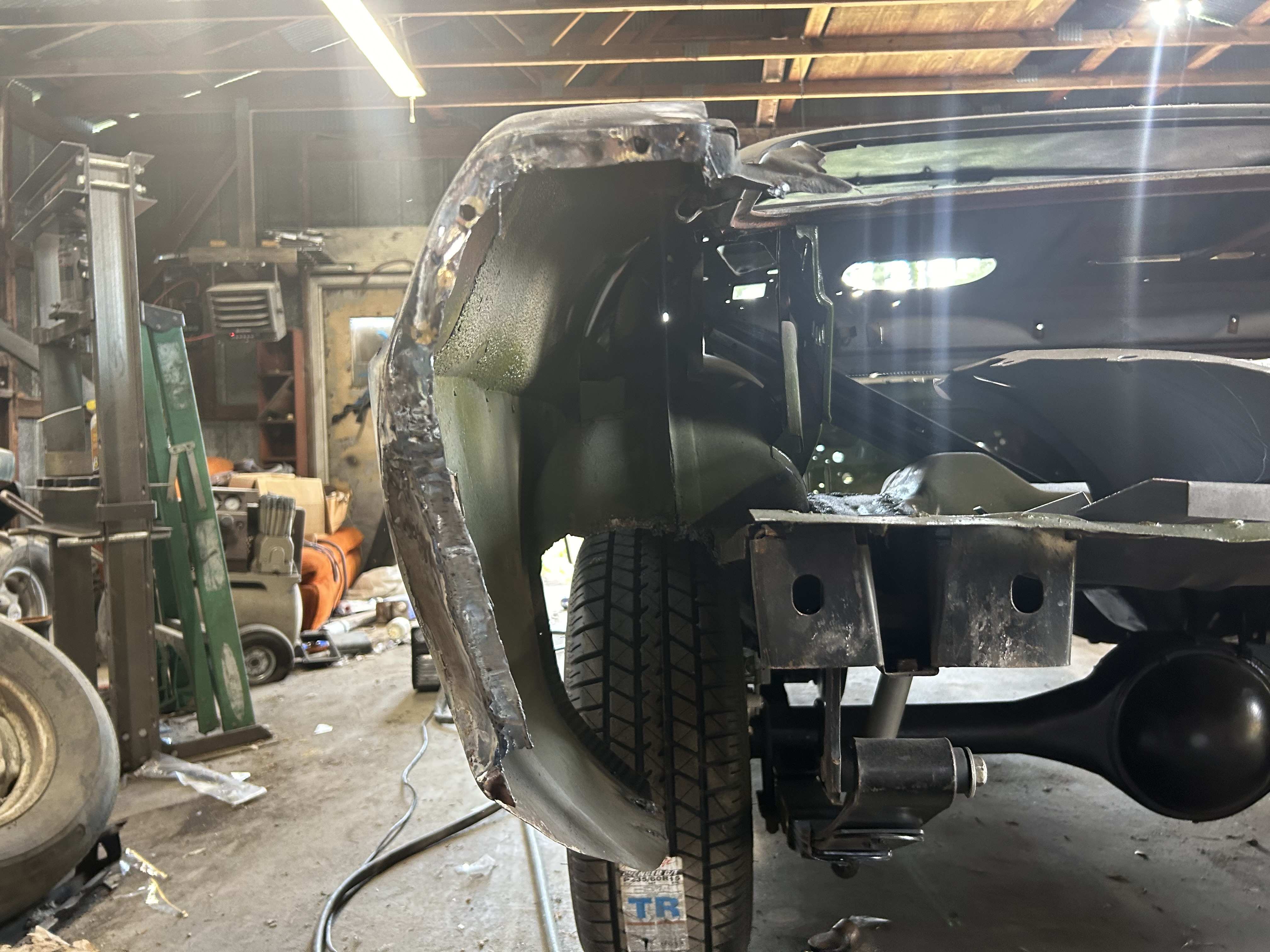

I got to do the other side. Then I’ve got to tac the trunk extensions in to the trunk panel.. after the trunk extensions are secure I can lining the valance up before I weld the trunk extensions in fully.. but before I weld the trunk extensions in fully, after lining the valance up, i have to weld the bottom pieces of the bottom quarter panel in place to match the trunk extension holes..

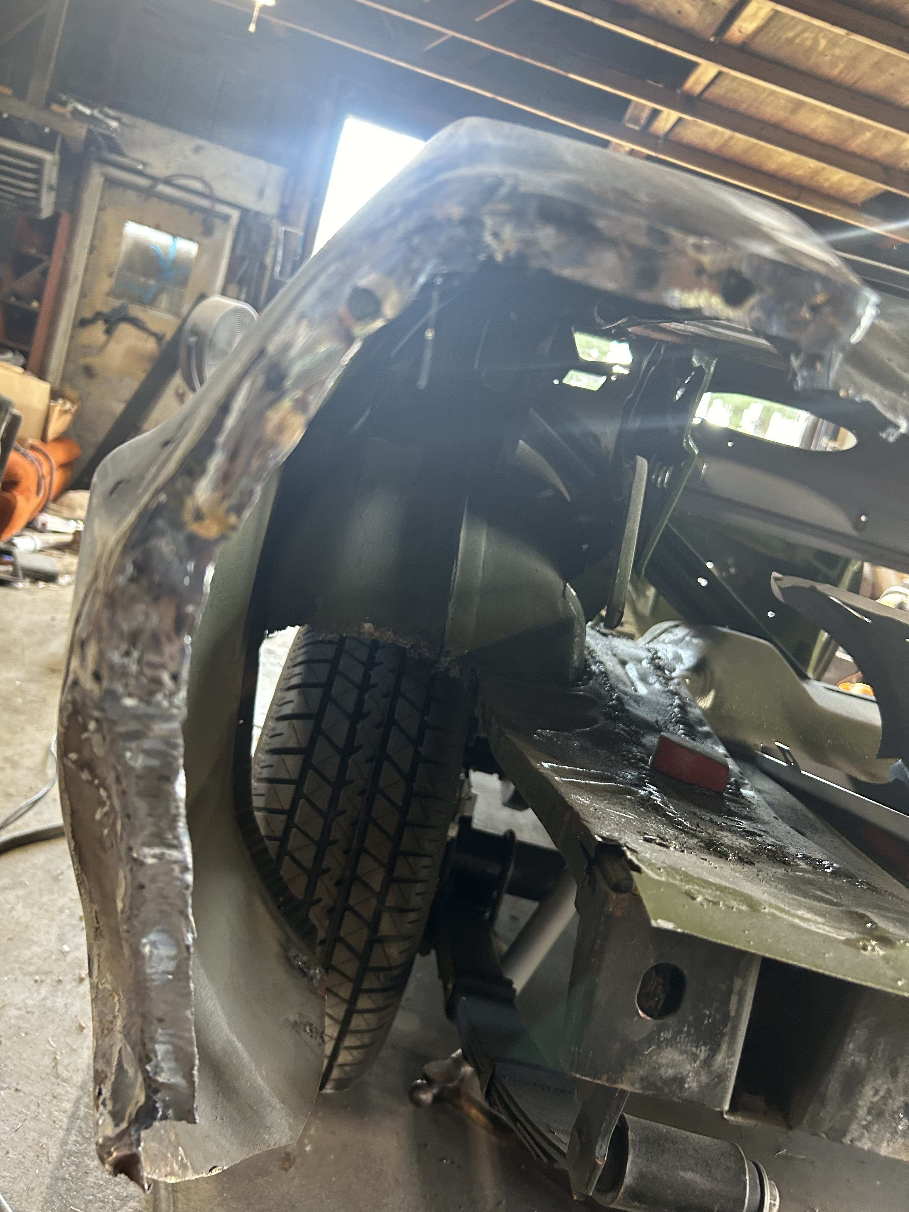

Got it ready for the trunk extensions. I didn’t redo the top part in this side because it looks like it’s in better shape- and also the quarter panels need to be replaced so I don’t won’t to do to much work to em..

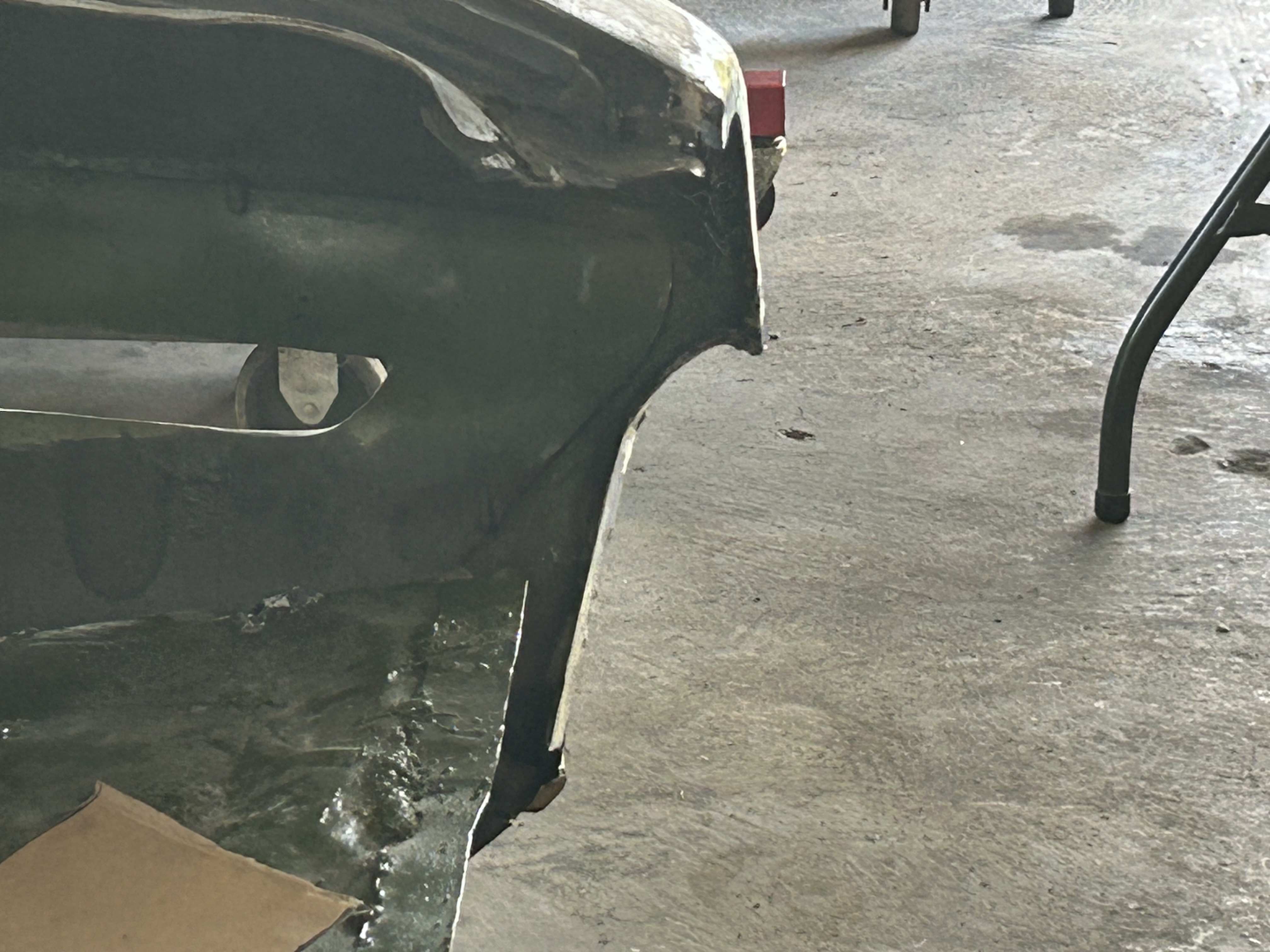

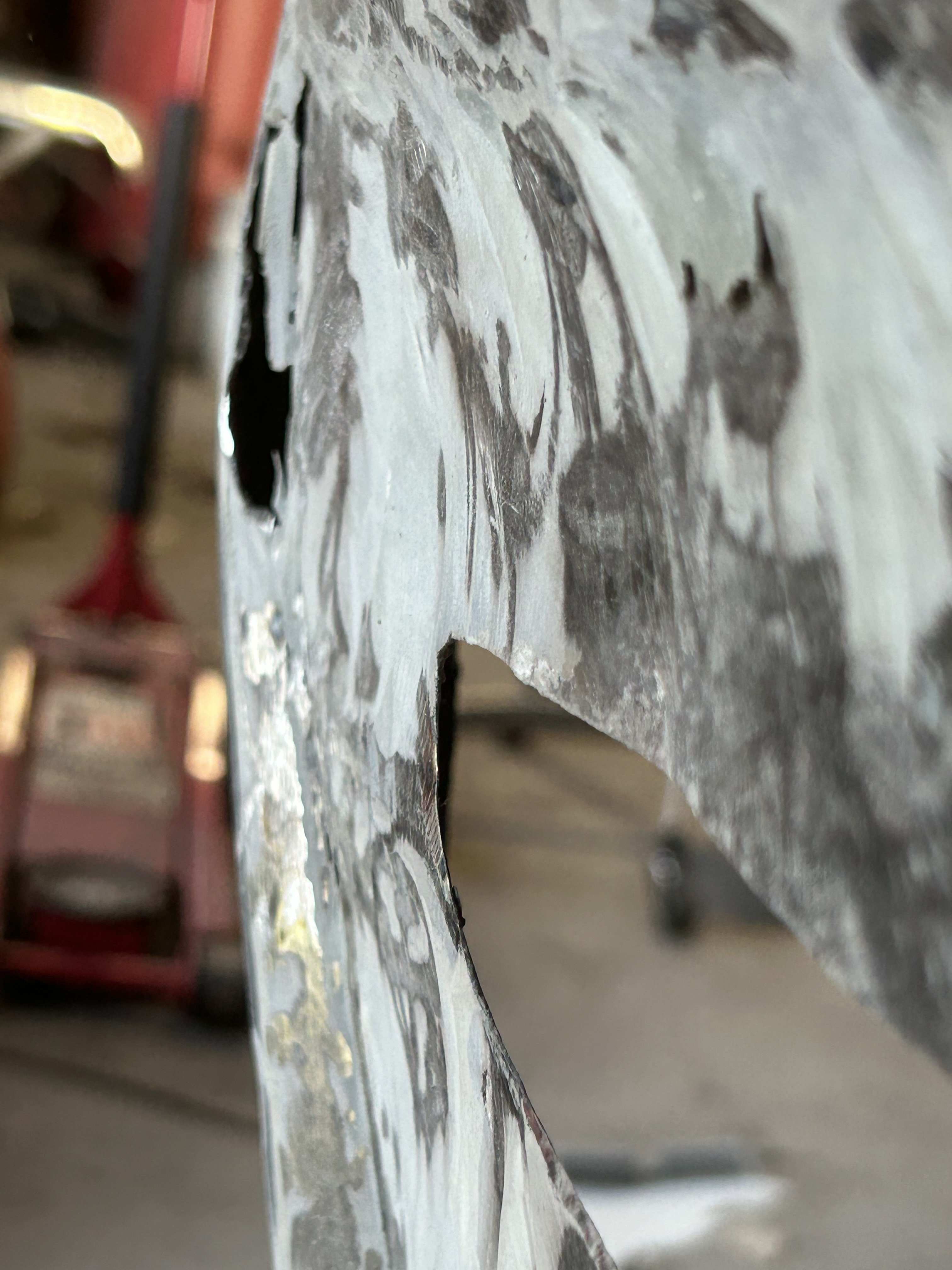

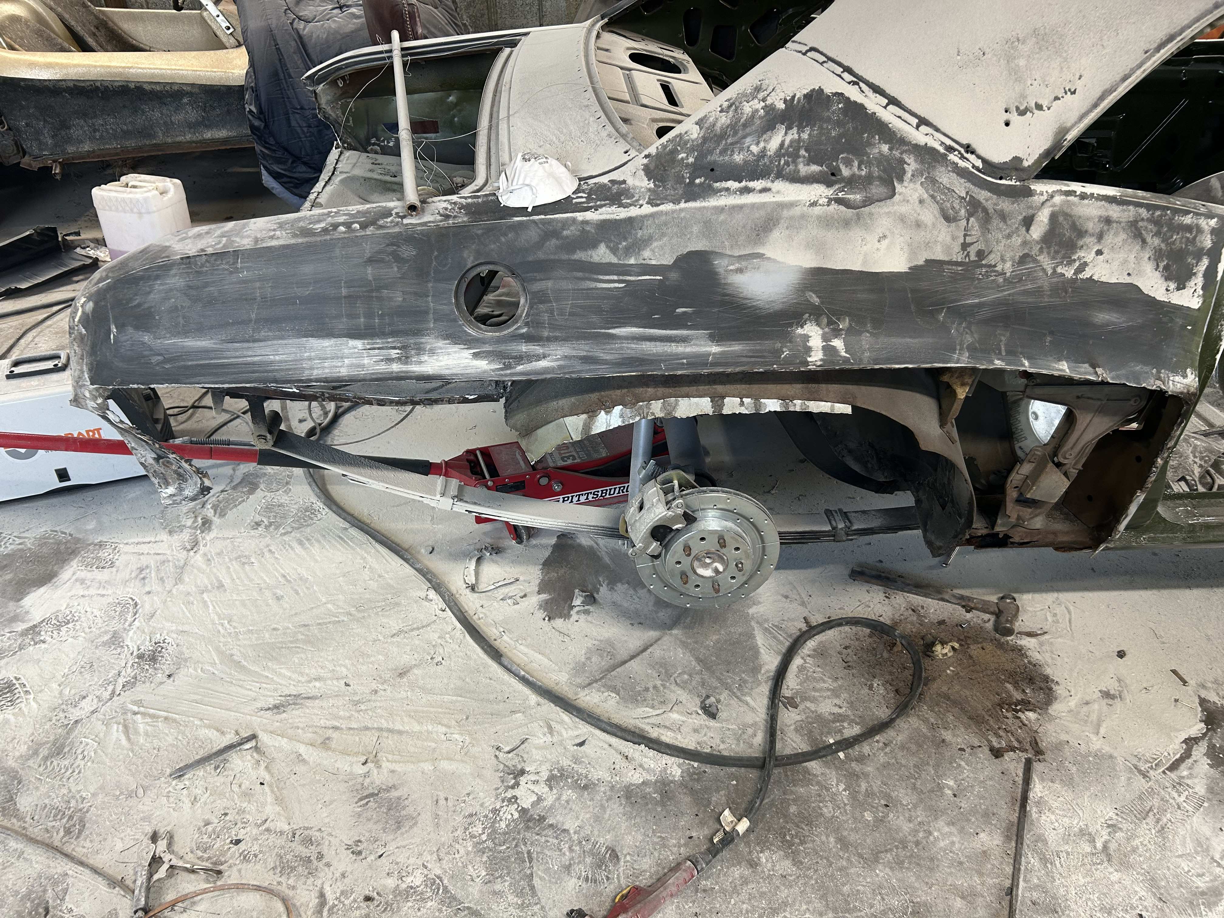

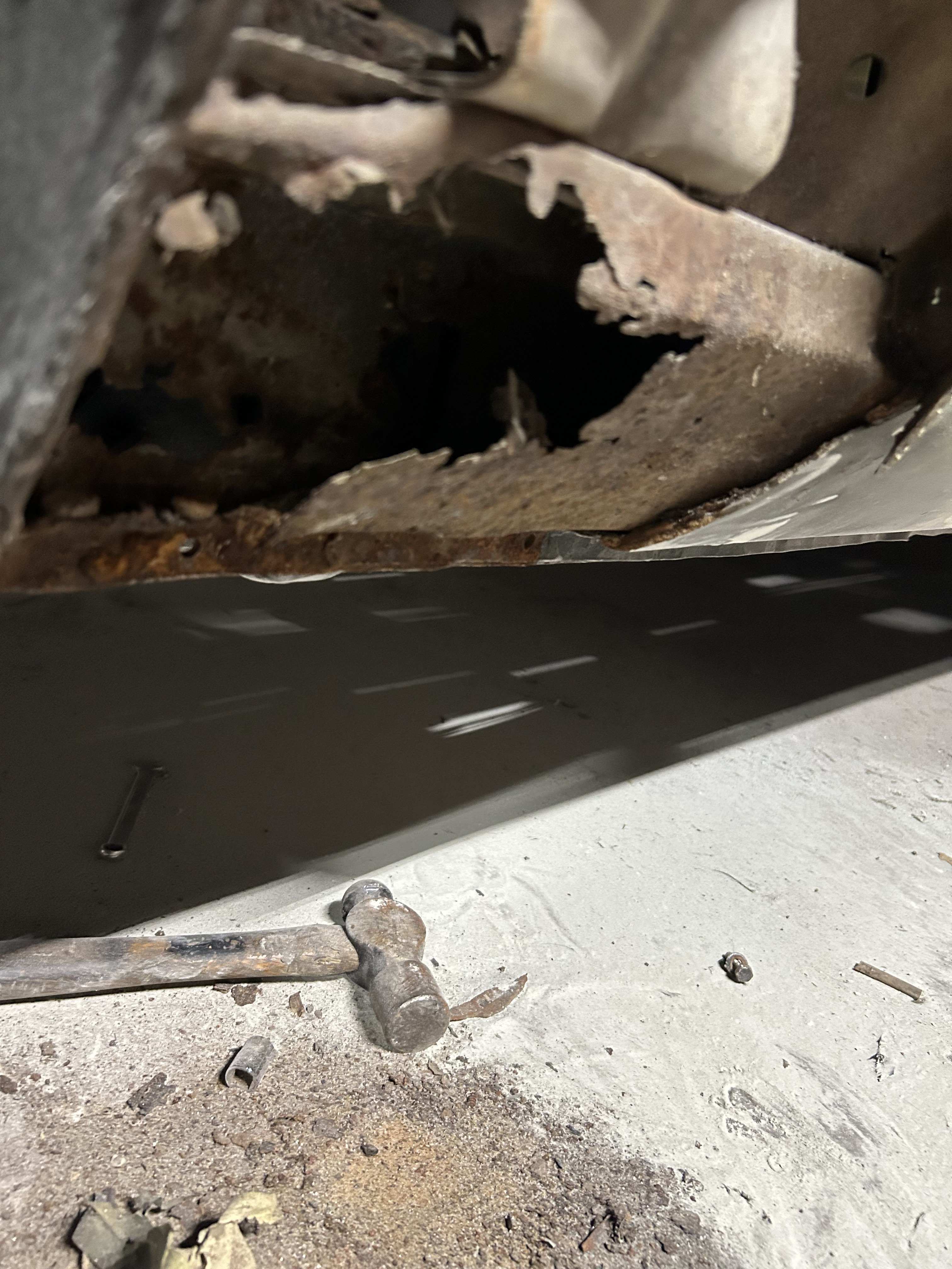

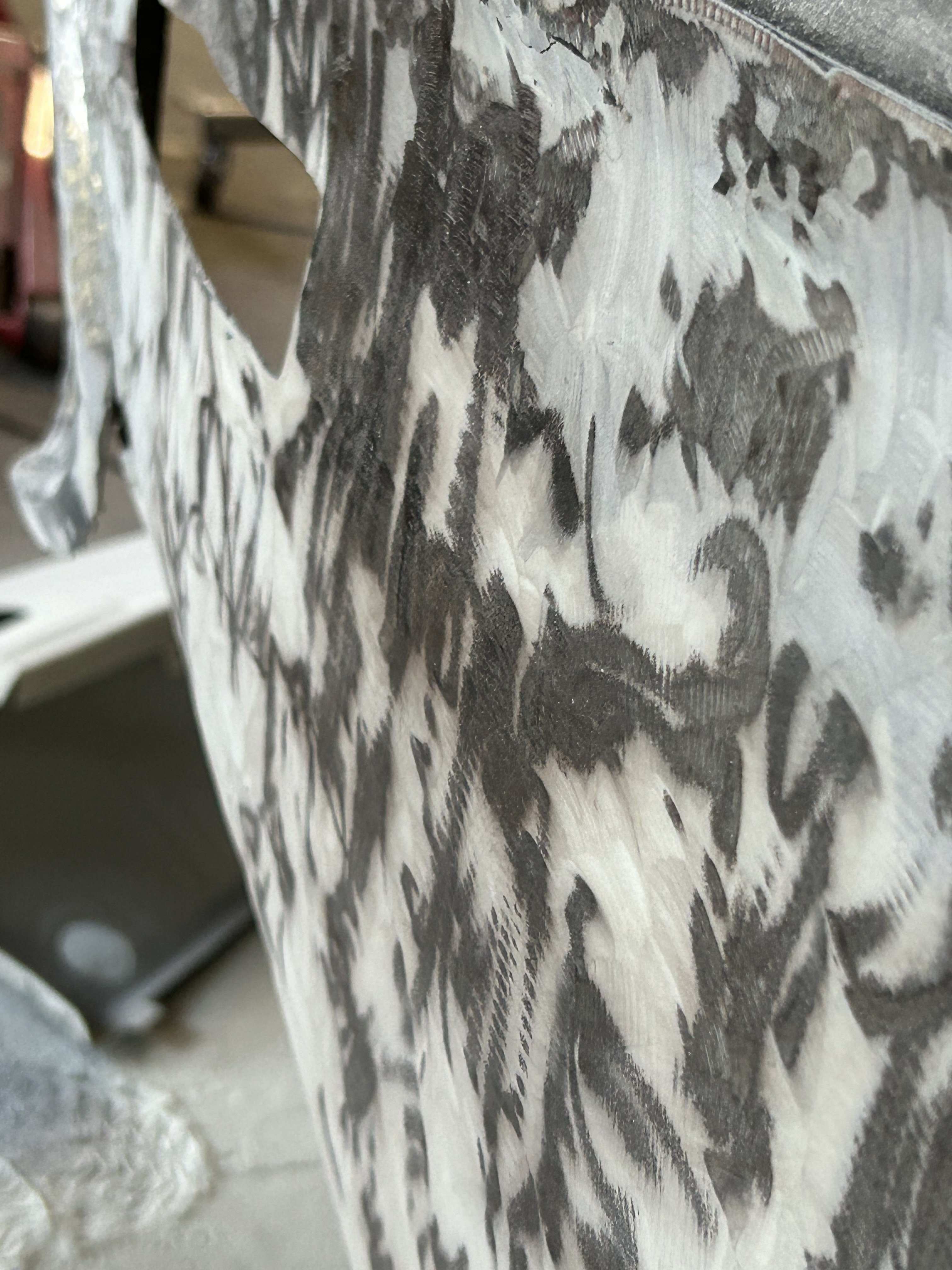

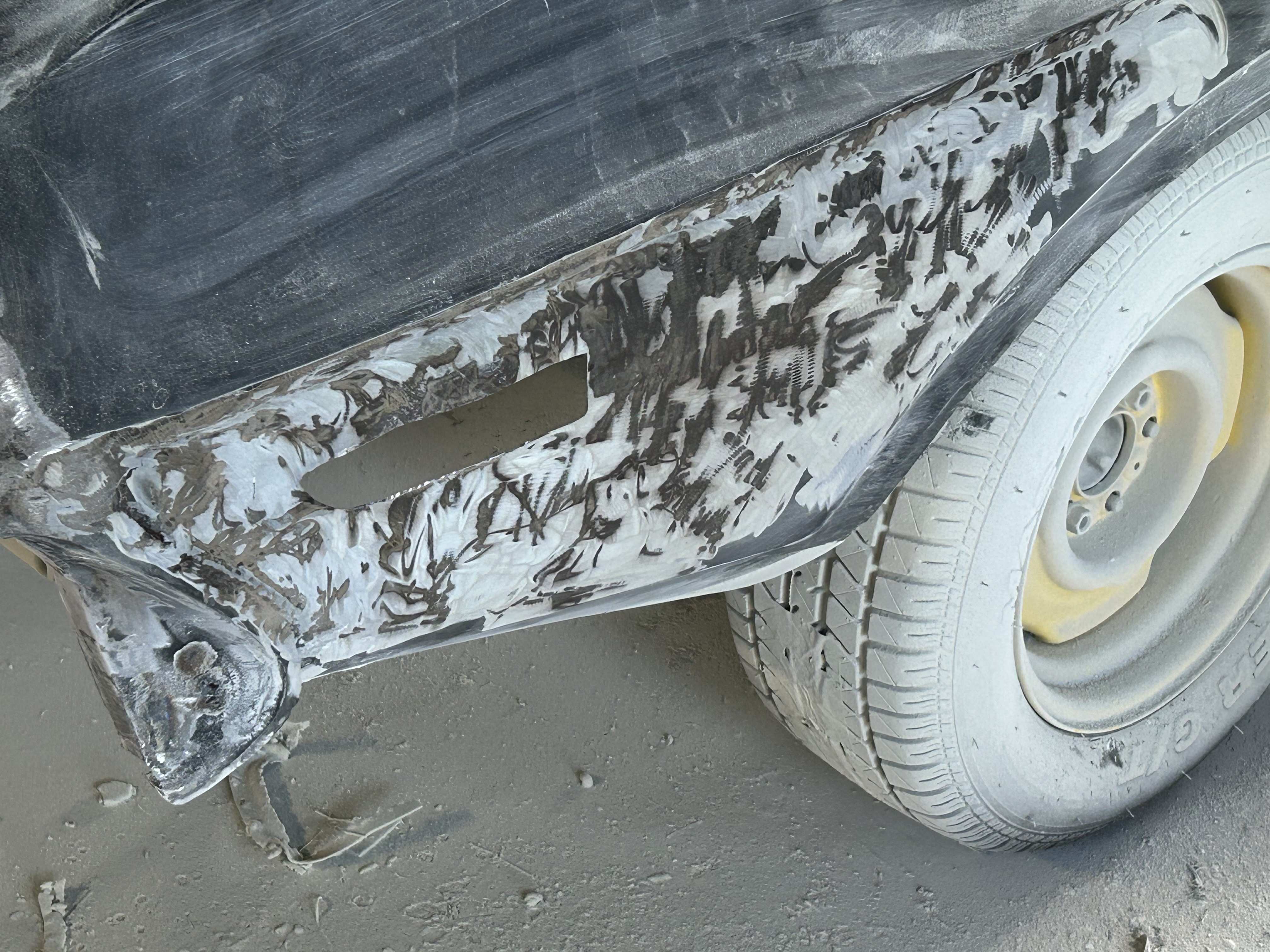

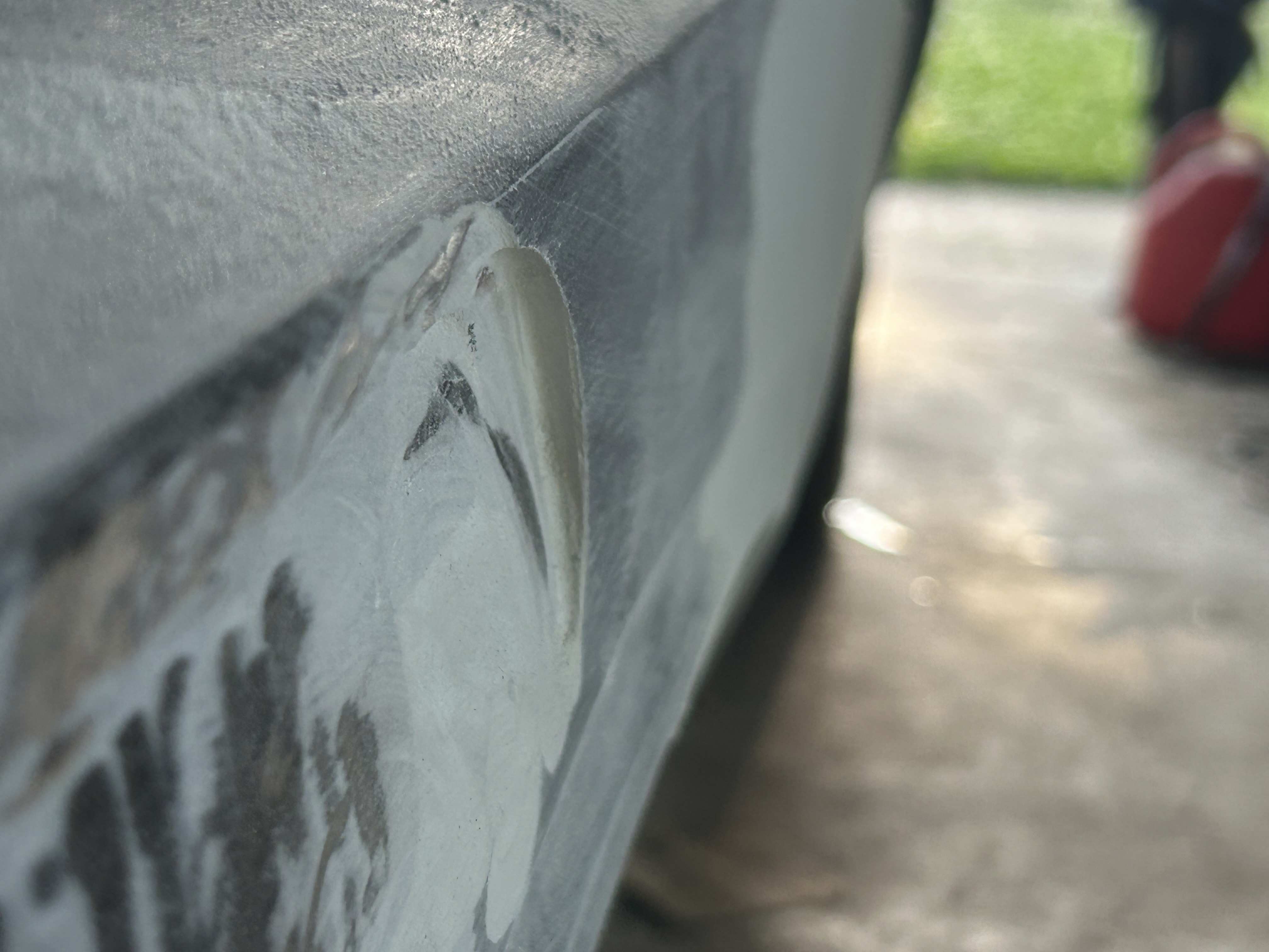

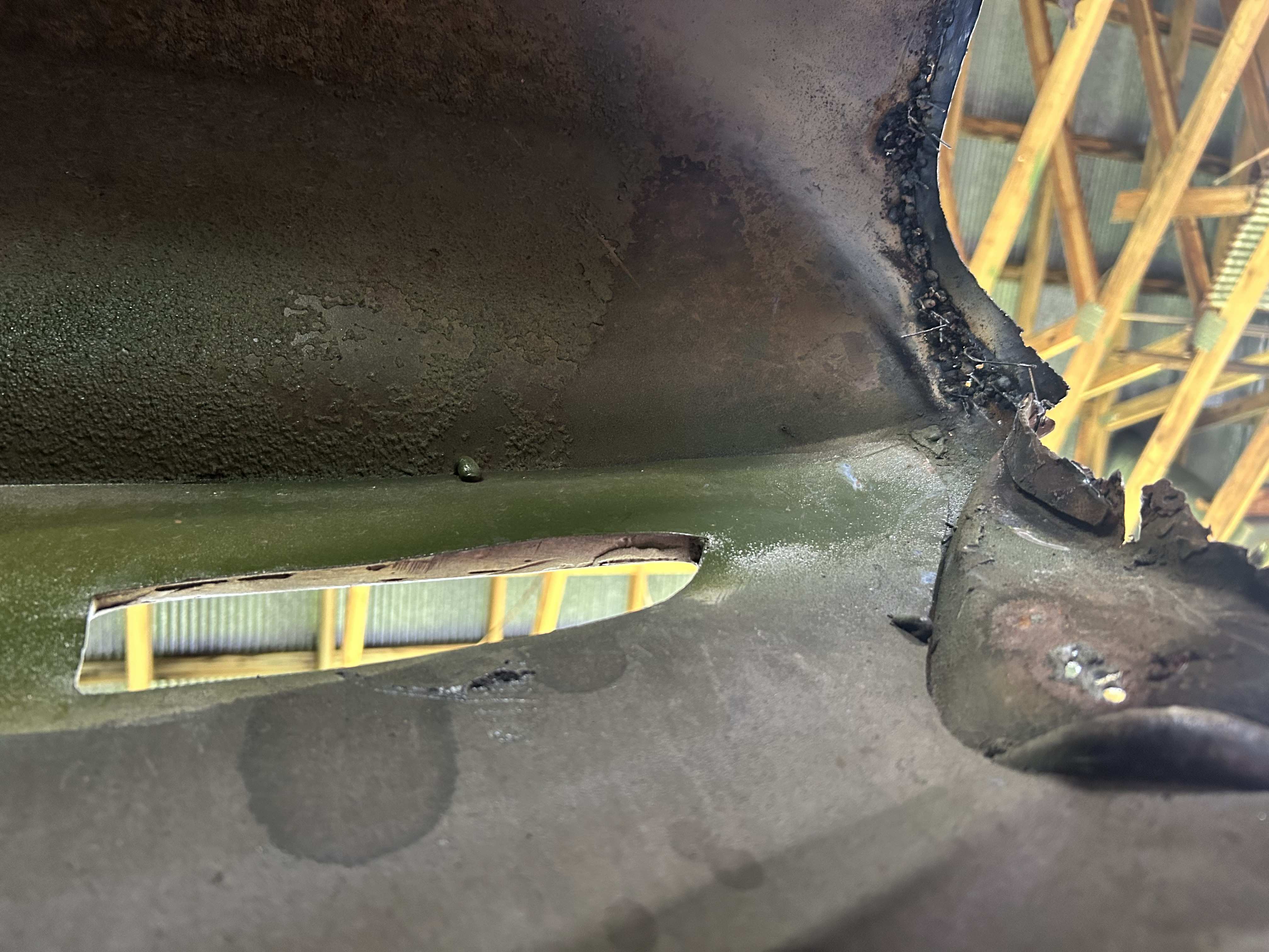

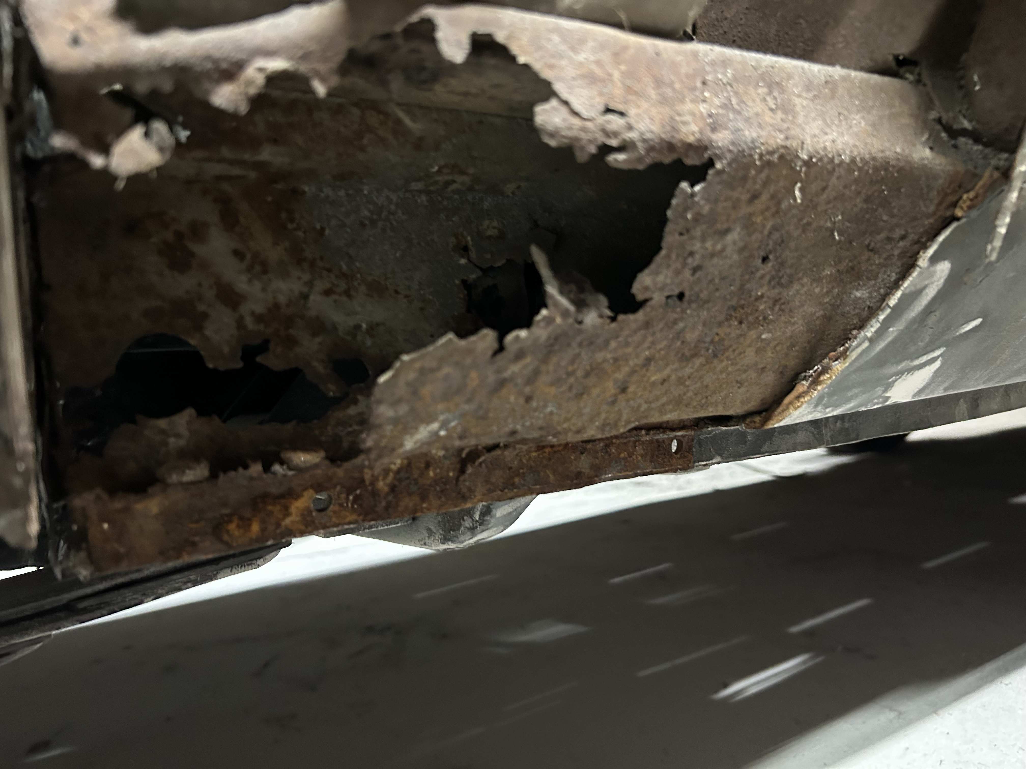

It’s welded alittle bit. Someone used maybe 2 gallons worth of angel hair bondo expensive bondo.. see the bottom is supposed to have tabs by the amd…
Dad thinks we can fix it by using the repair panels whoever used previously before us...

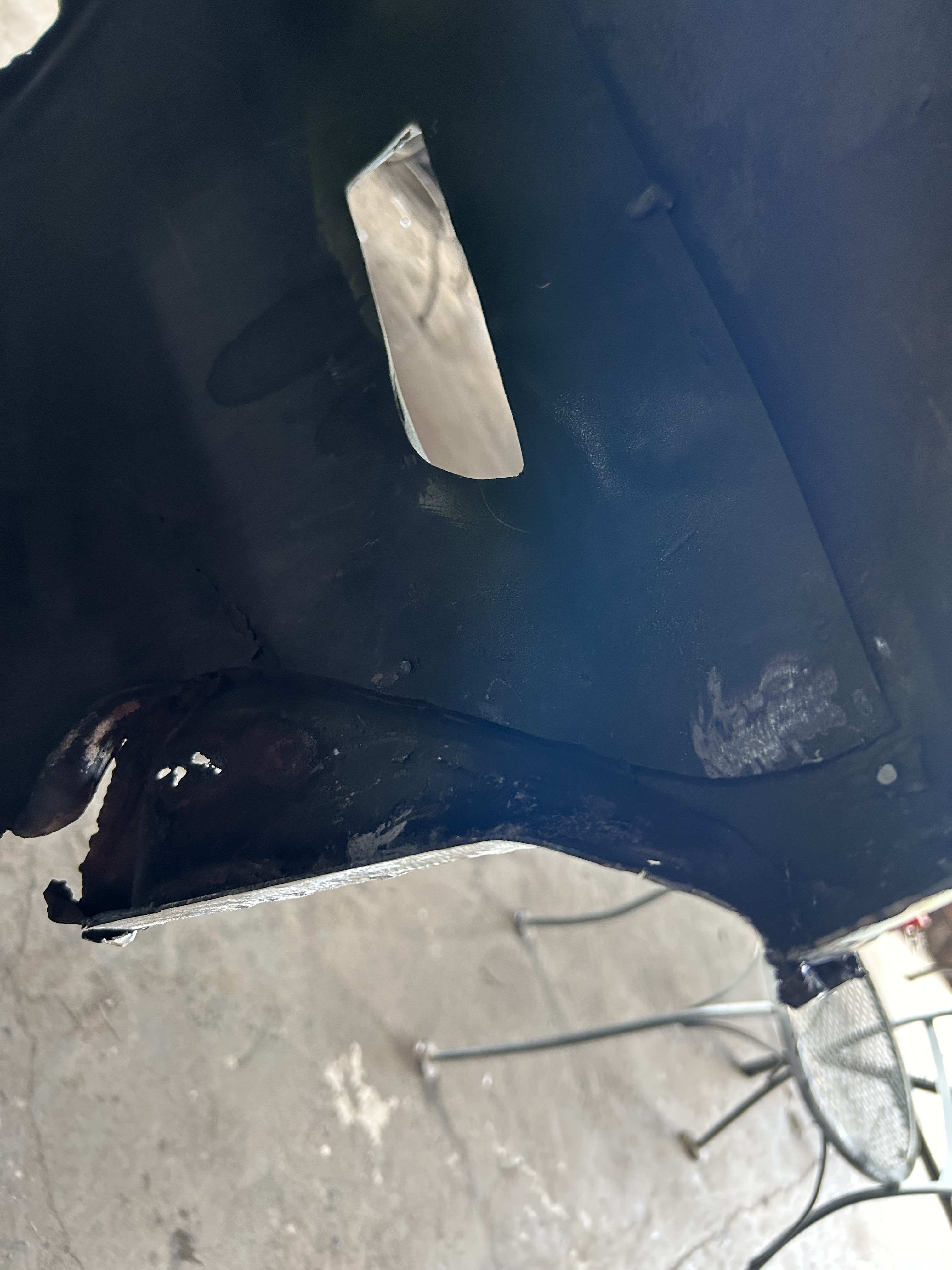

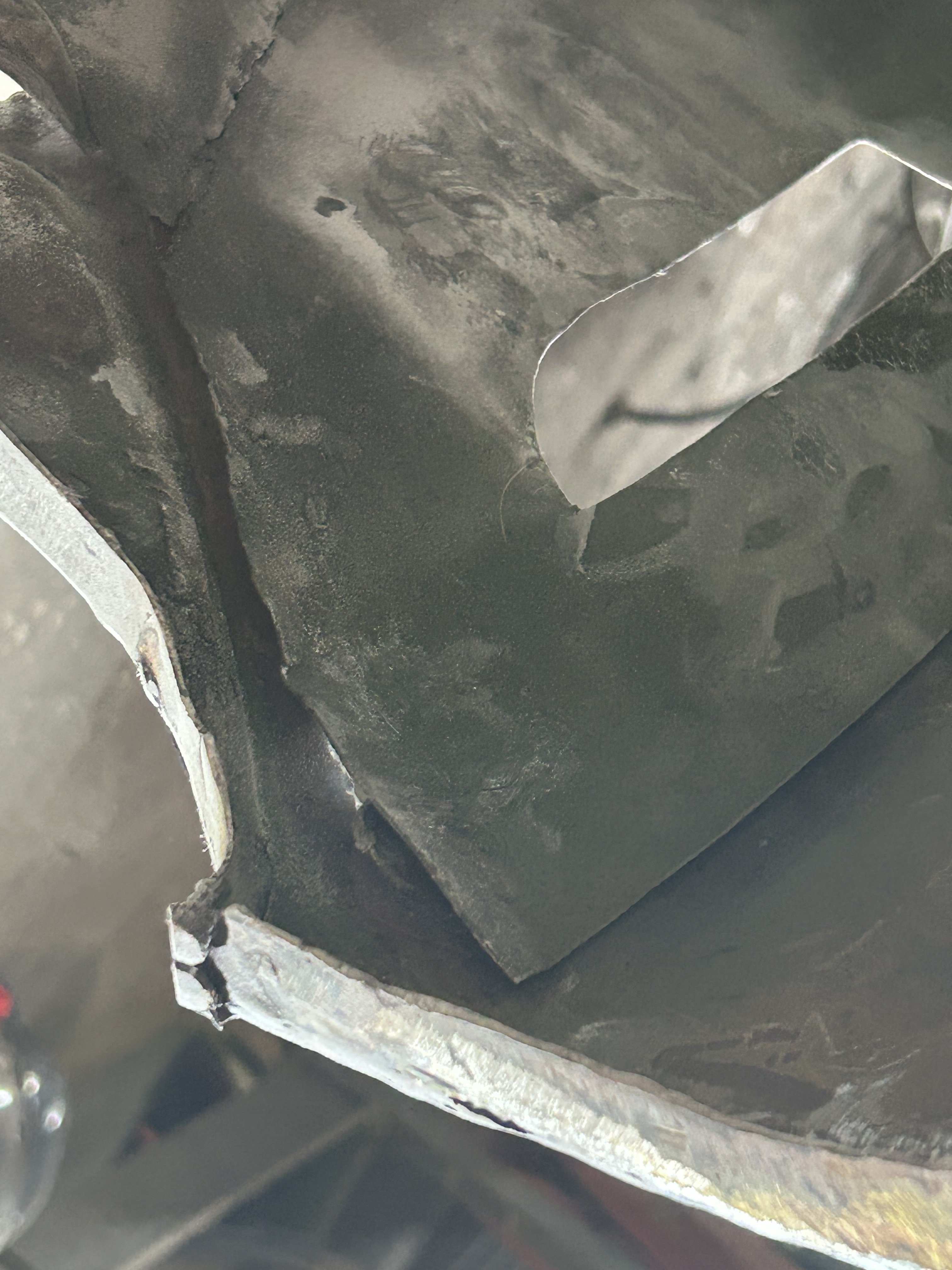

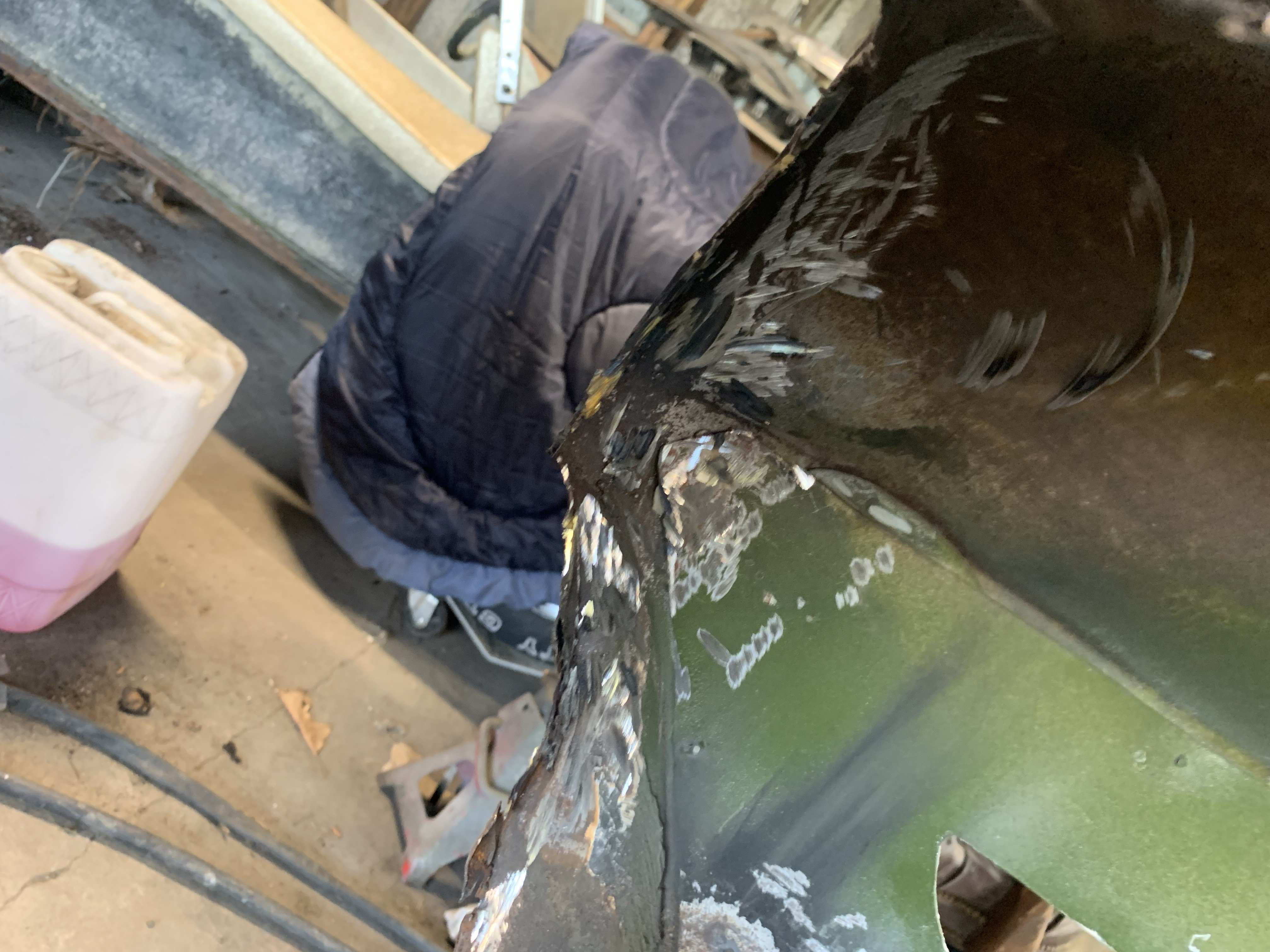

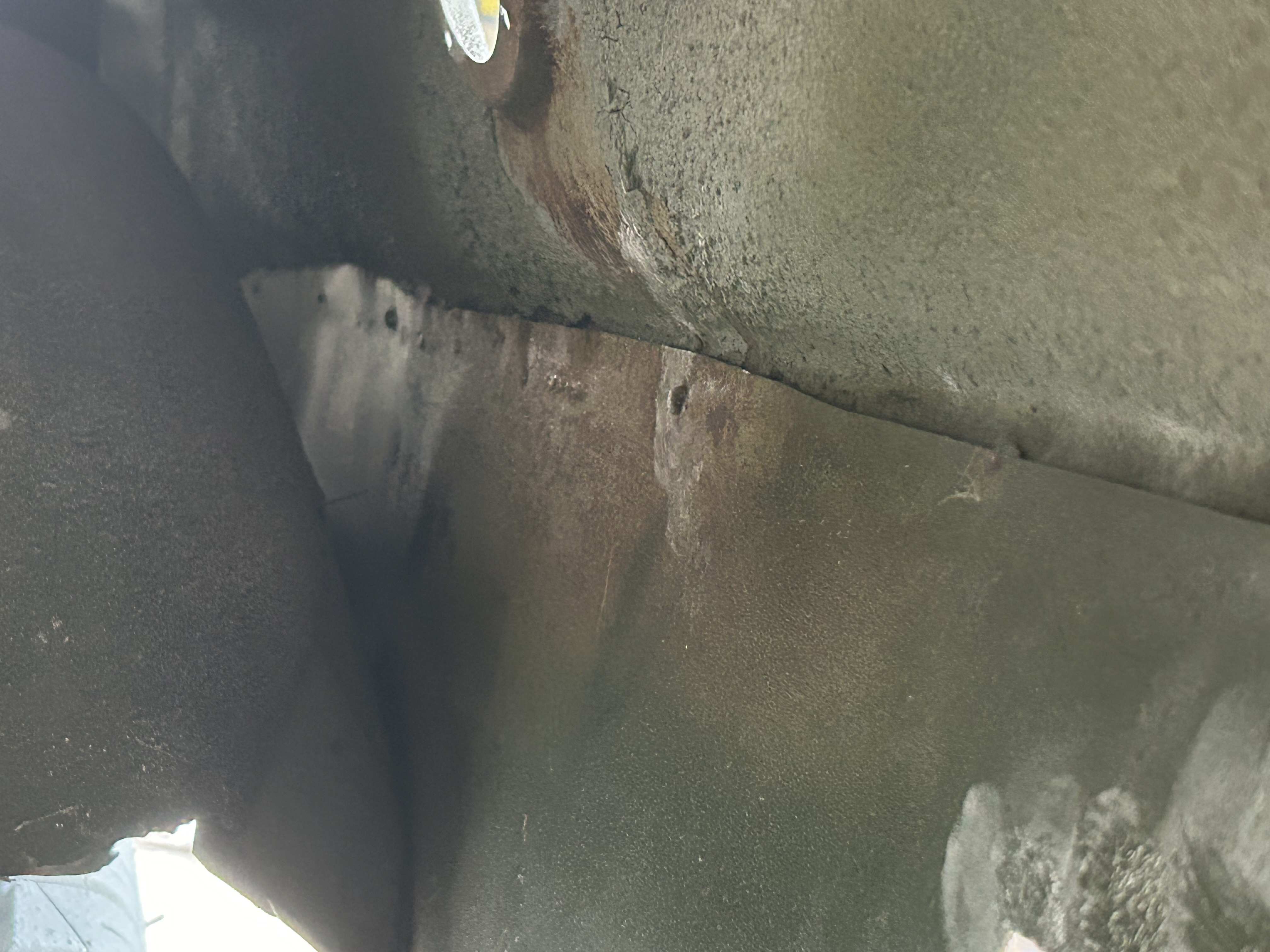

Looks like they smeared bondo underneath to hold the panel in place.. it’s some welds but the entire thing is not welded..

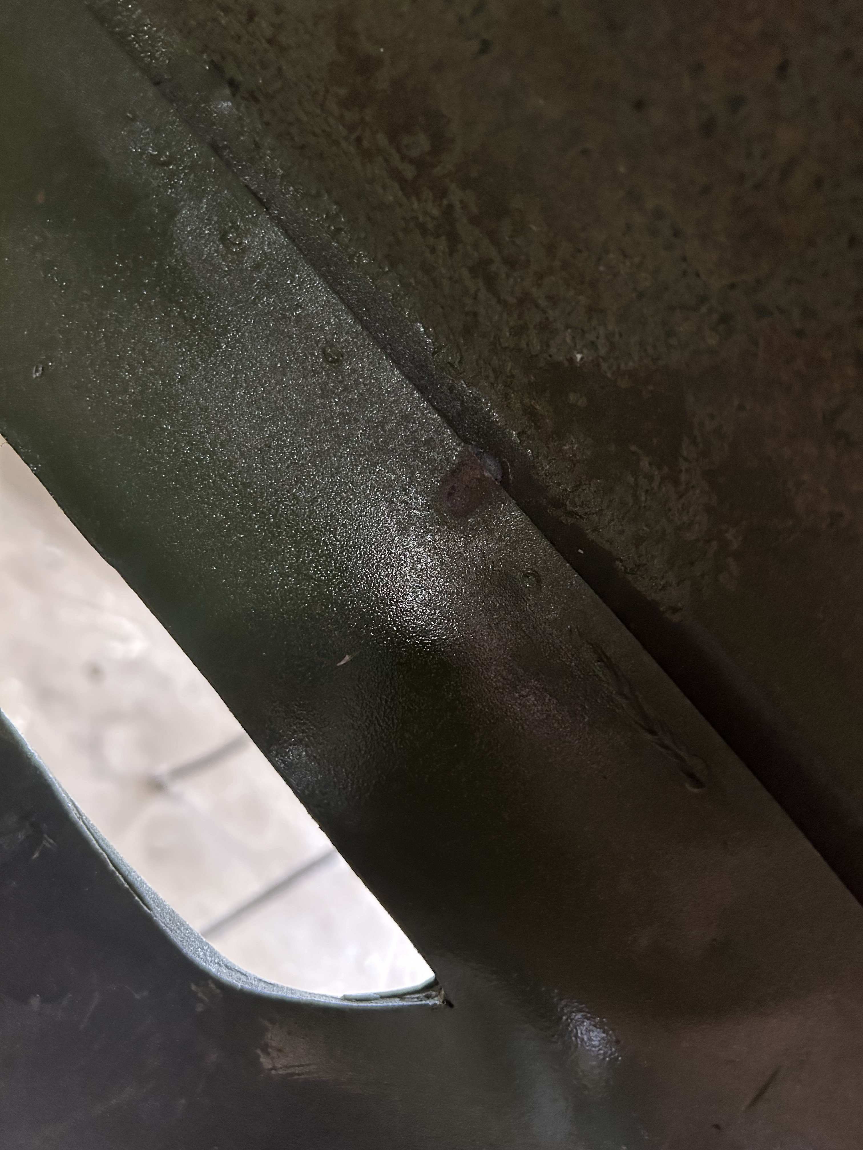

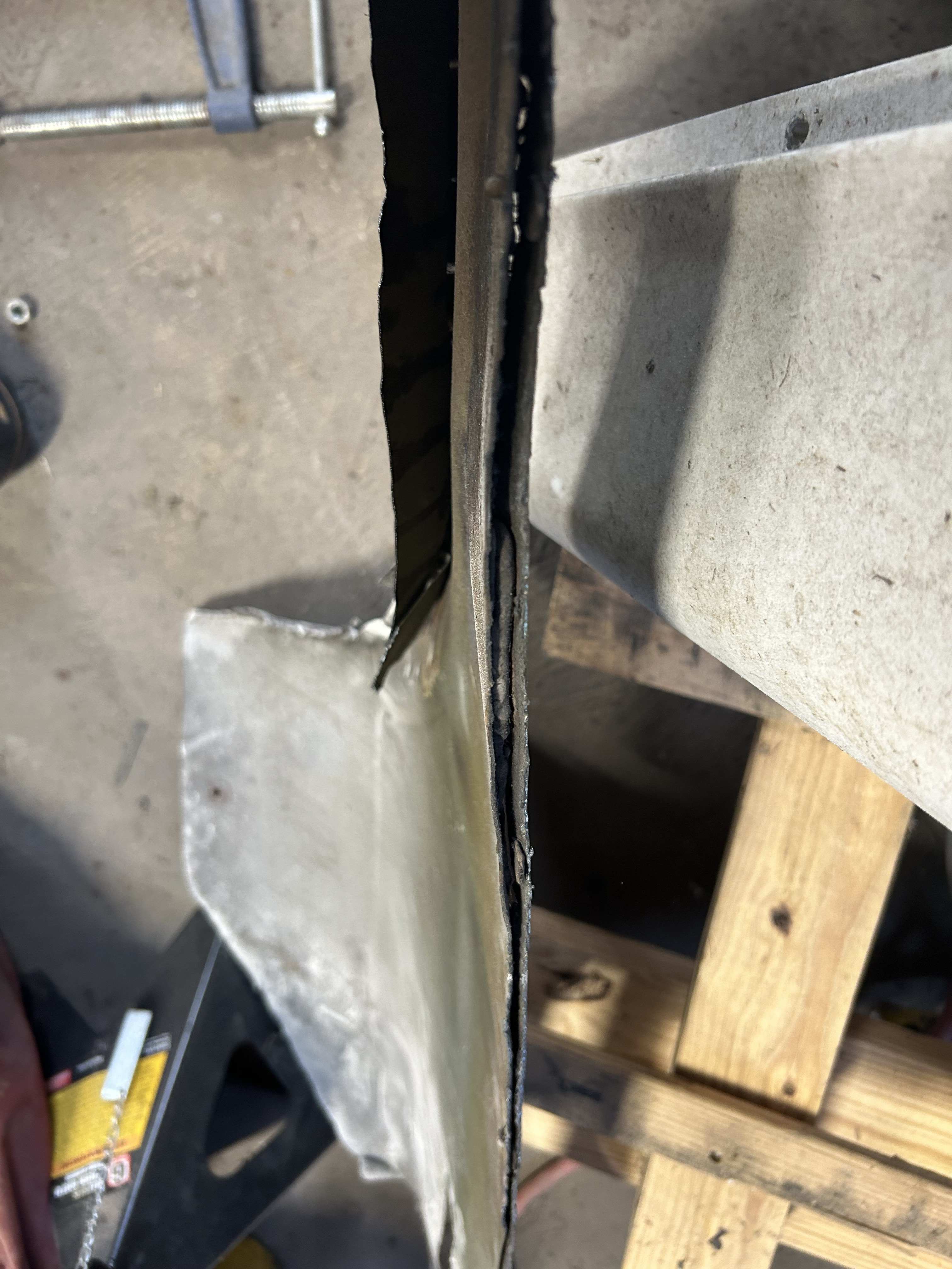

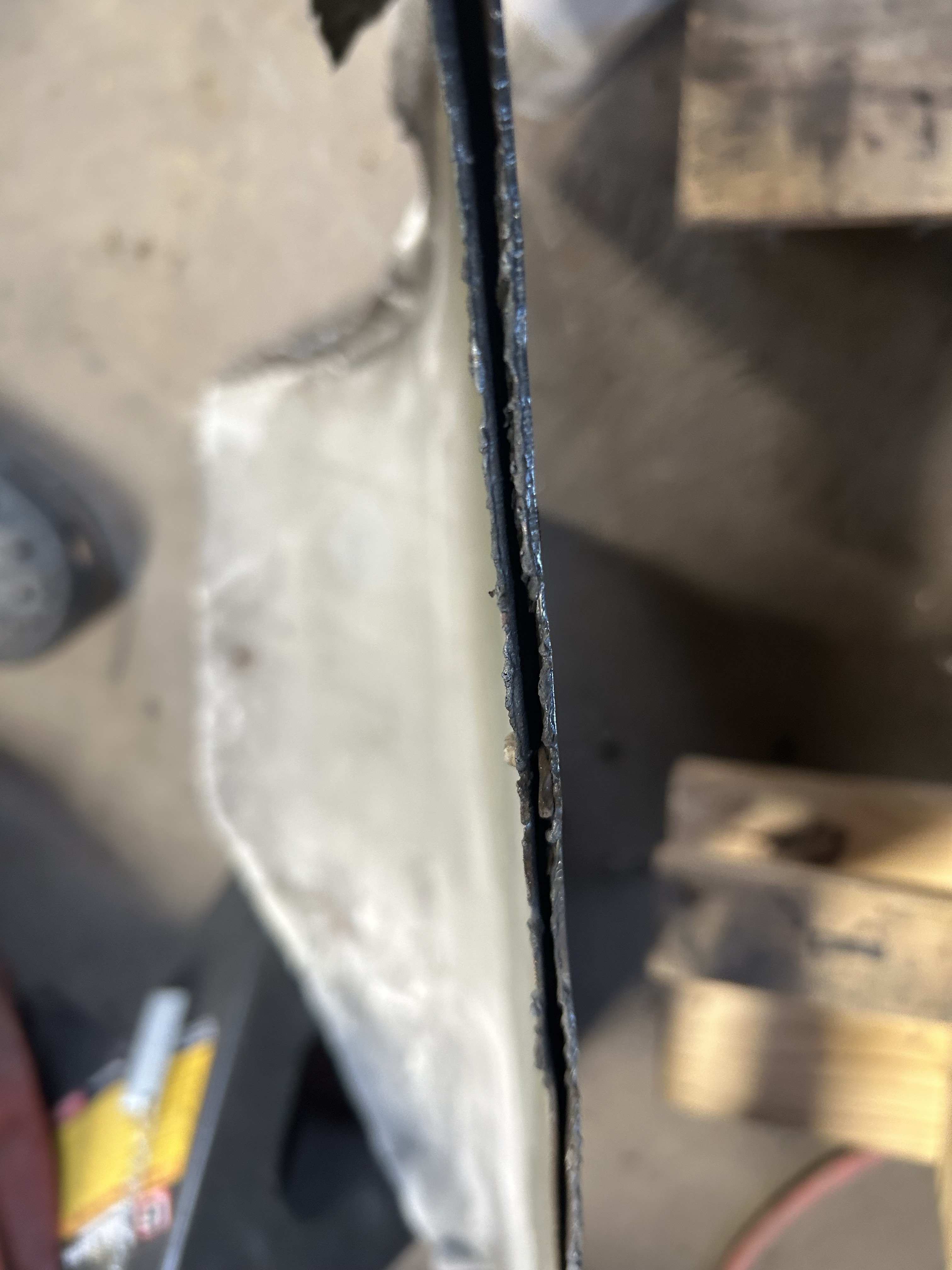

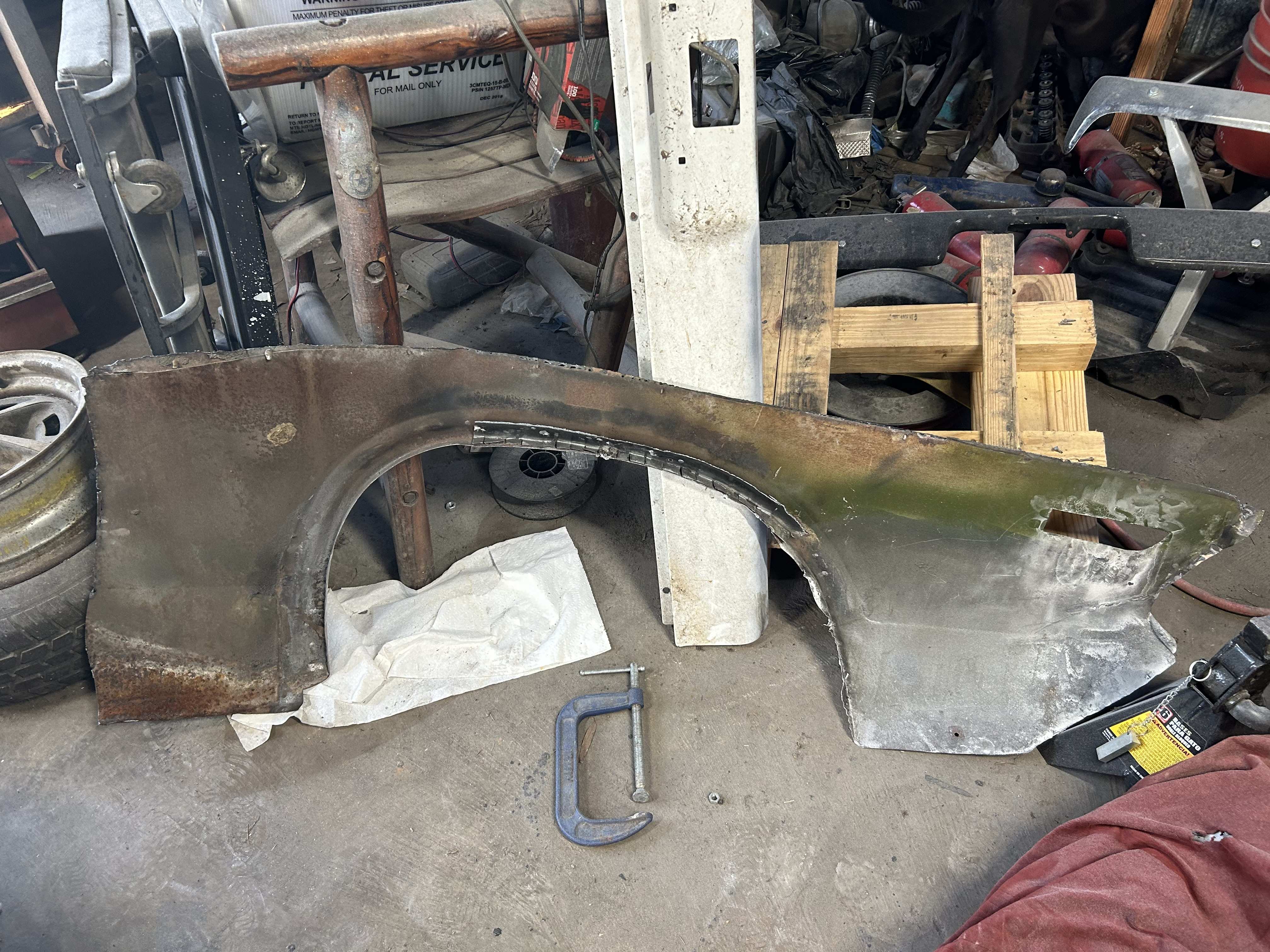

also it’s double lined two sheets of metal stacked…

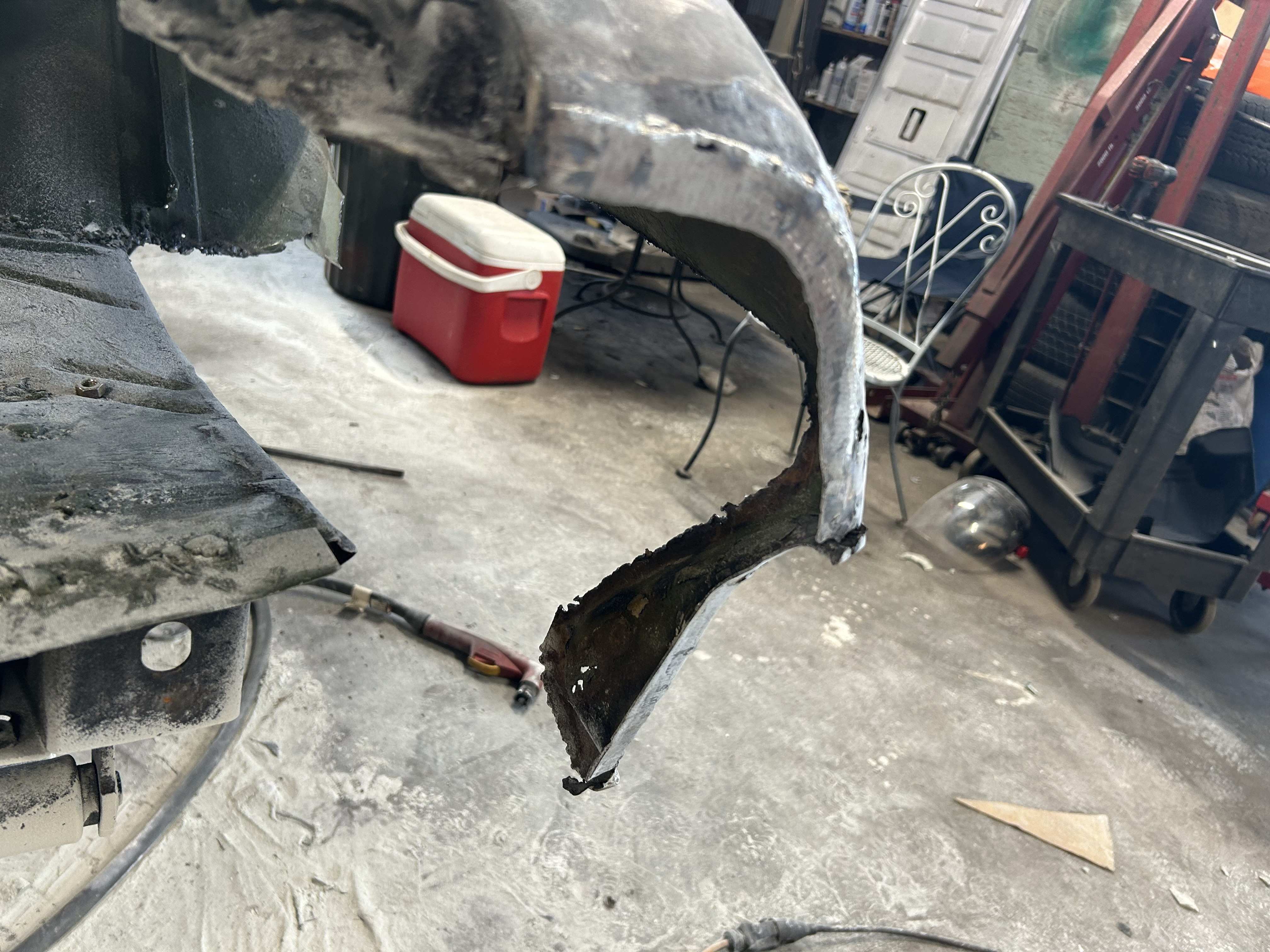

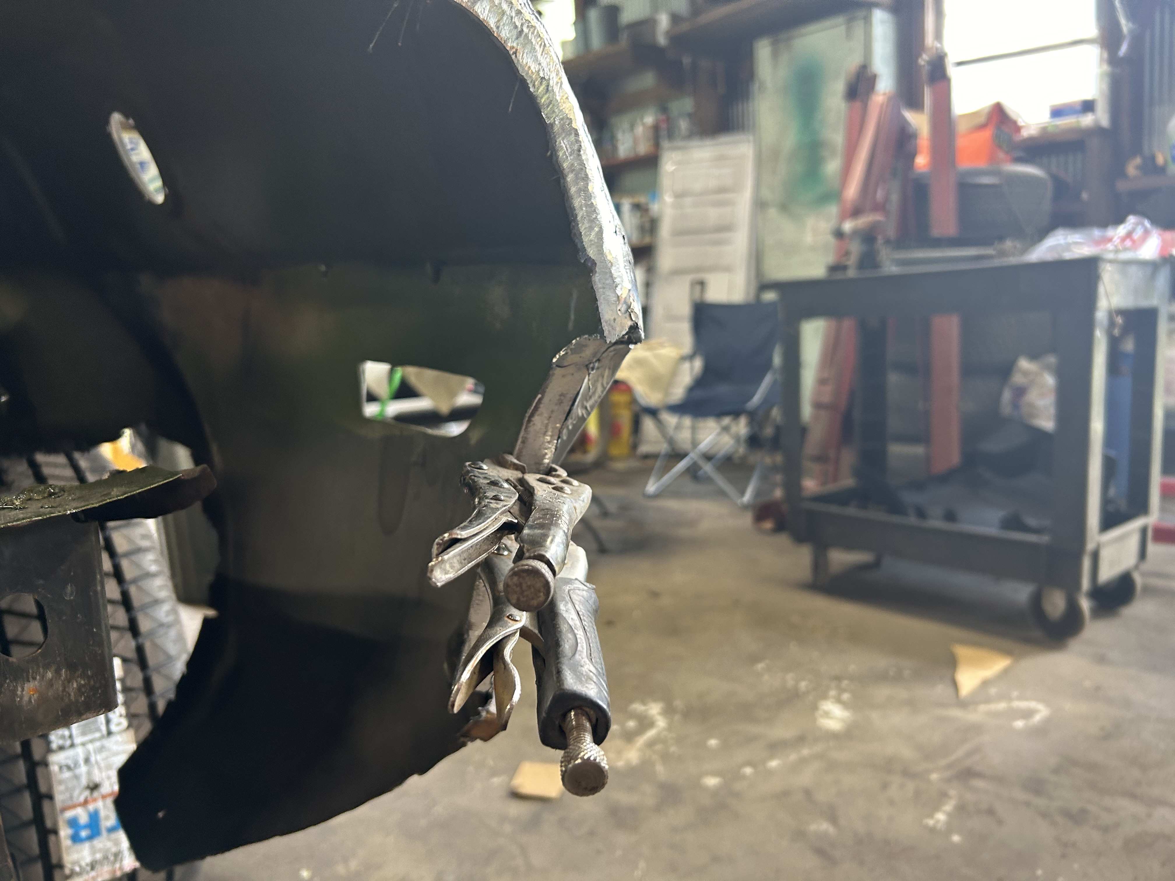

on the outside of the car-they used bondo to fill in the double lined.. looks like they took another cars quarter panel and bonded it in for a fast sell..

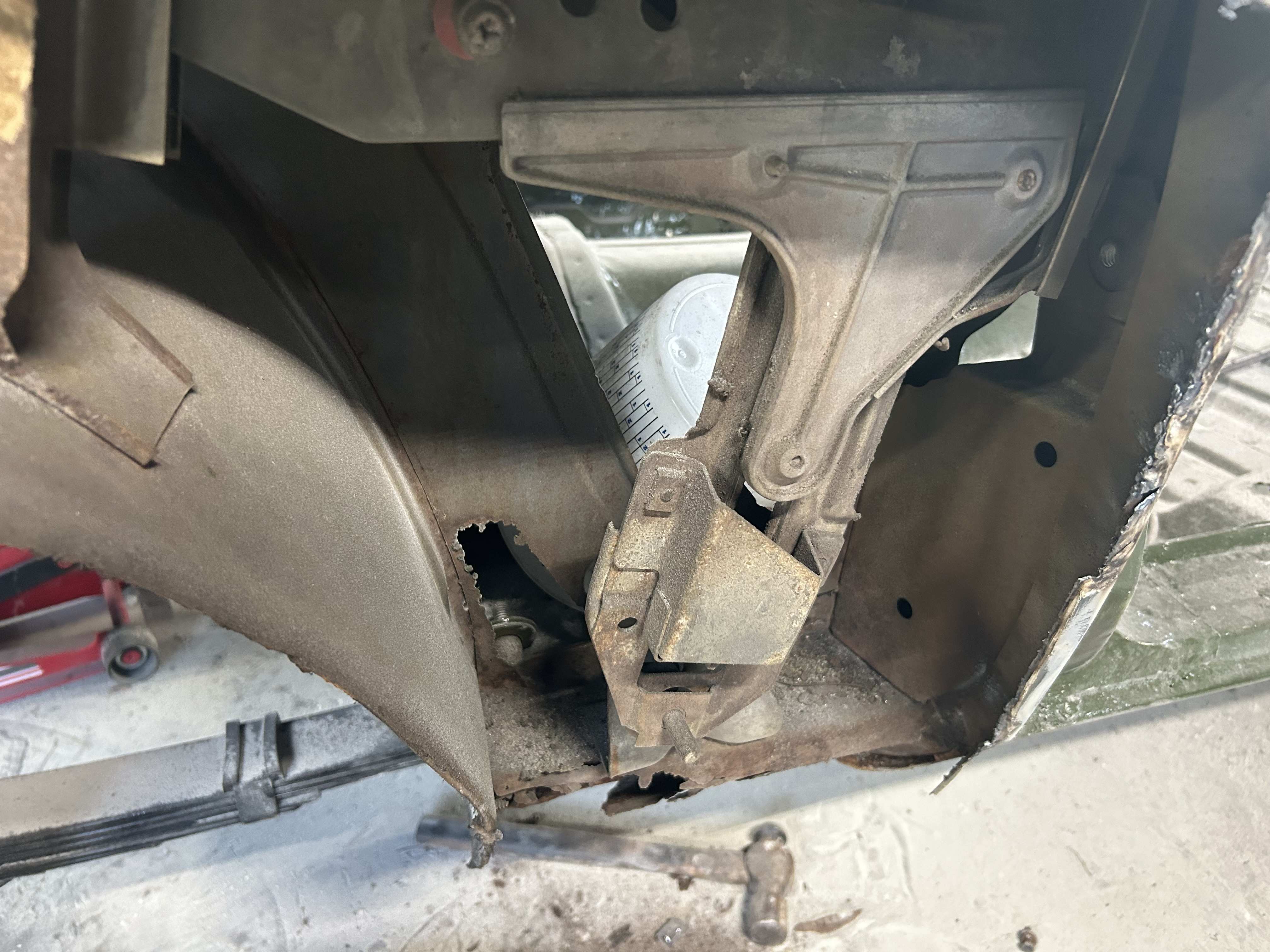

I’m gonna try to fix it without buying anything but metal at Lowe’s and using the pre existing metal I cut out.. I just don’t won’t a inch of bondo-3/16 is better to me.. dad said don’t do anything to the driver side until this side is done.. the driver side was done better than the passenger side..
Yea it was bondo on there..

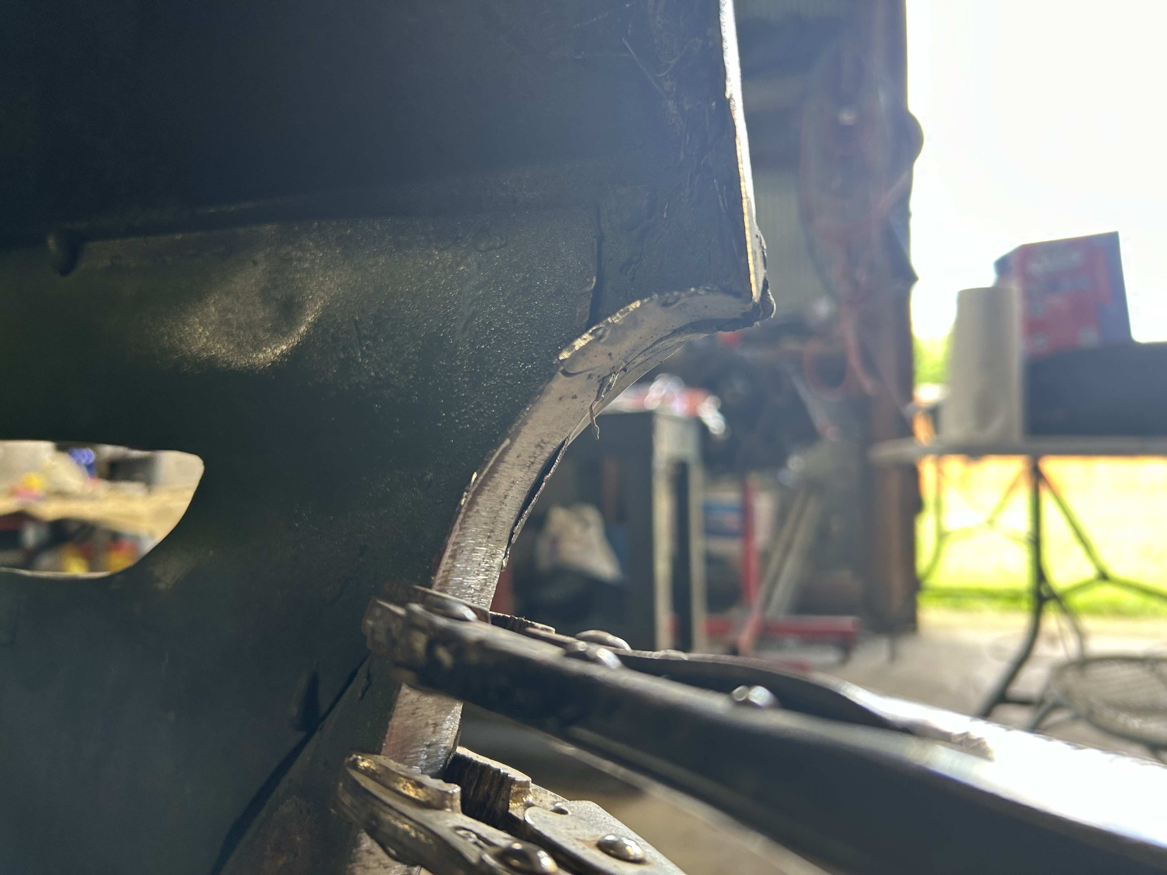

I want to save the quarter panels because of the se holes..

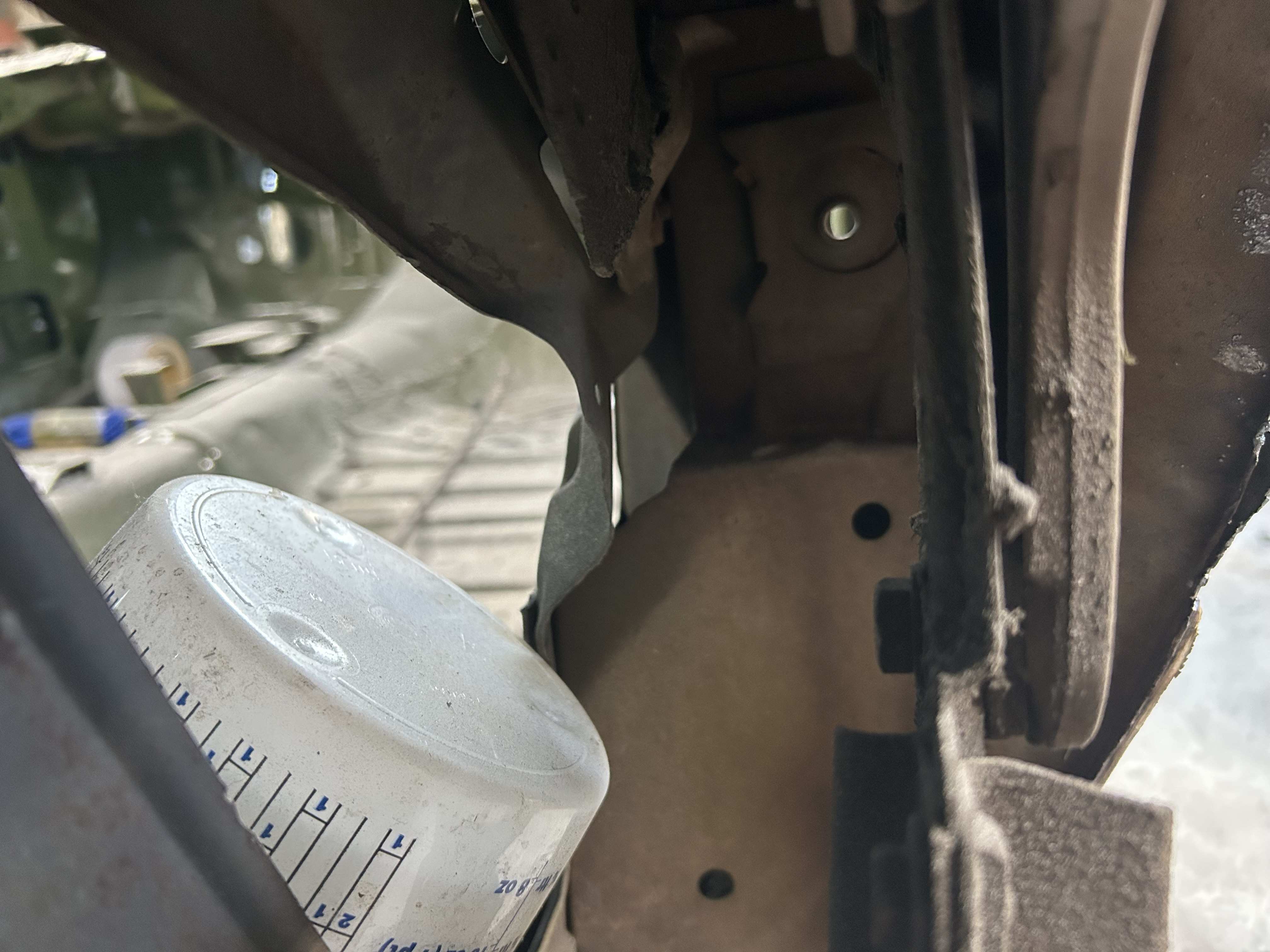

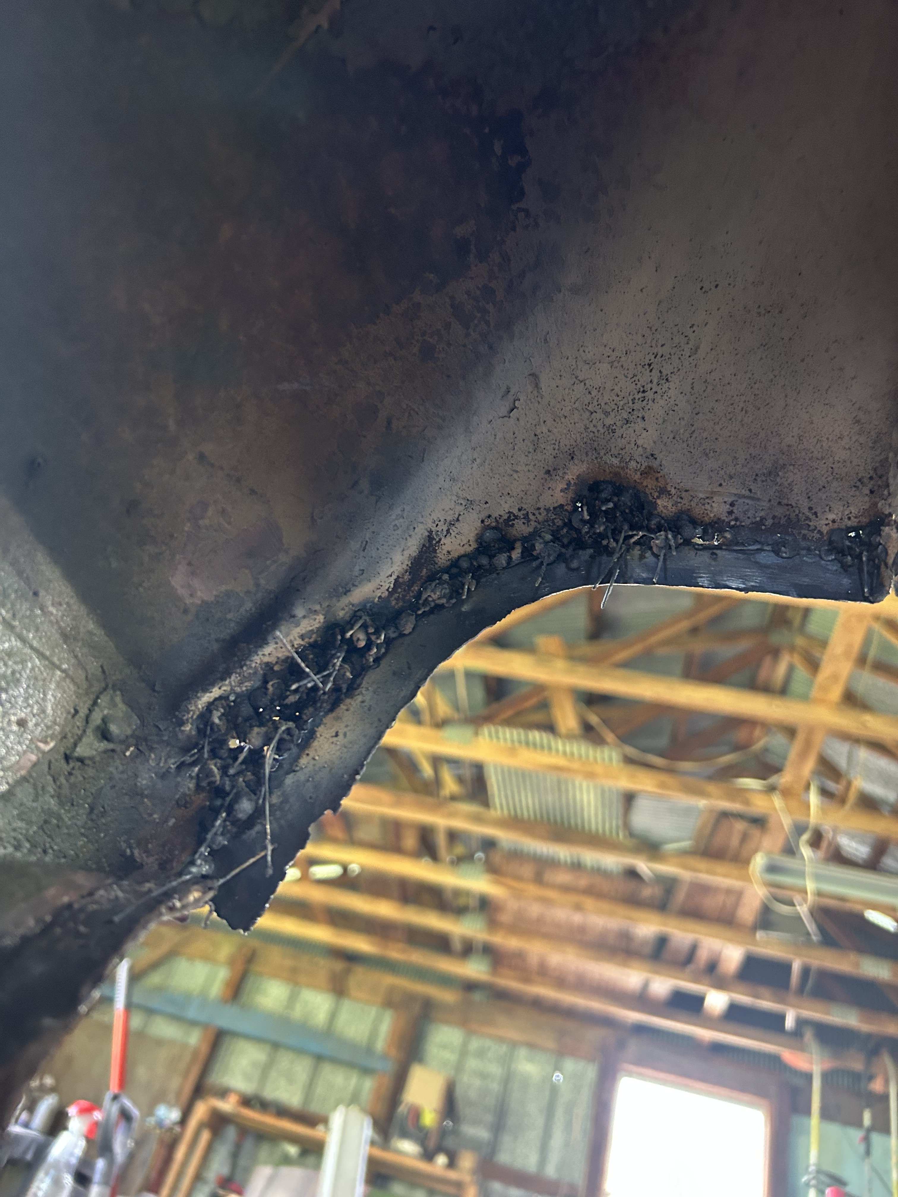

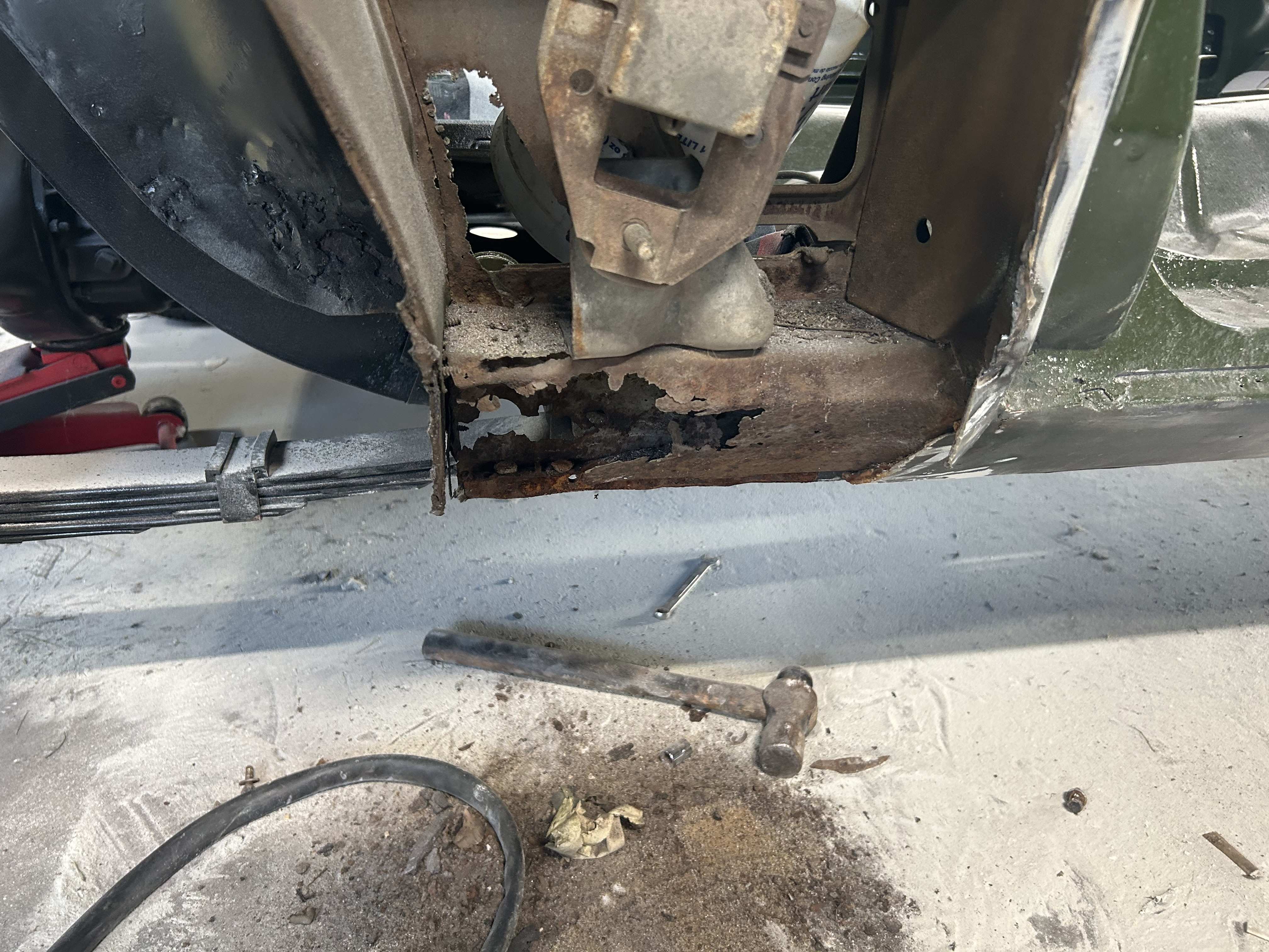

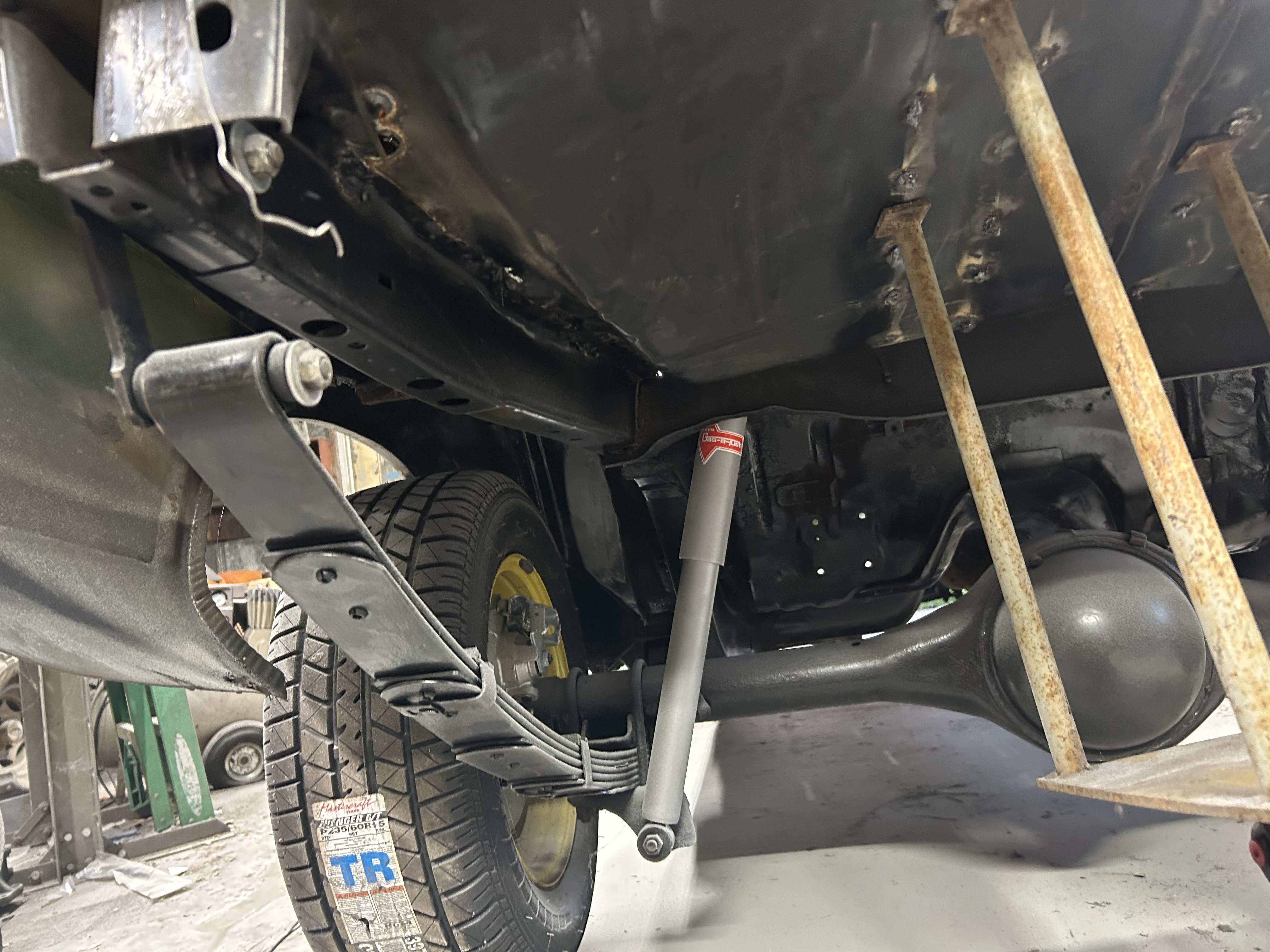

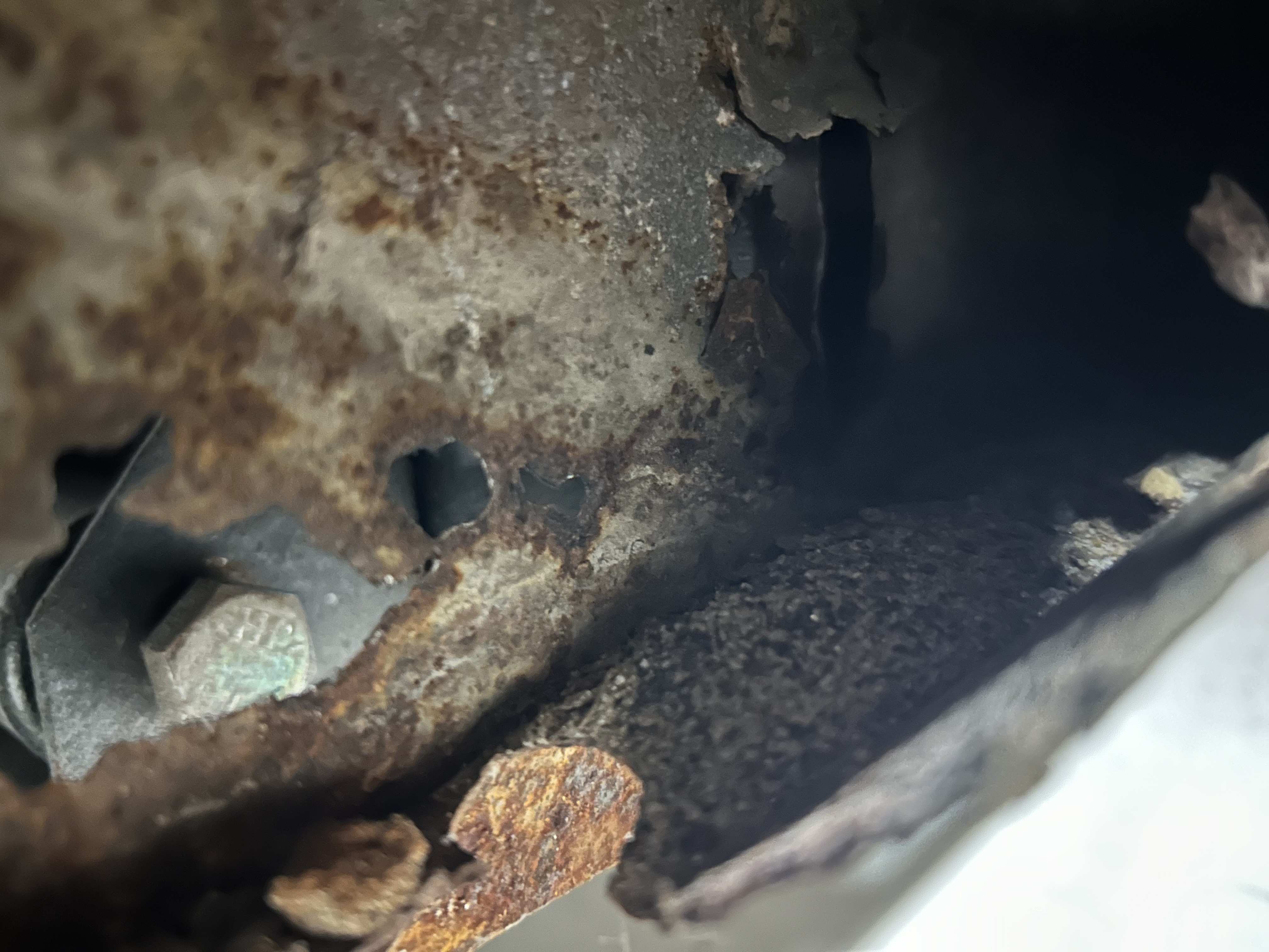

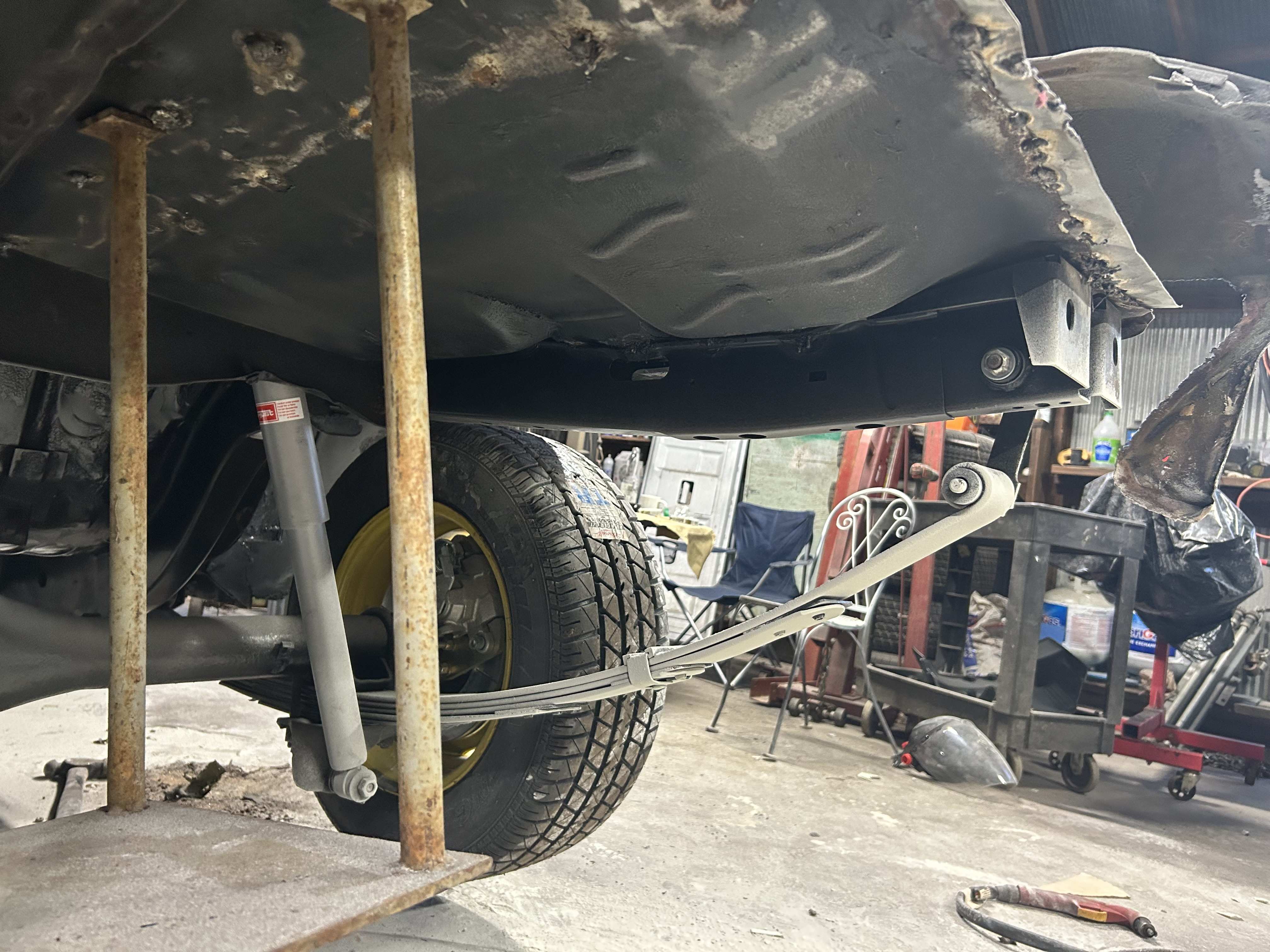

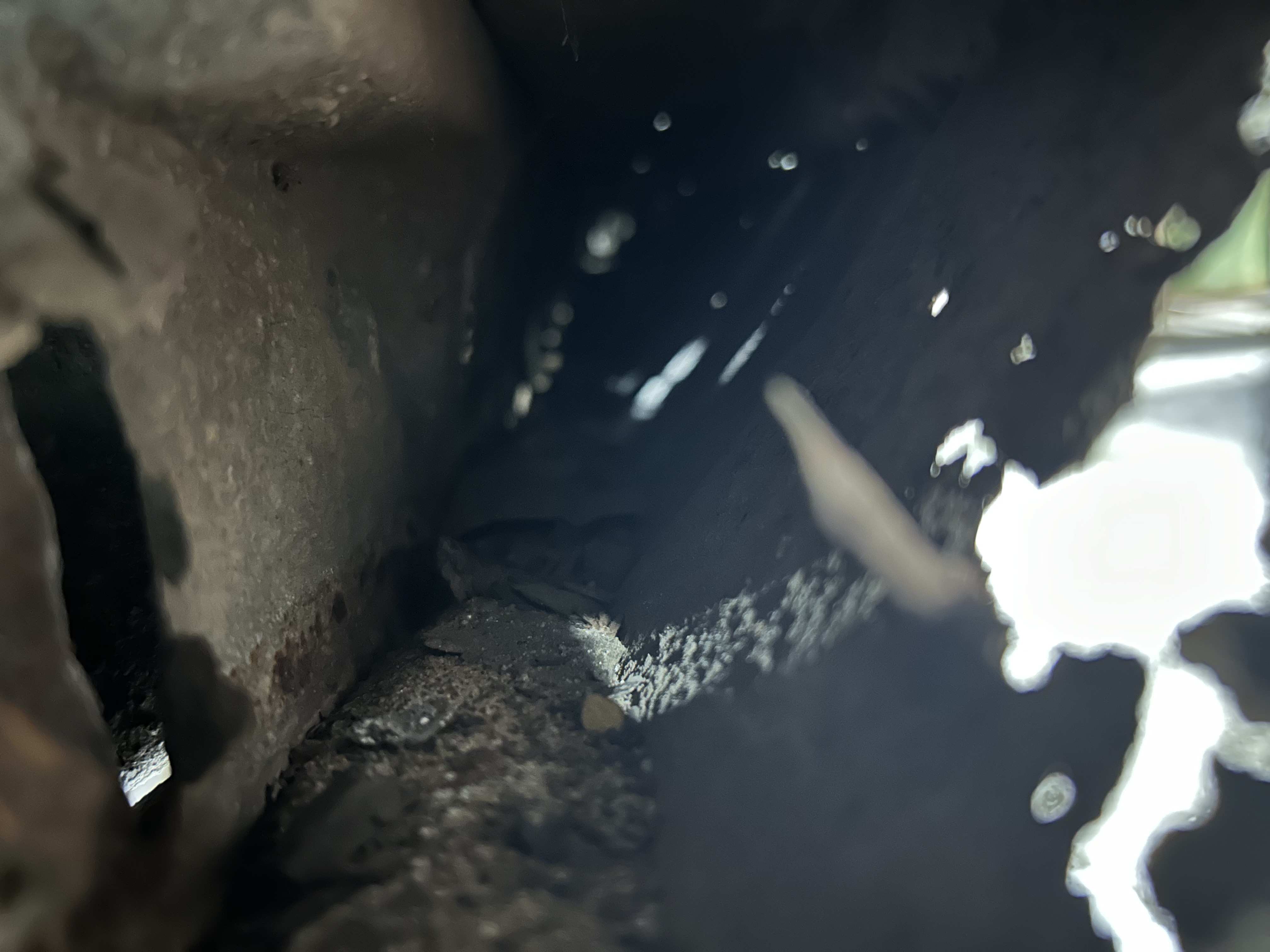

That where the leaf spring support is welded to.. their isn’t a part on this car that doesn’t have pits..
