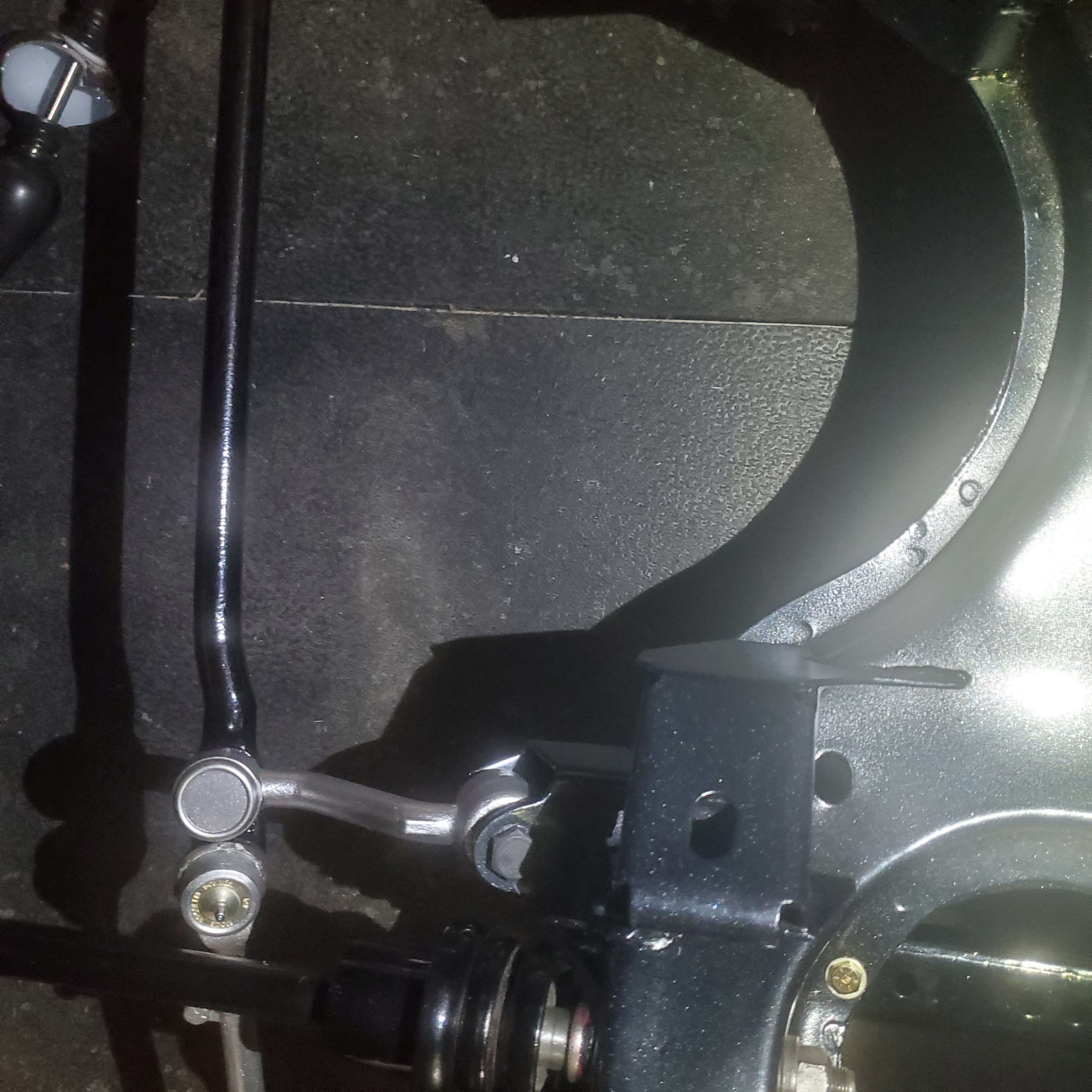

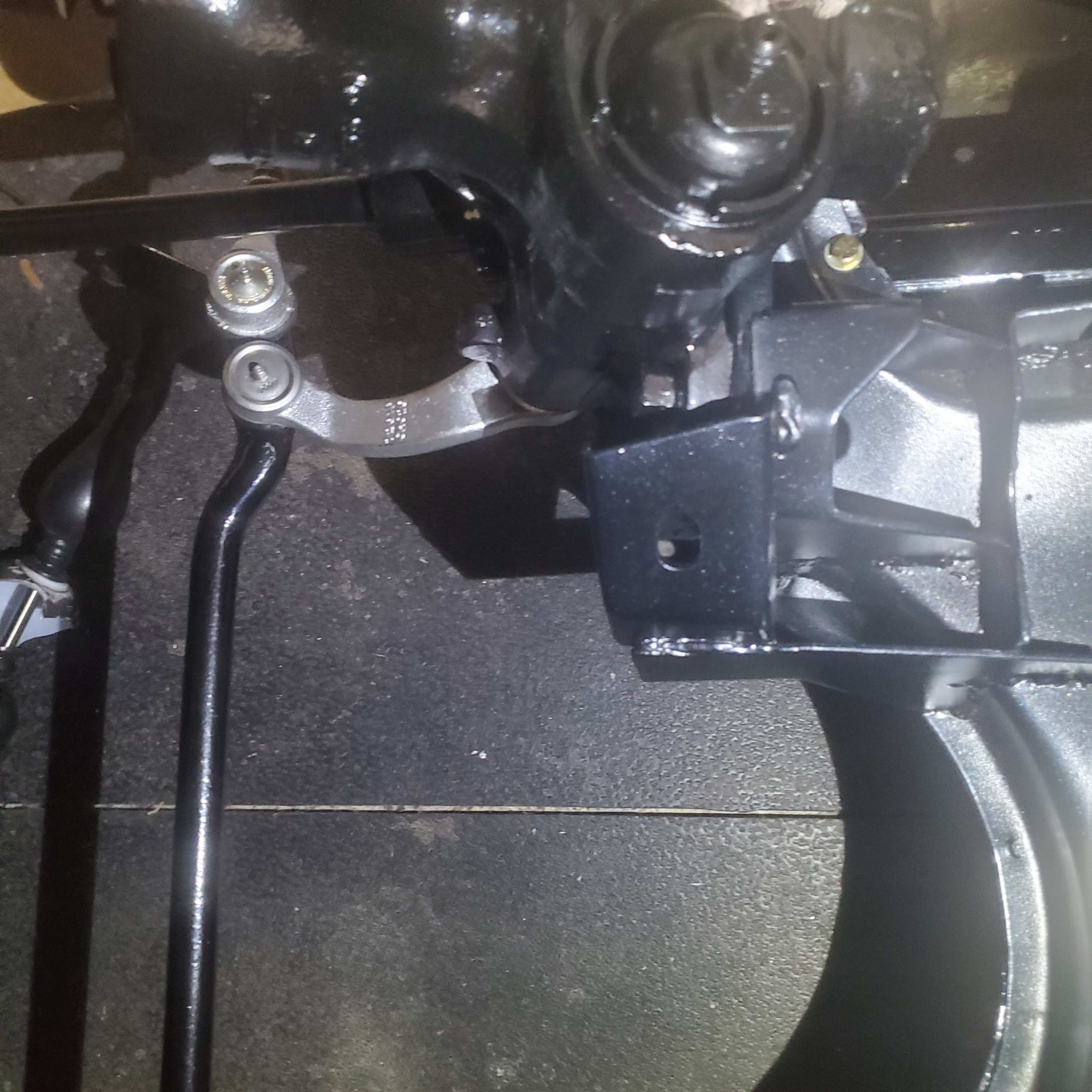

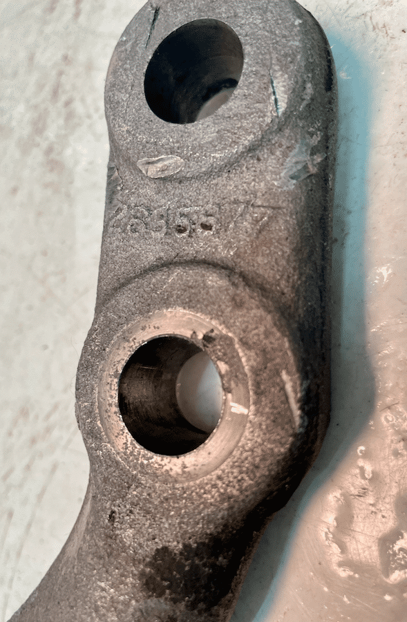

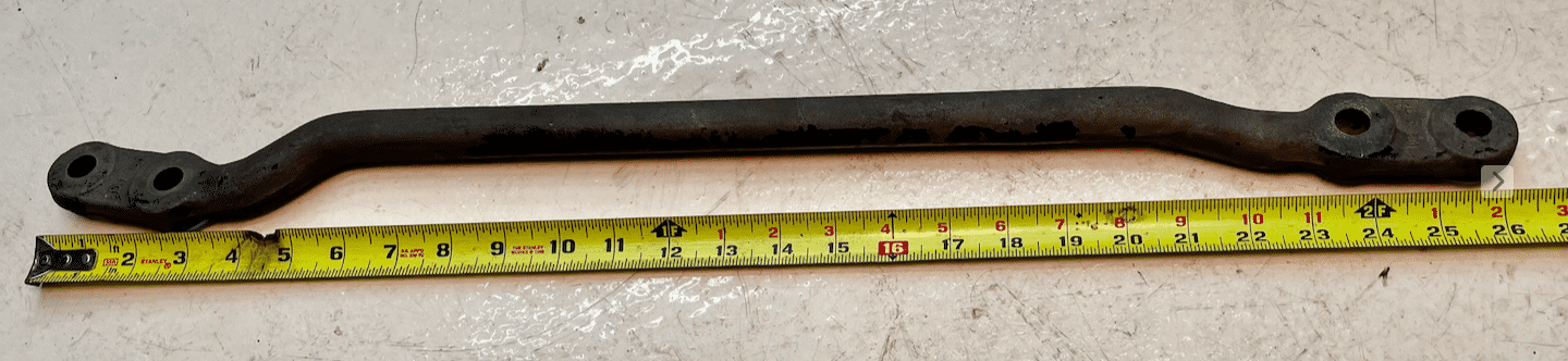

CENTER LINK INSTALLED CORRECTLY?
dennispsalm91
Nov 8, 2023
89
15
Palm Coast FL

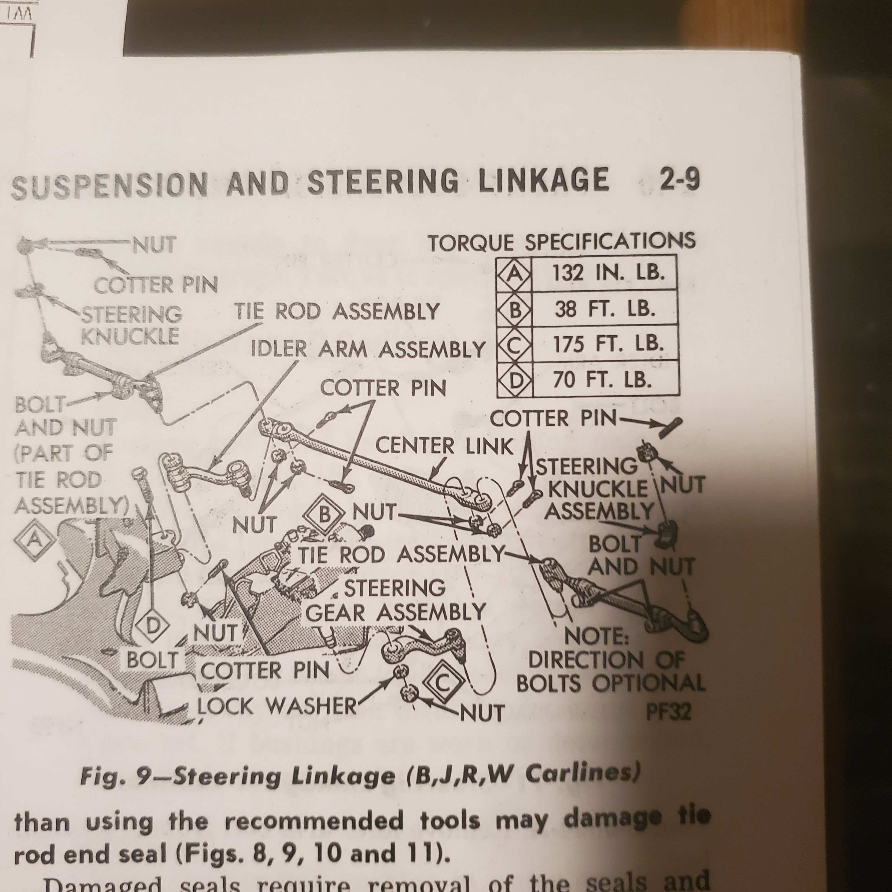

Can someone confirm this is correct, the manual has a bogus picture, 73 Challenger, thanks !
Thanks guys for your help, had this car for 14 plus years. Someone took it apart. Now after finally getting car painted, and now recently retiring. Time to enjoy putting it back together. Looks like ill be using this site frequently

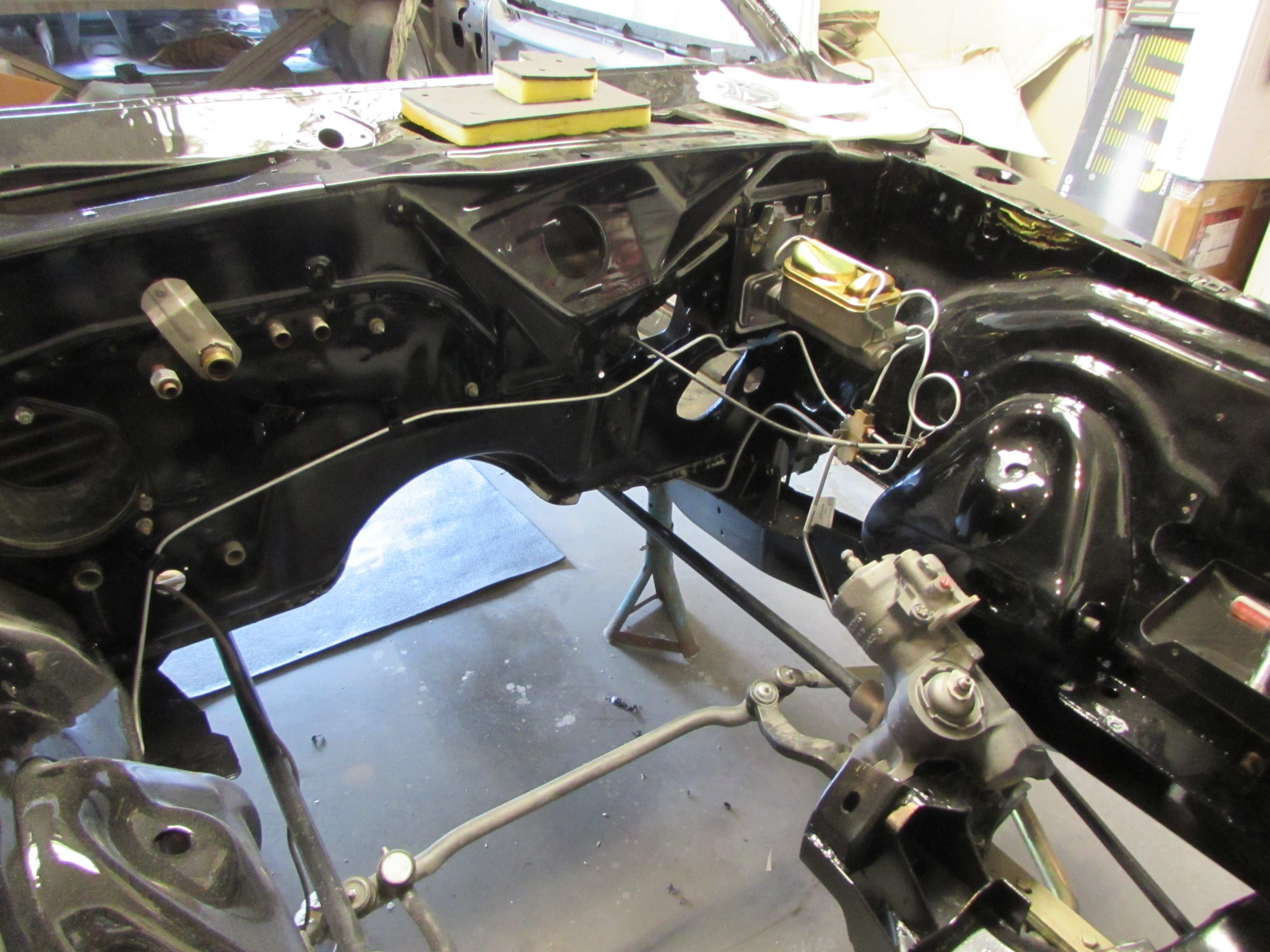

I took a lot of pictures before I tore mine apart, so let me know if you need any pics.
