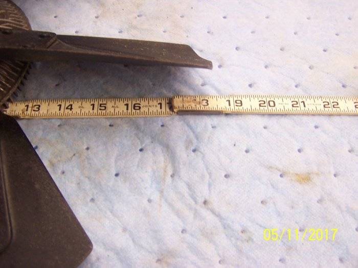

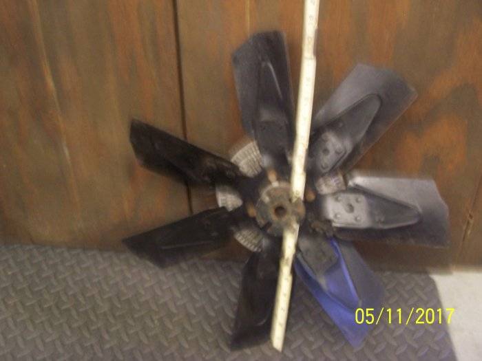

Does your car have the 26" radiator or 22"? Also does it have a shroud? My book shows a 18" 7 blade fan for a 440 without air PN 2863 224. I am guessing that would be with a 22" radiator. If you have the 26" radiator with a shroud, your best bet would be PN 2863 216 (18 1/2") with clutch 2863 260. Those parts are for 340, 383 & 440 with AC and the 426 Hemi that did not come with AC. I think the shroud opening is the same on all. If you have the 26" radiator, I have the 18 1/2" fan and clutch. $95 plus the ride. I just checked the shipping for a guy on the B body site from Canada and the shipping was $53.95. He declined because of the shipping cost. It is boxed up and ready to go if interested. Here are some pics. There are a dozen of them on ebay now and some are new. Tony's parts has new repopped fans in the 2863 216 PN.
