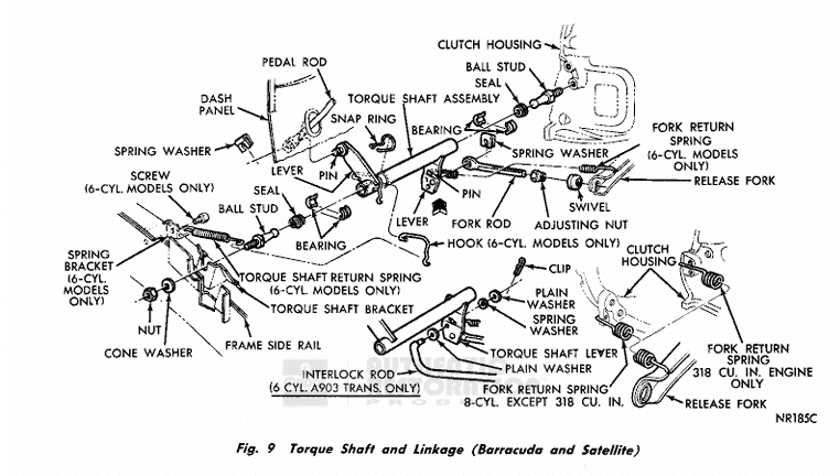

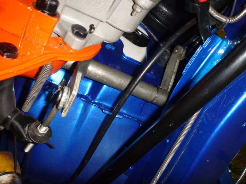

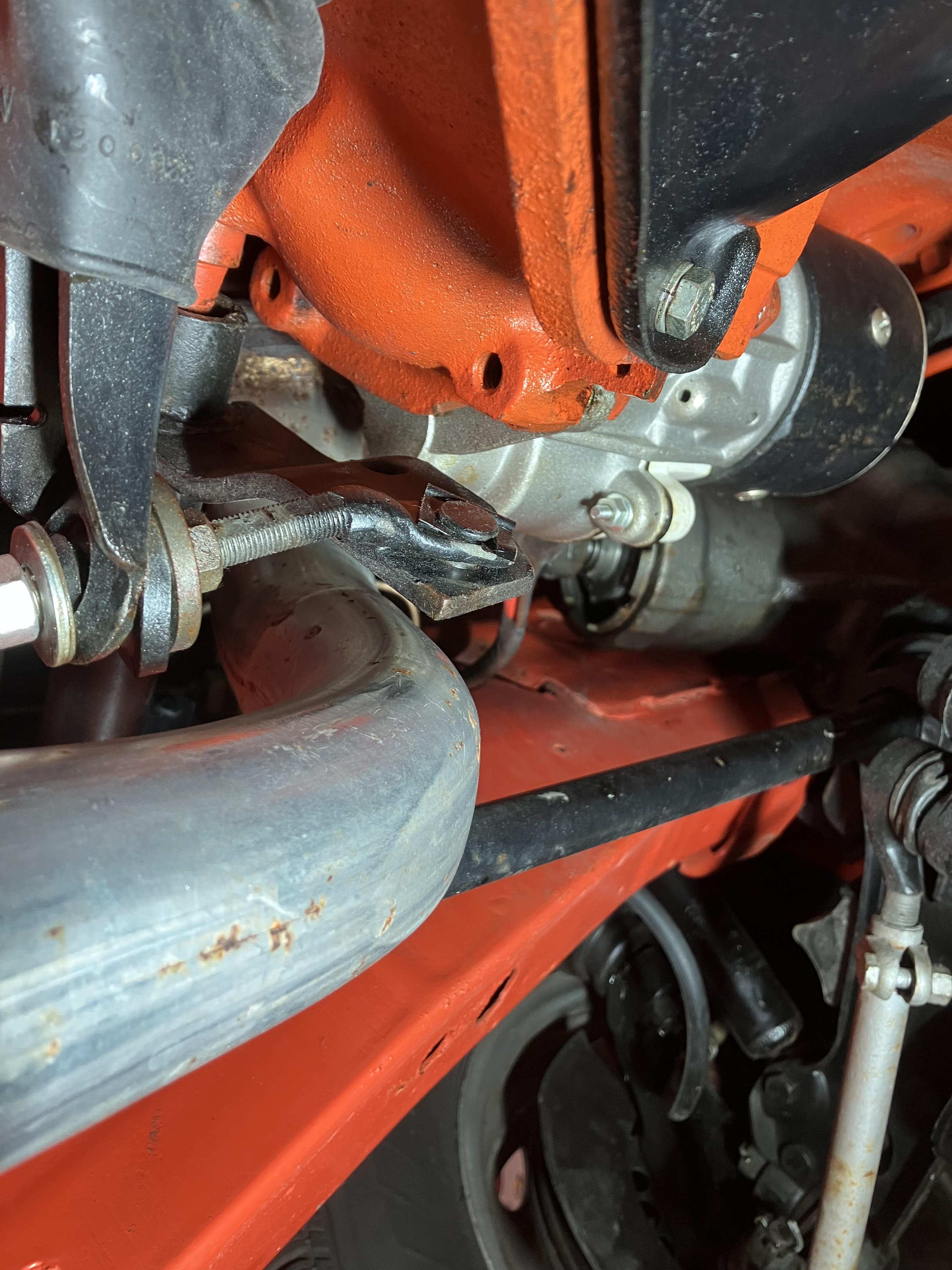

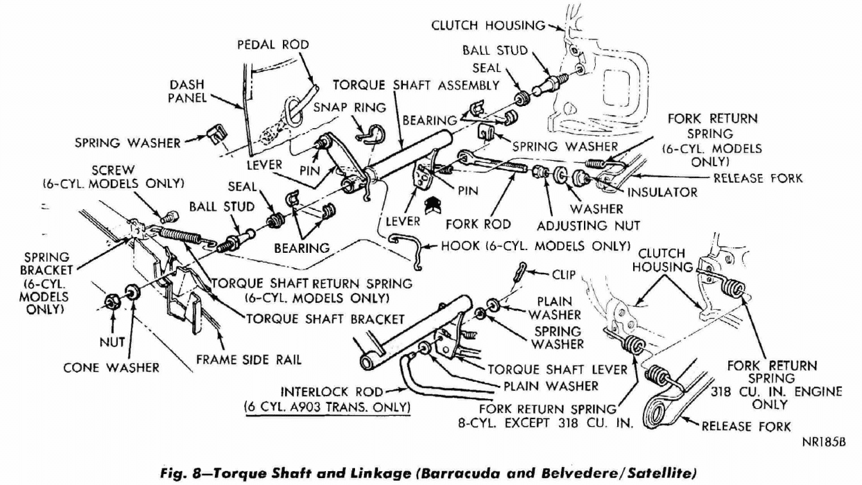

challenger clutch
Challenger RTA
Oct 28, 2018
2,666
1,335
PA Flood city
71. bring the nut forward,then just take up the slack by running the nut to the rear. check pedal play run nut to back to desired pedal feel. When done clutch pedal might be a little higher then brake.
