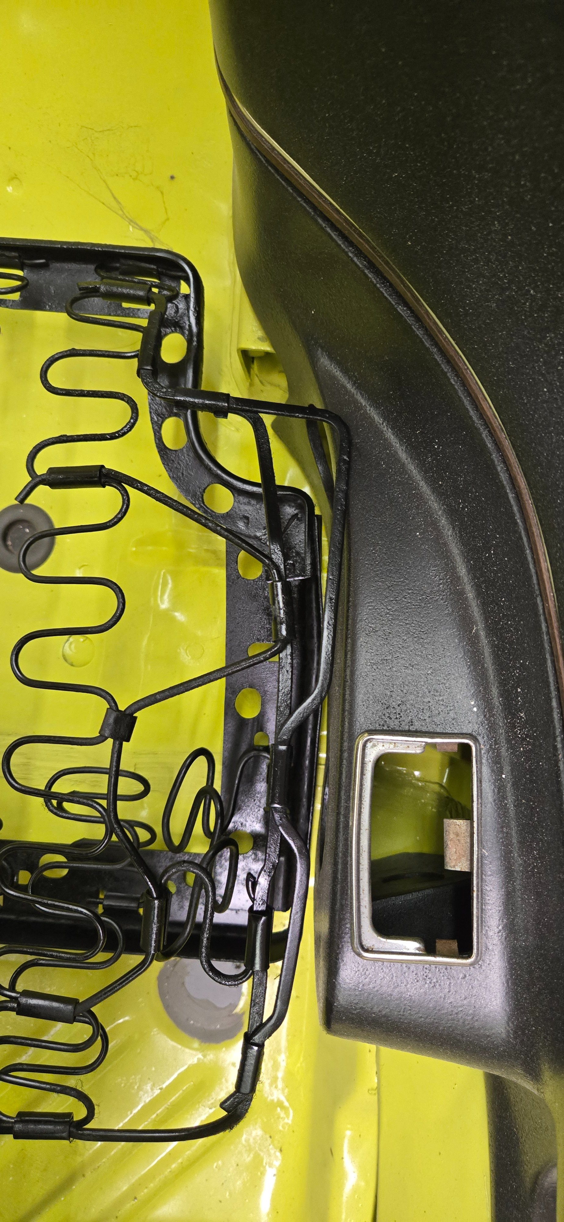

Doing upholstery. Thought I'd post the differences between hardtop and convertible rear seat bottoms.
I see classic industries offers a back for $800, but no bottom. Because the hardtop will work.

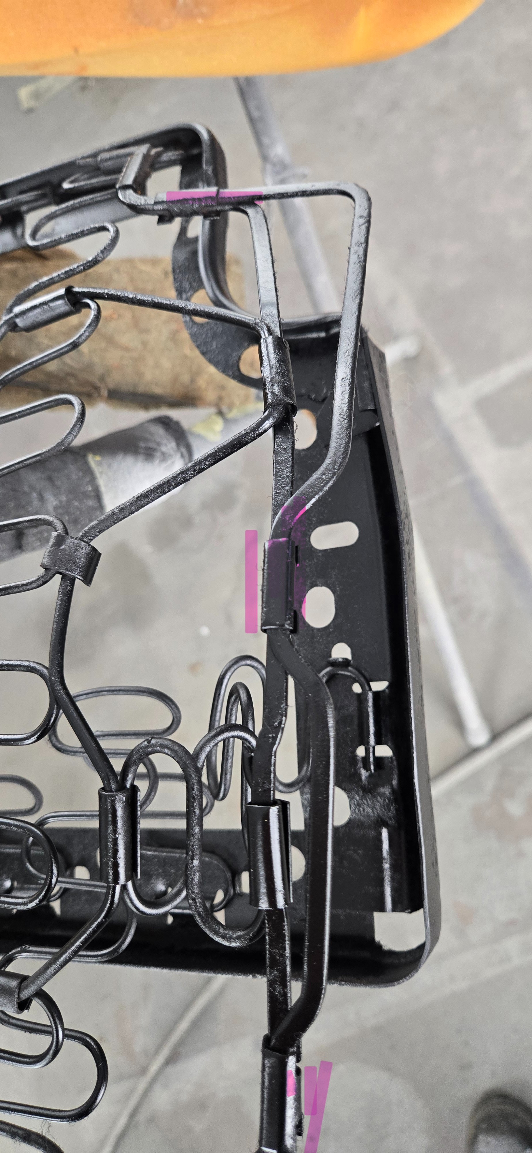

The bottom frame is the same, once you remove a barrel clipped on side brace. The hardtop seat will not fit with it installed.
The pink clips are the one to remove.
