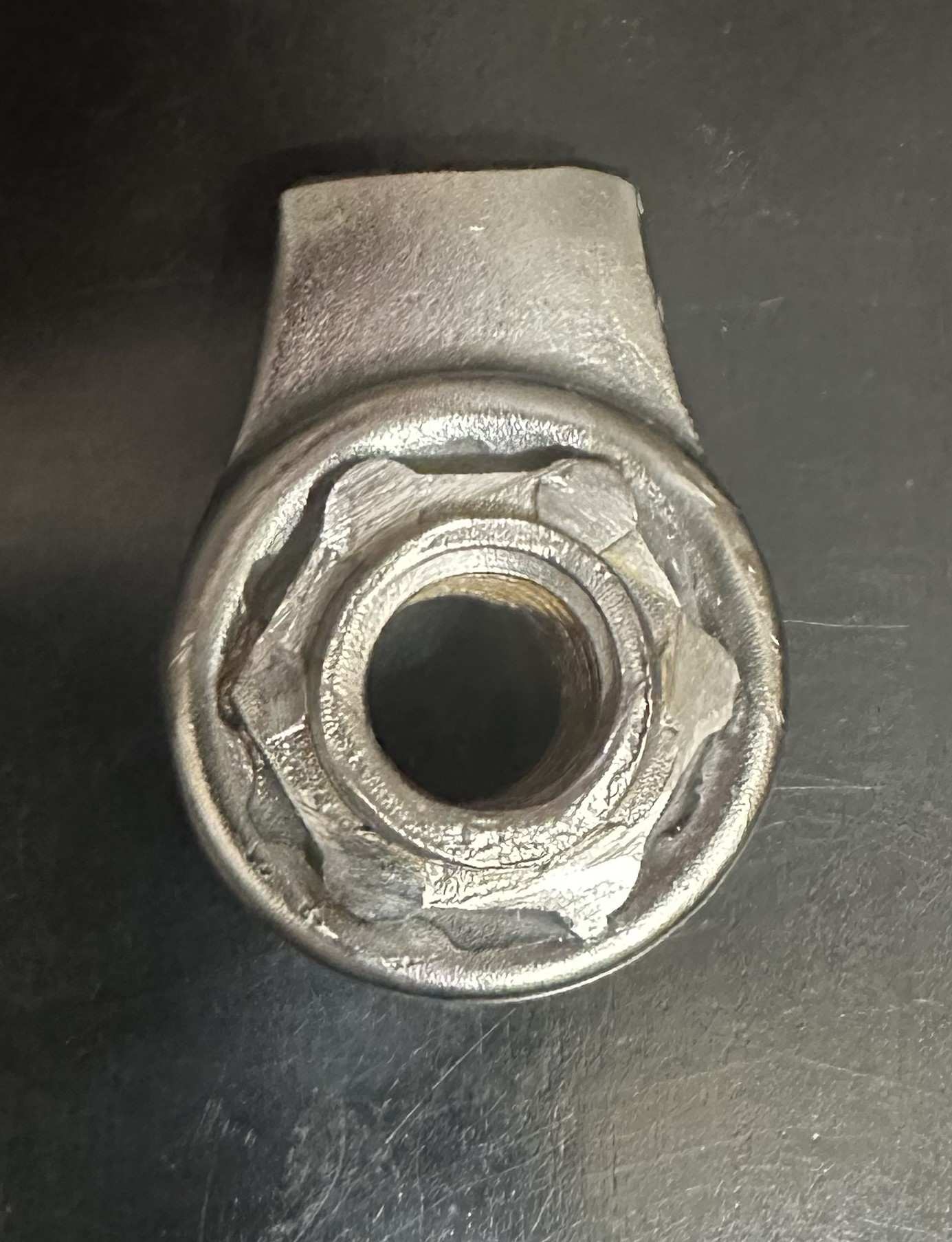

- Cut the closed end off a cheap 13/16" wrench.
- Applied JB Weld to the nut and the inside of the wrench head, and let it set up.

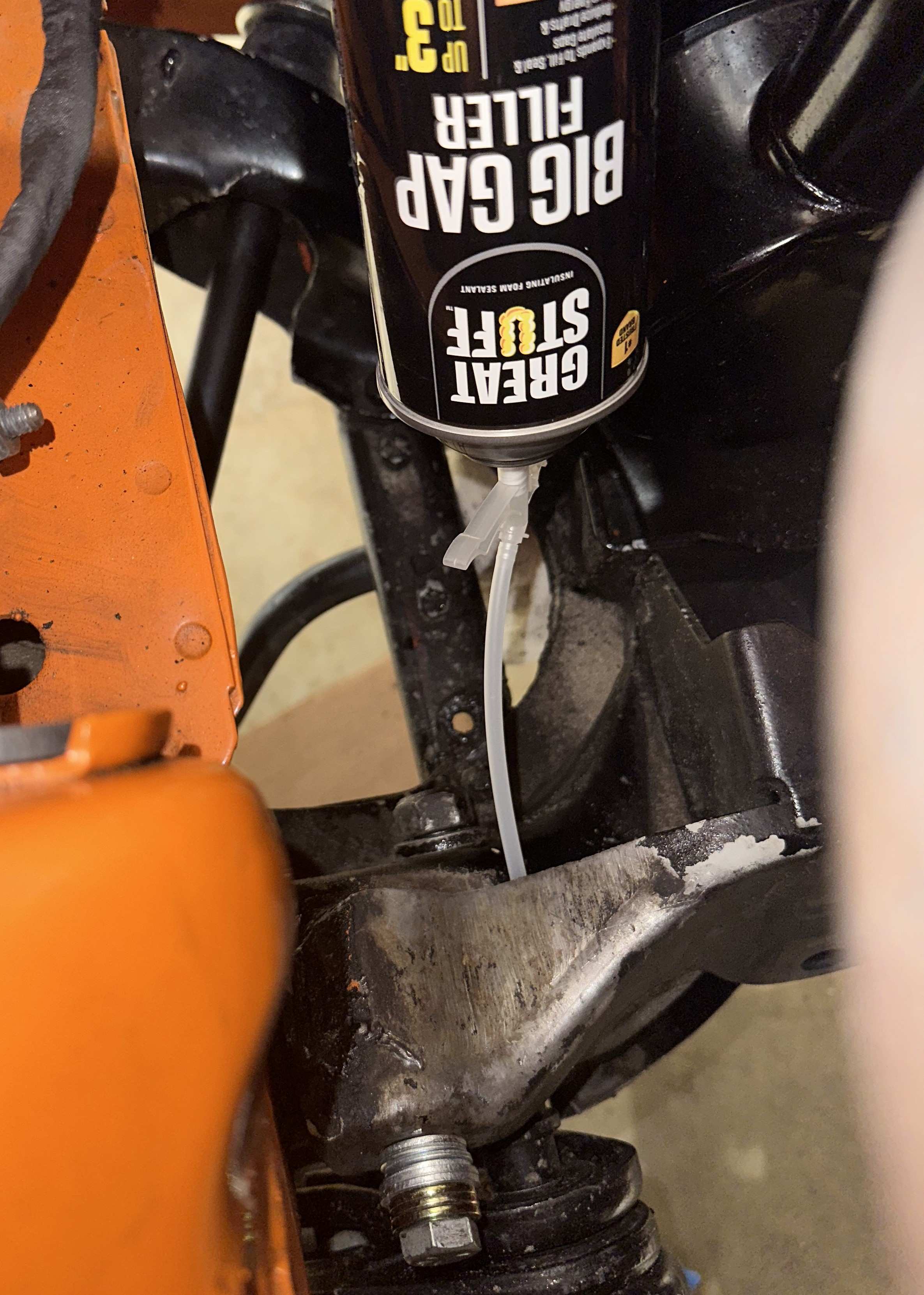

- With some careful finger work, I was just barely able to push the nut/wrench assembly into position and start a bolt to hold it in place.
- To hold it there while finishing the install, I shot expanding foam into the cavity.
- Once cured, I removed the bolt—the nut and wrench stayed perfectly in place.
- Reinstalled the steering gear, and the wrench stub locked itself against the K-frame while I torqued everything down.
